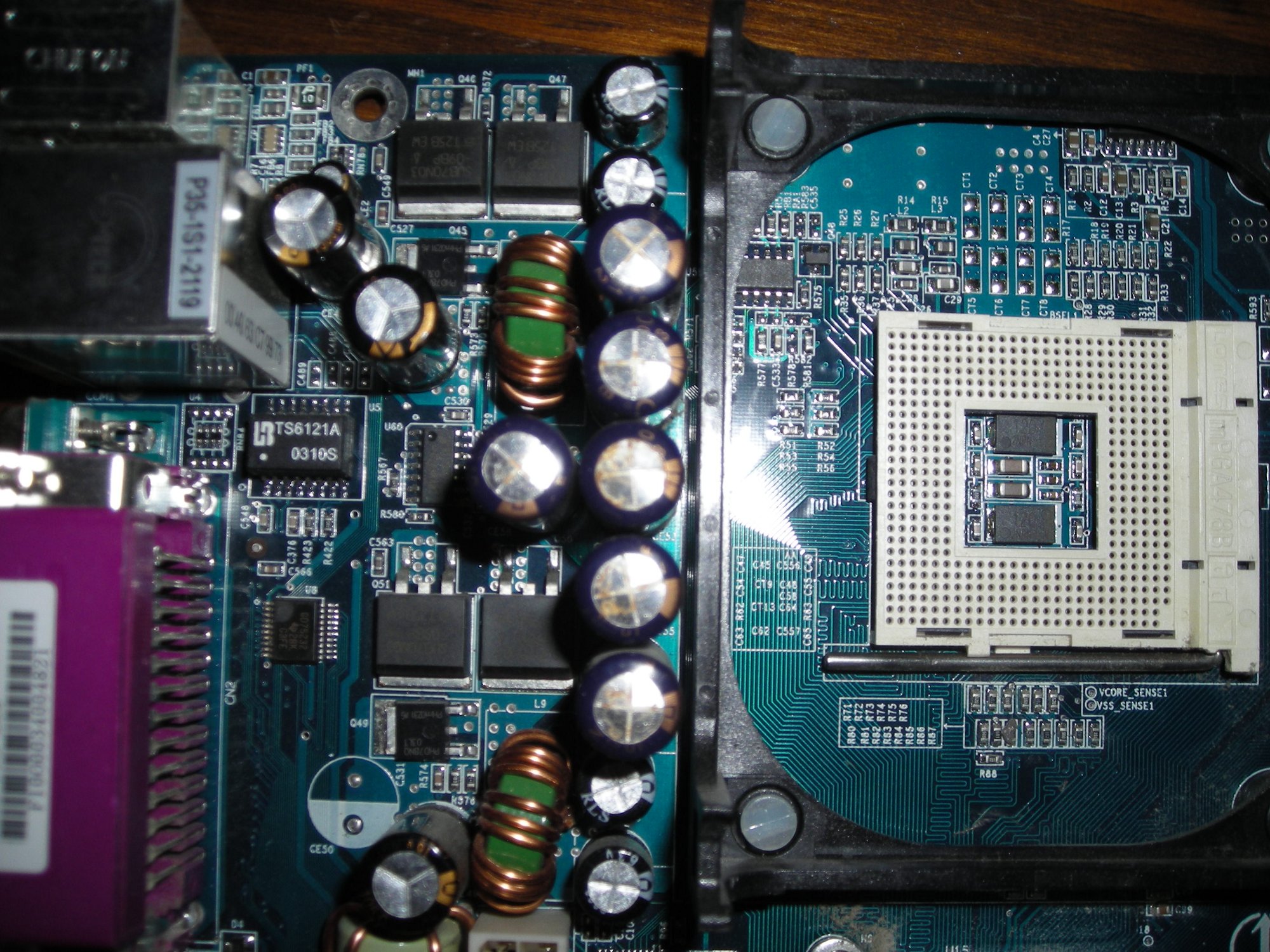

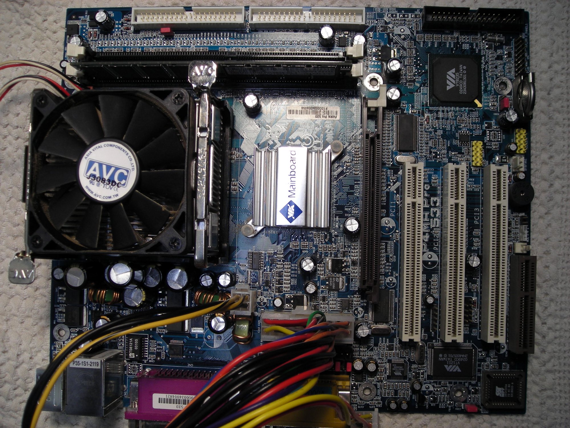

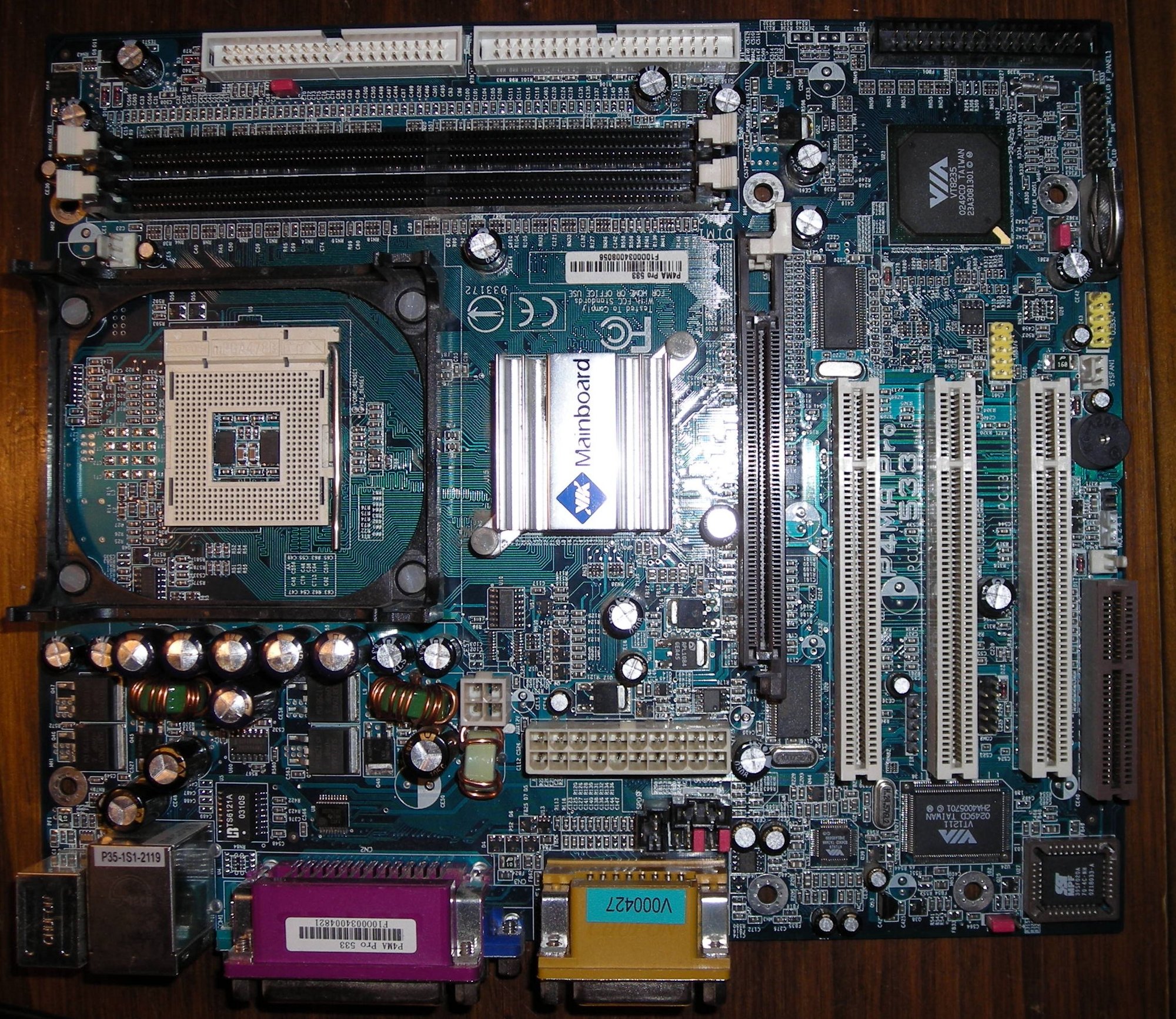

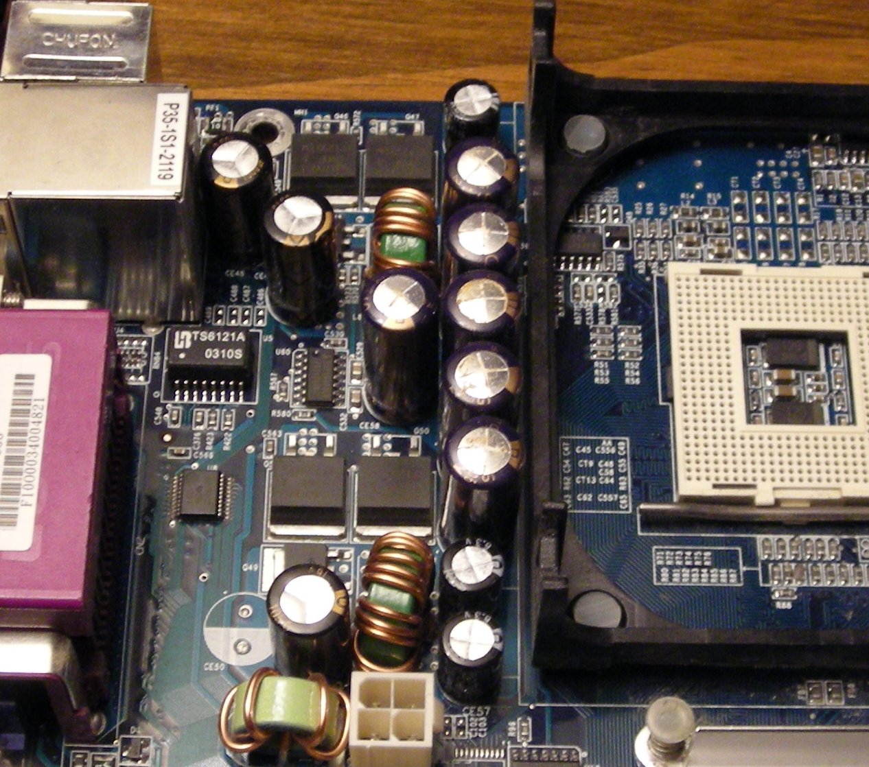

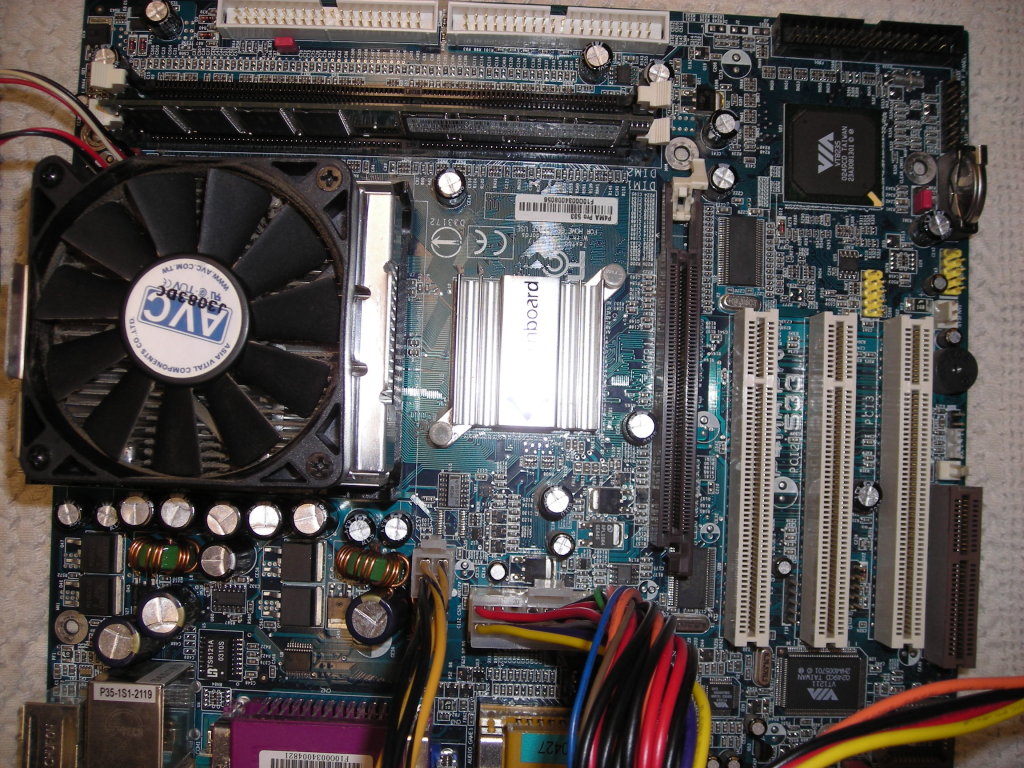

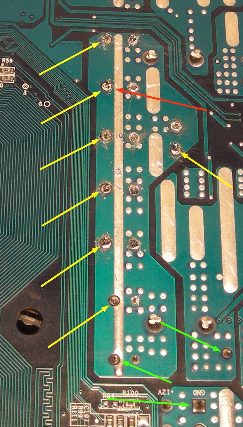

    I just finished recapping a board that I got from a buddy that had died on him. There were 6 visibly bad caps, so I decided that I would replace them, and see where that got me.
    When I try to power on the board though the fpanel connecter with a jumper, I get nothing.(I downloaded the motherboard manual to find out which is the power)

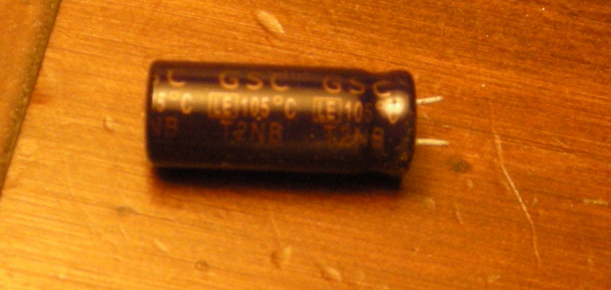

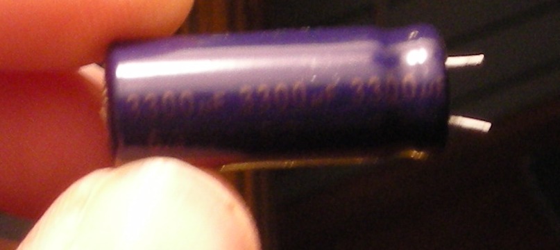

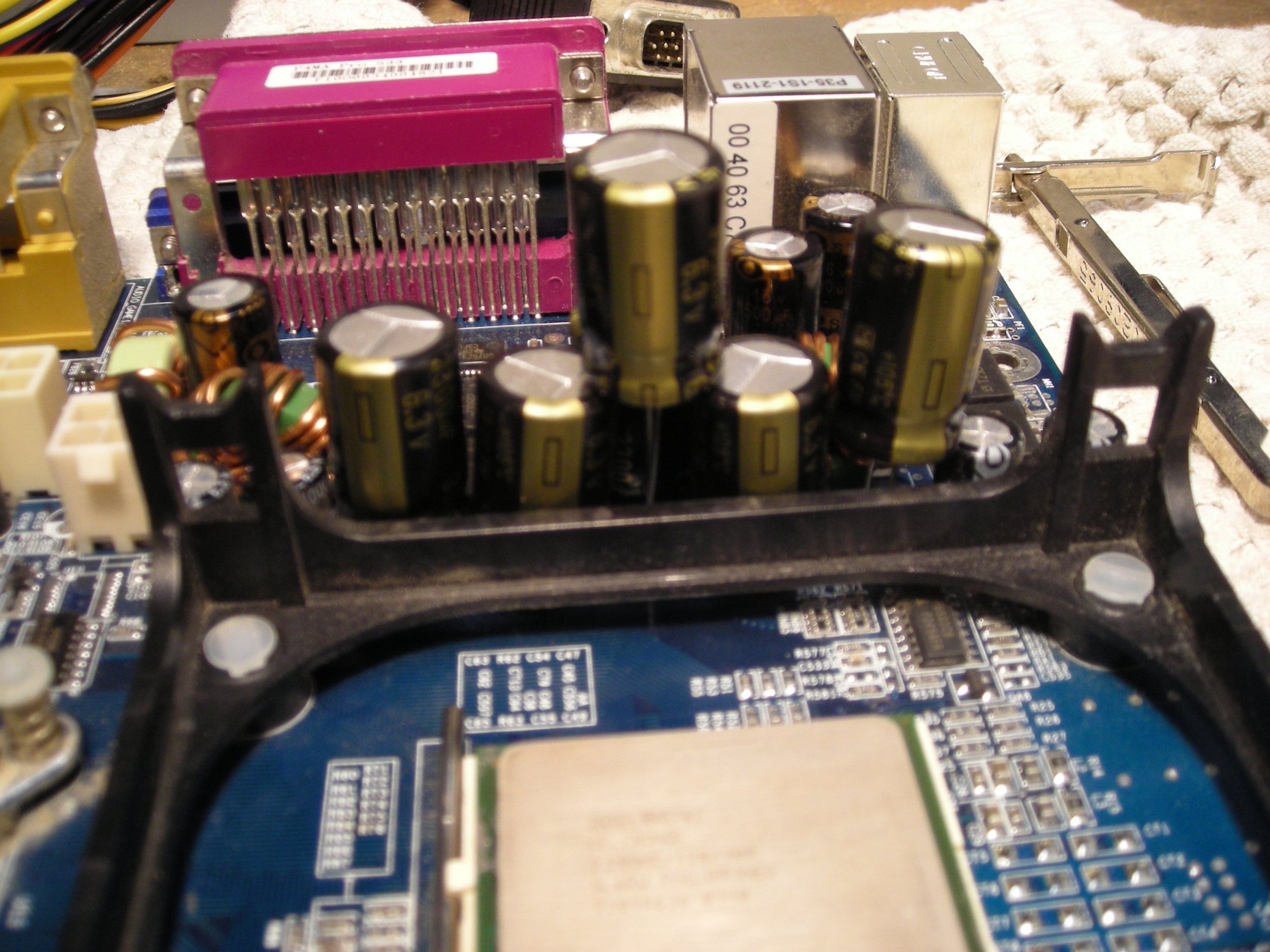

    I used Panasonic FM 3300uf 6.3v replacements. (had to work around the size issue which I mistakenly made)
    All capacitors are correctly oriented afaik, and leads are all soldered. My friend used the board with bad caps for awhile, so I don't know if this could have caused any other problems, but I assume so.
    When I try to power on the board, it does nothing, no fan movement etc..
    I don't have a ESR meter to test the rest of the caps, but I was wondering if it is worth trying to replace the others which are mainly 1000uf 6.3v and 1500uf 16v (the latter I don't have any) Or iif there are any other suggestions..
    Thanks for any help.
    P.S. I also tried removing the battery, and clearing cmos.

        Re: No post with selectivly recapped P4MA Pro

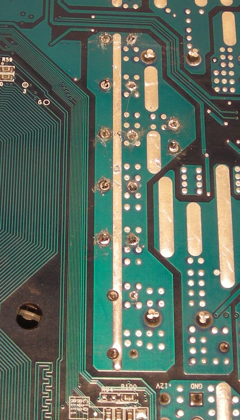

        The pictures were taking too long to come up so I didn't see the possible problem right away.
        Put your magnifying glasses on and:
        Redo all the solder joints with the Yellow arrows.
        The joint with the Red arrow looks like it has a gap. It's missing solder.
        All of those should look like the connections with the Green arrows, with the little "moat" around them clear of any muck.
        Those pads have a gap around them which insulates them from the ground plane. As PCBONEZ said, there may be a "whisker" of solder there. That will keep the PSU from coming on because it detects a short circuit.

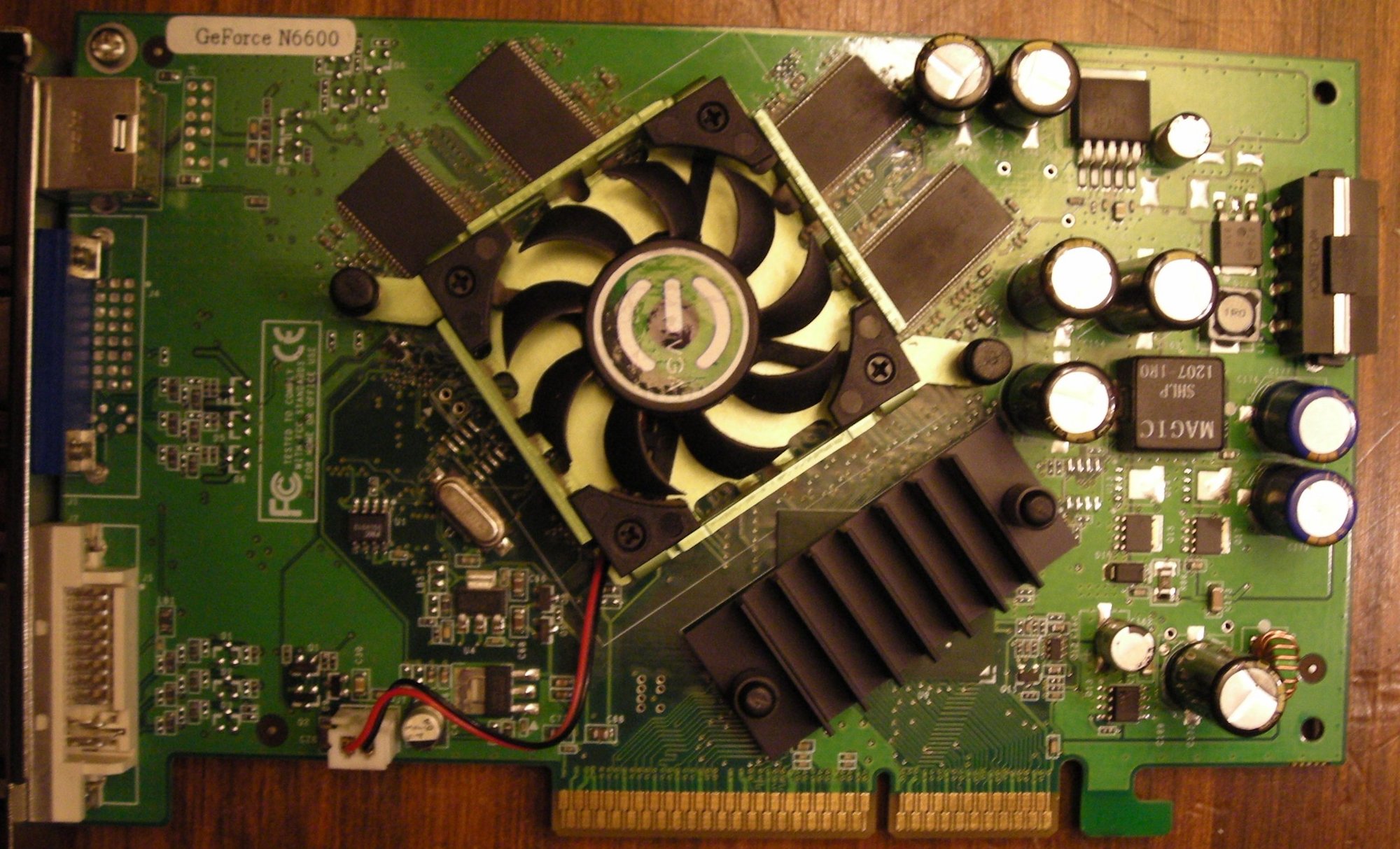

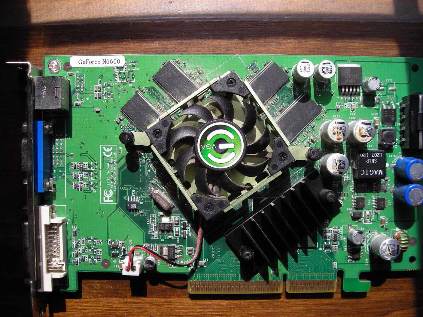

          On a good note, my recapped graphics card works fine so far.
            Toast
            Hi Toasty,
            Thanks for the pic and suggestion, I will take it, and redo these joints. I know they all made contact with the solder, but I suppose it wouldn't hurt to try and do a better job. (yep I know it was shoddy.) Working with a 45Watt iron seems to take forever to heat stuff up. I'll try to clean it up and see what happens.
                    Hi Datz,
                    I noticed you put some of the caps high off the board (due to limited space). Problem is, when caps are high off the board, their ESR goes up and they are not effective. If you are re-ordering replacements for the OSTs, you might as well order some caps that are the right size (and maybe save those Panny FMs you have right now for other boards that might come in ). Make sure the new ones are flushed with the board (like the ones you installed on your video card).
                    Also, if you have an old tootbrush, use it to scrape away any solder splatts that might be present after you have put in the new caps.
                    As for your soldiering iron, I think it's fine. I have a cheap 30-watt Radio Shack one and it seems to handle anything I throw at it. The trick is to make sure the tip is clean (remove any old solder that has accumulated on it). Also, apply a little bit of new soldier to it before removing the caps as this should help with the heat transfering.
                      Thanks, momaka, I did not know about the increase in ESR. If I order more replacements, I will make sure to get the right sizes this time.(I didn't think 2mm could make such a difference, but now I know I was dead wrong...lol)
                                  Hmmm.
                                  Thoughts -

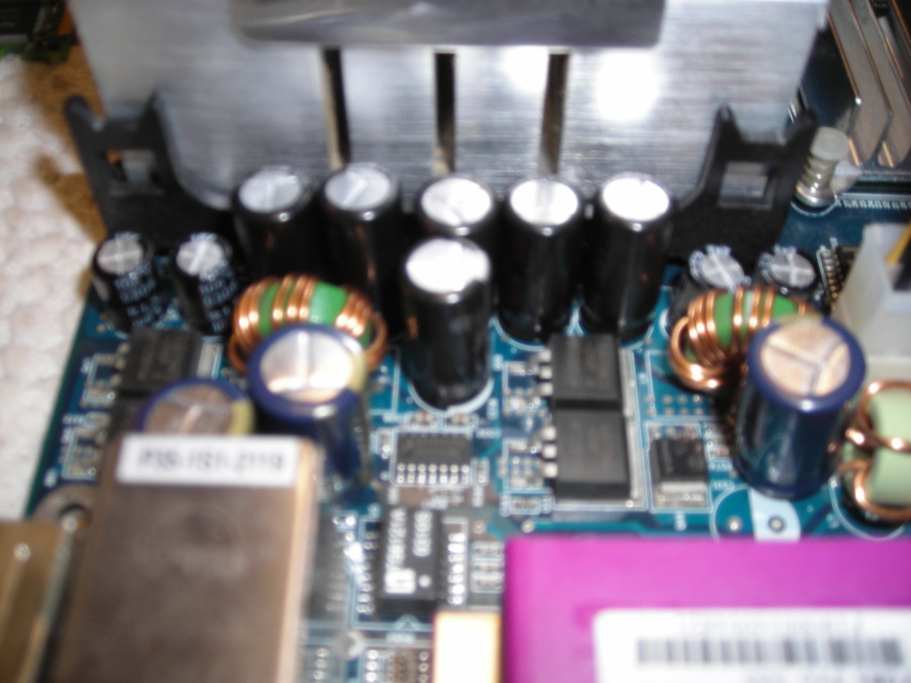

                                  Going from the first post where I saw the soldering mess, I'm thinking maybe you fried the VRM MOSFET's when you powered it on. Or, maybe they were fried when you got it. Don't know how quick the PSU caught the problem.
                                  Check Q45, Q46, Q47, Q49, Q50, Q51 - Don't know where Q48 is, if there is one...
                                  Did you perhaps reverse any of the caps when you replaced them? Negative (usually) goes to the white or hash-marked side of the silk screened circle under the caps.
                                  Using an ohmmeter, check from the negative terminal on those caps to the positive and see if you get a reading of zero ohms (the same as when you touch the probes together). Then reverse the leads and see if the reading is the same. If you get a zero reading it might mean that the cap(s) are shorted somewhere. You may still have a soldering problem.

                                    Regarding the VRM MOSFET's, they all look fine. I don't know how to check them otherwise.
                                    I don't think any of the caps were ever revered when installing them. I'll have to wait till I get my multimeter back to check the caps, but thanks for the suggestion, this may give me some clue as to whats wrong. Do I need the PSU hooked to the board when testing this? Also, I have made sure the solder joints are done much better this time around. And I don't see any splatter that would cause a short. Is it possible some of the caps were ruined by getter too hot in the soldering process?
