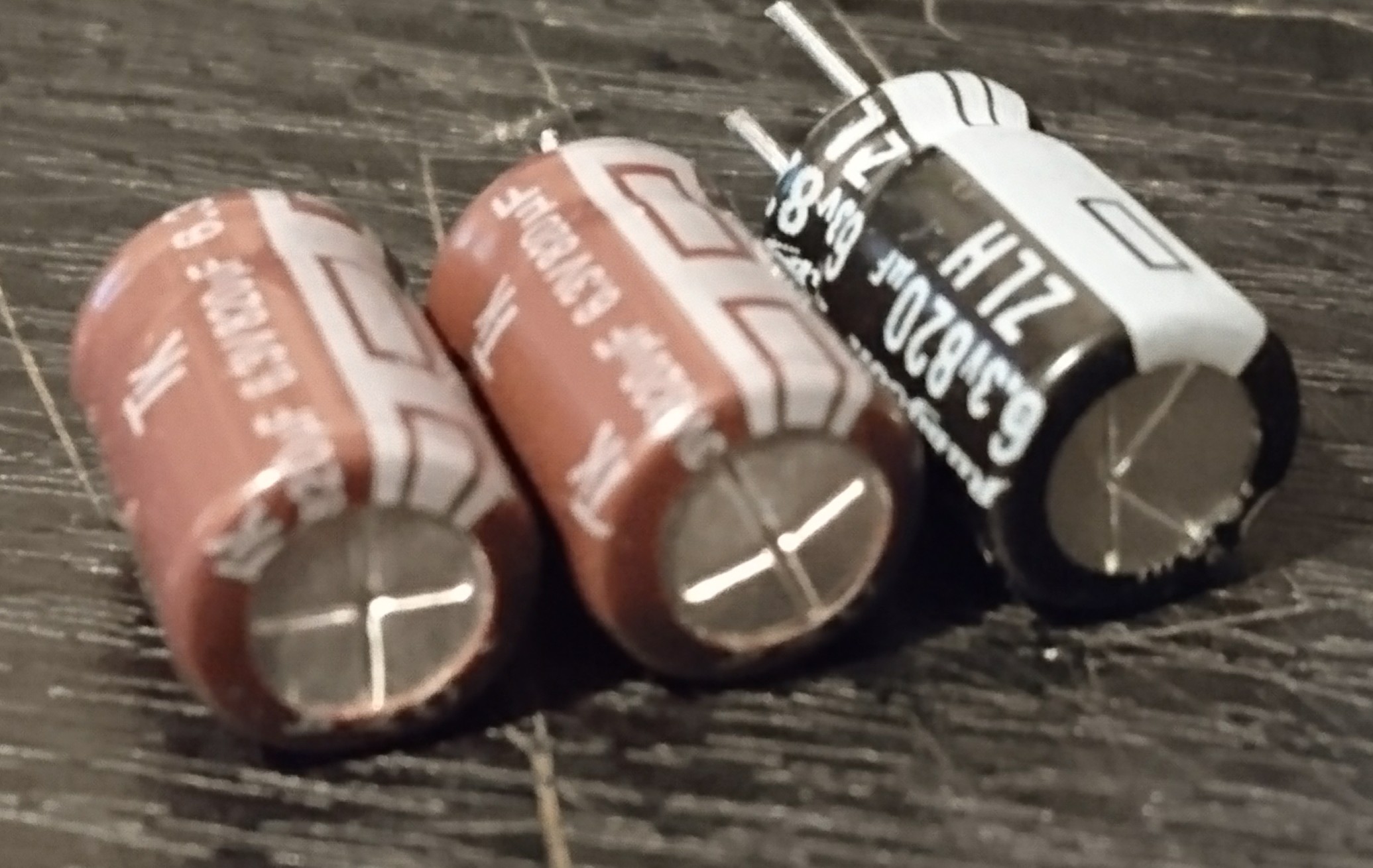

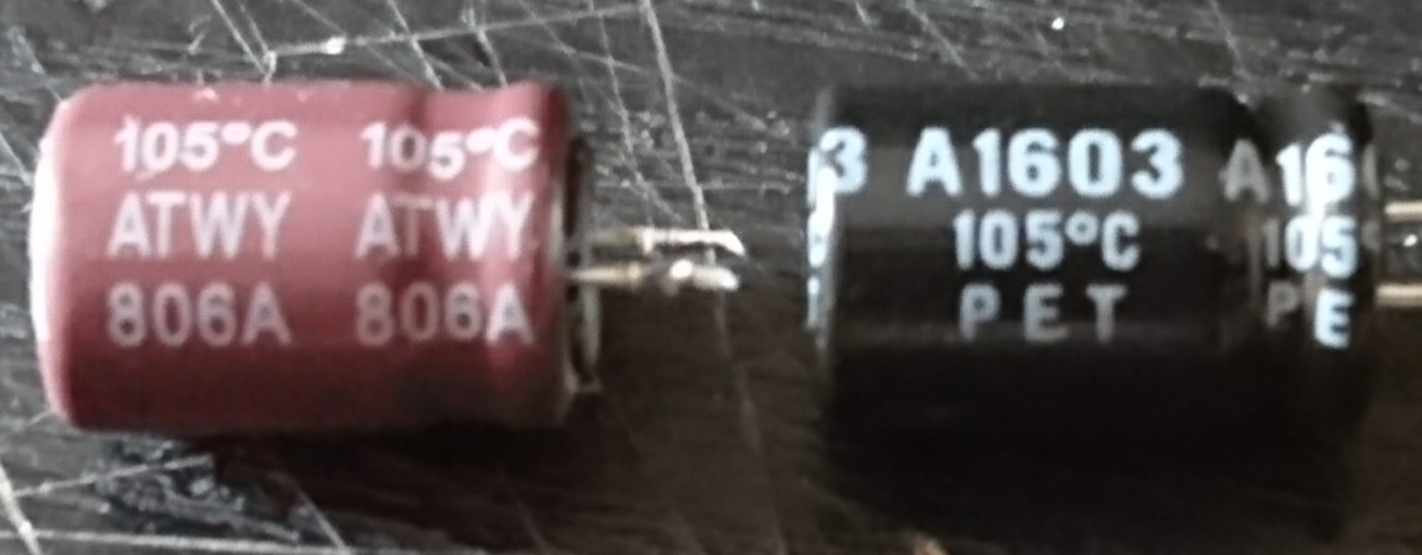

    So I have a geforce 8600 gt (en8600gt) fanless graphics card that was giving me problems, it would cause artifacting in videos initially but then constantly freeze and lock up and sometimes go to blue screen. I uninstalled the nvidia drivers and the computer would start up in VGA mode and it worked but it was very sluggish. I noticed some capacitors looked bulged so I ordered some more and replaced the bulged capacitors but when I restarted the computer it would not turn on instead the red VGA LED would light up.
    I tried again to turn it on and it only started up once but the screen was terrible there was so much artifacting and after that it would not turn on again instead the screen would be black. So I took the new capacitors off and put the old ones back on and I still got the red VGA light and the computer monitor would not turn on.
    I put the new capacitors back on but this time I replaced a few more old capacitors that looked fine so in total replaced eight capacitors but still I get a red VGA light and the monitor does not turn on.
    I've added photos of the capacitors the old one is the brown one the black one is the new one what did I do wrong, initially at least the computer would start up in VGA mode but now it doesn't turn on at all.
    I think I killed the graphics card competely so ordered a cheap one from eBay, but just curious as to what I did wrong here to make things worse as I got 6.3v 820uf capacitors, same as the old ones. I tried the card in a different computer and the screen would not turn on also.

    where did the new caps come from?
    can we see a foto of the top of it.
    • xad
      • Jun 2017
      • 11

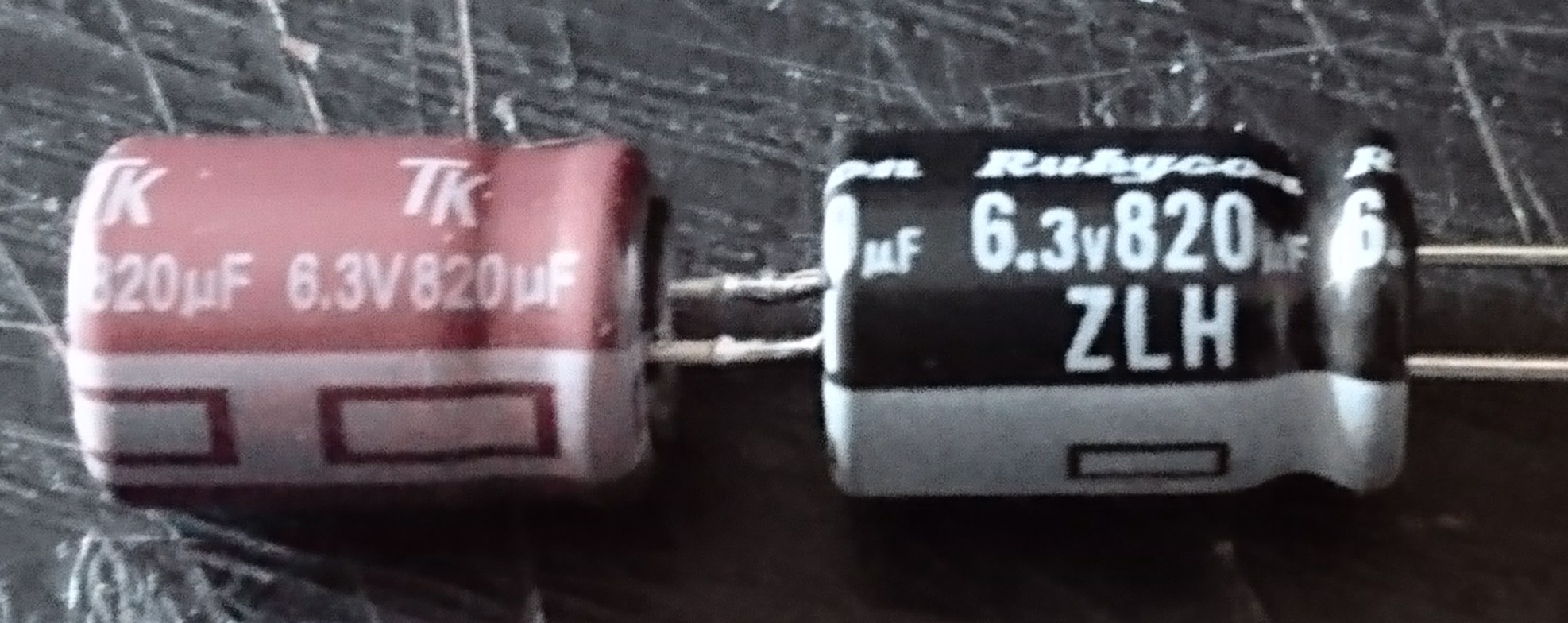

      Re: Geforce 8600 gs graphics card, failed repair
      I got it from eBay here: http://www.ebay.co.uk/itm/300494581145

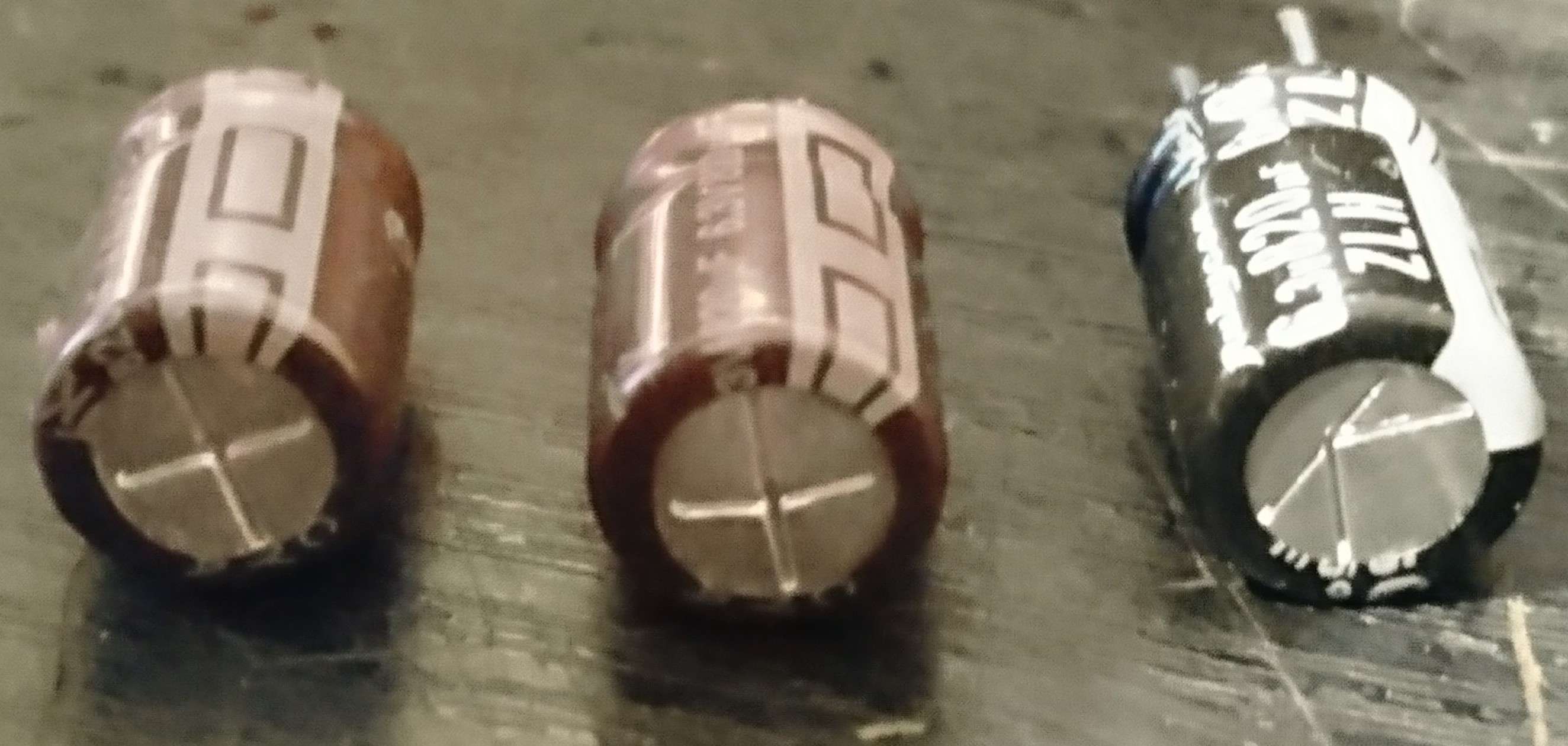

      I've attached photos of the tops, from the left:
      1: original cap looks okay
      2: original cap, bulged
      3: new cap with a K structure on the top instead of X

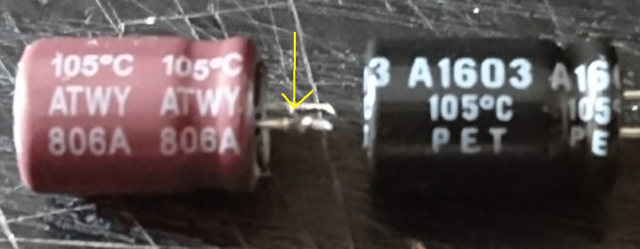

        Sometimes, not always when the old cap is removed the feedthru gets pulled out and stays on the capacitors lead, when this happens the connection between the top and bottom traces can be lost.

          If we assume that the TK caps were up to spec, AND that the Rubycon caps were genuine and so up to spec, the Rubycons would still not be a suitable replacement. You need to find caps with about same or little better ripple rating, and about same impedance as the TKs.
          If you can get hold of some genuine Suncon WG (previously known as Sanyo), they would be a very good match for the TK caps, spec wise. But I advice to stay away from eBay, as there are to many fake caps for sale. Panasonic FM will also probably work, if hight is not a problem. Otherwise I would probably look for polymer caps.
          Be a mensch
            • 31066
            the rubycons are from china, they have cropped leads.
            that means they are intended to be loaded into a pick&place robot in a factory.
            they may be real - and stolen/surplus from a production-line.
            but yea, i would have used poly's

              I've found that the original TK caps have a ripple current of 1140ma and esr of 0.036ohms while the new Rubycon cap is 945ma ripple current and 0.056ohms ESR. Would this be too much of a difference between old and new? I bought them in a rush thinking voltage and uf rating is only required having watched some youtube vids.
              Also, initially when it wasn't working I took off the new caps and soldered the old TK caps back on but the graphics card would not turn on where before it would turn on in VGA mode and work but now the red VGA LED on the motherboard lit up so the card wasn't working at all, should it not have gone back to how it was before with the old capacitors soldered back on?
              As for pulling the feedthroughs, that photo actually shows solder, I added more solder to remove the caps as they were a pain to remove, but just in case I checked all the removed capacitors and used a soldering iron to clean the legs up to see if I pulled anything out and it looks like I haven't, but again I could have damaged the board as the capacitors were a pain to remove and solder new ones back on.
