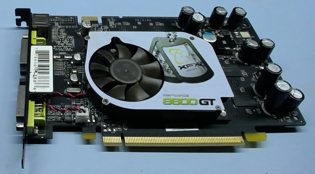

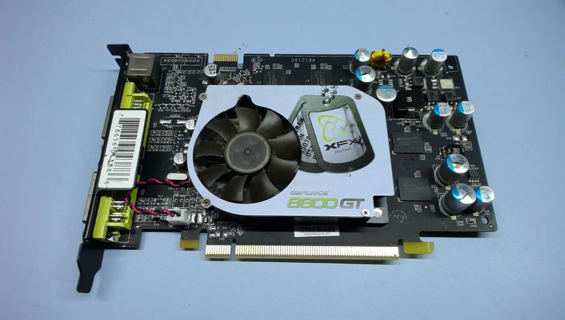

            I decided to repair an XFX 8600GT I had laying around with blown Sacon FZ...
            Some new Rubycon and Panasonic later, it's working! I'm using it to power a 24" Dell LCD on my workbench (great for viewing schematics etc)
            It idles at about 44 - 47°C with the stock cooler (fan still in good condition). I'm not going to be gaming on it. Should I bother with a better cooler?
              Nice!
              So it's the same like my XFX 8600 GT cards I posted?
              Not unless the noise from it bothers you.
              IMO, the noise wasn't that terrible in a closed case, but still quite loud.
              44-47C is pretty decent for idle temperatures. I was getting no less than 46C at 18C ambient room temperature with open PC case. And 18C is too damn cold for me, so my room temps are usually higher (I prefer 25-27C).

                Yeah, I think so, I've added photos.
                Out of convenience I mounted the new capacitors to the SMD-alternate pads on the top side.
