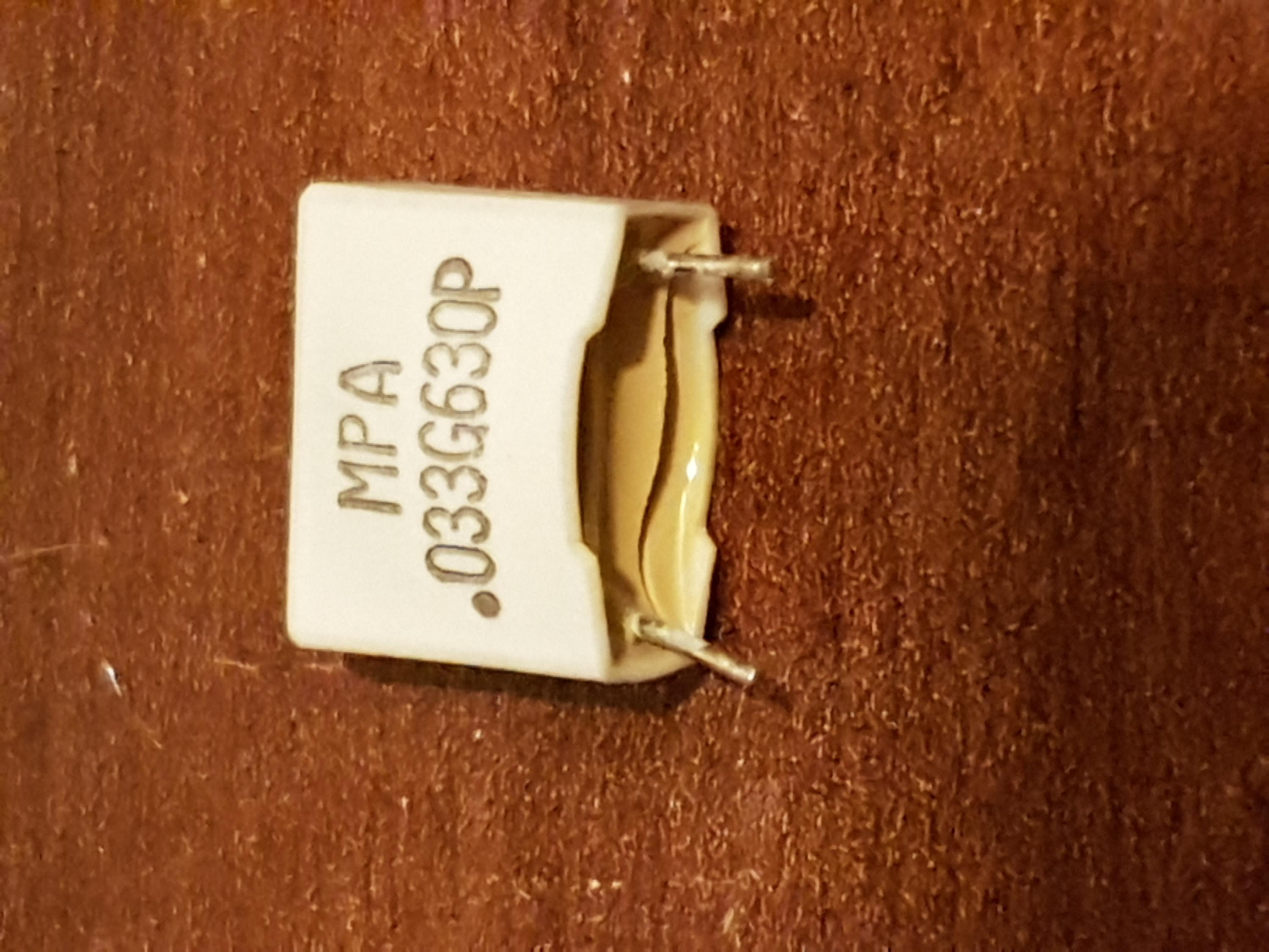

Need help to identify this cap
  • longlong2k
    • Mar 2010
    • 4
    Can you help me to identify this cap? It reads MPA .033G630P.
    My guess is this is a Metallized Polyester Film Capacitor of some sort of 0.033uF 630V. However, I have no way to validate whether I guess correctly or not.

    Re: Need help to identify this cap
    I would say your guess is right. Have you measured capacitance?
      I am totally new to this. Can you advise how to measure capacitance?
        Your multimeter should read capacitance
          You right. Metallized Polyester Film Capacitor....0.033uF 630 V
            Might the "G" mean 2% tolerance?
            In other contexts:
            M = 20%
            K = 10%
            J = 5%
            G = 2%
            F = 1%
            B = .1%
