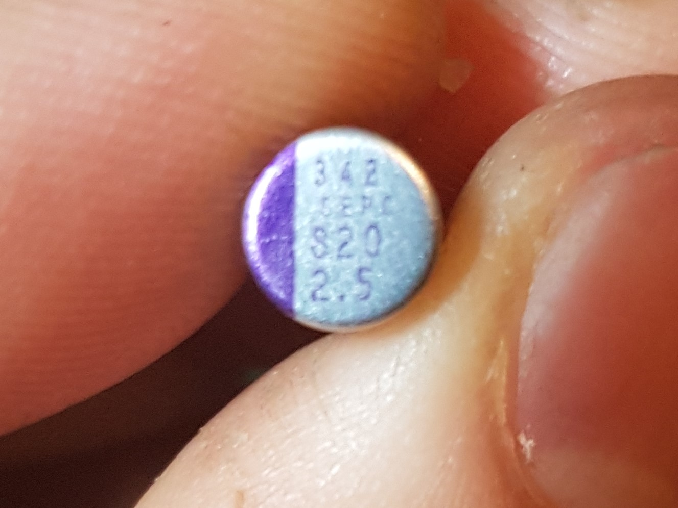

    So I have the cap which reads 342 and beneath it says SEPC then 820 then 2.5 with a purple tinge to it. (I have attached a picture)
    From what I understand with replacements I have
    Batch = 342
    Rated capacitance (μF) = 820
    Series = SEPC
    Voltage = 2.5

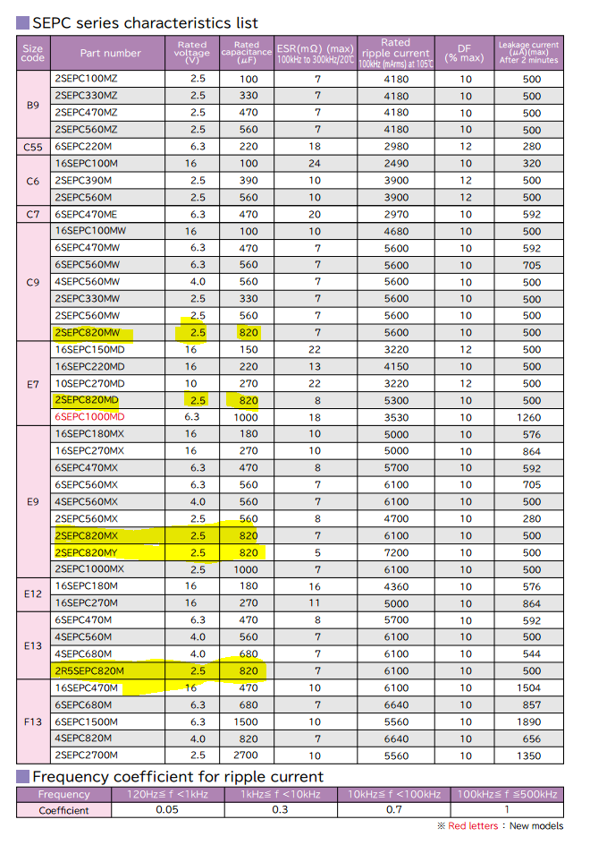

    Now my local supplier has a catalogue which offers 4 or 5 that seem to make these values but with different resistances and other variations ( I have also attached a pic of that too)
    the variation seems to be with Size Code, ESR(mΩ) (max) 100kHz to 300kHz/20o & Rated ripple current 100kHz (mArms) at 105℃ DF (% max)
    They are all 2.5V, 820uF, DF (%Max) of 10, Leakage Current of 500 uA
    Please Please Please can someone help me out with which one I need to get to replace it as I need to get my motherboard back up and running reliably again I have attached pics and charts if that helps with working out which one I need
    Code:

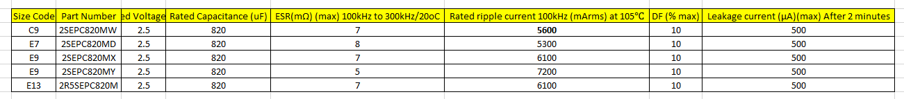

    Size Code	Part Number	Rated Voltage (V)	Rated Capacitance (uF)	     ESR(mΩ) (max) 100kHz to 300kHz/20oC	Rated ripple current 100kHz (mArms) at 105℃
    C9	    2SEPC820MW 	2.5	             820	                      7	                        5600
    E7	    2SEPC820MD	2.5	             820                       8	                        5300
    E9	    2SEPC820MX	2.5               820	                      7	                        6100
    E9	    2SEPC820MY	2.5               820	                      5                         7200
    E13  	2R5SEPC820M	2.5	             820	                      7                         6100

    Its a Panasonic 2R5SEPC820M (Os-con) no longer sold at mouser
    7mOhm and 6100mArms, 8mmx13mm
    2R5SEPC820M is your closest match
    hope you know how to unsolder the lead

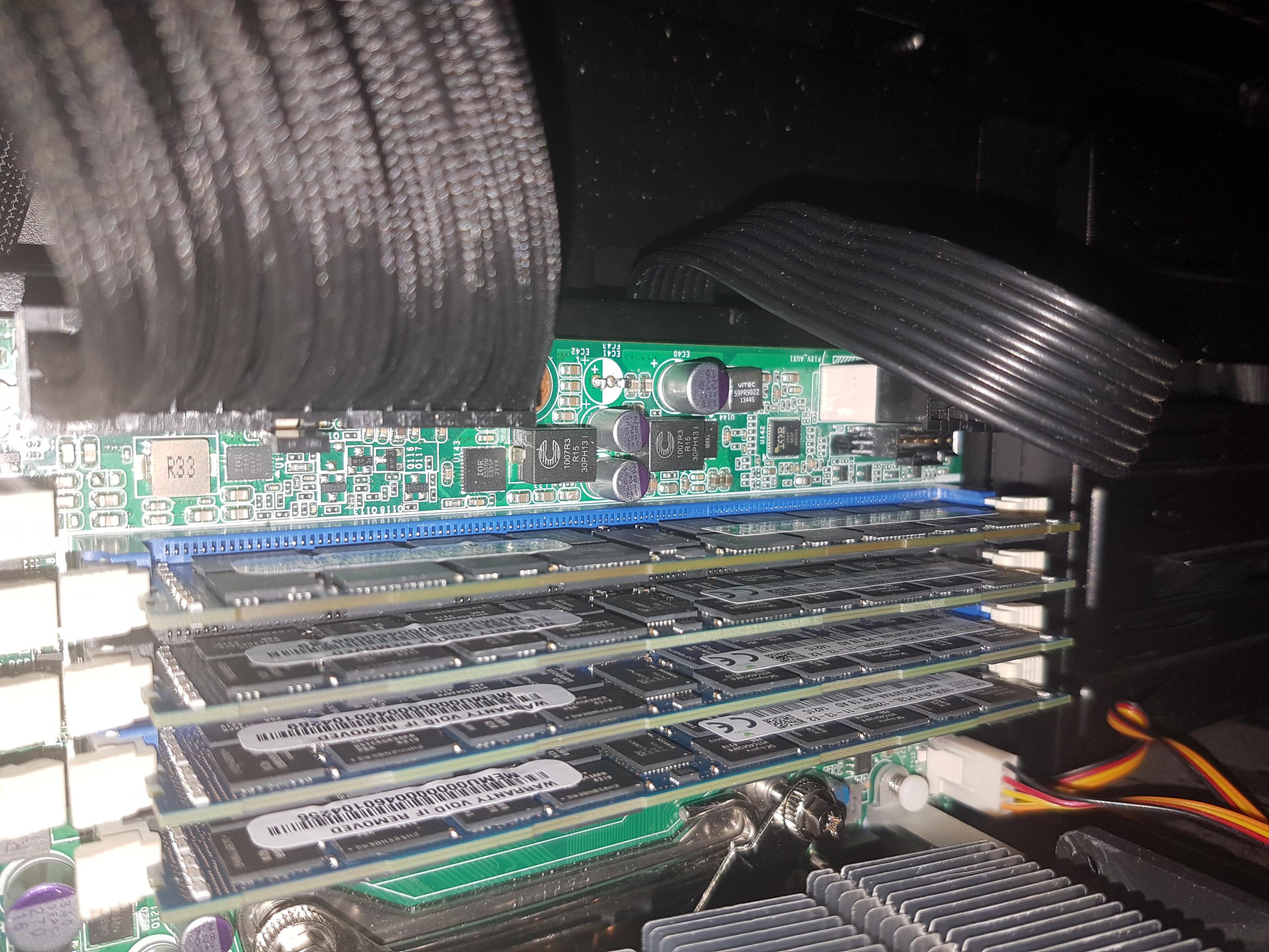

        are the legs above the board or below? can you get a picture?
        • cgtechuk
          • Apr 2017
          • 9
          • United Kingdom
          Re: Please help me identify which capacitor I need to replace on my Motherboard
          Hi there

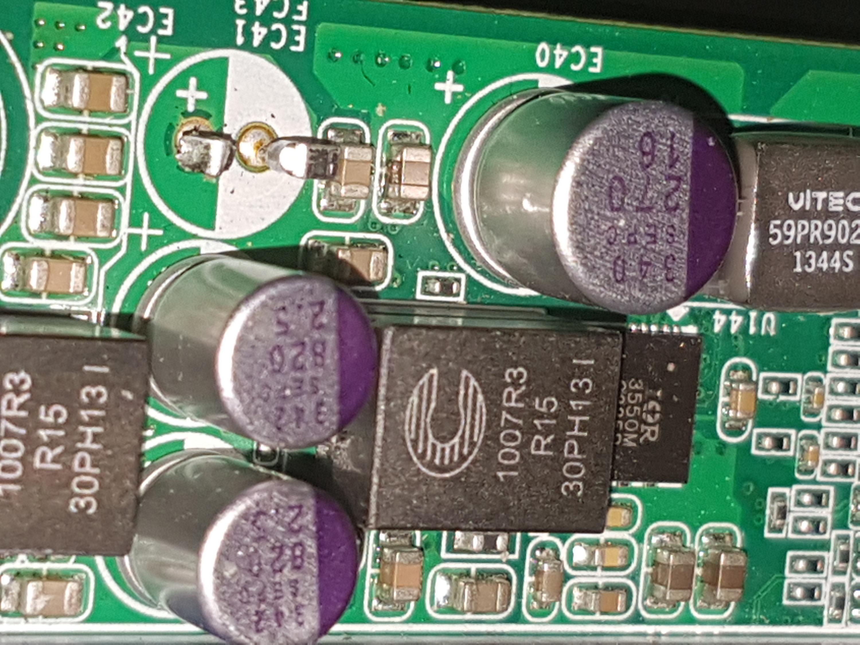

          The legs are above the board. I have attached some pictures. One close up and one to show you position on mb

            ok, take the ram out and disconnect the atx pin first
            You can cut the leads down to a small amount and solder it on there (10mm?). Make sure its on right
            If you have the skill, you can apply the iron on the top of the board where the solder is on each lead and pull it up carefully with a pair of needlenose plyers while the solder is hot and liquid (might want to apply flux first). If successful, add some flux and add some leaded solder on the bottom of each hole (nice and shiny) Then make sure the leads are on top of each hole and heat the bottom where you put the solder, it should heat through from the bottom of the hole to the top and _gently_ push each lead down. A little bit at a time, from the right hole to the left, a little bit at a time.
            make sure its on the right way (half moon mark on the cap matches the board)

                actually the last one on the list IS the exact matching one. I can't believe I didn't pick up on that
                yeah you're better off trying to get it on the legs and being real careful with it.
                edit: oh, MX is an exact match too

                  The E13 one (2R5SEPC820M) is the one that no one has anymore anywhere lol.
                  The E9 one (2SEPC820MX) is one of the 4 I did get which is great to hear, I will speak to my dad and see what he says and if he is up for it! im not sure what the differences between the E9 and E13 is mind you
                  Also not sure what the R means in the model number lol
                    4mm shorter
                      Such way he'd do that the whole day. Just get dental explorer and pierce the hot solder.
                      https://en.wikipedia.org/wiki/Dental_explorer
                      You can get pretty much any similar cap with 2.5 V and same or higher capacitance. Chances are it will work fine even without the cap anyway.
