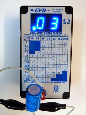

    I have been told the best way no be sure of a Visually good capacitors true condition is to measure its ESR. However I am still confused as there doesn't seem to any specific value of this. Some manufacturers data sheets for capacitors don't even give the ESR rating of thier capacitors. For example (1)
    I have here a Nichon 25v 220uf electro cap that according to my GM328R component tester has the following values: Impedance 228.4 ohms, vlos 2% and a ESR:0.40 ohms. As i cannot find any specs on what a acceptable ESR should be How do I know whether this is a good or bad cap. Example 2 is a nichon 4700uf 10v electro cap and it tests are: uf=5293 uf, vlos=1.9% ESR=0.16 ohms. Are these caps good or bad? Some caps I have measured have impedance in the fractions of a ohm while others can be many ohms. Is there a rule or baseline for knowing when a cap is in tolerance and a acceptable usable condition.

    i suspect both those caps are fucked - specially the first one.
    esr is only missing from datasheets of 85' general purpose caps.
    for those, there are vague charts printed on early meters.
    here's one.

      Thanks that's very handy. Apologies I didn't notice the decimal point ahead of those ESR figures, I wish they would put a leading zero as the decimal pint is not easy seen so are these caps still U/S?

        if it's under an ohm it's probably o.k.
        unless it's a low impedence type - then we need the datasheet.
        you didnt say what series either of those caps are.

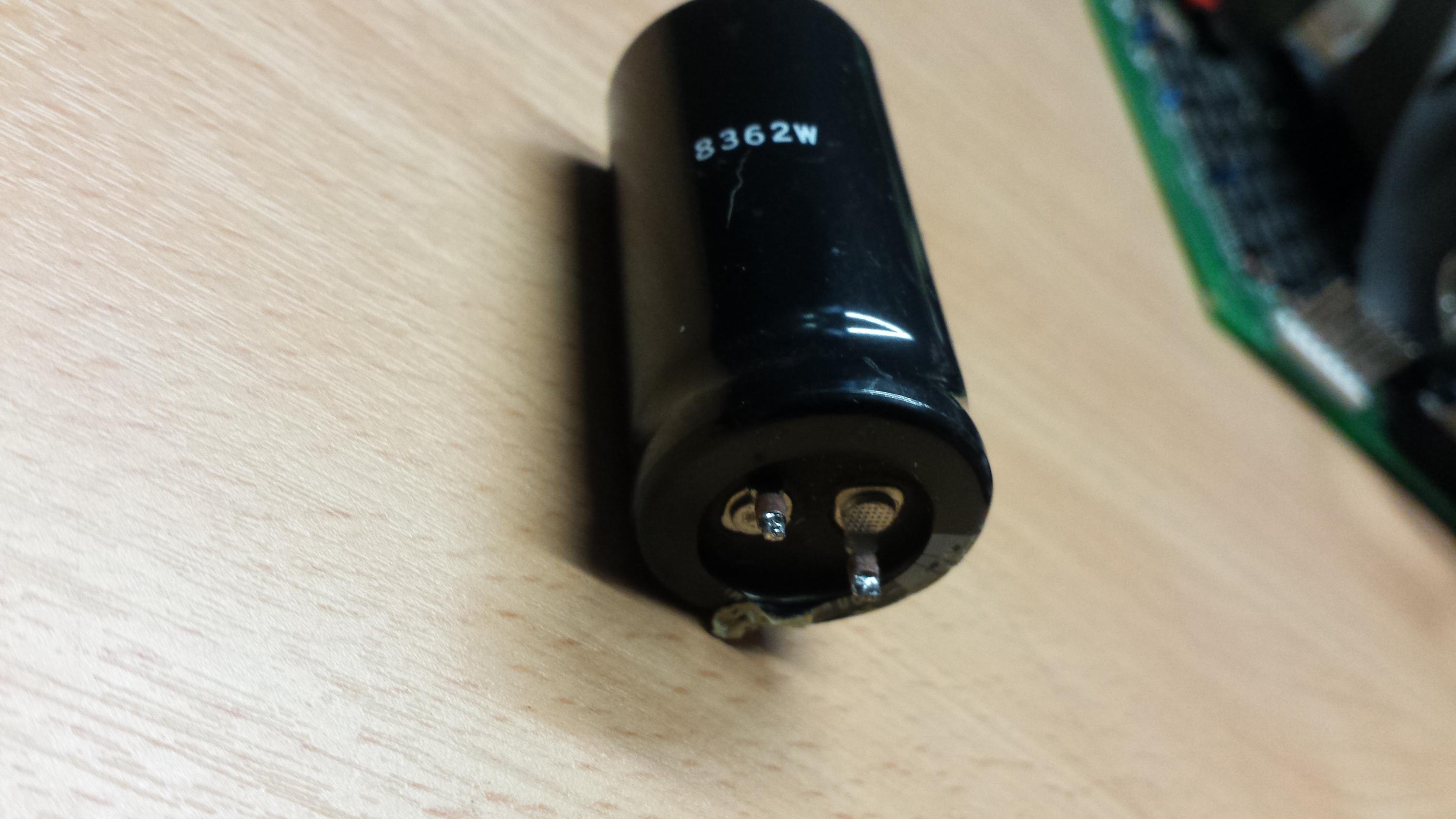

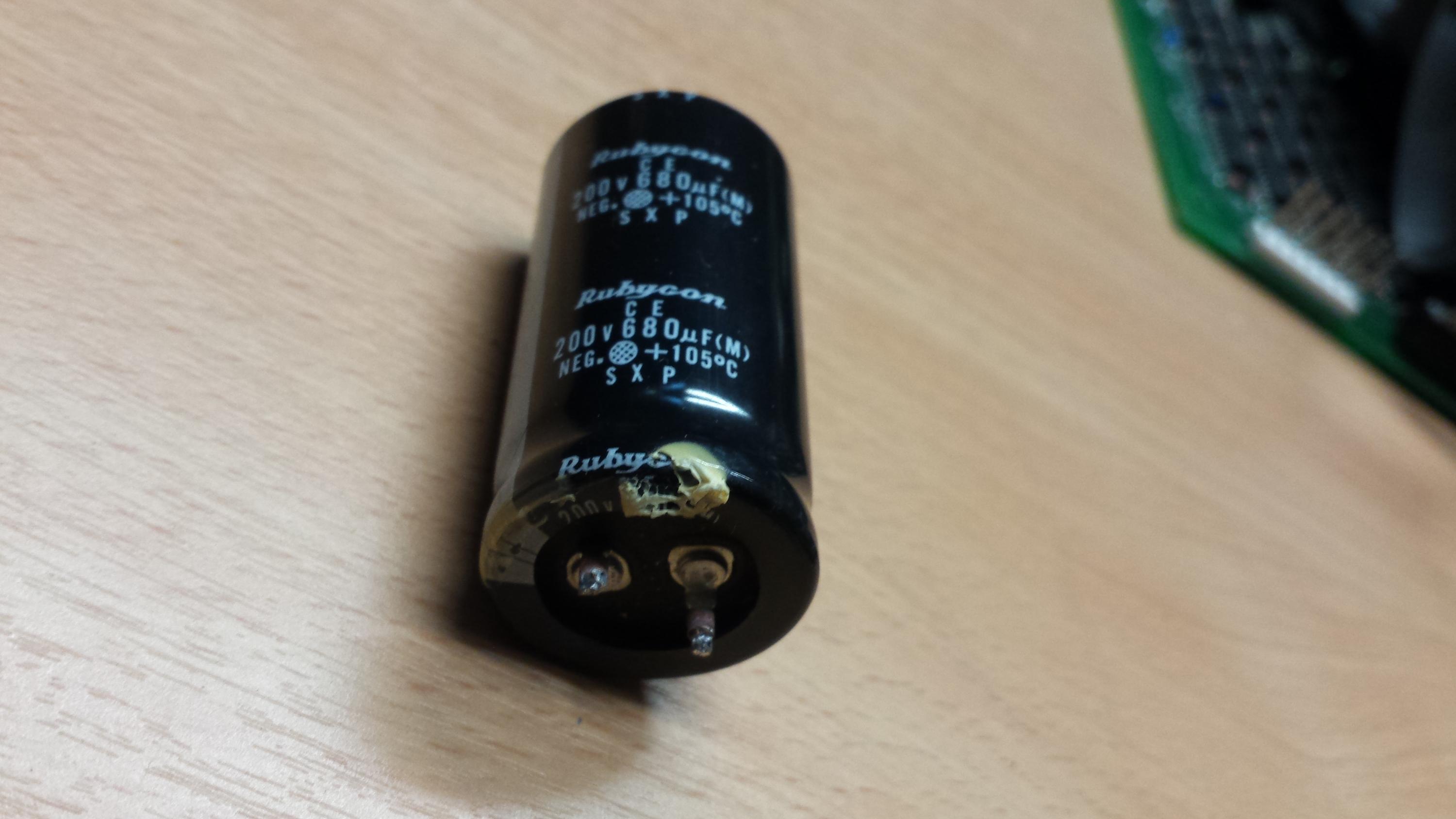

                  I was going by what the Temp specs were on the cap and finding a cap with the same rating. How are you identifying the Series? Here are some pics

                    SXP series.
                    and it's what they call a "snap-in" terminal, large can type.
                    http://www.paullinebarger.net/DS/Rubycon/
                    i dont see it there, but a search will probably find it.
                      • 31288
                      Re: Capacitor ESR
                      btw, it's smoothing the mains,
                      so ESR is not important, but ripple-current is.
                      more is o.k. - less is bad.

                          Initially you were talking about specs measured on Nichicons but you showed a pic of a Rubycon.
                          Attached is an old copy of that SXP series, no esr data, but has ripple current spec dependent of physical size.
                          Typically the series is a 2 or 3 alpha numeric designation.
                          Esr will vary by series and manufacturer. Also is dependent on capacitance. temperature rating and physical size.
                          There is no hard fast rule, but experience will help.
                          Data sheets are necessary.
