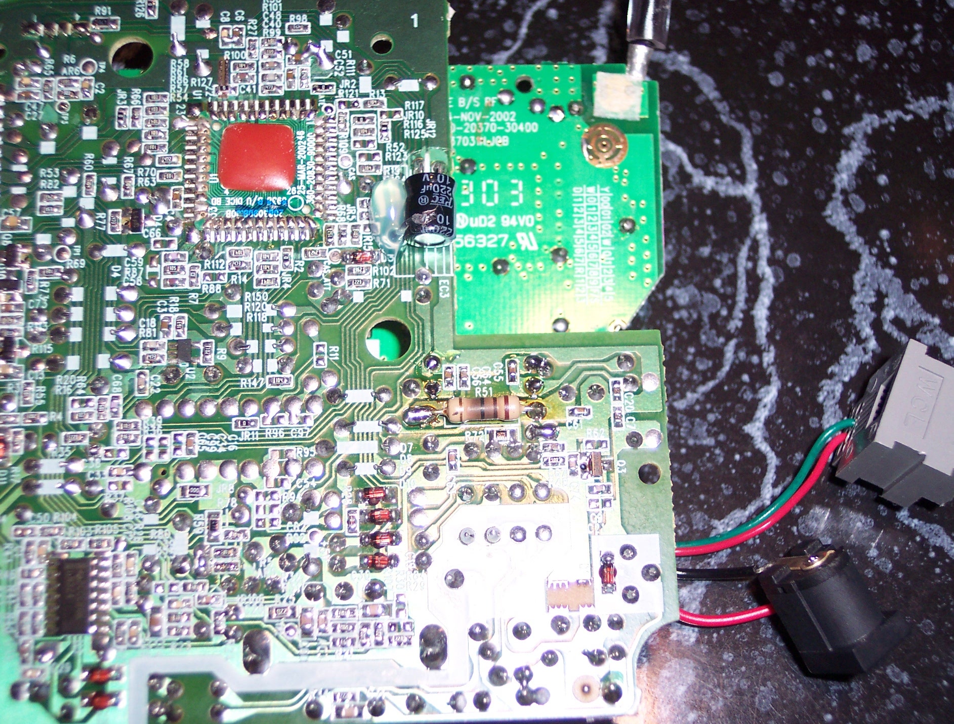

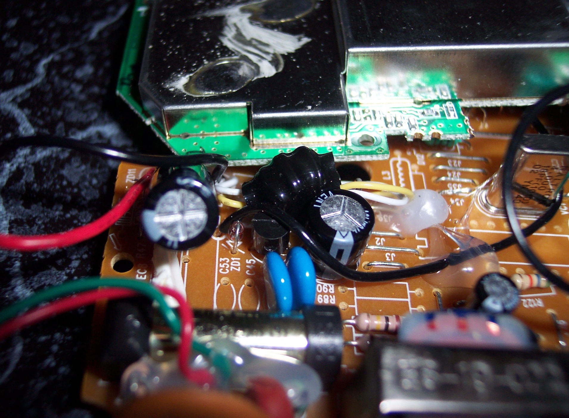

      Re: Bad Capacitors Heat Up?
      I have a brand new Panasonic cordless phone that was not working from the box. The adaptor that came with it heats up too much and the base heats up too without charging the handset. When I poped open the base I noticed that two of the capacitors are hot and later on after posting I noticed a discolored resistor. Not sure now if the caps are the problem or the resistor. The worst part is that Panasonic wont replace the unit b/c I don't have a receipt.

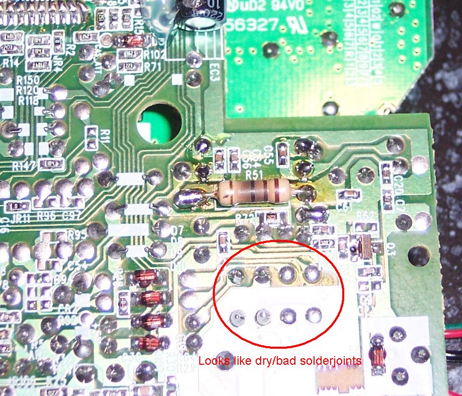

          Those look like dry solder joints (or there's just to much solder on them) which don't make an good connection to the PCB. I would add new solder to those pads.
