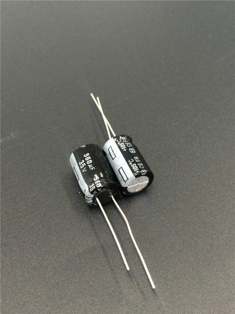

    10pcs - 560uF 35V 10x16mm Panasonic FR Low ESR 35V560uF Audio grade Capacitor
    555 uF
    544 uF
    542 uF
    528 uF
    508 uF
    497 uF
    489 uF
    484 uF

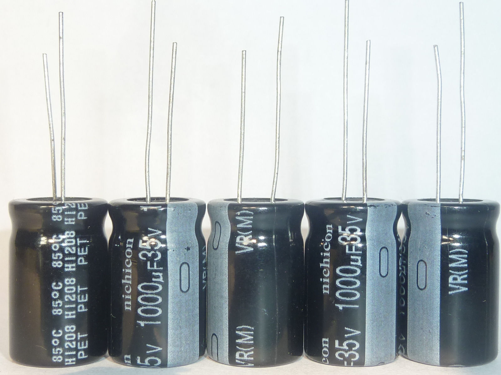

    5pcs - 1000uF 35V Nichicon VR 13x20mm 35V1000uF Electrolytic Capacitor
    1100 uF
    1091 uF
    1068 uF
    1054 uF
    1016 uF

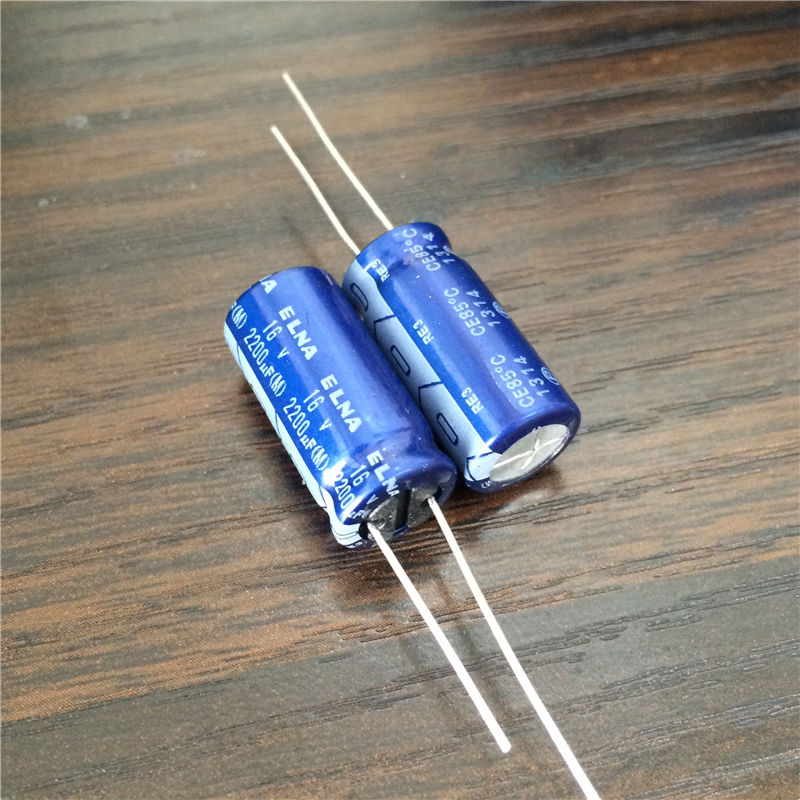

    10pcs -2200uF 16V Japan ELNA RE3 10x20mm 16V2200uF Audio Capacitor
    2300 uF
    2270 uF
    2240 uF
    2240 uF
    2190 uF
    2190 uF
    2150 uF
    2150 uF
    2130 uF
    2040 uF

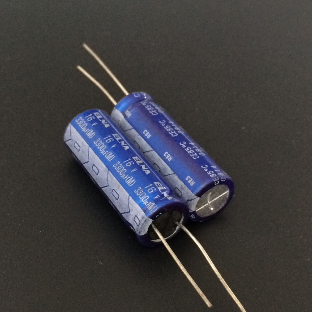

    10pcs -16V 3300uF 16V Japan ELNA RE3 10x30mm Audio Capacitor
    3280 uF
    3240 uF
    3230 uF
    3230 uF
    3220 uF
    3220 uF
    3210 uF
    3210 uF
    3190 uF
    3130 uF

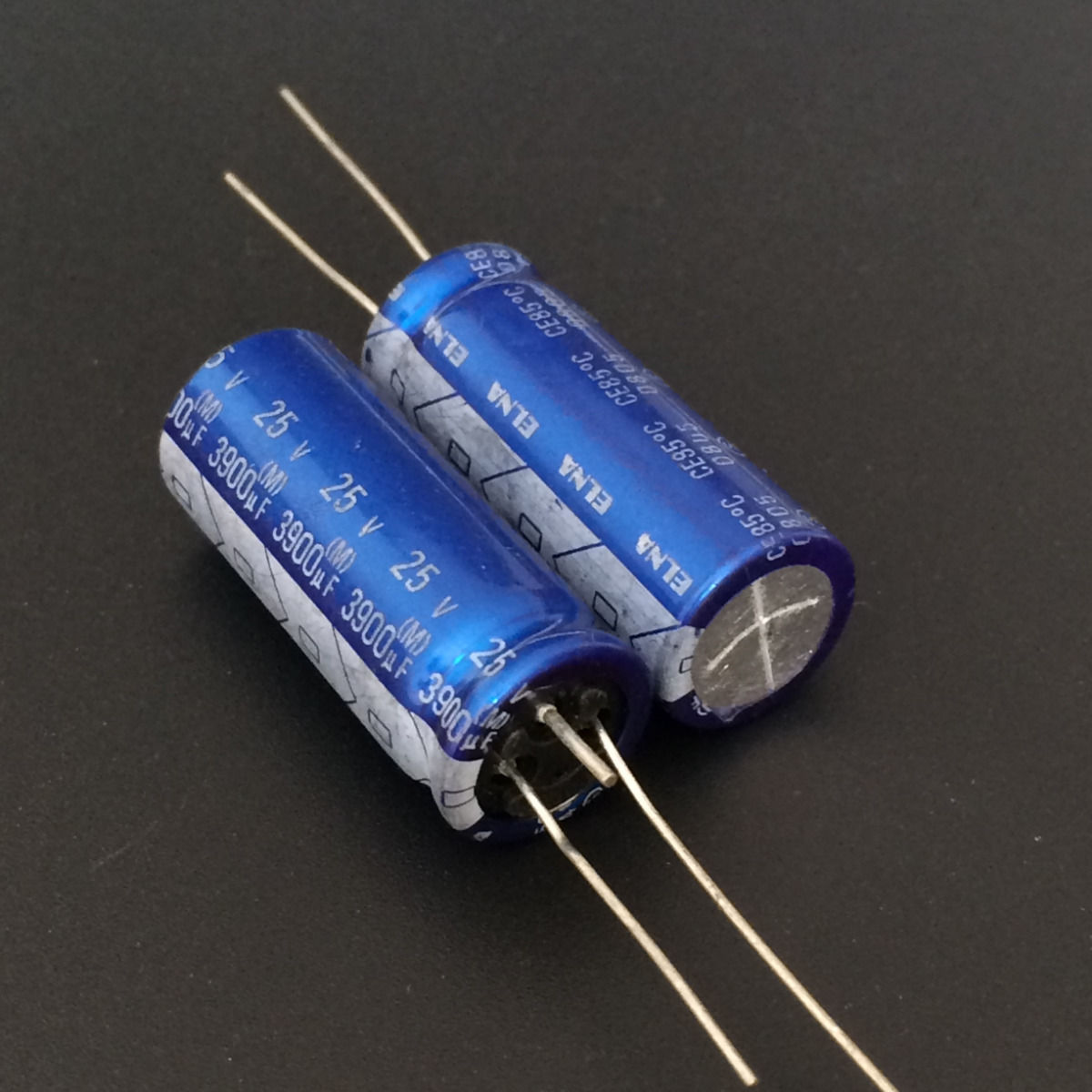

    5pcs -3900uF 25V 12.5x30mm 25V3900UF Japan ELNA top grade Audio Capacitor
    4170 uF
    4116 uF
    4110 uF
    4110 uF
    3570 uF

    the 560uf FR's are fake - the vent shoult NOT look like a cross.
    the print's wrong anyway.

      As stj mentioned, the Panasonic FR are fake. They should have a "T" like vent.
      The Nichicon's and ELNS's are rated at 85C. In a TV and power supply, you want 105C so they last longer.
      In your last picture, the ELNA cap has an extra lead sticking out?
      Overall, looking at your purchases, they look like fake/counterfeit and poor overall.
      Buy your caps from a reputable distributor like digikey or mouser. Avoid Ebay and aliepxress.
      Additionally, when buying low ESR caps like a Panasonic FR, it is the ESR value that is more important than the capacitance value. Capacitance value can be +/- 20% of its stated value.

        The ELNA cap is a audio capacitor, I shouldn't have bought that one so i'm assuming that is the reason for the extra lead.

            the elnas look real.
            the rest are fakes.
            its no surprise since you bought them on fakebay.
