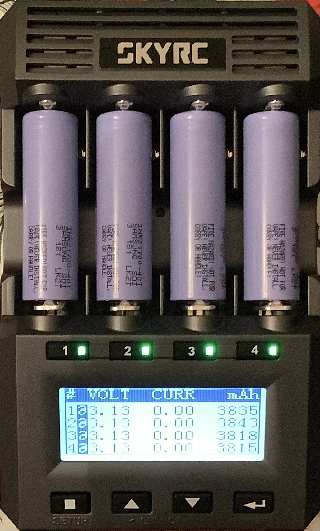

    I just bought this device that came in the mail today I put a set of 4 brand new 21700 high current battery on the charger
    The charger has four individual temperature sensors for each battery cell
    The bar graph for each individual battery cell is very primitive but will give you a good idea of how each battery cell is preforming and I find something odd I put on the individual battery testing machine that gives more details of the charging/discharging curves but it will be quicker to just charge and discharge battery cells that do not have any issues
    Or test battery cells that you do not know anything about this gives you a way to pre scan the battery cells to weed out batteries that have issues with out having to babysit them
    The 18650 battery store where I bought the high current tool type batteries from they had a review about this battery testing machine so I decided to try it out and see if it will work better for me than the SkyRc IMAX b6 battery tester that can only do one battery at a time with the temperature sensor so this will work a lot better for me now

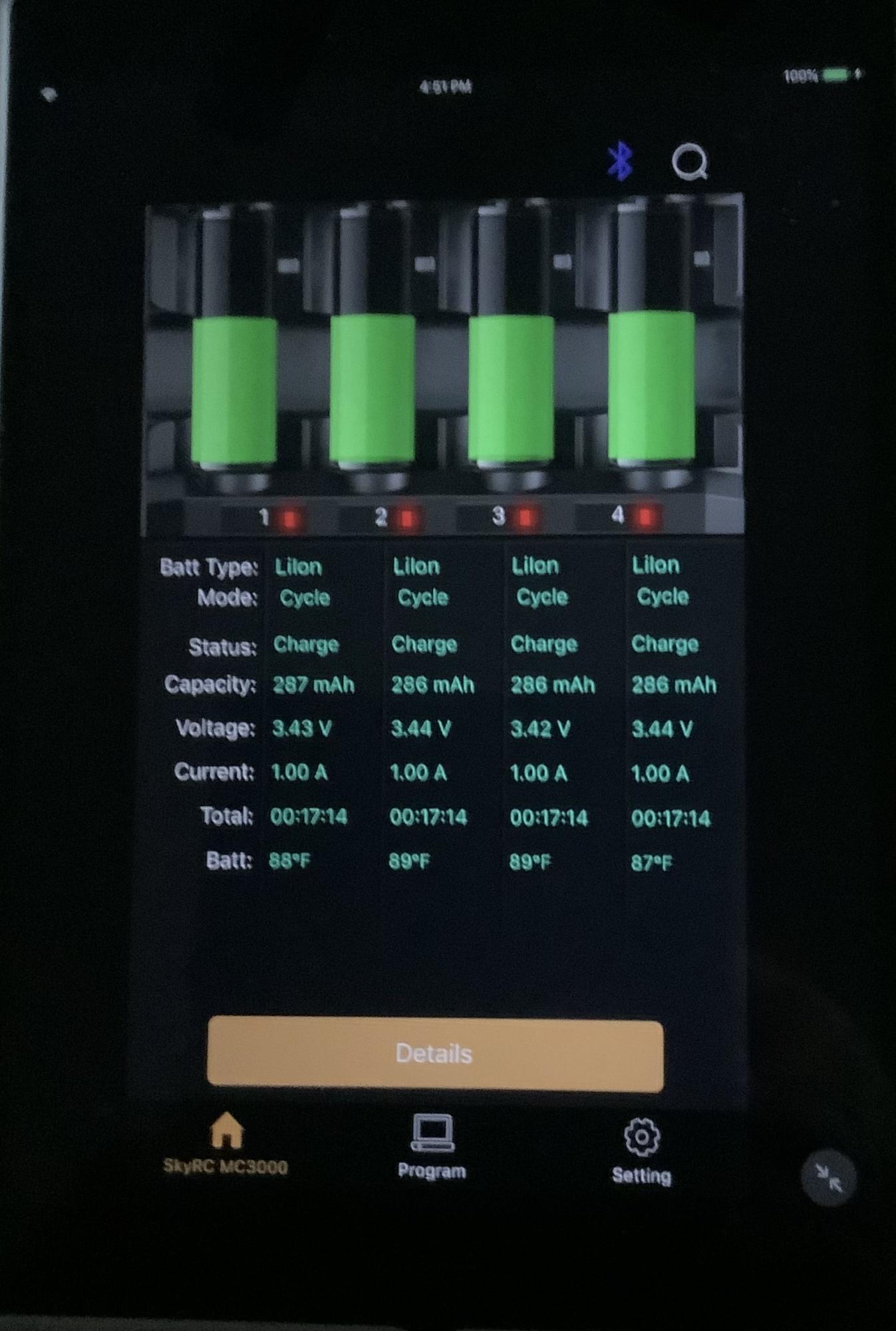

      Re: I just bought a SkyRc MC3000 battery testing machine very interesting device temp
      Yes it can and that what I was referring to that it very primitive graphics not much details but only because of the size of temple and the way the graph is setup I used my iPad to view the graphics I will post what it looks like sometime today or tomorrow
      But it does not look like you can start and stop the charger but I do not know for sure if that is the case only because I just want to see how the application was setup and if showing each battery cell temperature or not one thing that is nice about the application is that it shows you the internal resistance of each battery cell as well a very nice feature
      The other SkyRc also had this feature but you had to go to another screen to see it so I did not use it very much to most of the time not at all

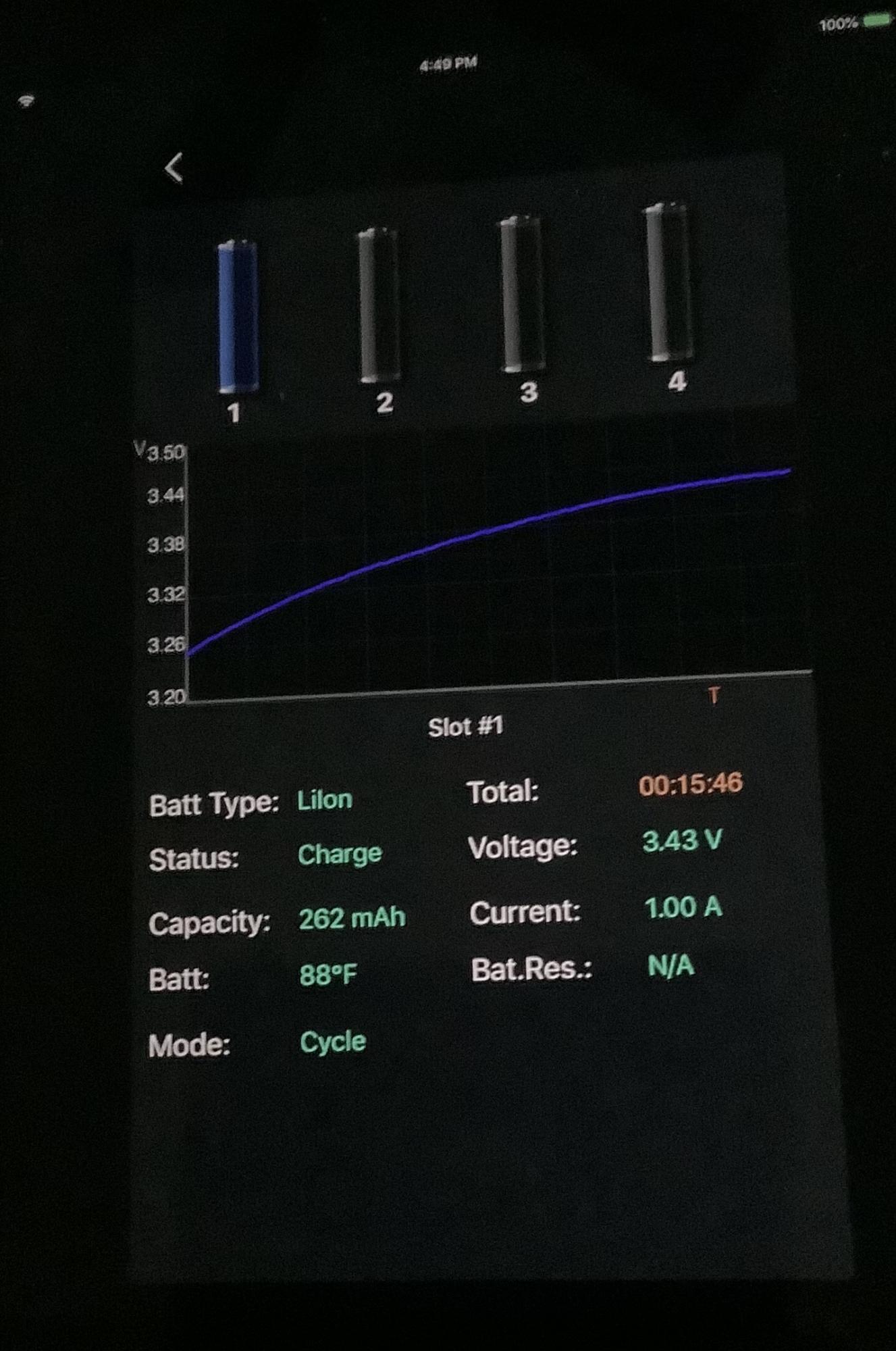

          I have changed my mind about just how primitive this graphic application really is I was just going to storage charger them when I was watching the being of the charging cycle the charging curves were all over the place between individual battery cells so I am going to cycle them one more time and see if this situation will be better
          The graduations in mil volts is what is lacking in this application but it is very useful for spotting issues with the charging/discharging cycling curves which is what I was looking for in a battery testing machine
          If I want a closer look at just how bad a charging/discharging curve is then I will use the other battery testing machine for more accurate look at this situation
          One note I started with storage mode was when I saw all the charging curves all over the place so I stopped the mode and when to the cycling mode
          One more note the battery resistance measurement is when you first start charging mode the first time then when you do the discharge mode after that it shows N/A after this not an issue
          Charge once and discharge once then when to storage mode then when to cycle mode
          Overall I very impressed with this battery testing machine from SkyRc for a 4 bay battery testing machine

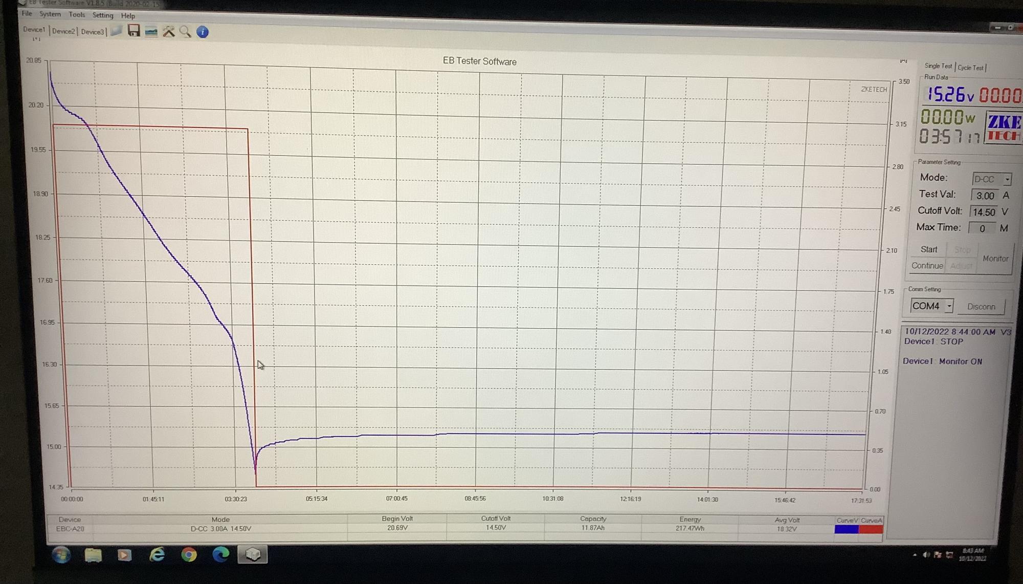

                            Update on the battery testing that I was doing for the replacement battery packs for the Milwaukee M18 battery packs I finally finished one battery pack I did a three amp load test gave 10 amps hours at about 16.7 volts before the voltage drops rapidly the batteries are rated for 4 amp hour but my testing showed more like 3799 to 3899 at 1 amp load on individual battery cells with a voltage cutoff at 3 volts
                            This is not bad for tool battery cells at $4.35 each
                              • Jul 2011
                              • 6070
                              So the average battery voltage roll off 3.4something this is decent results for an average

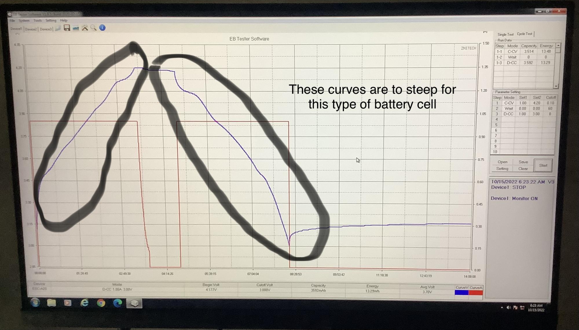

                                Well I tested one of the old battery cells from the unbalanced battery pack and the results are not very good
                                The other problem with the old cells are a self discharge rate is to fast about a month some of the battery cells voltage were at 3.4 volt with battery pack not used other than activating the fuel gauge LED lights
                                The voltage range was from 3.4 to 4.0 volts
                                I will do the same battery testing on a new battery cell that I bought just recently for the Milwaukee battery packs
                                Now you would think that having a 94.5 remaining useable life on a battery would good if the self discharge rate would not be so high
                                I will still use these batteries but will put the batteries that have a high discharge rate all together so the battery pack will be more balanced than what it was

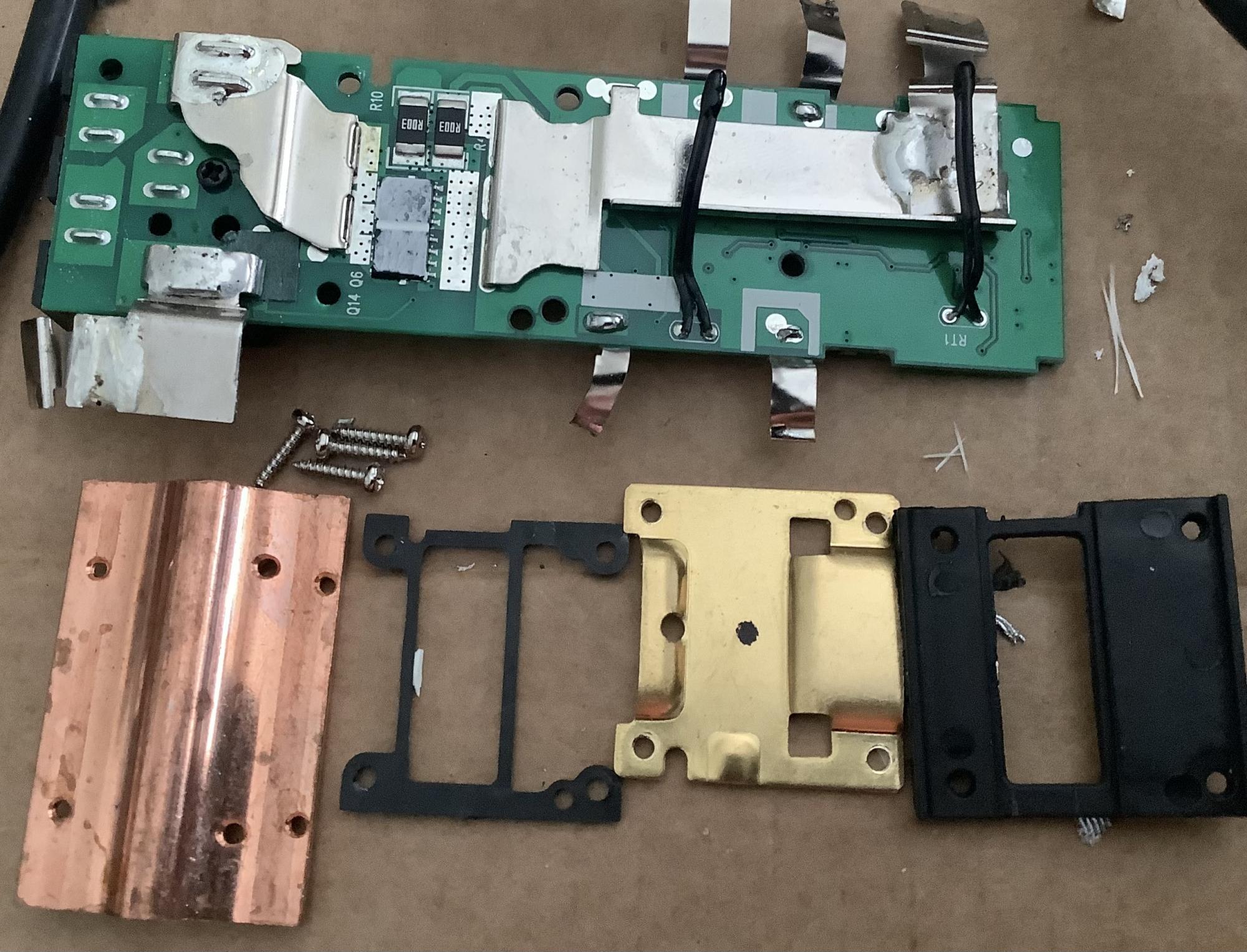

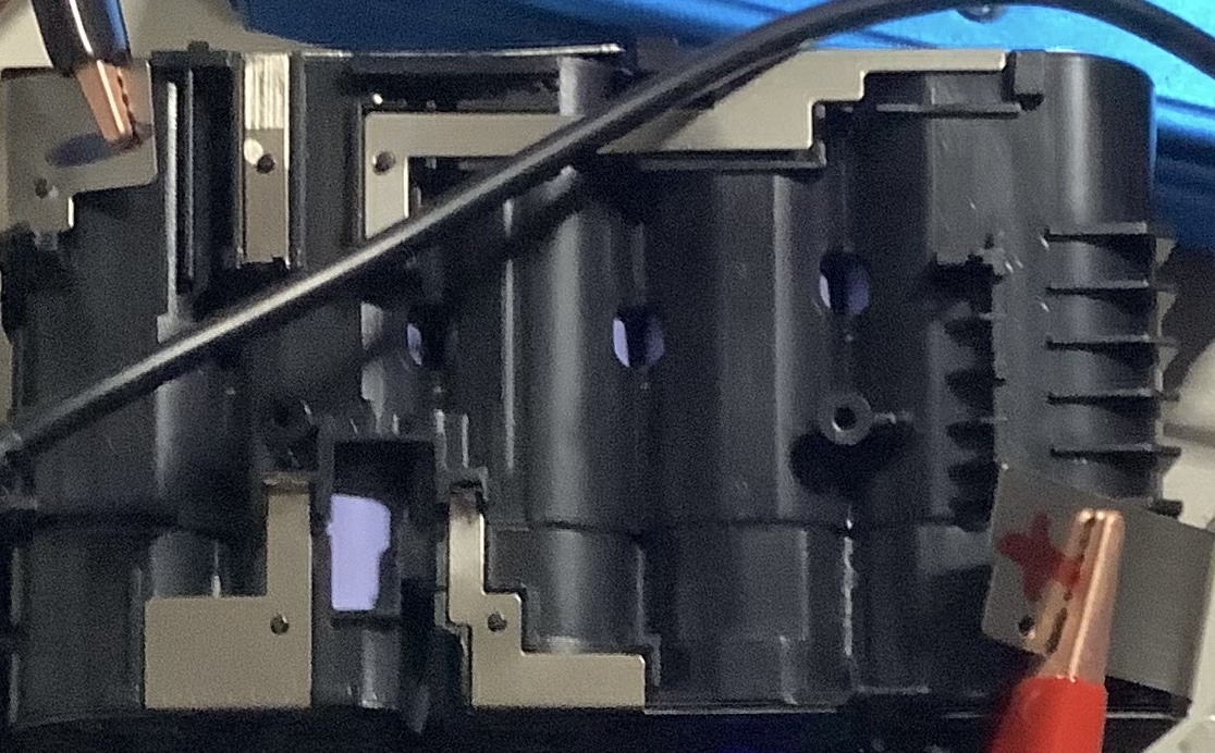

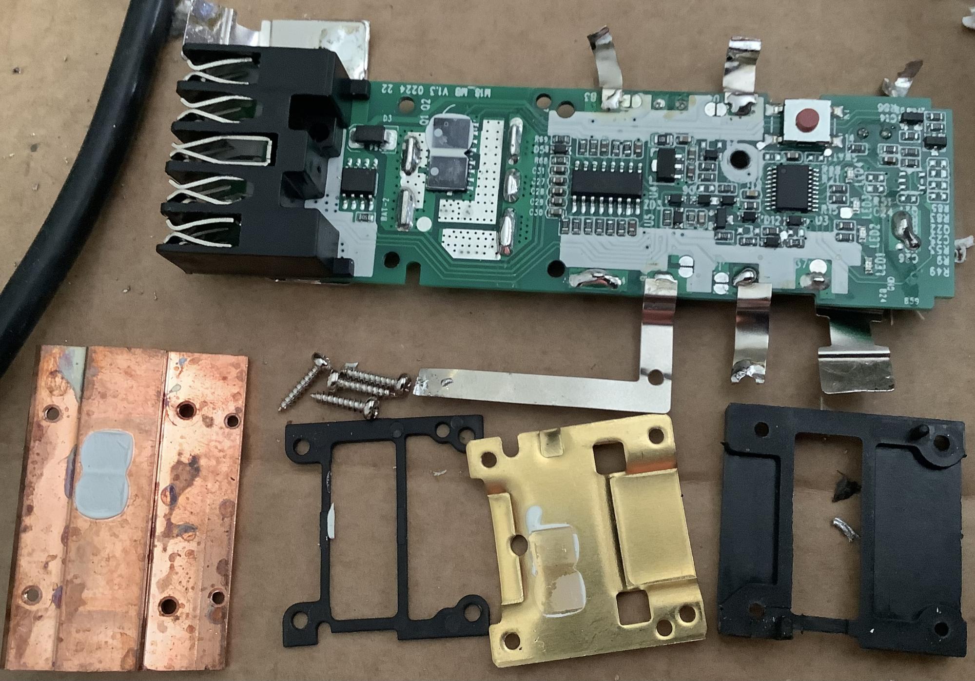

                                  Here are the pictures of the BMS protection board that came in Milwaukee battery repair kit that does not work correctly here is what is under the two heat sinks

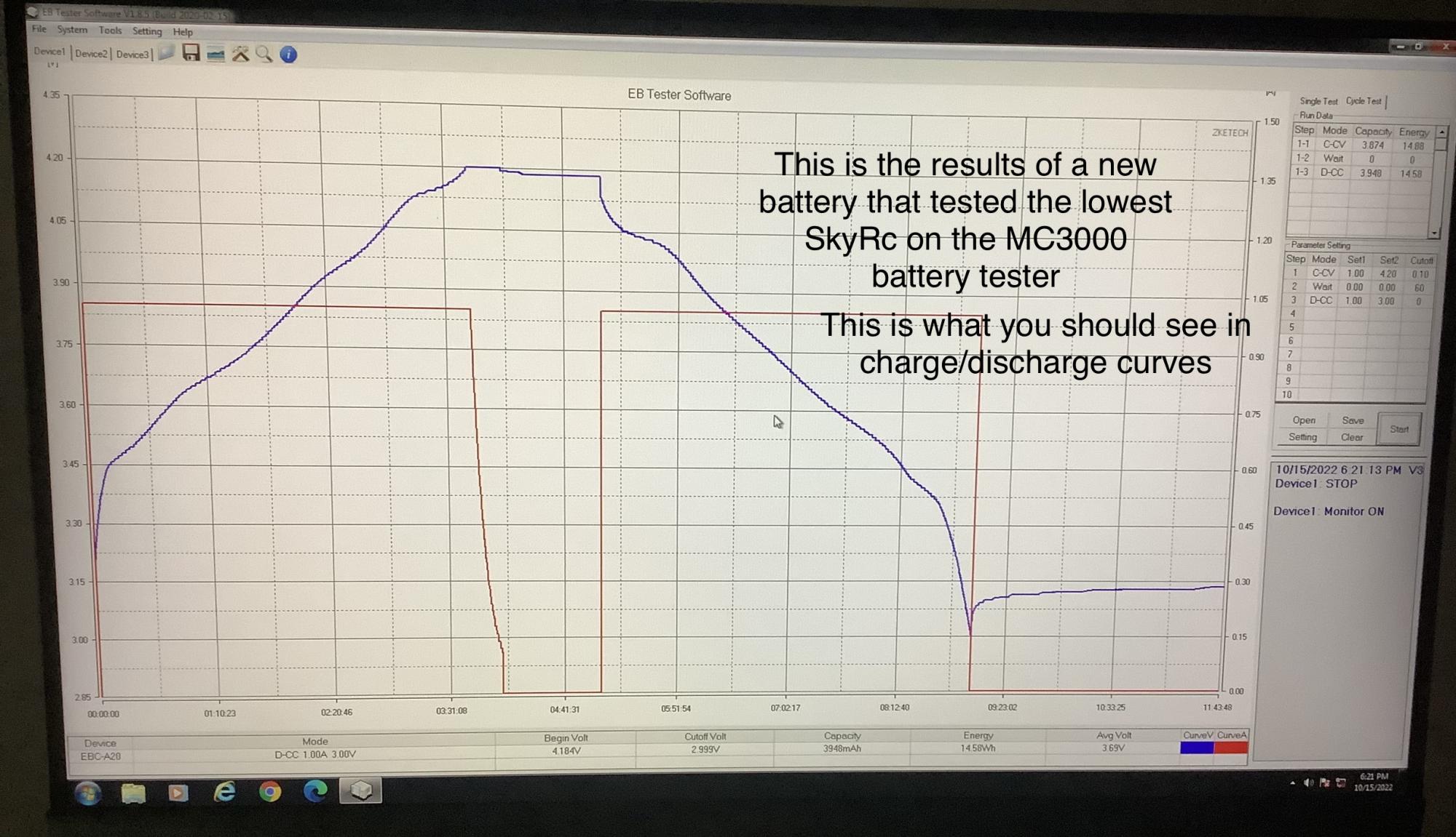

                                    Here is the results of a new 21700 battery versus the old 21700 battery that was in the Milwaukee battery pack
                                    Yes they are still useable but not for high current applications that they would be if they were not having this issue with dropping so fast
                                    Mind you you that this is at one amp not 3 to 5 amps for a grinder with a load

                                      AliExpress has gotten back with on my dispute about the BMS protection board issue and they do not give you enough picture space or information space to fully document the issue and what you have done and how you did what you did
                                      So let see what happens next with AliExpress and this dispute if they refunded any money for these BMS protection boards that do not work correctly
