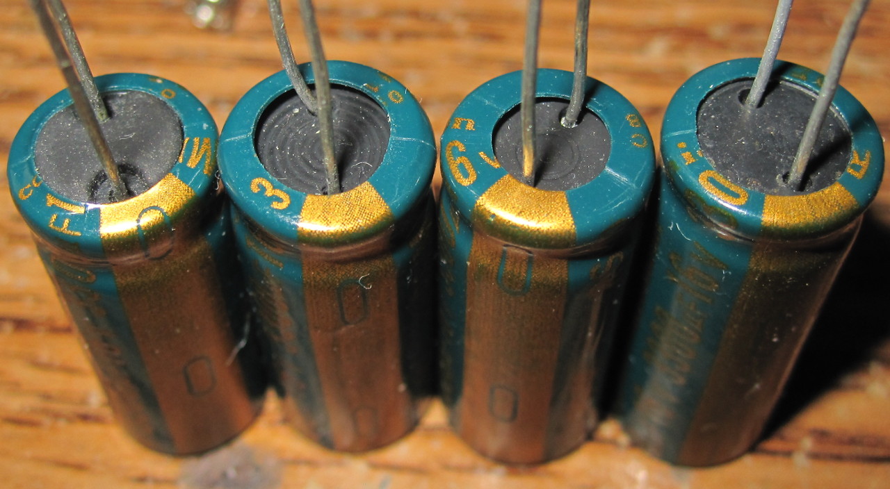

    Fake Nichicons
    I ended up getting a whole batch of fake Nichicons. I recently found out there were at least 4 different manufacturers thrown into the batch of fakes based on the bungs and the top patterns. I think one of the fake sources is Teapo (three lines and dots) but the others have a simple cross on the top vent.
    I noticed "type 3" - the third from the left - had no way in hell in surviving anything above about 10 volts. I don't know about the other ones but suspect they all have the same problem. These are all rated 3300uF 16V and a fake RS(M) written on them.
    "Type 4" - the one on the right (or fourth from left) looks like a Teapo but I don't know what Teapo bungs look like for sure. It measured 2200uF so that one's really wrong.
    I got a refund for them (and did not have to return this trash) after pointing it out so I guess I'm not too upset but finding it interesting...
    In the other thread where I bloated/exploded two of them, these were "type 3".

      Re: Fake Nichicons
      No this was a China source. I kind of assumed these were phony to begin with but expected them to "work" at least for a short while as I wanted to use them as test caps (like what I did). However these are not even acceptable at all!
      I'm planning to do at least a partial recap (mainly the X caps and a few of the analog PSU filter caps) of my Tektronix 2440 and going to be ordering from Mouser.
      BTW, I noticed my crap NTE capacitors (probably Teapo as well?) look like "Type 4".
      I had a spare "jwco" crap cap and the bung/vent seems to match "Type 2".

          Re: Fake Nichicons
          Yeah, I would imagine the vent and the seal bung would still match the original manufacturer. From vague pictures I saw on the web it indeed looks like a Teapo.
          Incidentally I don't know why I haven't come across a blown Teapo yet. Mostly Fuhjyyu's for me.
          I think whoever did these Nichicons are even worse than NTE. At least NTE tried to make it work for some applications. This counterfeiter seems to have made it work for NO applications!
          (though I'd like to try my 470uF 35V NTEs that I have on a PSU to see if I can see the same behavior. Alas my Sencore only has a 25 and then 50V range.)
