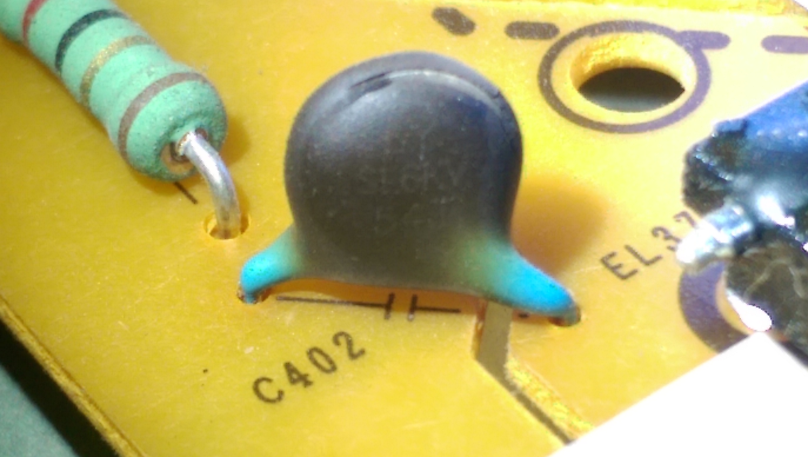

    Hey guys new here trying to fix an LG model 42ld520-ud found a bad capacitor. I need to find a replacment but can't find one. From what I can read on it says ly s1.6kv 54j my father downloaded the schematic and it claims to be a 100uf 16v however I can't find one anywhere or even if that's correct any help would be amazing thanks.
    http://imgur.com/Z0DNfRh
    http://imgur.com/jO3guC9

      After I looked at your picture links, I don't think your original cap is an aluminum electrolytic capacitor. It looks like a tantalum capacitor. You should confirm that. If that is the case, check out the choices on the following link.
      http://www.mouser.com/Passive-Compon...z0x565Z1z0x63t
      You really need to identify that caps specs so you can get a good replacement match.
      Regards
      PS - That could also be a ceramic cap. Does your documentation indicate the type of cap? You should download the LG Service Manual for that TV and look to see if the Service Manual gives a more complete description of that caps' specs.

        I Google'd that part number and I suspect that's a ceramic cap.
        Check the cap closely and see if it should read: LY SL6KV 54J.
        If that's the case, I don't think that's a 100 uF 16V cap.
        It might be something like a 54 pF 6000 V 5% Tolerance High Voltage Ceramic Cap.
        If that's the case, then the cap on the link below would likely be a good replacement.
        Murata 56 pF 6300 VDC 5% Tolerance High Voltage Ceramic Cap, Murata Part # DEC1X3J560JC4B
        http://www.mouser.com/ProductDetail/...llgYhaXQ%3d%3d
        You've got to inspect that cap carefully and get the inscription correct.
        Then you should look up that cap inscription and reconcile the cap specs with what you seen in the schematic.
        What is the caps part number on the schematic? Did you correctly match the cap with the one in the schematic? Are you looking at the correct board in the schematic? I don't think the cap pictures and cap inscription match a 100 uF 16 V cap.

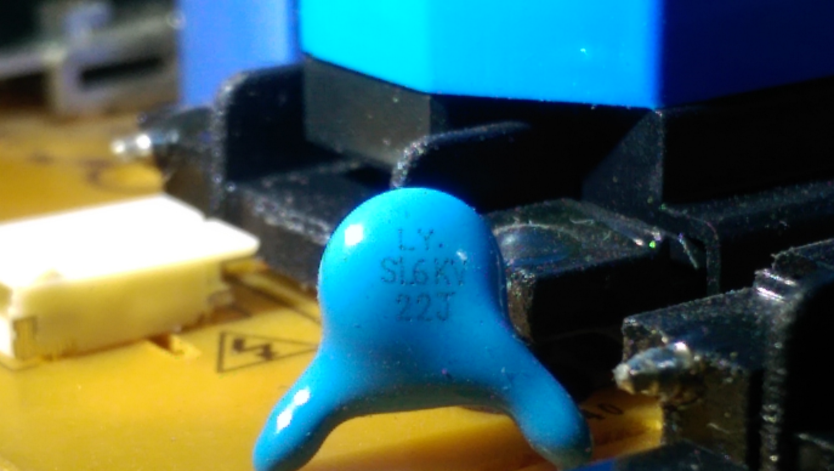

            I downloaded the manual from link you provided it does show that 402 and 401 are the same however I'm positive the burnt cap is diffrent is it possible that the writ cap was installed ? Here is a picture of cap 401. Thanks for the replys I'm just lost lol .
            http://imgur.com/VPD1Bb3

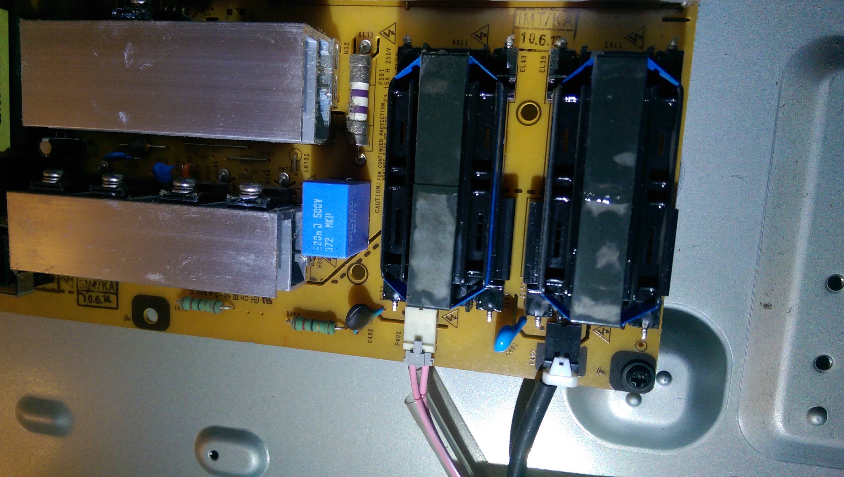

              Looking at this power supply inverter online the c402 cap spears to be bigger then c401.isn't that weird considering there supposidly the same caps on the schematic. I'm so confused bahhh.

                  From comparing the two pictures of caps C401 and C402, and from my current understanding of their label, I think the installed caps are different. C401 appears to be a 22 pF 6000 V 5% Tolerance High Voltage Capacitor.
                  The downloaded Service Manual does have a different Model Number suffix. But, I wouldn't think that it would be that different from your posted Model Number TV.
                  This cap replacement requires more research to resolve the discrepancy and assumptions.
                    Post the link of what you are seeing online.
                    The downloaded Service Manual indicates they are the same specs, but your pictures seem to indicate that the installed caps are different specs.

                            The picture of C401 looks like LY.S1.6KV22J. If that's the case and my understanding of that cap number system, C401 would be a 22 pF 1600 V 5% Tolerance High Voltage Cap.

                                      Can I see the bottom side of the board around those two caps and the whole top side and bottom side of the board? Then I can tell if the two caps are the same value or not.
                                      One of them may be Ballast cap and another one may be output tuning cap so they will not be the same value.
