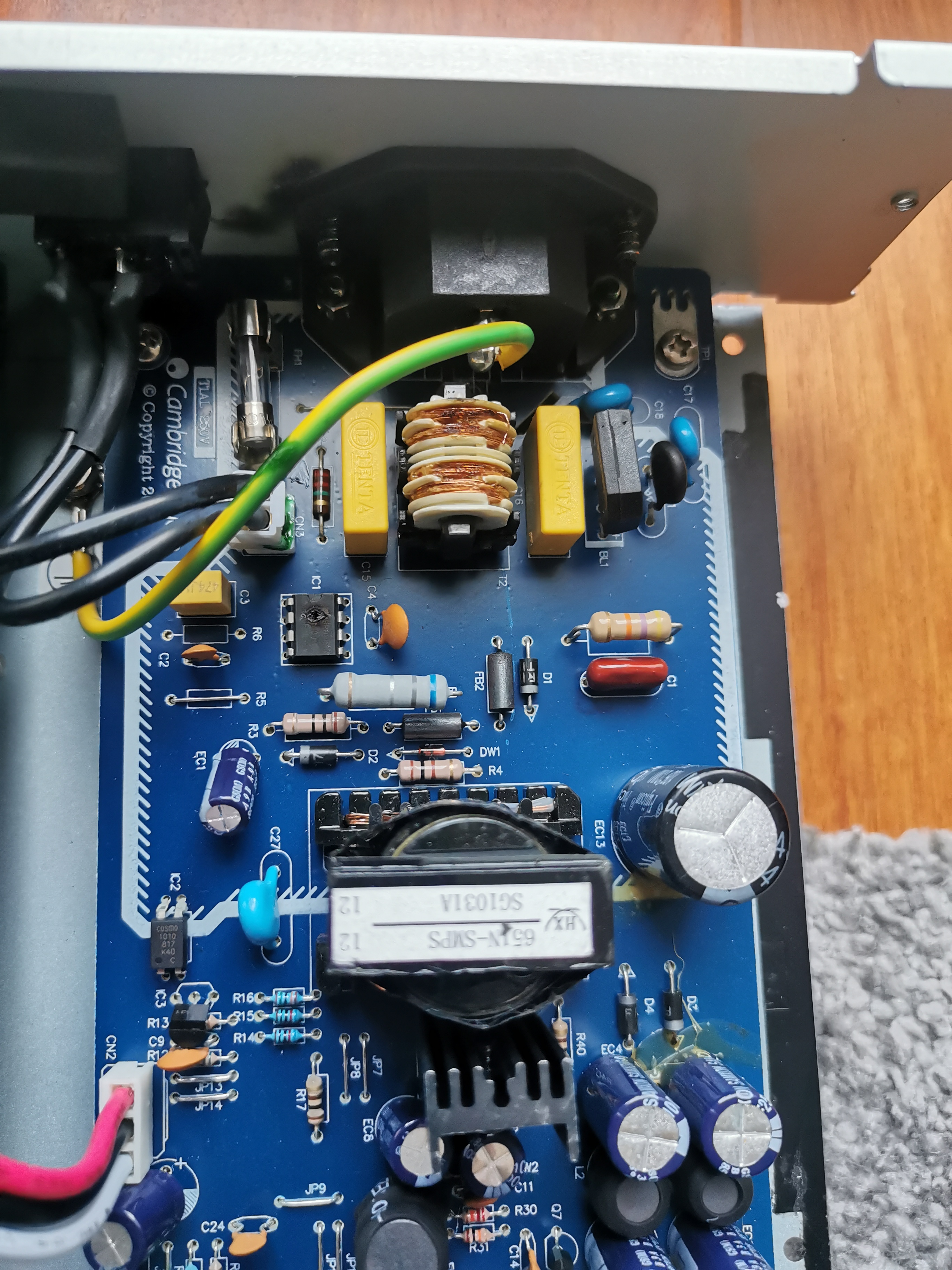

    I have here a Cambbridge Audio Stream Magic 6 which does not power on.
    When opening the case the PSU appears to be faulty:
    Click image for larger version  Name:	str_mgc_psu_01.jpg Views:	0 Size:	2.79 MB ID:	3532660

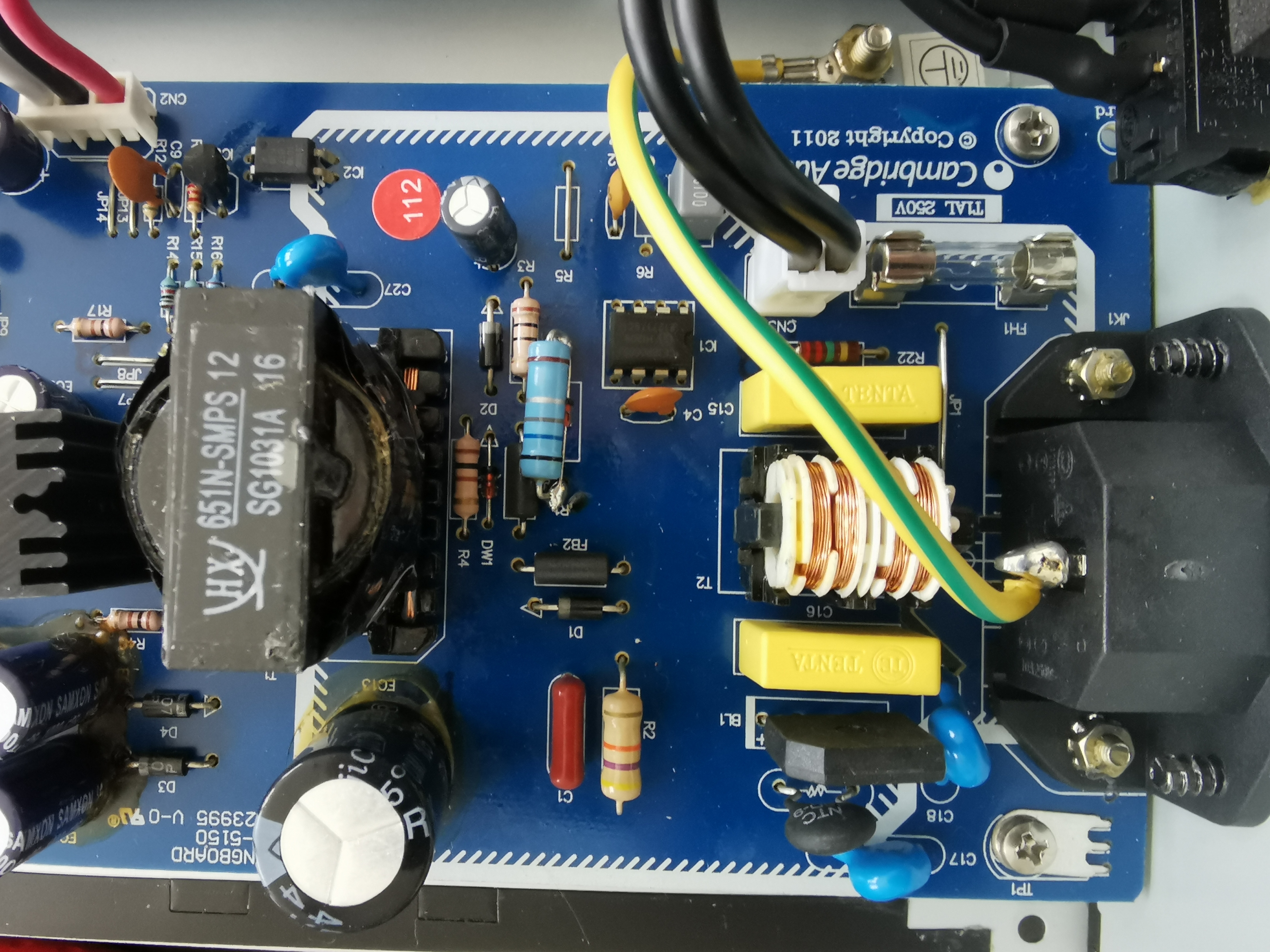

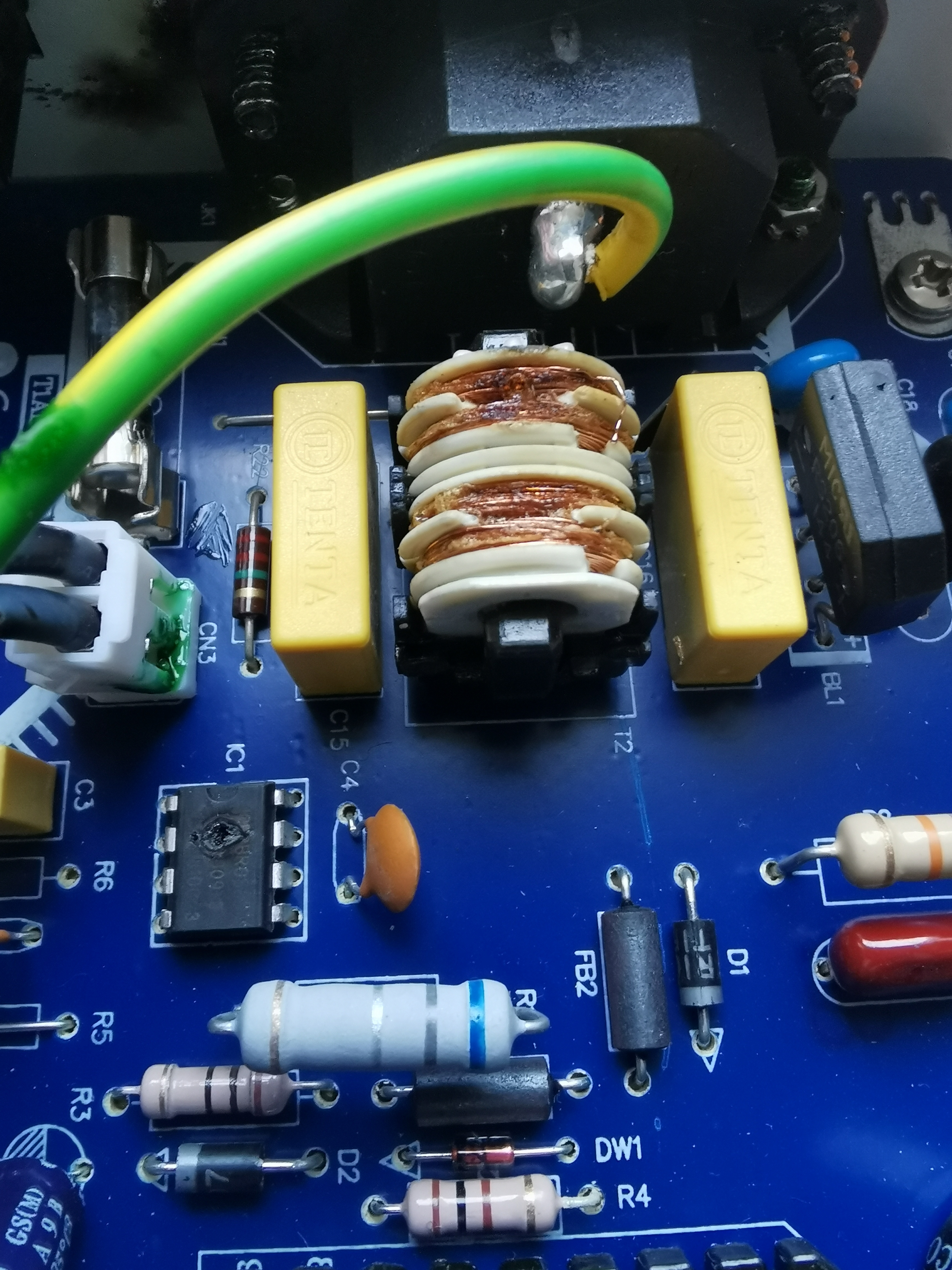

    IC1 (ICE3BR0665J), D2, the rectifier bridge, C15,C16 are dead and T2 is fried:
    Click image for larger version  Name:	str_mgc_psu_02.jpg Views:	0 Size:	3.90 MB ID:	3532658
    I found the schematics of the PSU in the cambridge Audio CXN Service guide which uses the same:
    My problem is that I cannot find any info on T2 (SG01323) which seems to be a choke. Anyone knows how I can find a replacement & the value of that choke ?

    T2 is likely a ET20/UT20 emi input inductor it may be over heated but should still work at least for testing. Remove the ic from the circuit then check C15,C16 and the bridge.

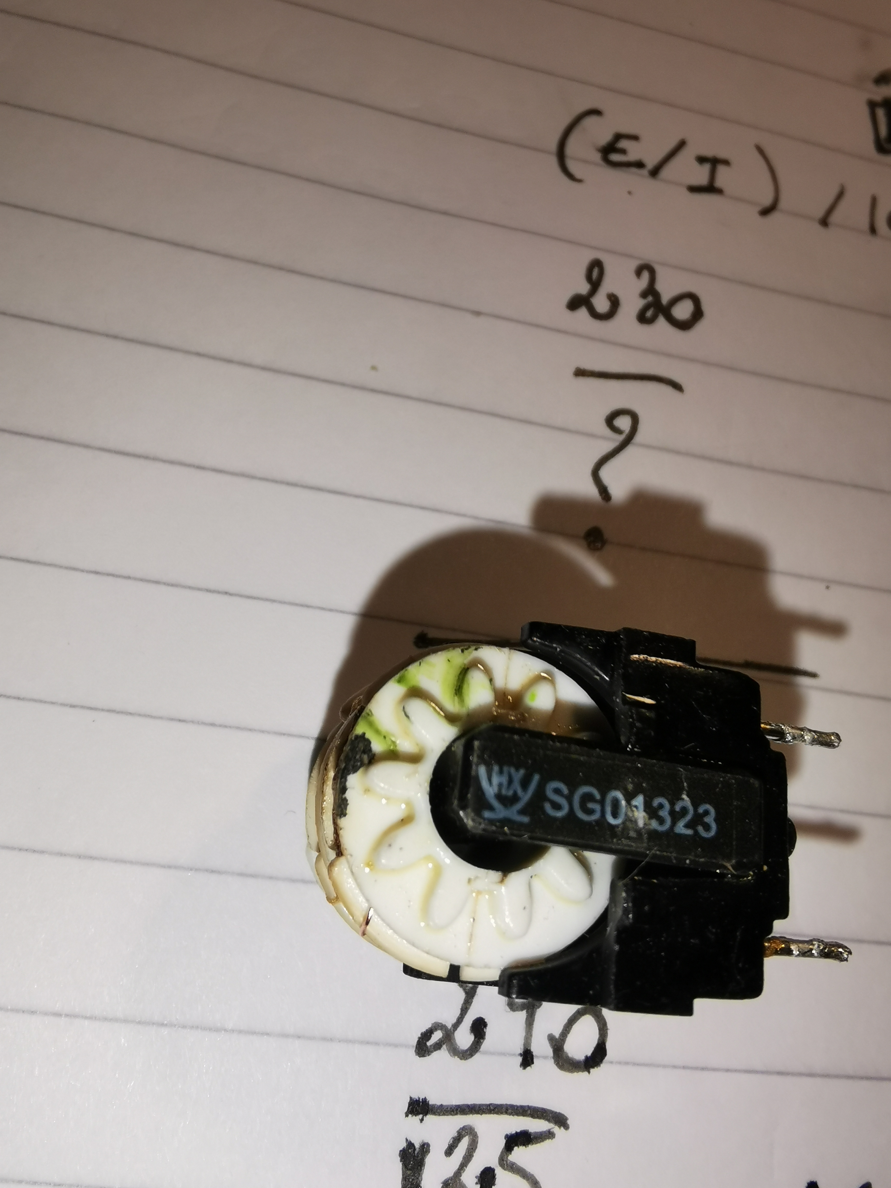

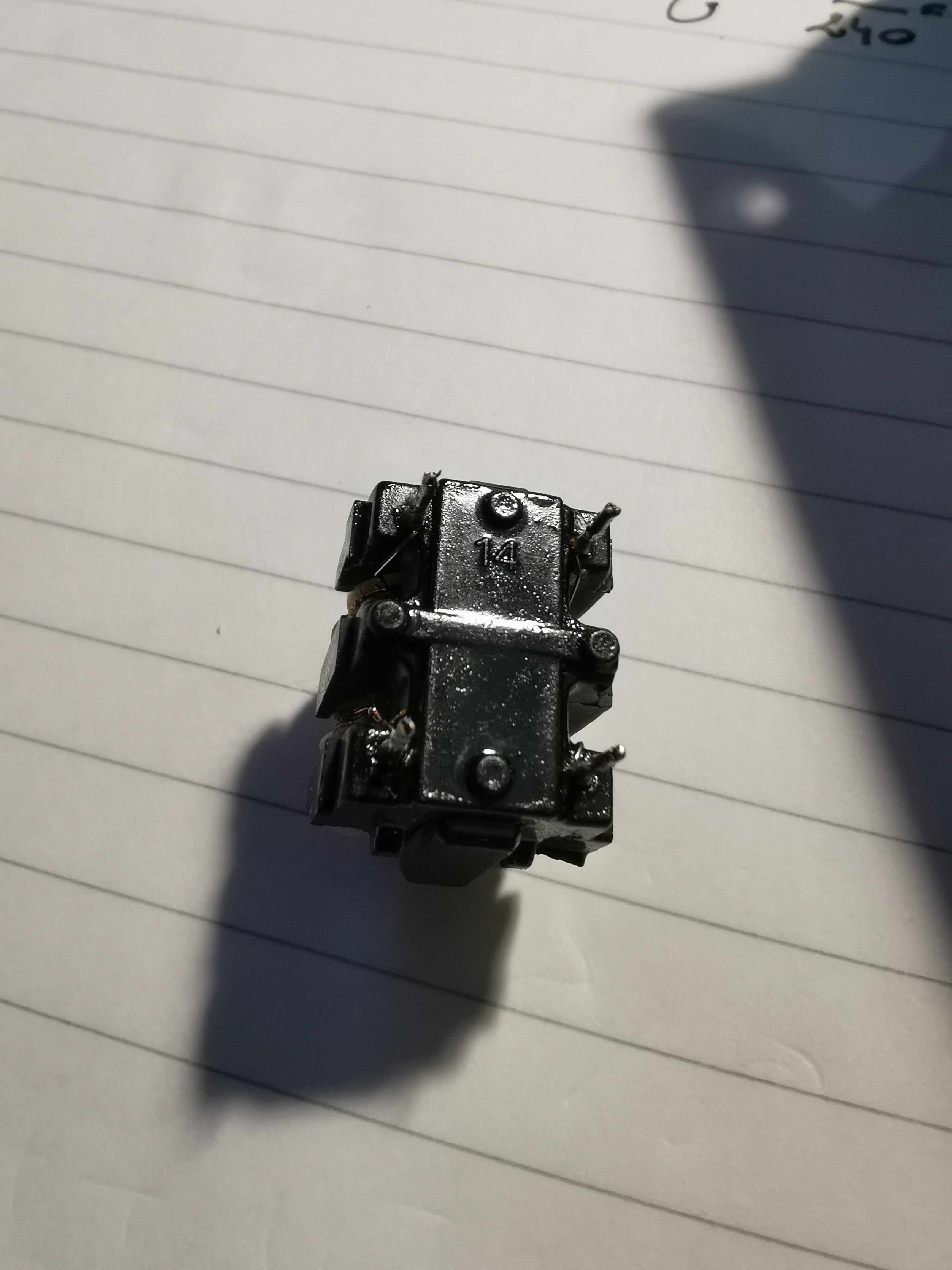

          I unsoldered the inductor, it has written on the side HX SG01323 and under it '14'
ID:	3533213 Click image for larger version
          I could not find anywhere a data sheet on SG01323...

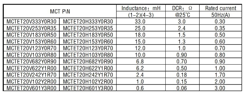

                search for ET20/UT20 .
                ok but what value of ET20 (how many mH ?) ?

                  All the filter does is prevent some of the unit's smps noise from going back onto the ac line. pick 10 mH or maybe 6.2mH to get the higher current rating, I would not be concerned about the input choke until you have the rest of the unit working. If the coils are open, just install jumper wires in place of the windings to test the amp.
