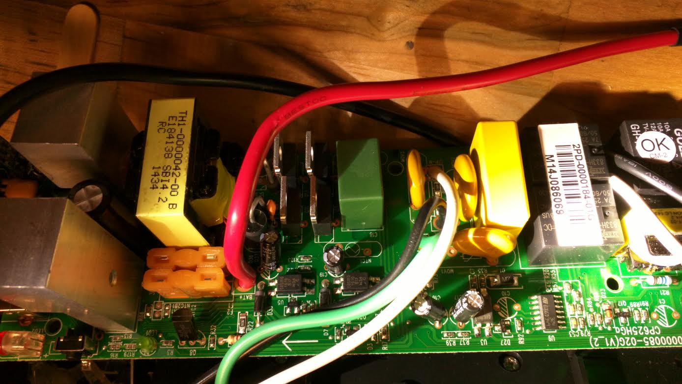

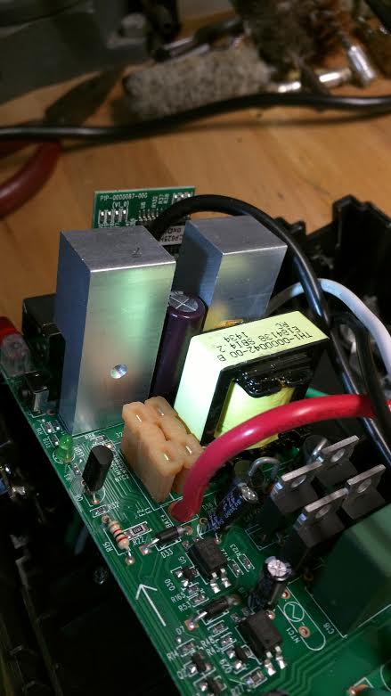

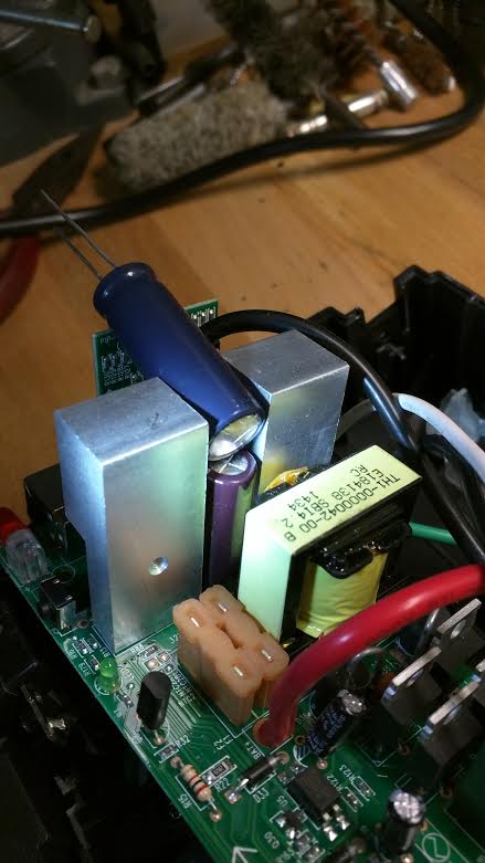

    I opened up a Cyberpower 550VA UPS. It uses all Suscon capacitors, apparently. The biggest one is a 3300uf 16v 10mm cap that looks to be about 50mm high. It's situated between two heat sinks. I think I can get a 12.5mm cap in there as a replacement but it would wedge tight against the heat sinks. Opinions?

    no - unless you can put some heatshrink on it first to act as a protective insulator.

      No problem. Those HS only get hot when on battery, otherwise they are inert. For charging it has different circuitry (stand-by supply). This cap filters its output.
