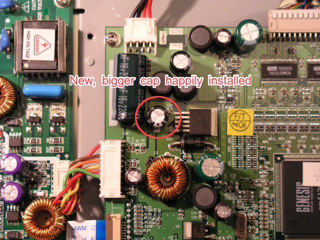

I have a vp171b 17 in LCD monitor that has a problem with the backlight, it randomly turns off. I know it is just the backlight because if I shine a flashlight on it, the image is still there. I took the monitor apart and found a bunch of 100uF caps by taicon and 2 25uF by hermei. None of them or bulged or leaking in any way though. My question is, do you think that the problem could be caused by a bad cap that is shorting out when warm or after it has been in use for a while, or do you think it's something else. On my capacitance tester, it showed most of the caps at around 83uF, so I wonder if that is too much tolerance.
Also, if the caps are the problem would you choose panasonic FC or nichicon HE. I have both brands available to me. Thanks

When I turn the monitor on, it works fine for a couple of minutes and then the backlight shuts off (Heat Related?). If I power cycle the monitor, the backlight will turn on for about 2 seconds and then shut off. If I do this enough times (for about 15 minutes), it will start to stay on, and will work perfectly for hours. I replaced all the caps according to the instructions above, and if someone wants a pic, I guess I can take the monitor back apart and get some now. If anyone has any idea what the next area I should troubleshoot is, let me know. I'm fairly sure it's not the CCFL's, as they dont have many hours on them.
