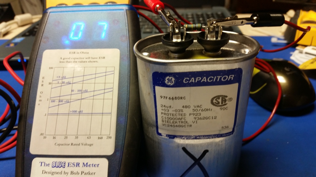

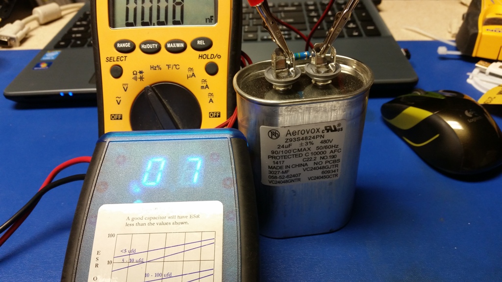

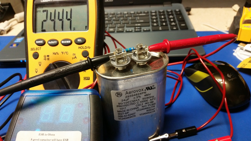

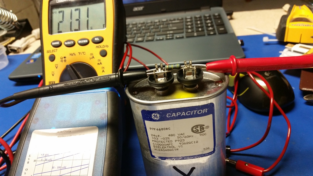

            I brought home 2 caps today from work, a new Aerovox 24uF 480V AC cap and a 1997 bad cap which is also 24uF 480V AC. These caps are used in a 1000Watt metal halide light fixture. The cap is wired in series from the output of the ballast to the center contact of the lampholder.
            The caps are oil-filled wet caps with a bleeder resistor across the pins. Tolerance is +/- 3%, leaving a minimum of 23.28uF. Due to DMM calibration differences, we replace anything at or below 23uF. Aerovox publishes expected life at 60,000 hours. The site lighting where these are installed is dated to 1998, so the lighting has an estimated 63k hours at 10 hours per night since 1998.
            The ESR rating between the new and bad caps is the same at .07, measured with a freshly calibrated Anatek Blue ESR meter. Personally, I don't think the ESR matters as much as the capacitance in HID fixtures.
            The first 2 pics are the new capacitor and the last 2 are the bad cap.
