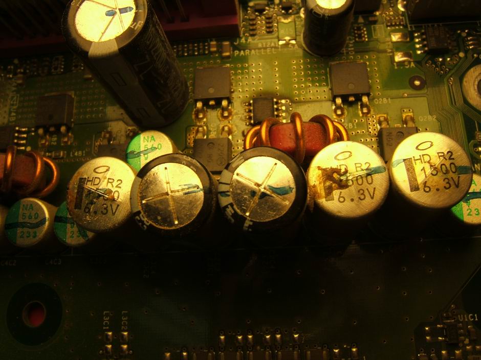

Help identifying these caps?

    Who makes these caps?

    Re: Help identifying these caps?
    need a better pic.
    they might be some sort of polymer.
      I don't have the board, but I puled the pic from here-->
      http://www.bit-tech.net/content_imag.../ext-led-8.jpg
        May be Capsun or Samwha. But i haven`t seen the exact logo there.
        http://capacitor.web.fc2.com/
            good find!
            useful even with all the unreadable scribble.
                Time will tell us, but i would not expect a fully blown quality control and stringent raw material testing as may be from the well known & more expensive big players in the field.
                On the other hand, i think they may have learned their lesson and take the opportunity to improve their overall production habits.
                Any way, it think they should at least outlast any electrolytic cap and thus are probably perfectly fine for SOHO IT equipment.
                But on a expensive, high end board, i would want to have something better, e.g. Oscon.
                        From the logo printed on the case, it's Ost's polymer cap.
                              hmmm ost polymer death watch anyone?
                              if this is your mobo you are now the official badcaps.net ost polymer guinea pig.
                              we will be expecting a full report ;-)
                                      Certainly not, but if they would be from a good brand, i think there would be more than one reply.
                                      And meimei_liu seems to be confident on this part.
                                      I think if they aren`t Ost it probably could only be worser. We have had a topic here, where a Asian government paid research project was mentioned, to enable their cap manufacturer to supply the next generation cheapi polymer caps.
                                      Theoretically, anyone of those people could probably start a polymer capacitor production.
                                      May be the logo was derived from the Capsun logo, which is very similar.

                                        I say nay to OST. I searched through their products for a narrow logo and found a Quartz Crystal. OST's narrow logo is a T on an O.
                                        I have a circle logo that could just as easily be OST and mine have brown goo . The two caps in the center are Rubycon 3300uf 6.3v HM.
