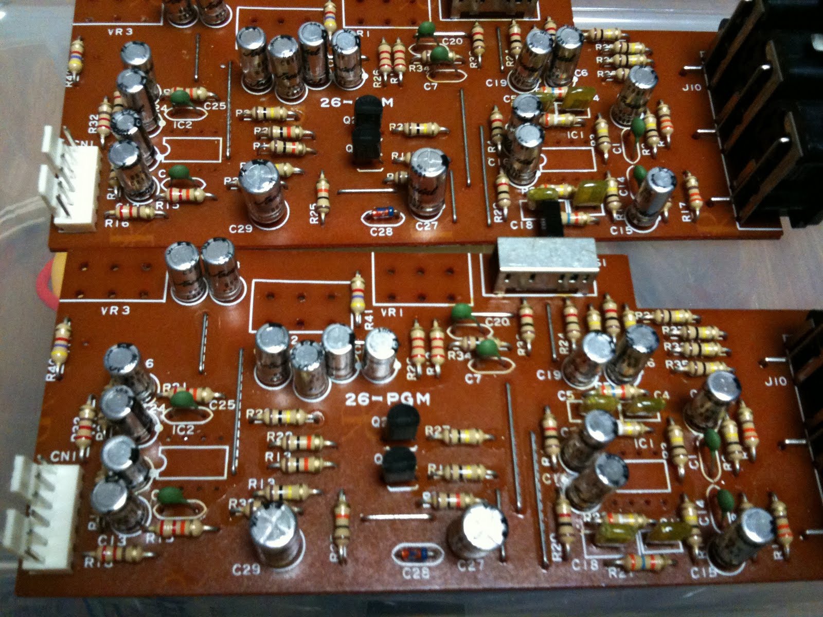

Re: Need help identifying cap.
if you could take a closer pic of the capacitor it would be appreciated i just can't see the name sorry
however the green capacitor looks like a nichicon audio filter capacitor
Need help identifying cap.
Re: Need help identifying cap.
am i supposed to see a foto?
because i cant.Leave a comment:
Need help identifying cap.
Can someone please help me identifying these "silver" colored electrolytic capacitors?
I can read "Jo" and "ail", but I don't know what brand can be... I think they are Japanese capacitors, and of good quality, huh?
Thank you, guys
Best regards,Tags: None
by HondamanI ordered a Japanese book, it will never be published in English. A Mr. Fujumoto was a Japanese sushi chef who became a cook for Kim Jong-Il. He was not perceived as a threat to the dictator's power, so he became very close to the dictator. Apparently, the dictator is QUITE hedonistic, with a lot of debauchery. Although he can spend as much as $700,000 per year on alcoholic beverages and this alcohol is NOT actually the highest quality. Also, the dictator has 24 palaces. One of them is as large as TEN YANKEE STADIUMS PUT TOGETHER. Are they all that large?
Does anyone have experience...-
Channel: General Computer & Tech Discussion
I have an MSI 3PA1 monitor on my bench that wont power on. I have tested the 2 (what I believe to be Schottky Diodes) and both are shorted in both directions (a common faulty from what I can see on Google) but I'm not certain what the markings on the Diodes mean so I need some help in identifying which ones to order from Mouser please?
I've done a search for 101C 5100C and all I can find are datasheets for 5100C which say they are 20-100V 5A Schottky Diodes but I'm not 100% sure if this is correct or not and what significance the 101C is.
We... -
by KhojaHello friends, I have a Lenovo Ideapad Flex 5 14IAU7 laptop that doesn’t turn on. When I opened it, I found a burnt resistor on the motherboard. Since I couldn’t find a schematic for this model, I need help identifying the parameters of this resistor.
- Model: Lenovo Ideapad Flex 5 14IAU7
- SN: PW0AZK3W
- Motherboard: LC57-IAU MB 213062-1M 448.0RH09.001M
Any assistance would be greatly appreciated!...1 Photo09-19-2025, 09:56 AM -
Hello! I am looking for help with identifying this tcon chip on KOORUI 24E4 monitor.
Driver board number: pn238ct01-3-xc-2
Other IC on the driver board: NT71265MFG-001
Channel: Troubleshooting Computer Displays
Good morning, I would appreciate help identifying resistors responsible probably for volume down / volume up buttons that I accidently knocked off while replacing fan connector. I enclose picture with location. Thank you for help in advance.1 Photo07-19-2025, 01:49 AM
- Loading...
- No more items.
Leave a comment:
