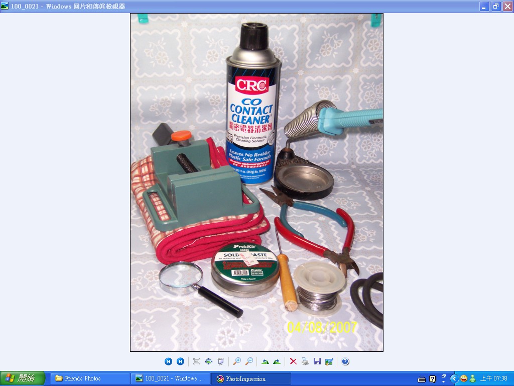

                        Dear Friend,
                        A good 40 watts iron is OK. The tip of the hot iron touches only the holes but not any part of the printed circuit. It is not a must to remove all the old solder in the holes. For the tools and instruments, please see the photos.

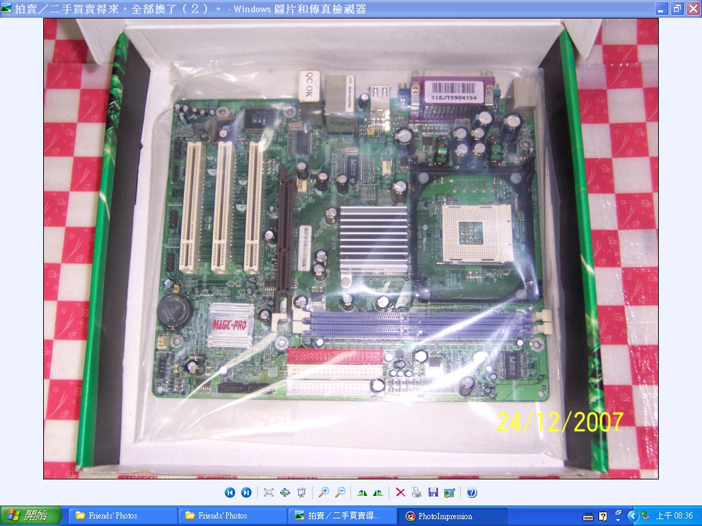

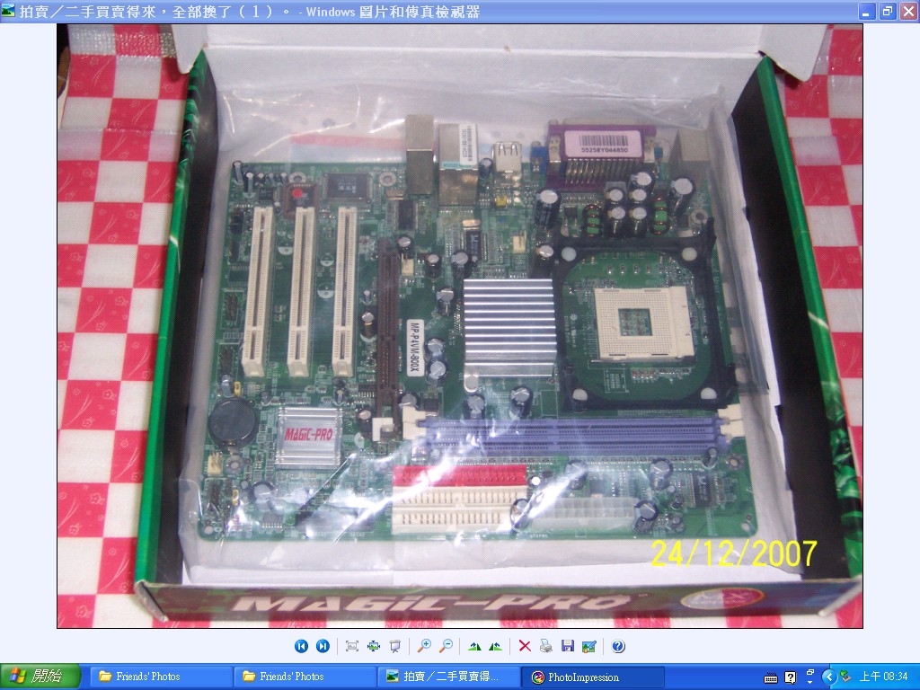

                          Dear Friend,
                          I have 3 motherboards of this model. The capacitors of all of them have been successfully replaced. These are two of them (after replacement).
                            Re: Thinking of doing my first recap
                            Dear Friends,
                            The two above-mentioned motherboards. Thank you for your teaching!
