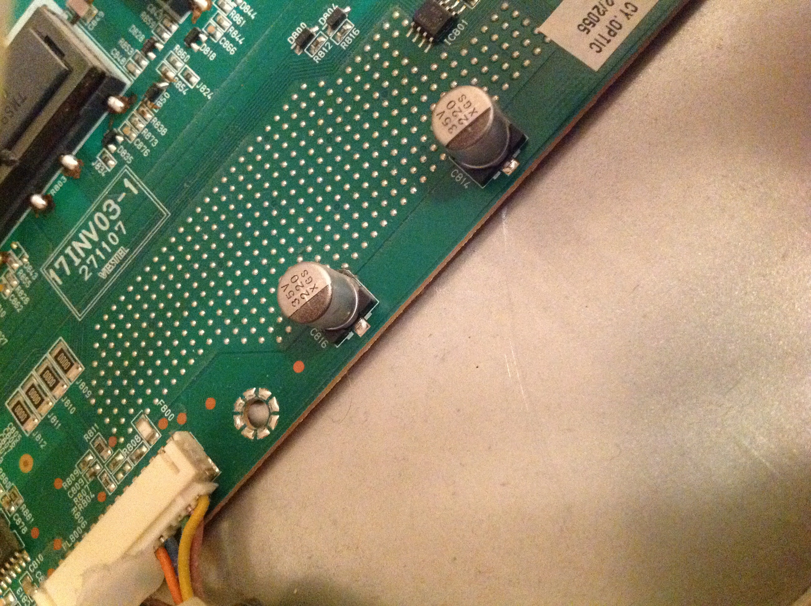

    What brand are these caps ?
    Here we have a vestel junker in today the inverter will try to start but will trigger a shutdown, I was able to by pass that shutdown and get the inverter to start but the lamps would flicker and burn dim, on close inspection the capacitors on the input are bulging and are probably failed, jus wandering what brand and series are they, thank you.

    just use something very good like panasonic FR

      Dont worry got some on order

        Re: What brand are these caps ?
        Originally posted by ReeceyBurger123
        . . the capacitors on the input are bulging and are probably failed, jus wandering what brand and series are they, thank you.
        I'm wondering what brand these capacitors are also! Haven't found anything yet.
        Brown markings with voltage, capacitance, then series (doesn't look like date/lot code)?
            Just some cheap junks that have failed, are the ones you have failed as well ?
              Originally posted by selldoor
              is there meant to be a picture with that?
              Yes. See the first post in this topic by ReeceyBurger123.
              No. I don't have any of these capacitors. I was more curious as to the manufacturer of the capacitors shown in your photo.
                Probably something cheap like lelon or taicon, inverter was recapped and is working fine.
