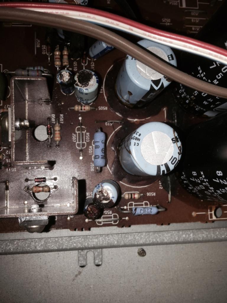

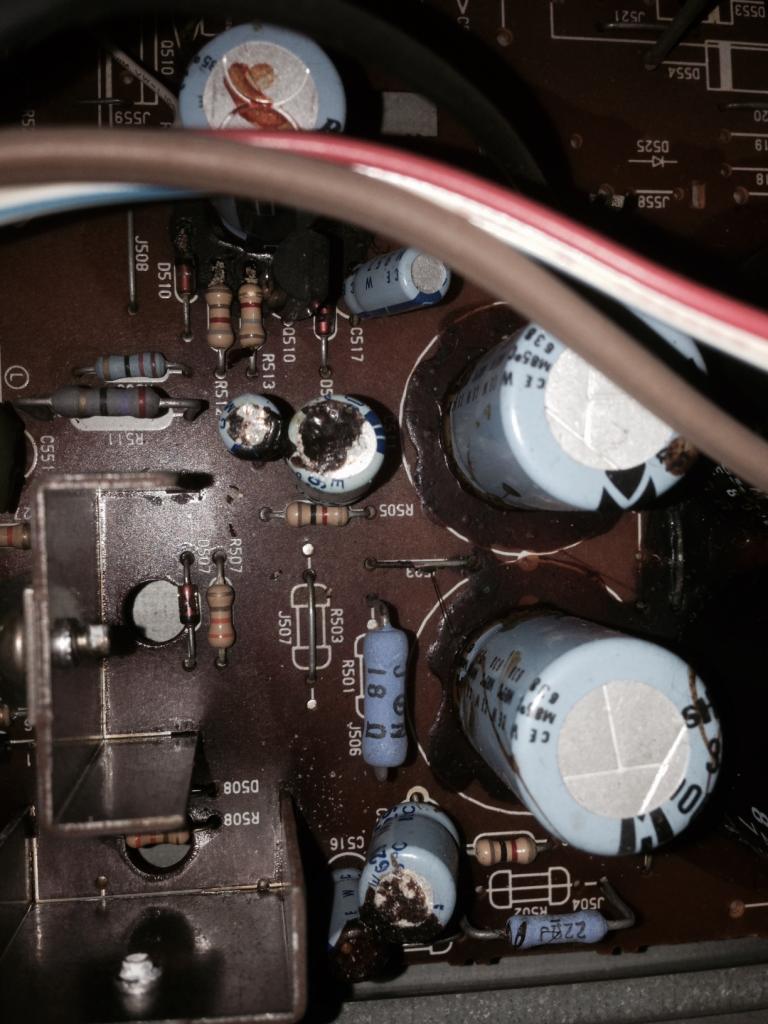

    Are all of these caps bad?
    It appears the smaller caps have a leak in the top?
    What is going on with the ooze on the bottom of the larger caps?
    Thanks!!

    sometimes the pressure forces out through the top stamp, other times it gets between the wire and the rubber bung - whatever gives first.
    i can say with pana FC's if you do overstress one, the bung will leak long before the top domes or bursts.

      Re: Are all of these caps bad?
      It is glue
        Yup. I'm pretty sure it's just glue.
          yay, i see foto's this time.
          yep, that's old glue - probably evostik or some variant.
            Why do they do that on them for ?
              probably to hold them down before the solder-wave machine does it's thing.
                That glue was a tan color when new. When it turn brown from heat, it gets conductive and
                Don't ask me how I know conductive glue in a power supply
                  how old is the device? if 5 years or older I always unsolder at least one to see what the reading is. I found a lot of junk caps that way. caps can go bad without any visible defects
                    Judging by the color of those caps and the board layout, it's at least 15 years old, if not more.
                      29 years old
                      Thanks for the responses all. I'll start to desolder them and take a look at their readings.
