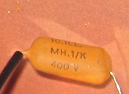

                                • eccerr0r
                                  Solder Sloth
                                  • Nov 2012
                                  • 8706
                                  Re: Old caps...
                                  Looks ceramic-ish but it couldn't be...
                                  ...could it?
                                  • goontron
                                    5000!
                                    • Dec 2011
                                    • 4108
                                    • US
                                    Re: Old caps...
                                    paper. seen them once before in a GE radio.
