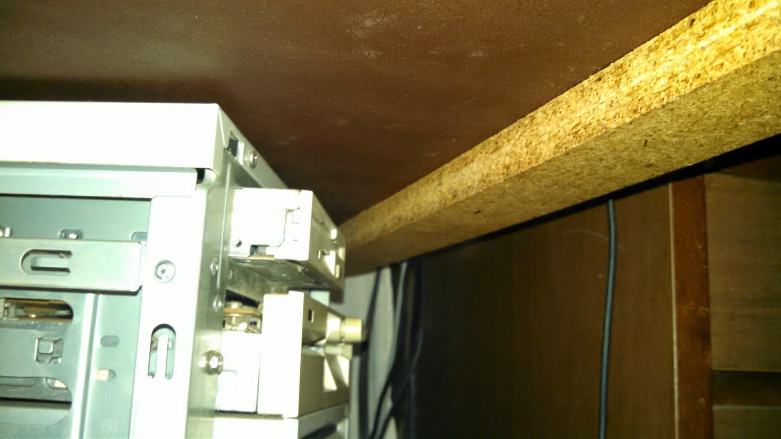

                    You can see why I want to replace all the caps as it's a pain in the you know where to get the case out from under the table which just has a scanner and printer on top so need something to hold the table up 3+ inches off the floor unless it is a good idea to unmount the motherboard with the case still standing up.
