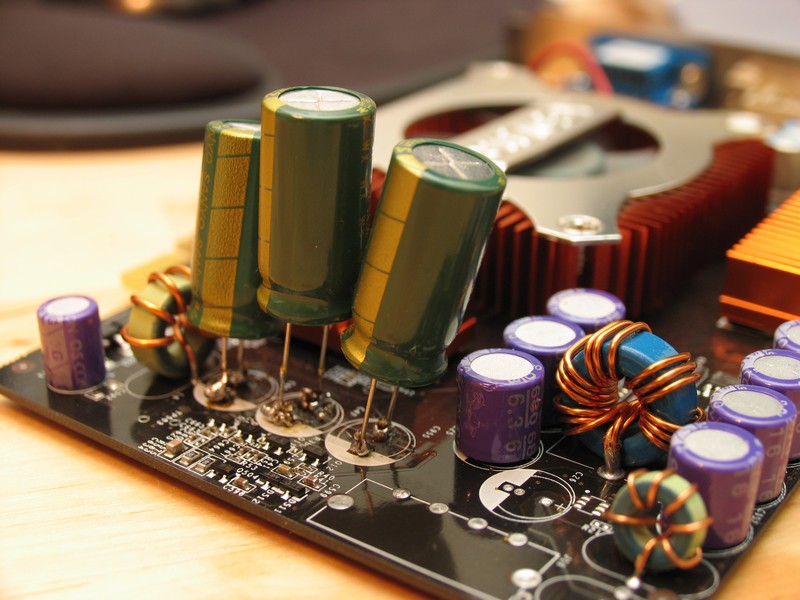

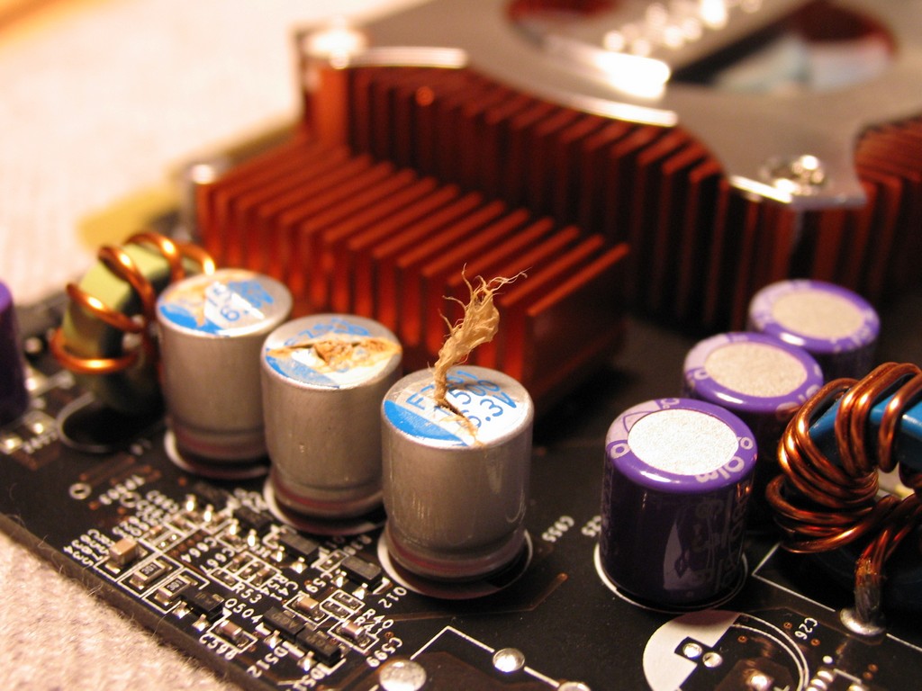

    Anyone seen like this before?
    I just found these hairy electrolyte caps on my video card, it's an AOpen Aeolus PCX6600GT-DV128.
    Anyone seen anything like this before? Is it probable that recapping will get the card working again?
    Thx,
    Ramón

    no i have not seen hairy lytics before so thanks for posting
    you have a good chance the card will work again. what other caps are on the card? i see some oscon which are probably ok so you only have to replace those 3 and any other from bad companies

      Looks like high-speed photography.

        Willawake, thanks for the response! I'll check out the other caps and start looking for replacements.
        Gastorgrab, what do you mean "looks like high-speed photography"? As soon I heard some crackling I drew up my camera and got this shot within 1/2000 of a second

          Looks like the one cap expelled some of its guts. I wonder whether that 6.3V cap was subjected to 12V, blowing up as a consequence. Maybe the VRM switch FET is shorted?

            Oooh the capacitor rope trick .

              Typical cost cutting. 3 Oscons and cut it and use 3 electrolytics instead of 6 Oscons

                3 crap electrolytics even

                  Maybe instead of using paper between the plates they used that twine it almost looks like seizel or however you spell it.
                  That stuff they weave those horrible sandpaper-like rugs from.

                    reminds me of the fibres hanging around when a cap blows up.

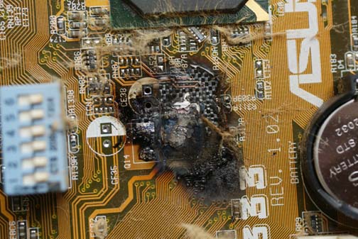

                      Did a mouse piss on it and blow it out? Did that crap get expelled from a cap on the mobo?

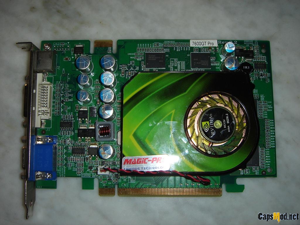

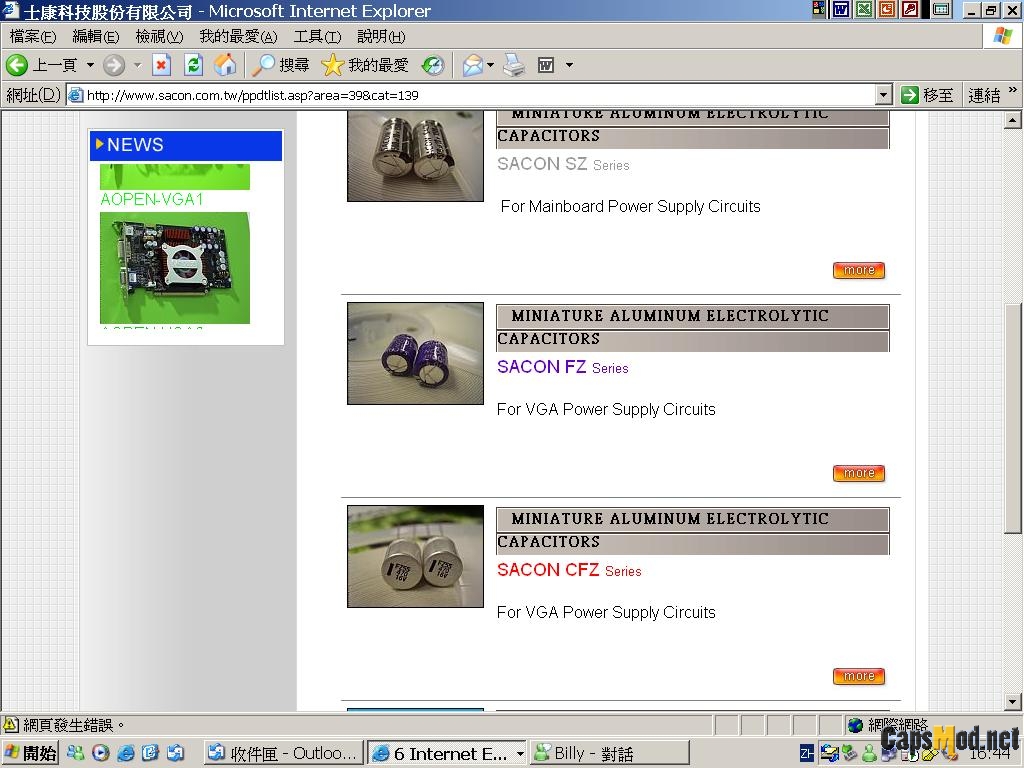

                        Same case for 7600GT Pro 256MB DDR3!! Crapped caps are SACON FZ series, http://www.sacon.com.tw/ppdtlist.asp?area=39&cat=139
                        It is works aftrer recapping for me.

                          Looks like it's easy for everyone else to recap their video cards, I can't even do anything on some old Chaintech video card, since the positive lead is stuck in there!
                          Looks like Chaintech put "anti-recapping" features on my old video card.
