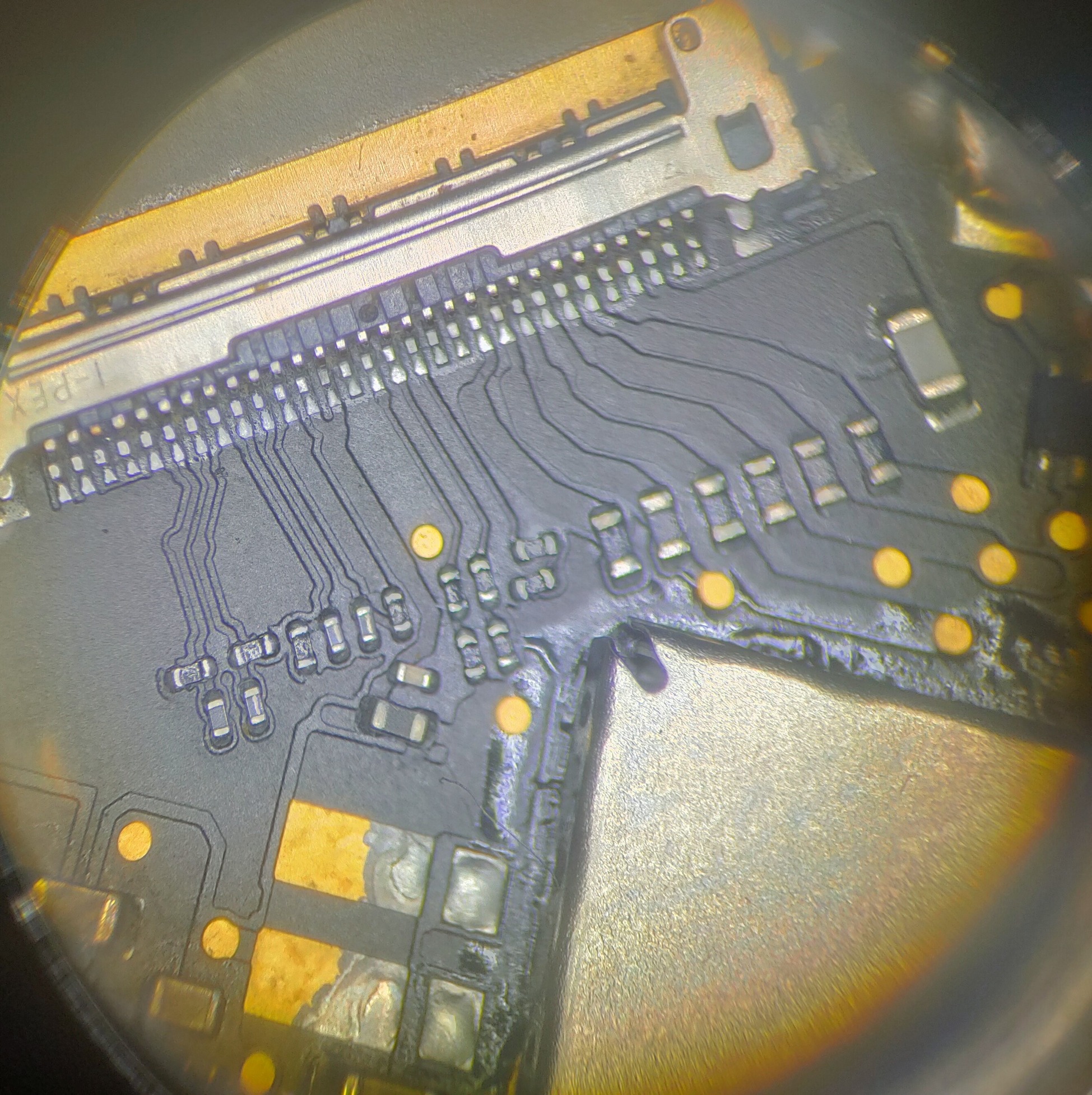

    I've started to practise more on macbooks air board, I've got a bunch of defective ones, to see if I can gain some more knowledge.
    I've been focused on a water damaged board of an 2017 Air.
    Someone else already worked on it, the SMC has been reflowed plus some minor reflows around the board.
    I've reached a dead end but I improved the state of the board.
    Initially it was no power, no green light, no fan spin, stuck at S5 state.
    After replacing some components (U7090, Q5500, Q7430, C7432, Q7630, U1950, R6115, R6116, Q3080) and reflowing many others (U8300, U4590, U6100, U6101, U8050, U7701, U5800, U7400, U7600, U1900)
    The current situation is:
    the board seems to be powering on (the CPU gets hot) but I get no chime, no greenlight on the charger (genuine one), the battery won't charge but I get a fan spin.
    I can't test if I get an image because the LCD panel backlight has been broken.
    If I do the SMC bypass procedure, the fan start spinning fast and it seems that in the LCD there is something showing. I don't have any SSD to test if the OS is booting.

    Apply a flashlight from the backside of the display panel to mimic the missing backlight.
    Does the caps key toggle the led on the keyboard?

      I didn't realize that also the panel itself is broken, I can't tell you what's the screen showing.
      When I press the caps lock key, the green led show up.
      Could it be an ISL problem? Maybe also the SMC could be..

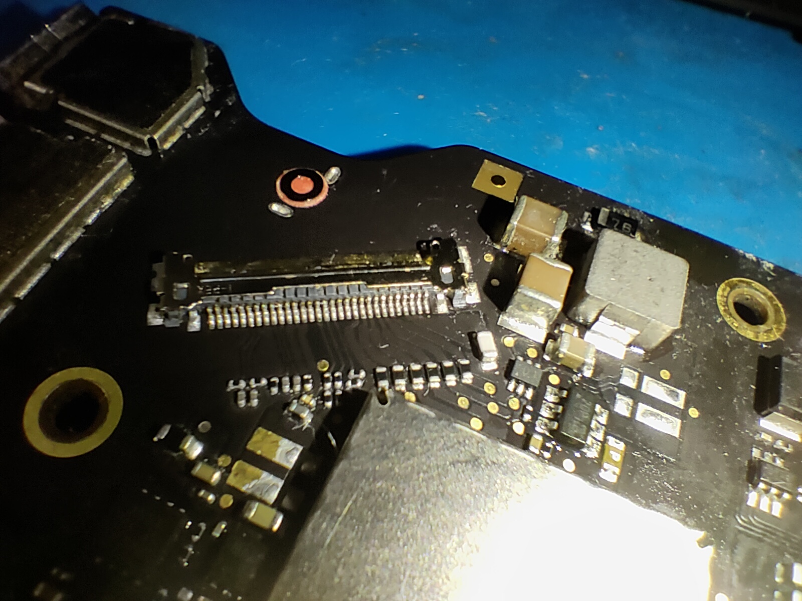

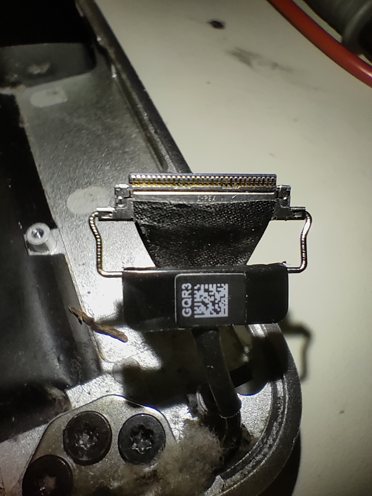

        Re: 820-00165 no greenlight in S0 state
        If the green caps light toggles, the OS is booted. Carefully remove the LCD panel connector using the latch used to secure into place and inspect the contacts of the LCD panel cable. Wipe with IPA (alcohol) if required).
        Post pics of the area of the display connector.

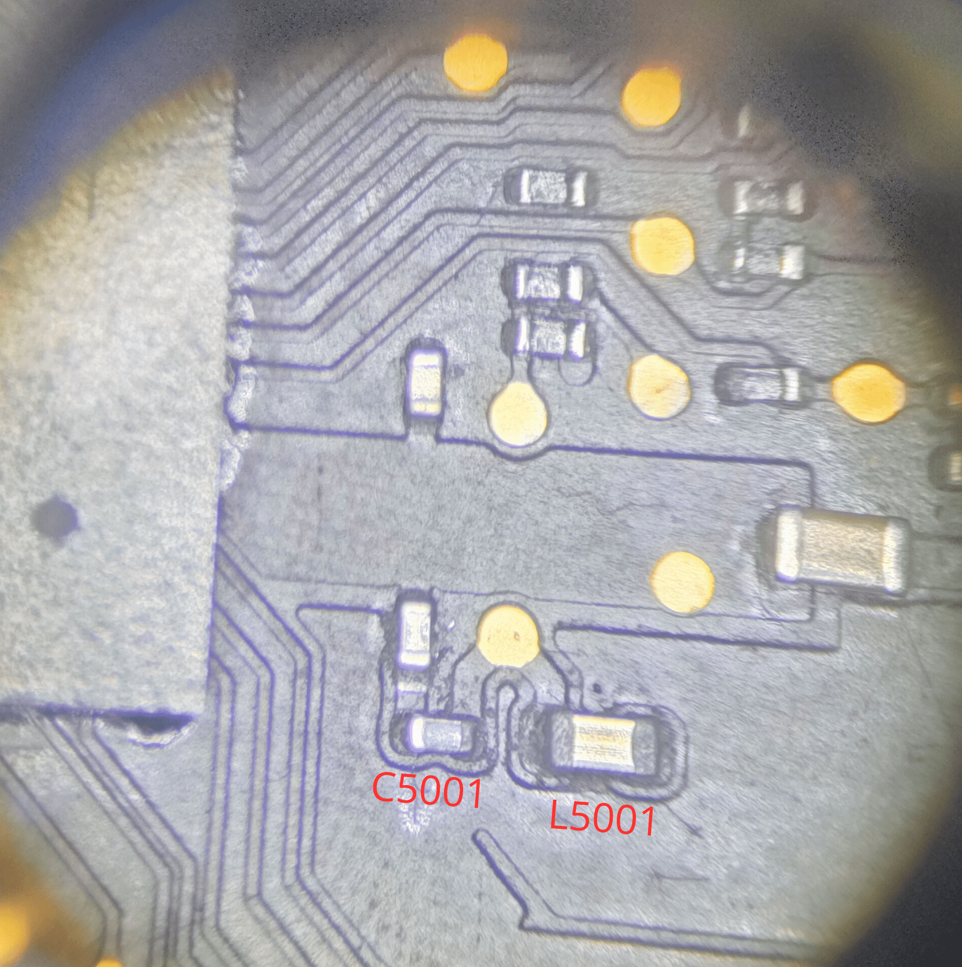

          Maybe I haven't explained very well the screen situation but the connector itself is in good conditions. The problem is that the macbook air i've been working on has been damaged by a previous technician that broke the screen assembly trying to pry open the adhesive bezel. The panel and the backlight are broken, I should buy a new screen to test the LCD screen output.
          I've cleaned the connector as suggested, I've attached some pictures.

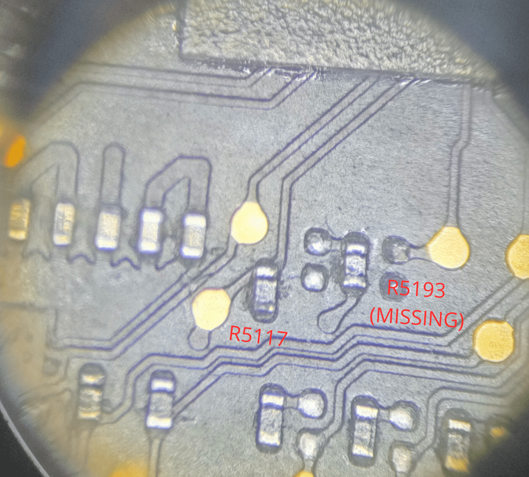

          I've also uploaded few pics about the SMC area, there are some burnt component that i'm not sure if they are crucial for the SMC to work correctly.
          I've measured those components and the resistors value are correct. The L5001 is 0 ohm value.

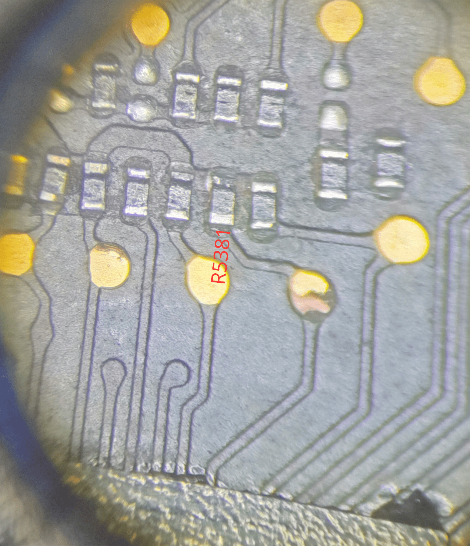

            The test point connected to R5381 is likely open circuit, would explain why your battery is not charging (since this is a SMBUS line to the battery). Corroded test points very common issue on these boards.
            If you've had that much corrosion right next to the SMC, then likely there is corrosion under it. But given it's booting you might be ok. I usually reball them even if a reflow is successful.
            A damaged display is still usually detected to at least enable backlight. You should get 25V at C7797 once the board boots. I have a couple of damaged LCD's that I use for this purpose on the bench. Buying a replacement display makes these uneconomic for resale unfortunately. I can only get about AUD$400 for them, and the displays are about $190 aftermarket. Couple with new battery and maybe a SSD and adaptor, you don't make much.

                Reformatt, thanks for spotting that corroded pad, I really didn't see it in the first place.
                Later I will try to fix it and see if the battery charging circuit will work again.
                Also thanks for the tips about the older macbook market model, I will take a look.
                I also seen some aftermarket screen from aliexpress for 50€, that would be my last stand in case I won't find anything cheaper on ebay or similar marketplaces.
                Later I'll test the backlight voltage as well.
                About the SMC, I was thinking also to reball it just to be sure the reflow didn't work 100% but I was a bit hesitant because I'm not familiar with the process. I also don't have the BGA stencil. But I think I'll give it a try, I don't have anything to lose actually. Do you think reballing the chip with a solder blob will be enough or would make the balls too much unevenly the same size?
                Alternatively I have the solder paste. In case I will get the stencil, does the paste need to be applied right away or need to be dried first? The reflowing temperature to melt the paste is roughly 250 C? What about the airflow? I know the settings differs a lot from station and location, I just wanted to have a general indication to start trying the reball process.
                About the fact that the charger light won't light up, is it related to the SYS ONEWIRE even if the board boots or it is related to the SMC itself?
                Also about the fact that the board boots only under SMC bypass, it can only sensor related or it might be that SMC that is not working correctly?
                Sorry for the many questions

                  The charger light is supposed to be out in SMC bypass. It goes from green/orange to out as a visual indication you are in bypass. PPBUS_G3H will also drop from 8.6V (with no battery) to 8.3V, and fan will also spin at max speed since sensors are ignored.
                  Check for a missing PP3V3_S5_AVREF_SMC, this is the most common reason for only working in bypass. Often due to a shorted cap C5125, or corrosion around U5110.
                  As far as reballing goes, this is a whole other topic. Deal with the other issues first.

                    -I've fixed that corroded pad but there's no change to the green light/orange light in the charger behaviour, both are not yet present.
                    I've measured the battery voltage on the pins 1,2,3 of J6950 and there seems to be some activity there, the starting voltage with no charger connected is 1.5V. After connecting it it raise up to 4.5/5V and it seems to be rising.
                    -on C7797 I measured 40V when the display connector is connected. That voltage is present even if I'm not in the SMC bypass mode. Does that mean the board is powered on normally or that doesn't mean anything? Yesterday I replaced U7701 from a donor board because it seemed to be quite corroded.. maybe that did something to the backlight circuit even if I didn't test it until now.

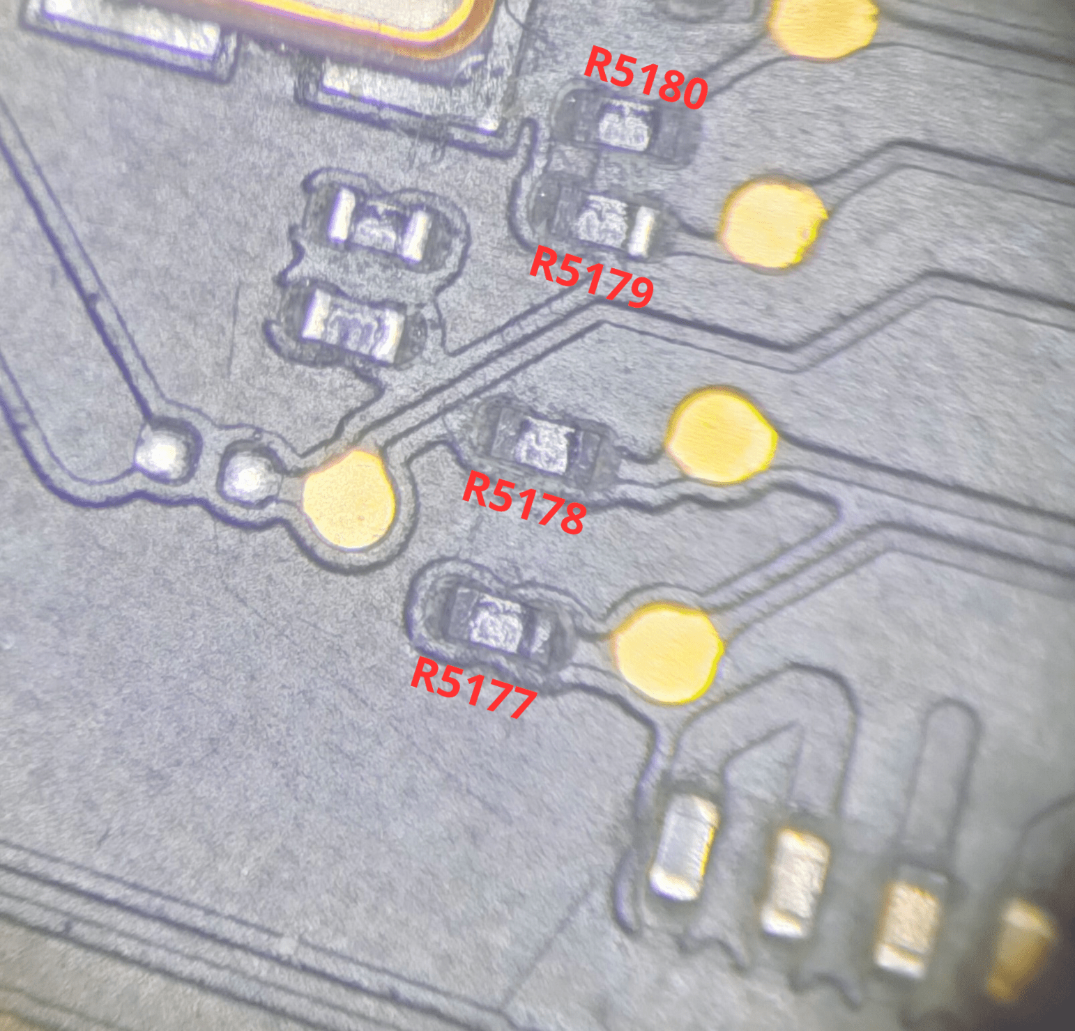

                    -in the SMC area i've redone the pads of R5177, R5178, R5179, R5180, they were quite corroded and the lines were interrupted.
                    I've replaced U3710 and R5625 which weren't in a good condition at all.
                    Then I've desoldered Q5158 and it was cracked, the pin 2 was detached from the rest. In the process of replacing it with a donor one, it slipped away and I didn't find it again. I guess that component is important for the CPU to communicate the SMC its temperature. I will try to get more of those transistors.
                    -I've tested the line PP3V3_S5_AVREF_SMC and it measure 3.33V without entering in the SMC bypass mode.
                    Do you think the board is actually booting even if there's no light coming from the charger?
                    I guess the next step will be to take a decent display and see what's going on there..

                      40V for backlight? I've only ever seen that once and I think I resolved it with a new LP8550. It should be 25V.
                      Do you have a USB stick with a LED that blinks when accessed? When an Apple board successfully POST's, it will probe the USB ports for something to boot off. The LED in a USB stick should blink 3 times to indicate the port is being accessed. I use a Chipmunk USB tester which is specifically designed for just this thing.
                      You can also use a magsafe 2 cable from a power supply and monitor input current. It's important to use a genuine magsafe cable, as 820-00165 boards are particularly fussy about them and will hold PM_BATLOW_L low if they are dodgy, and they won't reach PM_SLP_S4 as a result. 820-00165 boards will initially go 550 to 600ma, then settle back to around 330ma or so once it's POST'ed.
                      From your descriptions, I think you at least need to reflow the SMC or reball it. If the SMC is not in bypass, it will not charge the battery without onewire comms to the charger. You can also have a bad SMC as liquid damage can at times damage the SMBUS data connections to it.

                        I've purchased an early 2015 air in immaculate conditions that had no power issue. I've fixed the board and I swapped it with the one of this topic.
                        The machine is actually turning on, the screen image and backlight are working and the battery is charging.
                        The charger led is also working, turned out to be the flat cable 821-1722 that had a pin that desoldered after it got shorted when it got water damaged.
                        After booting, the OS is kinda slow due the missing transistor Q5158 that I will replace as soon as I will get some more of them.
                        The only issue I've noticed is in the backlight circuit. When I try to adjust it, the screen won't dim but will abruptly lower the brightness at the minimum value when the UI indicator in the OS is at half way.
                        Looking around in the schematics and in the wiki I think the part to check is the LED-Retun / Feedback / Current sink one, right?
                        I already tried to reset PRAM and SMC with no changes.
