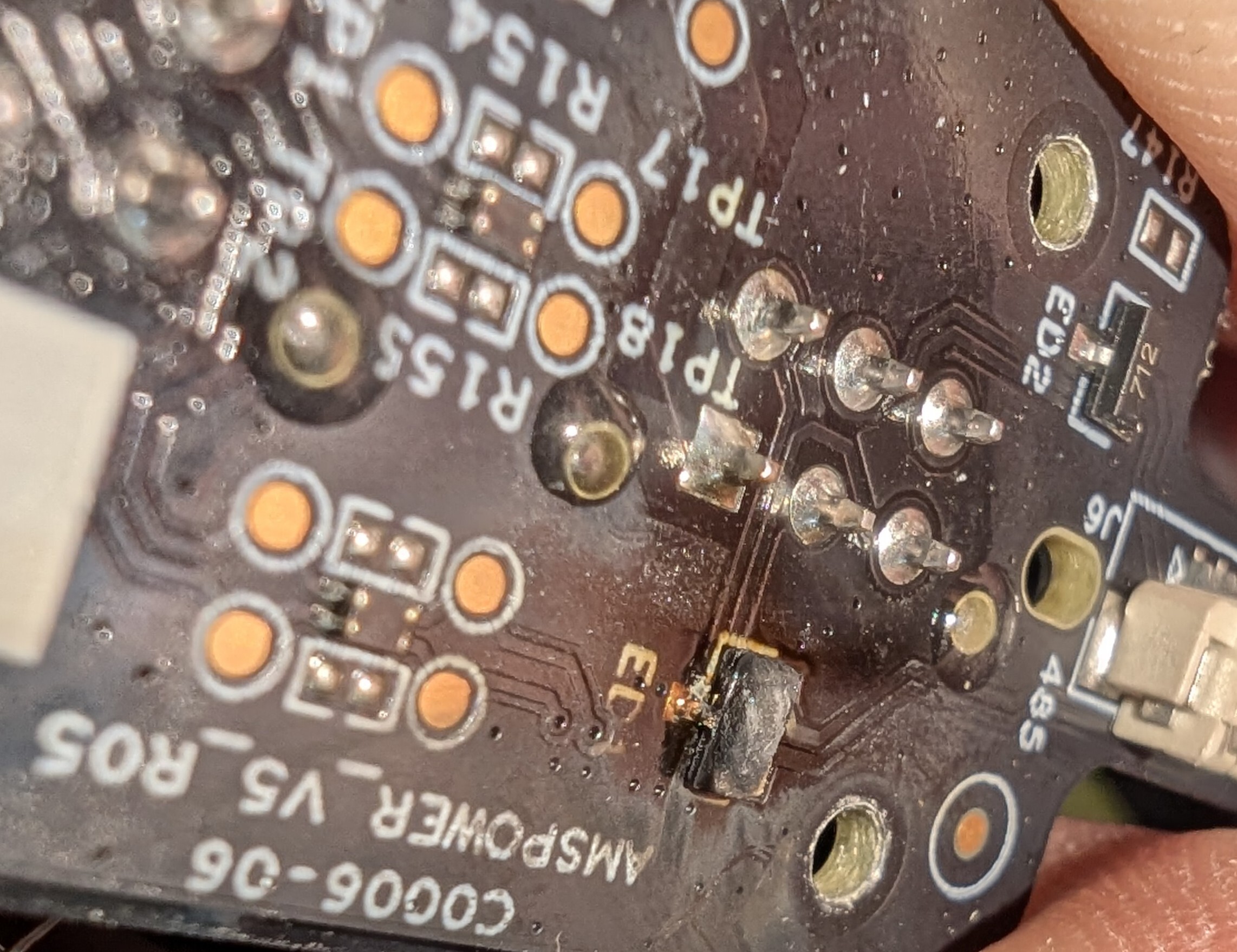

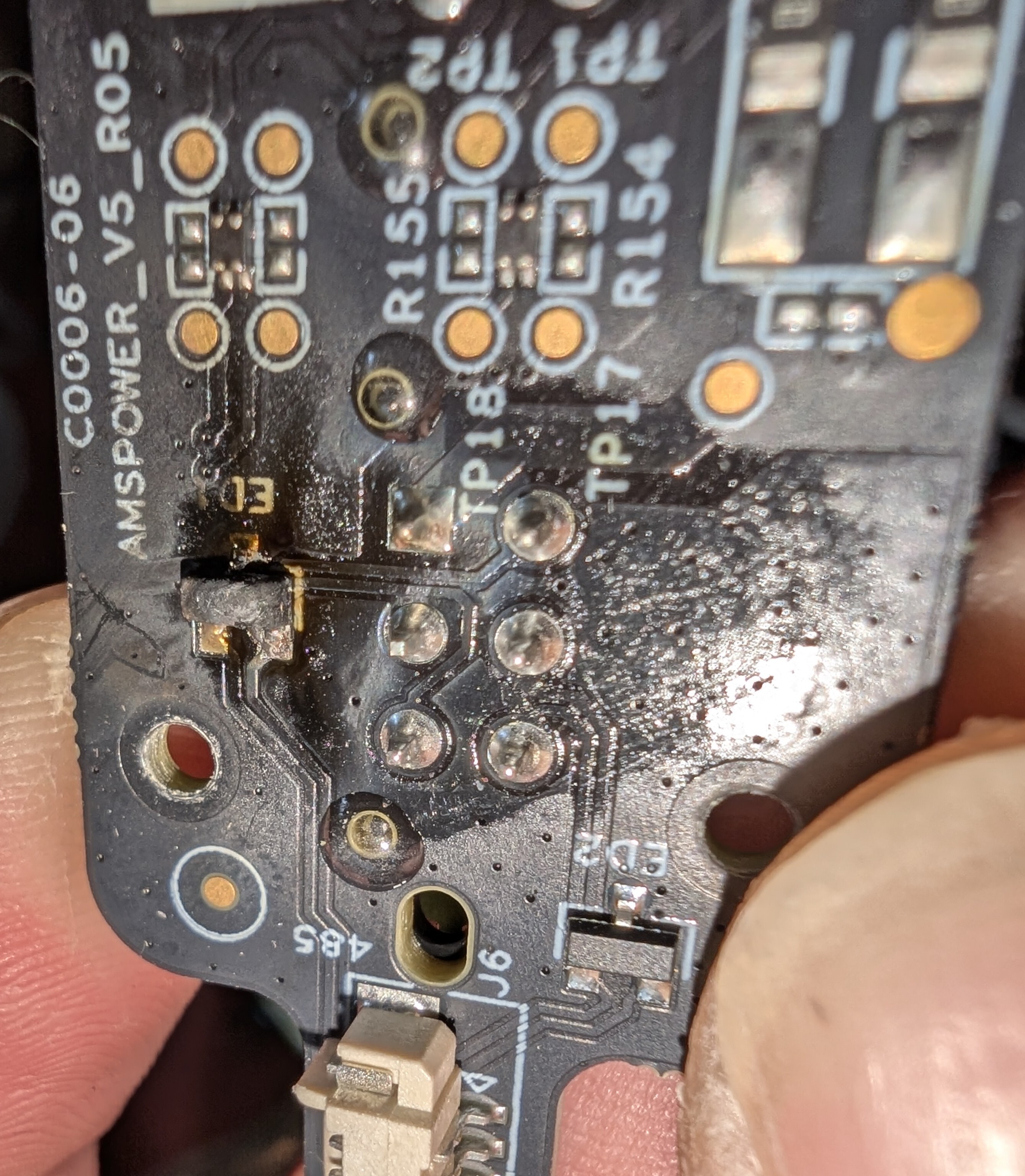

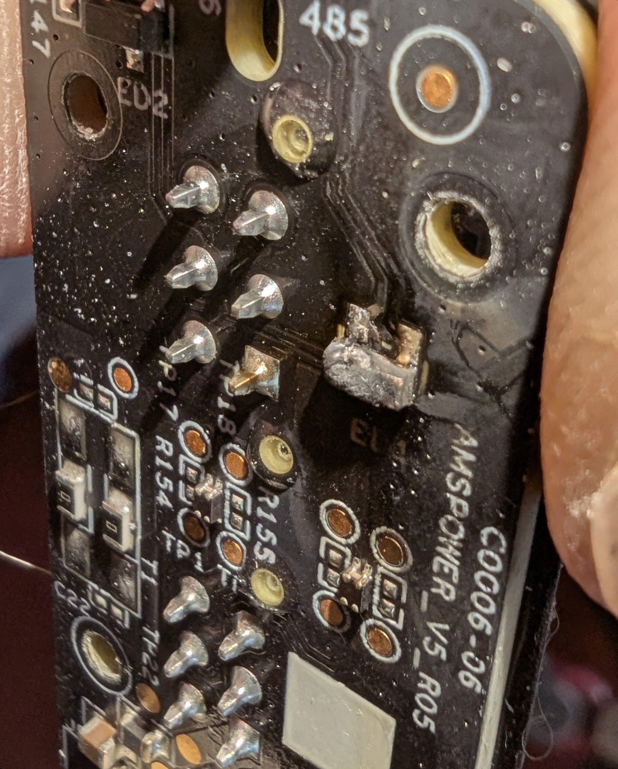

    Hey there,
    I'm largely still a student and unsure about identifying components like this, anyone have any idea what this is and if I have another one, fairly straight forward to swap out?
    From my Bambu Labs AMS - had connected the wiring incorrectly .. Whoops!
    Cheers!

    Based on the silkscreen reference designator and it having three leads, I think it might have been a TVS diode.

      Whatever ED1 is for a TVS look at ED2. They are probably the same.

          Board marking "485" so I would say it is a dual TVS for protecting the RS-485 port. ED1 likely same as ED2 "712"
          Bourns SM712 or Littelfuse SM712 etc.
          If this is the port you wired wrong.
