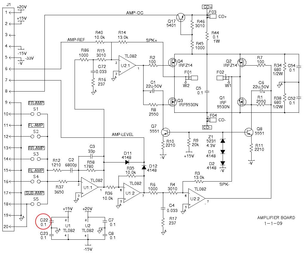

    Hi all
    I am working right now on a Klipsch ProMedia V2-400 amp that I got on Craigslist. As some might know this amp has for each channel an individual amp pcb.
    Here is what happened:
    I replaced the usual suspects like underrated and non-functional resistors on the DC to DC and Digital Converter. As soon as I turned it on, cap C22 on one of the amp-boards went into smoke.
    I assume that this particular board had already a prior issue which killed an underrated resistor (which acted then as fuse) on the DC-DC converter.
    Anyways, I disconnected this particular amp-board and amp plays now fine on the remaing 4 channels.
    My question:
    Can somebody point me please in the right direction what kind of cap this is and what would be an adequate replacement.

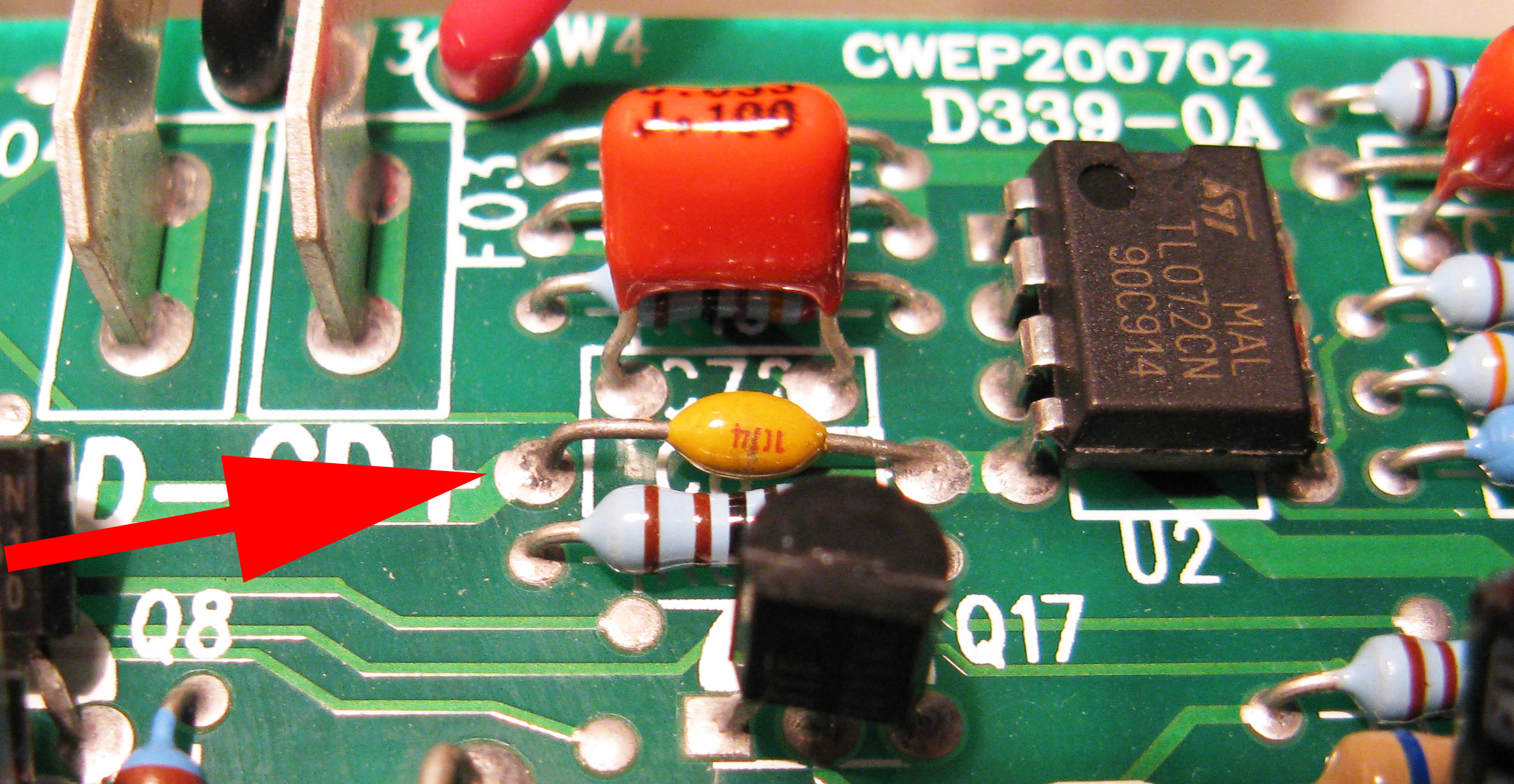

    Re: Need help to determine cap type
    They are bypass Ceramic cap. Ceramic cap will usually fails in shorted out mode.
    http://www.mouser.com/ProductDetail/...T1AUQKZeYzY%3d
    http://www.mouser.com/ProductDetail/...3dcUyZcfc7w%3d
        If you didn't order them already, pick some that are rated X5R or X7R or G0G/NPO.
        The ones linked are Z5U which aren't as good. For a decoupling capacitor it doesn't make much difference, but as long as you're buying why not buy some better stuff.
        Here's some suggestions:
        http://www2.mouser.com/ProductDetail...1h2iE%252bY%3d
        http://www2.mouser.com/ProductDetail...52bpP7i1YUY%3d
        http://www2.mouser.com/ProductDetail...VHnLudpv150%3d
