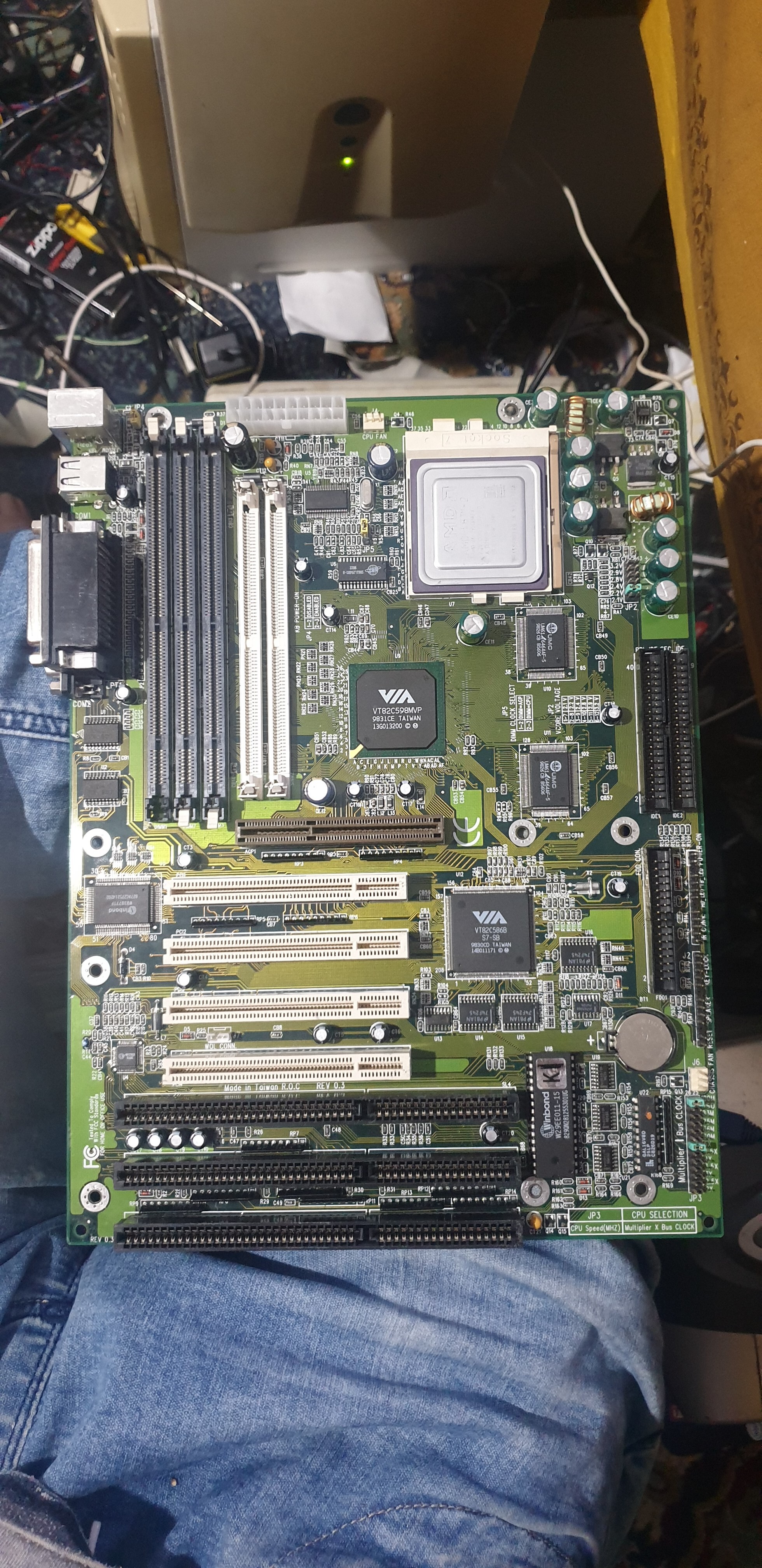

                      • Dan81
                        SNES-powered
                        • Oct 2013
                        • 1865
                        • Romania
                        Nice, I had a few valuable boards go thru recap, with QDI's BrillianX 1 and Chaintech's 6BJM0 being up next soon.
                        A few of them.

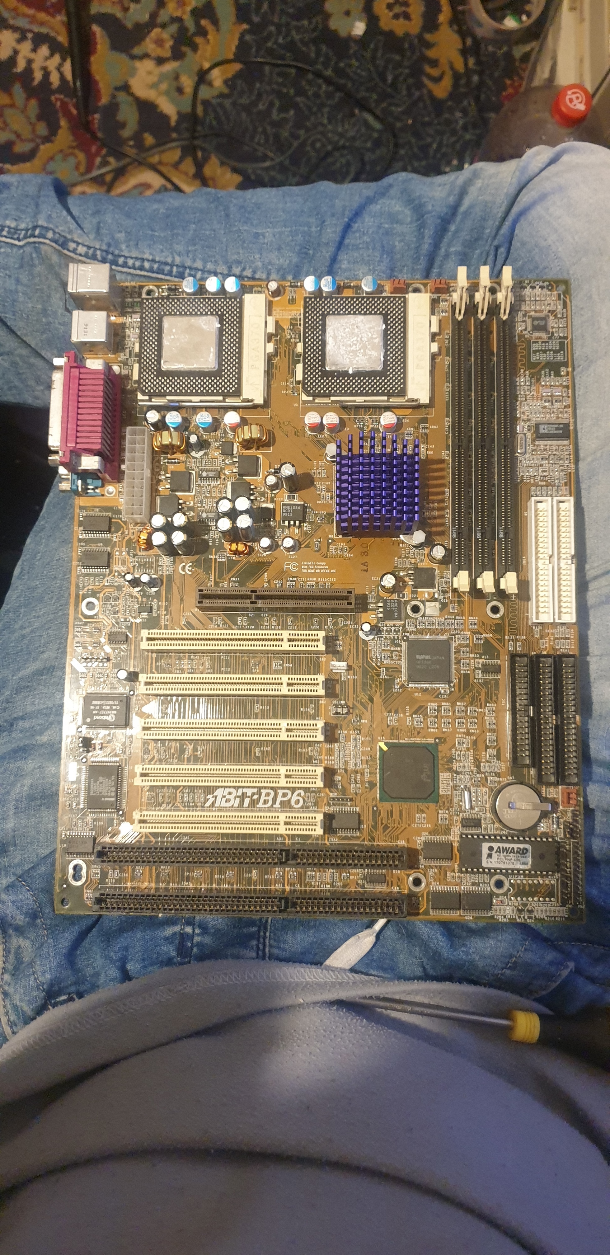

                        BP6:

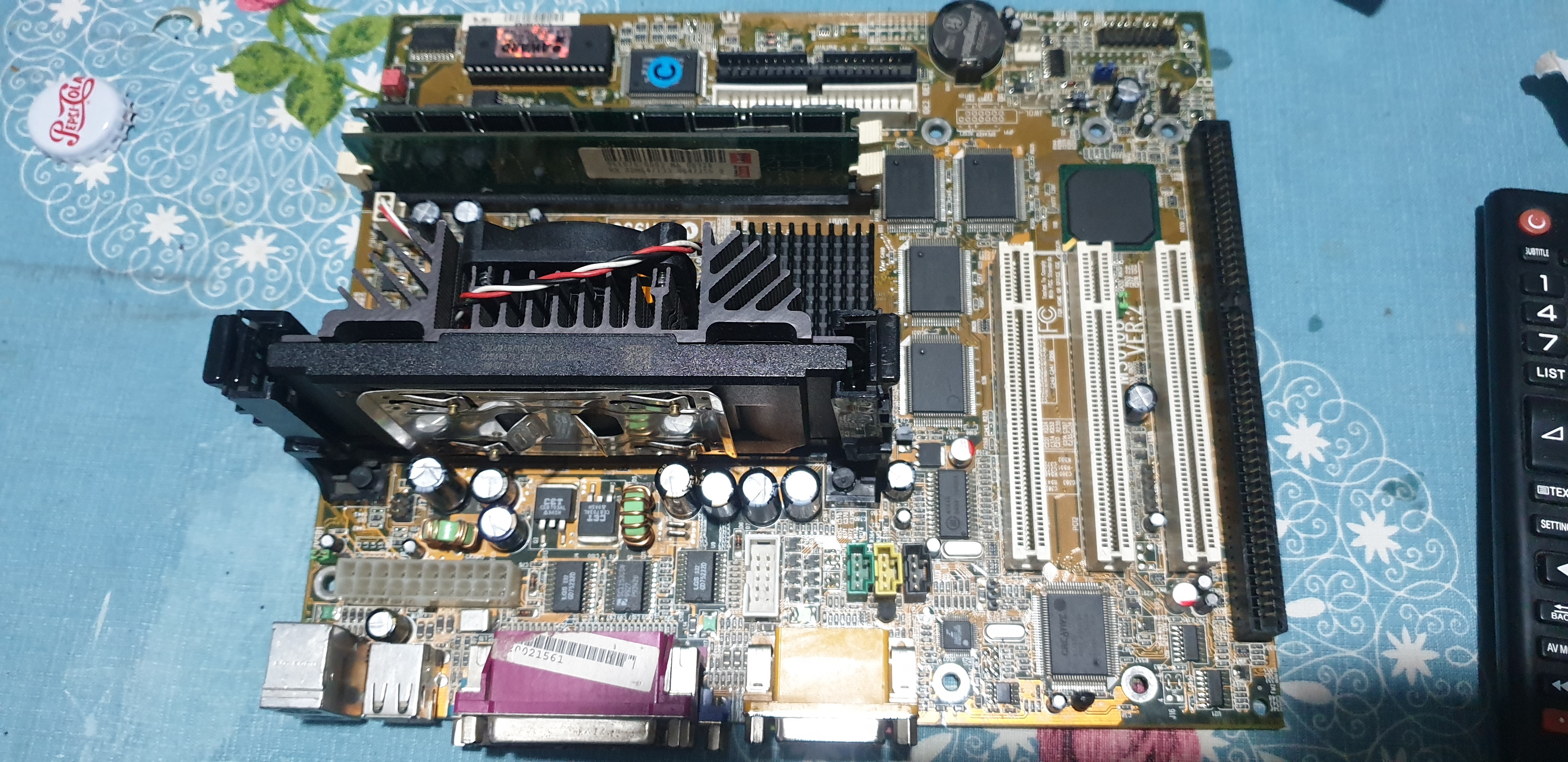

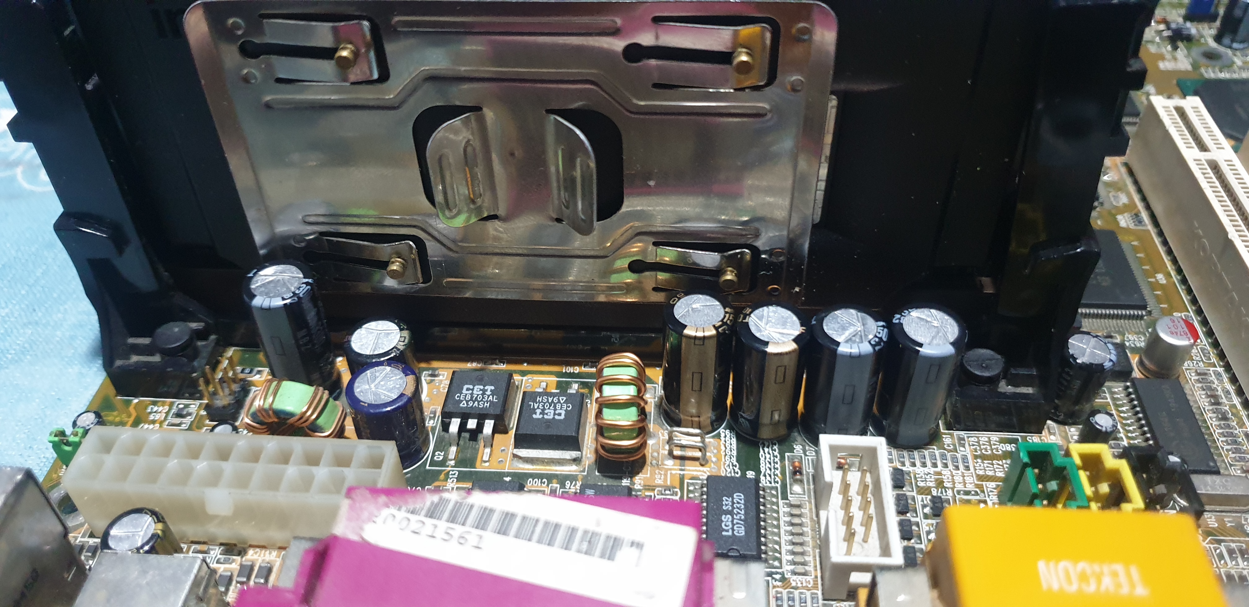

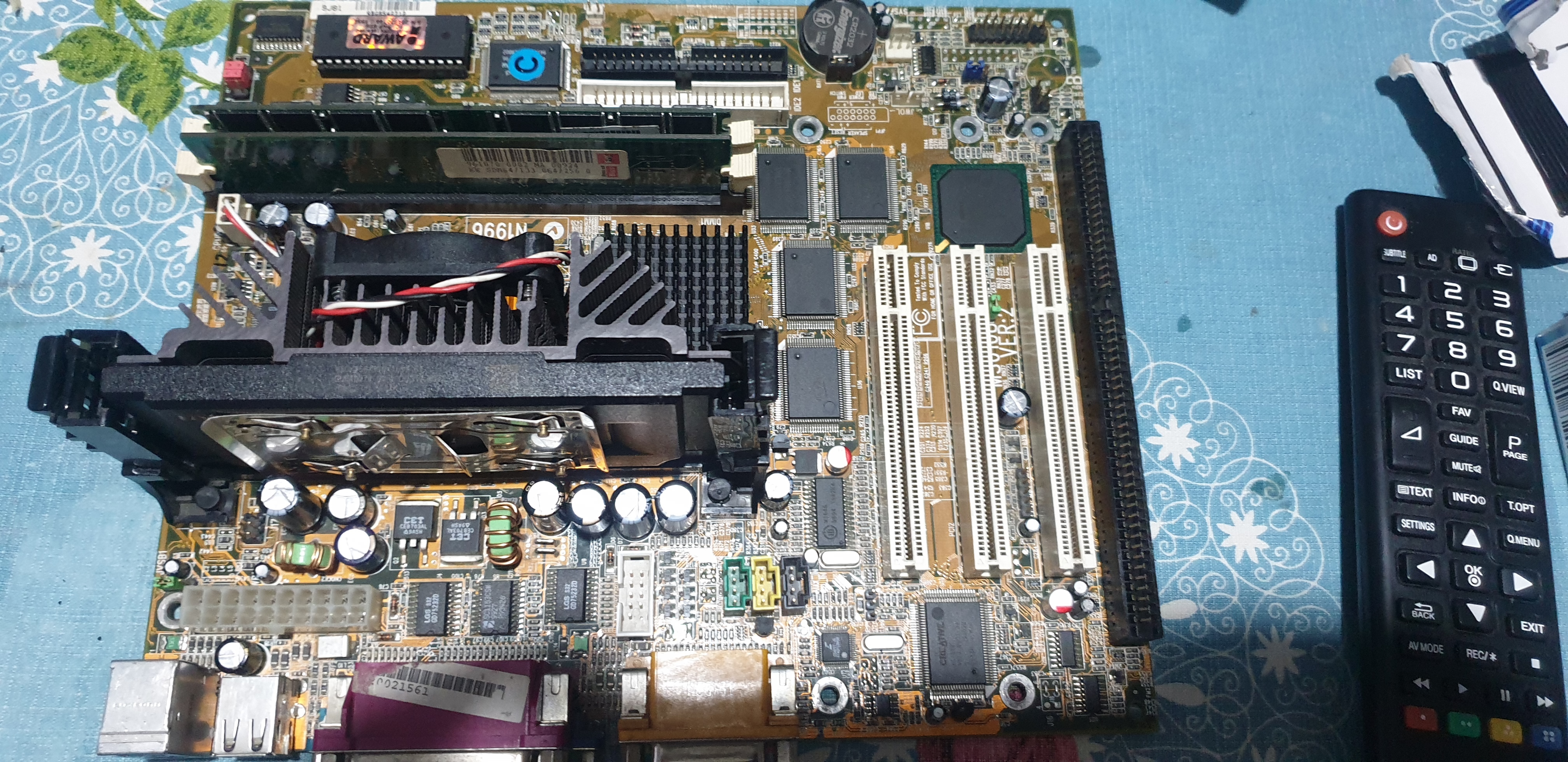

                        MSI MS-6168, Voodoo 3 2000 onboard
ID:	3513556 Click image for larger version
ID:	3513557 Click image for larger version

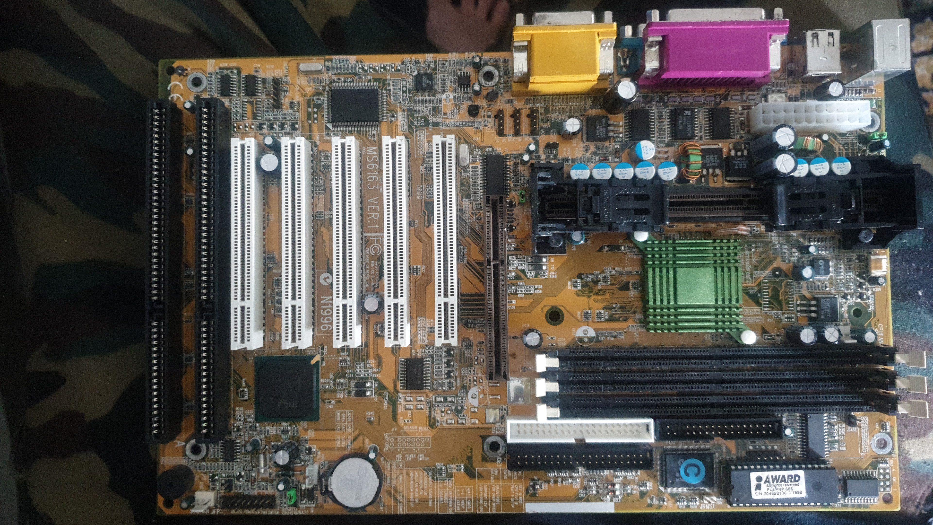

                        MS-6163 rev1, VRM low is almost all poly
