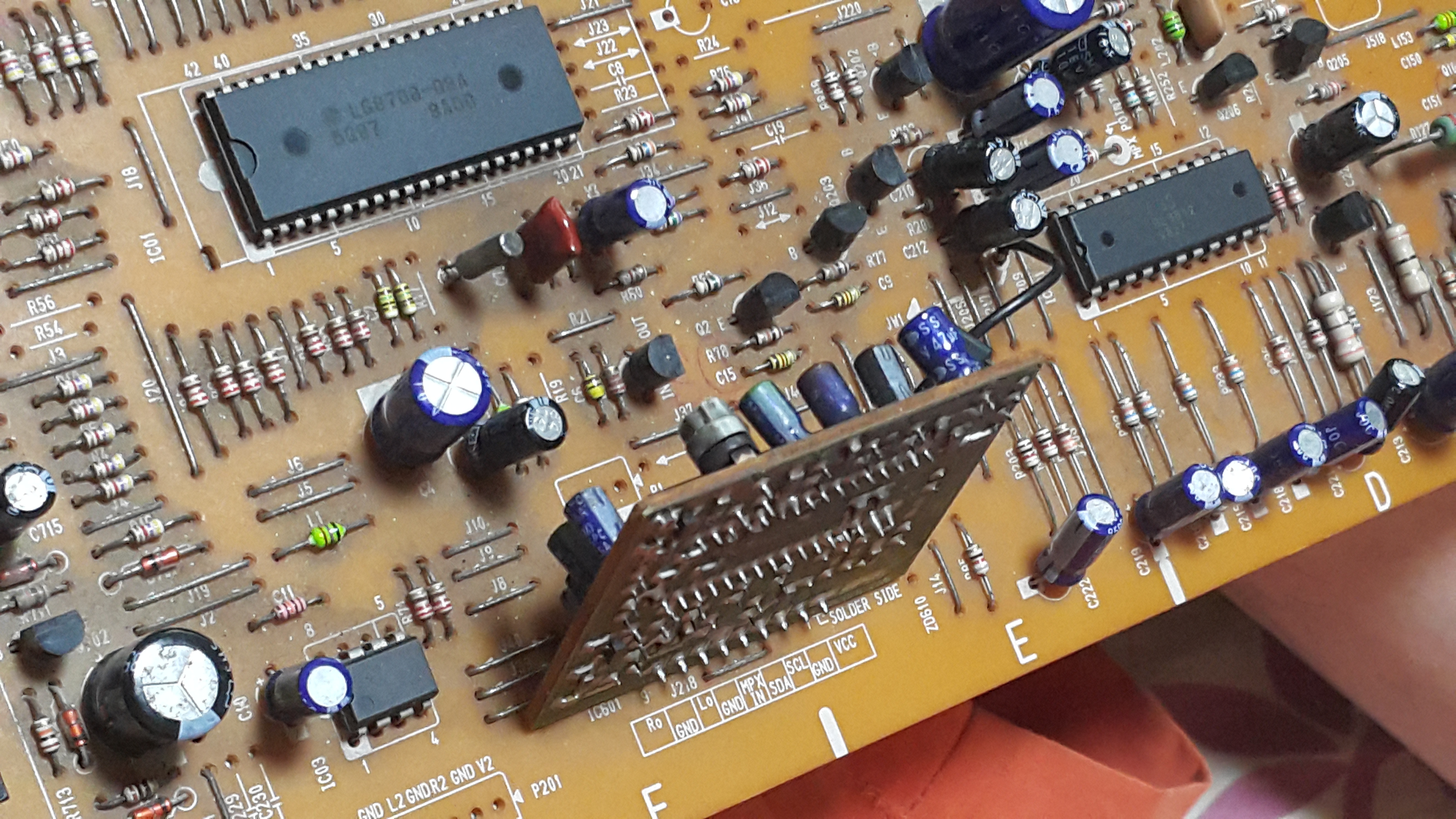

    When I desoldered R831 and solder 60w bulb, I measured B+ filter capacitor and It was measured 120Vdc.
    So I think that there is no faulty in the HOT area. So I doubted maybe there was loose contact on the pin of IC,Beacuse This CRT TV was manufactured over 25 years,So solder joint would not as tight as twenty five years ago.
    And it seems that weight of its PCB is about 2kg,I think that Whenever I deposited this heavy PCB on the floor,this would put pressure on the pin of IC ,So there would be minor crack on its solder joint.
    I soldered all pin of IC01(LG8708-08A), IC201(GL3812),IC501(TB1231N) and Turner TU101(TUSHB-A07A) at the bottom of PCB, and It finally displayed screen!
    But there is some weird issue for this CRT TV.
    If I frequently press channel up or down button It sometimes make it mute like below video.
    https://www.dropbox.com/scl/fi/d667w...=ralpc4qj&dl=0
    And Display suddenly become distorted(concave), after switch on CRT TV in 10-20 minutes.
    https://www.dropbox.com/scl/fi/v2qdo...=3ksy8xoi&dl=0
    I doubt that there is still loose contact somewhere in the bottom of PCB..

          I would recommend that you use a magnifying glass and very carefully check each and every soldering joints for bad soldering joints because if you found some there might be others that you could not see with the naked eye I have been there and done this before trust me check them with a magnifying glass to make sure that this not an issue that still exists
          • R_J
            • Jun 2012
            • 9608
            Did you reinstall the original C433 (5.6µf/50vBP) capacitor? or did you use a replacement? Check connections around Q406~Q408 and the two adjustments vr400, vr401 (pincushion and horz. size circuit) it may be a dirty control or there may also be a weak elec. cap in that area as well.
            I would resolder Q408, its connections don't look good from here.
            Another electrolytic that can cause problems in these chassis is C406 (2.2µf/160v) horz. drive transformer filter cap.

              Thank very much for all of reply.
              It is not possible to purchase bi-polar capacitor which has 5.6µf/50v specification,So I still not yet replaced it.
              I noticed that There was a crack in some pins of Q408(KTD2059-Y) and IC601(it look like below screenshot).
              Click image for larger version  Name:	IMG_20240707_114609.jpg Views:	0 Size:	6.51 MB ID:	3304881
              So I soldered these pin and There was no more distorted screen and silent while pressing channel up or down button!
              But Unfortuantely,There still remains minor issues which seems to be extremely hard to repair.

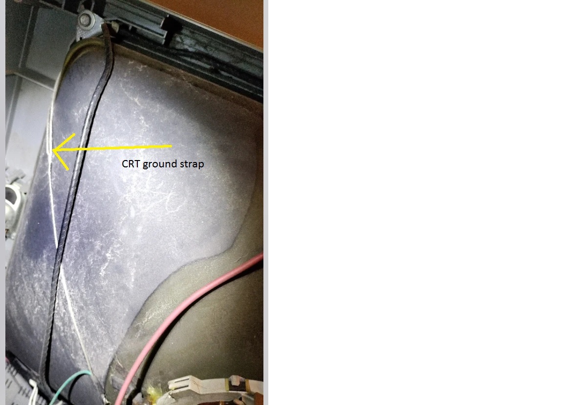

                    By the way,I found that there is small crack on the one of GND soldering joint in the CPT board ,So I soldered it and all of other large pins on the CPT board like below picture.
                    https://www.dropbox.com/scl/fi/zp4zw...=wc083ly5&dl=0
                    When I switched on TV,I confirmed that It display screen like yesterday,But Now I heard quite loud noise from anode suction cap and cpt board like below video.I recorded below video when I closed all of window in order to reduce noise from outside.
                    https://www.dropbox.com/scl/fi/z8778...=t5vmvk79&dl=0
                    Although It was noiseless almost as soon as I unpluged ac cable,But I really dread of this loud noise may cause burnout or burst of cathode-ray tube or CPT board itself.

Name:	crt ground strap.jpg
ID:	3305859 Make sure the crt aguadag coating on the crt (the black coating on the outside of the crt glass) is grounded to the chassis It sounds like a ground might be missing, this is just the high voltage bleeding off it will not burn out or burst the crt.
                      Post a couple pictures of the rear of the tv so I can see the grounding on the crt and how the ground strap connects to the chassis. I tried looking up the model number you provided but it does not seem to exist

                              And I found that one of GND solder pad In the CPT board have been torn out.
                              So, I scraped remained solder pad with needle to expose copper surface and soldered it to GND pin.
                              And this time,I deliberately hindered anode cable from being very close to yoke like below picture.
