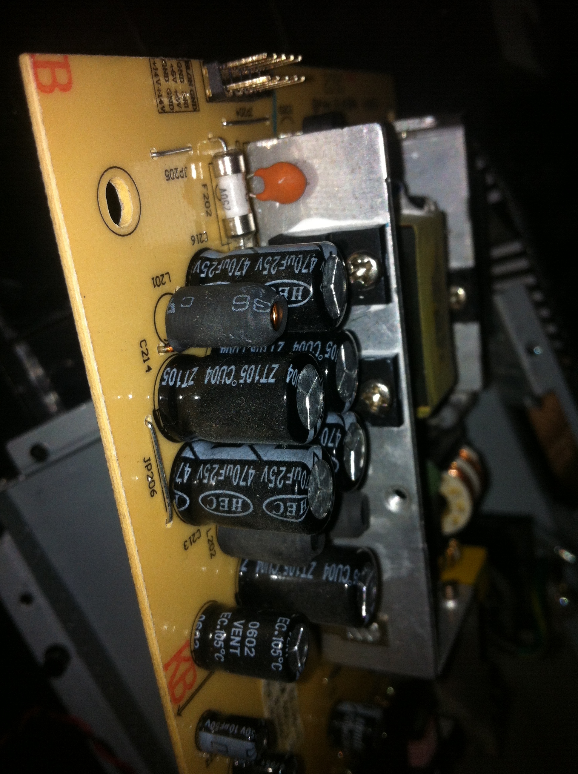

    Hi Guys,
    I'm new to the world of caps and would appreciate a little first time advice.
    I'm attempted to fix my LCD monitor. I've been having problems with it powering on, flickering and hissing then turning off 30 seconds later. After some reading around I've concluded its probably the caps on the power supply board. I've pulling it open and had a look at the PSB however they are not showing the obvious signs of being blown.
    I was wondering if I could firstly get an expert eye to conclude if they are blown and secondly if indeed they are blown it would be great to some advice on the replacement cap I will need.
    Thanks, C.

    Pictures? They may still be bad without showing any sign. What make/series are they

      Thanks for the quick reply.
      I've included pictures do they not show?
      "HEC 24V 470uF" is all I can make out.

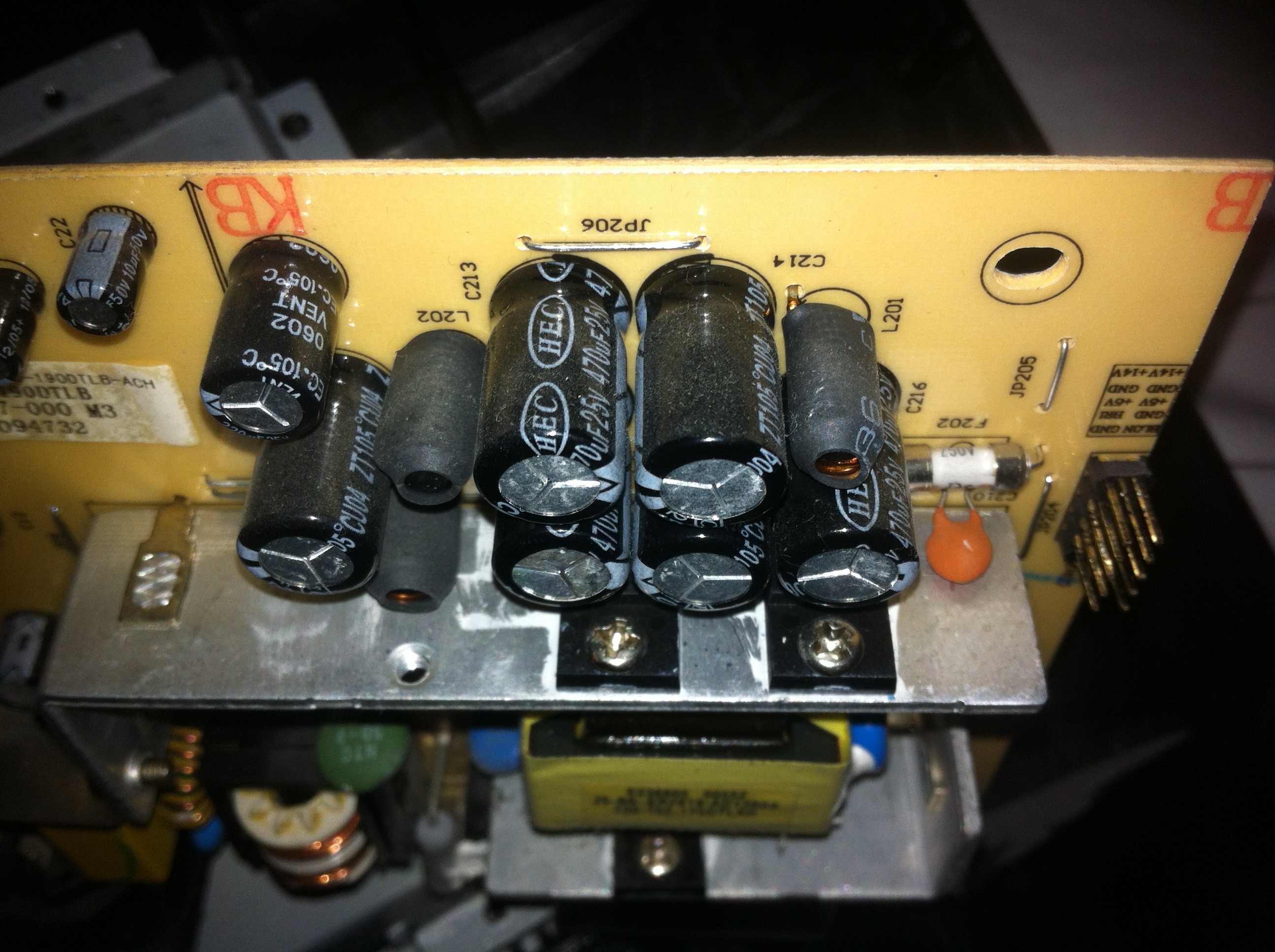

          Okay hopefully these will work...

            Ok - they look alright - I would consider changing them but hissing and flickering is more likely to be a bulb issue or inverter issue. What is the make and model of the set? can you post a straight on picture of the power supply front and back.
            If you get round to replacing the caps just get panasonic FR FM or FC
            in the values to match the old ones and just check the physical size to make sure they fit. CPC.com have a post free offer at the moment.

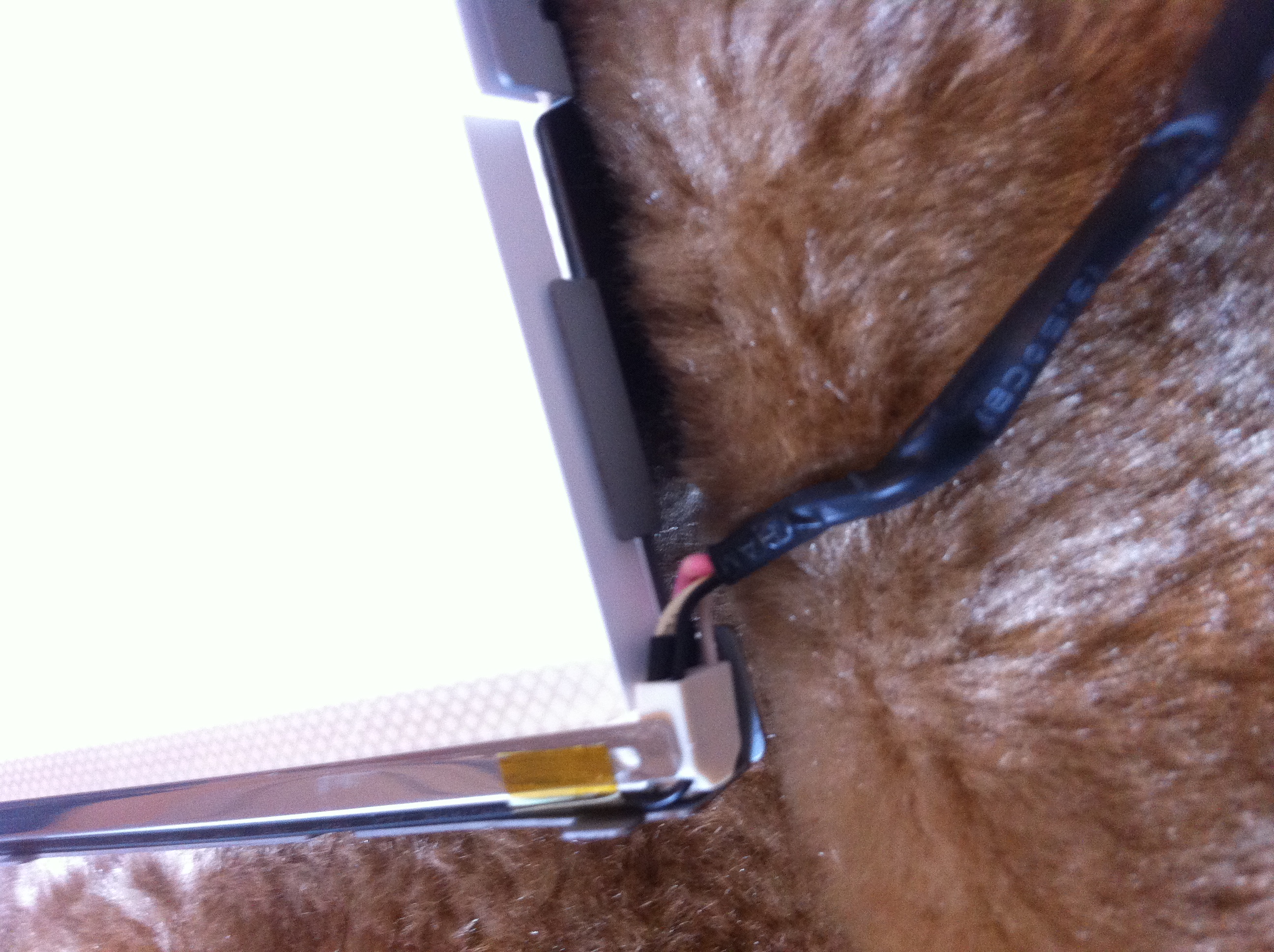

              Hissing and all that sounds more like one (or several) wire came loose from the fluorescent lamp end and it's now arcing against the metal shield of the lcd panel.
              The fluorescent lamps have 700-1000 volts running through them (at low currents) so these arcs are sometimes enough to trick the inverter controller to think the lamp runs properly.
              Carefully, pull the silicone boots from the end of the lamps and see if everything is soldered properly to the lamp ends.
              Capacitors in one picture are HEC 470uF 25v ZT series, they're not very special... you can find the datasheet here if you really want to see it.
              Like selldoor said, the Panasonic capacitors will work. Just match the uF value and the voltage rating and you'll be good to go.

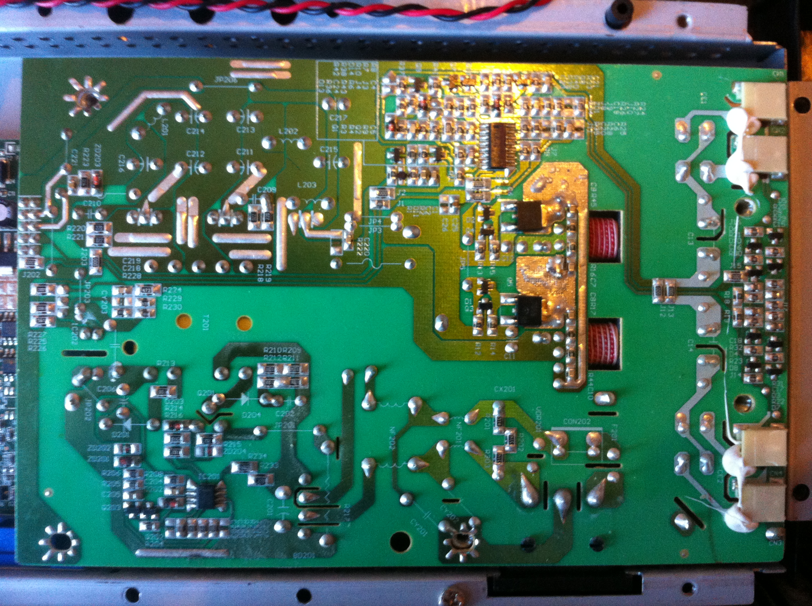

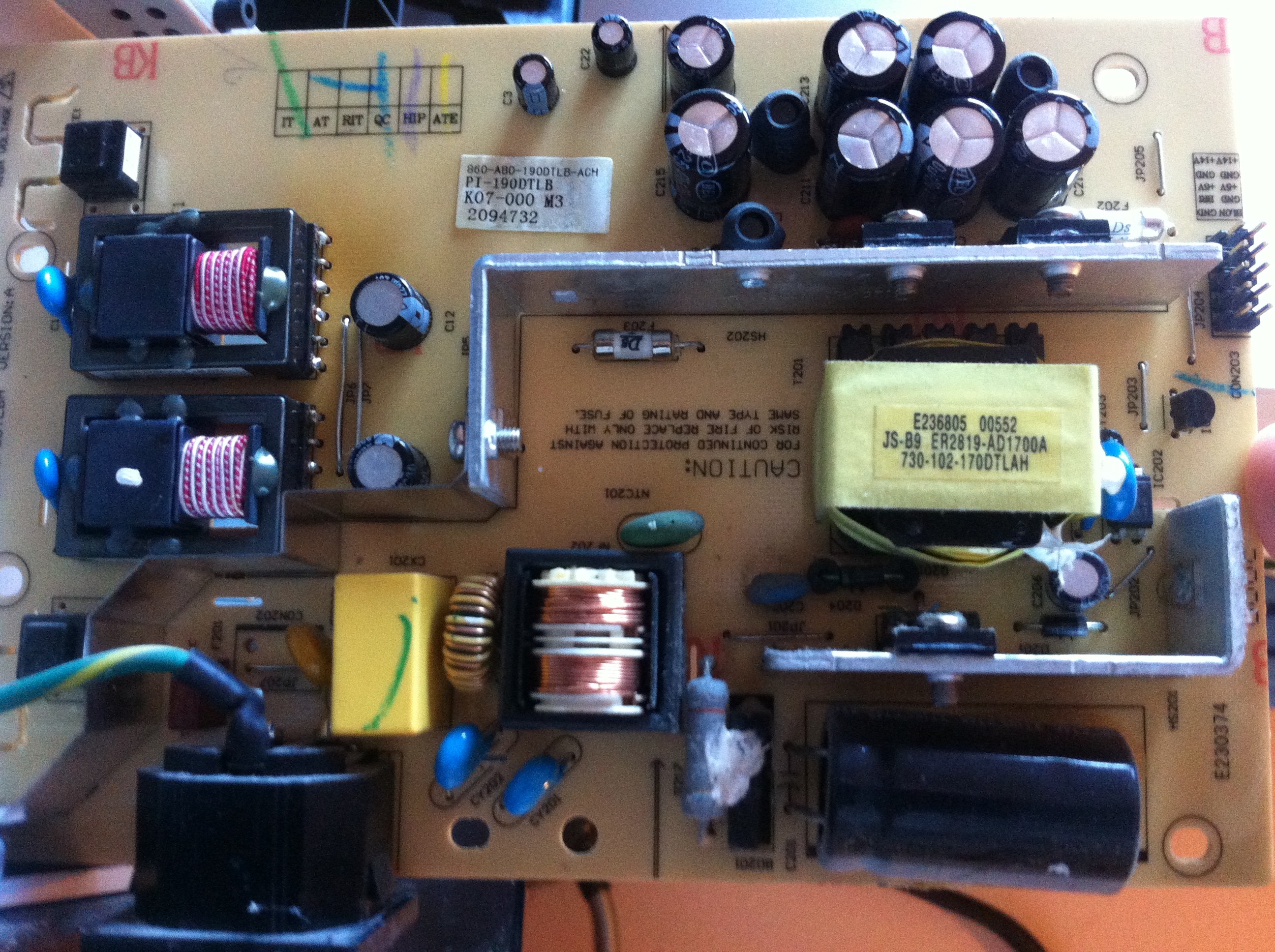

                Okay thanks for the information selldoor and mariushm, I'm really hoping its not a bulb issue read it was a difficult fix. I'll study those lamp ends to check.
                I'll give the cap replacement a shot too, out of curiosity more than anything.
                Here are the front and back close ups of the power supply...

                  ok looks like it may be one of these Proview PL926WBI,or Xerox XR6-19DW.?
                  There are a few threads on the proview. Some have backlight fails.
                  You need to look at the bulb ends also maybe a wire just needs taken off and resoldered.
                  Bulbs become very brittle with age - care and patience is the key.

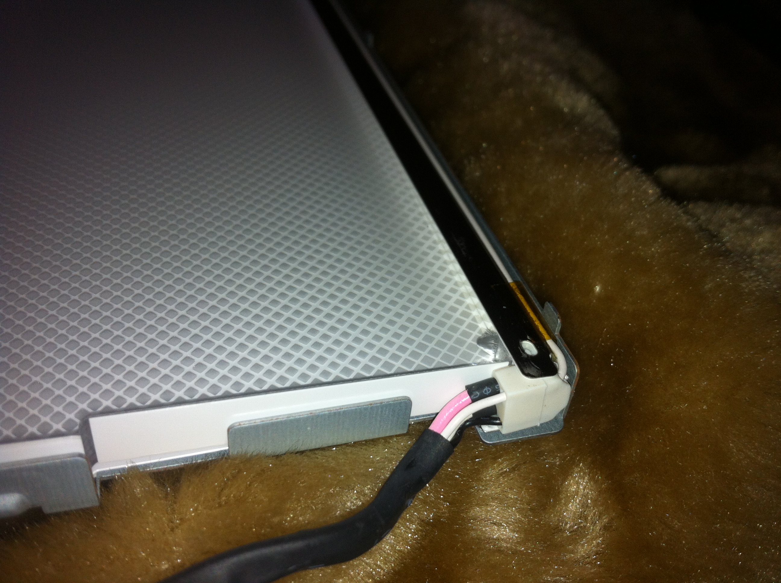

                    I've got as far as the bulb ends, I'm not sure what I'm looking for at this point ( attached pictures ). Do I need to some how remove those silicone covers, seems like its going to be a real pain, was pulling at it for a bit but its glued in place.

                      Ok I think you need to remove the lamp assembly from the panel first. This will enable you to see the bulbs and then you only need to go further if they are black or broken. The end caps tend to weld to the glass tubes.
                      There are a few tutorials about try youtube. and here
                      http://www.ccflwarehouse.com/lasotu.html.
                      Also have you tried plugging it in with the panel as it is to see if you can further
                      locate where the noise is from. Any signs of arcing on the frame?

                        Put it all back together to identify where the sound was coming from ( like selldoor suggested ), it was silent, plugged a HDMI in and it worked perfectly. Taking the whole screen apart and fiddling around has somehow fixed the issue.
