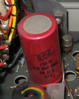

    What is this cap?
    I just opened up my oscilloscope to check if it had bad caps (or a brand that are likely to fail), and saw this unusual cap. I don't recognize the brand (C.C.L), and it doesn't have a vent on top. Could it be a polymer? Could it be one of the old caps that are designed to vent through the bottom? The oscilloscope is fairly old; it's one of those that uses a CRT tube rather than a digital display.
    Anyone know about this kind of cap?
    If you can't read it, the writing on the cap is:
    C.C.L
    330 uF
    160 VDC WKG
    PK 61 S
    D73

    I opt for an old can style cap, nothign fancy abouth them. All the older can style caps do not have vent`s. very common in older CRT`s, duno why they used them, but IMHO in those days the caned caps have had better ESR and endurance specs than the sleaved radial ones.
    I replace those with standard caps like Panasonic ED series. etc.

      is it really 160v? then no way a polymer

        The highest voltage rating I've seen on a polymer from a brand I'd consider credible is 35V (UCC PS series). That rating, "160V Wkg" (Wkg - Working), suggests to me that it's 1970s vintage or older, well before polymer caps came into usage.

          Looks like a standard 1970's electrolytic capacitor to me. They didn't have vents in those days - they just went BANG.. and you knew about it

            looks like Old Electro Cap to me too....
            What Brand CRO is it?
