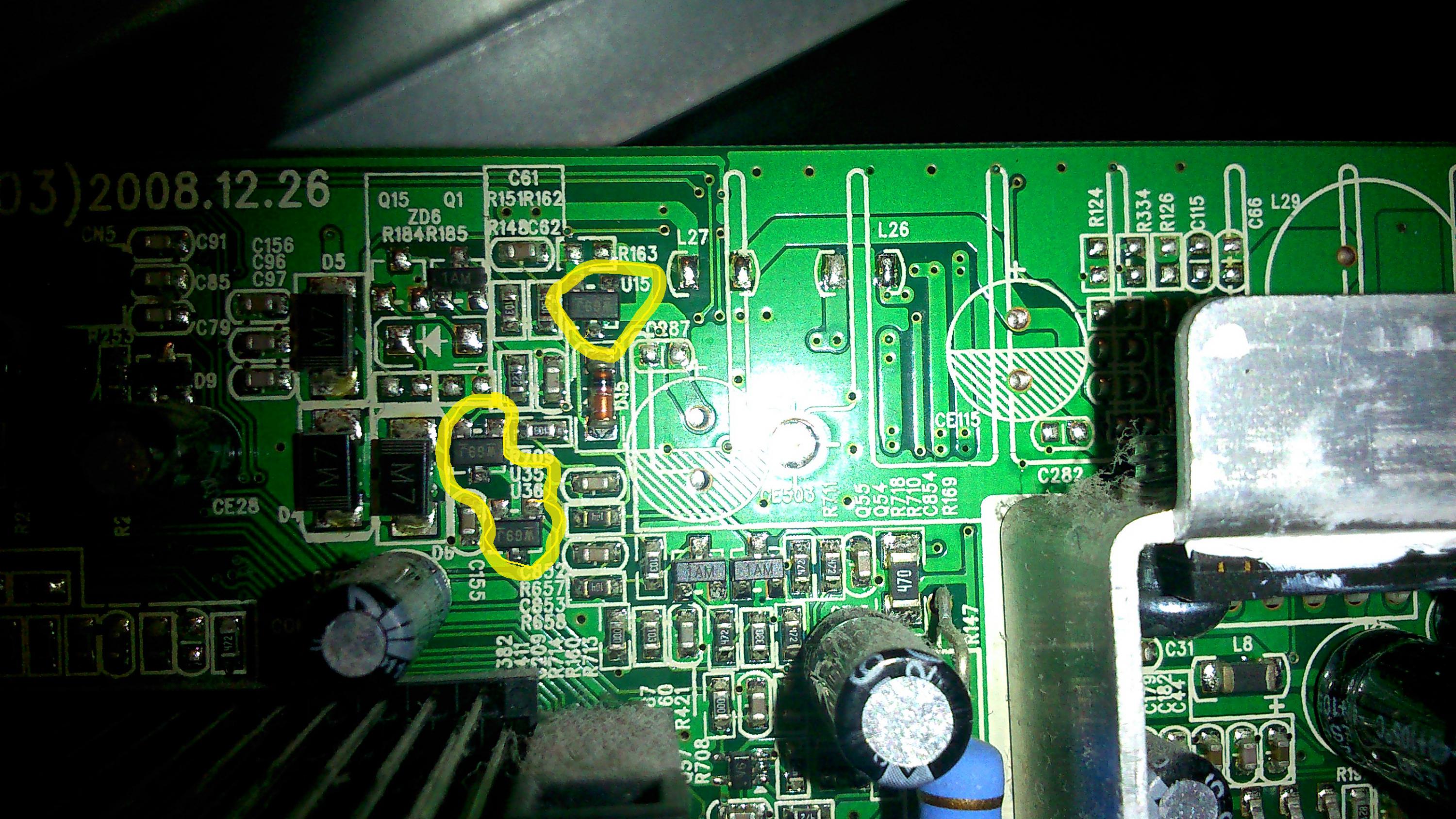

    Hi, can anyone give any assistance with this item - having problems finding out what it is as one is burnt out on board.
    looks like id WG9J or W89J ?
    Picture not the best but should be ok for id process.
    this is from an unbranded 32" lcd tv but matches Technika type and it off the main board L2M08 2008.12.26.
    any assistance would be great.

    Sorry it is not the best description but just trying to identify and replace one of these parts that has burnt.
    Thanks in advance

      If you search for the SMD code "G9" in here instead of WG9J, you'll get 9 different products but only one of them has 3 pins, which is of type BF 767, manufacturer is either Siemens or Philips.
      Then if you go and search for BF767 in this page, you will indeed find Siemens and Philips datasheets for BF767.
      This Philips one for example, which is a PNP Silicon Planar Transistor BTW, is indeed used in TV tuners:

          it is definitely WG9J and definitely some kind of planar surface-mount transistor
          if it was me, I would replace every electrolytic cap in this TV, those transistors don't burn for no reason!

              Well I am slightly confused, when trying to locate to order some of these the identification is not showing up, can find some types but unsure of the values needed any pointers from the technically minded at badcaps?

                search on KTC3876

                  I think this is a suitable crossover to your part -
                  www.vetco.net/catalog/product_info.php?products_id=2935

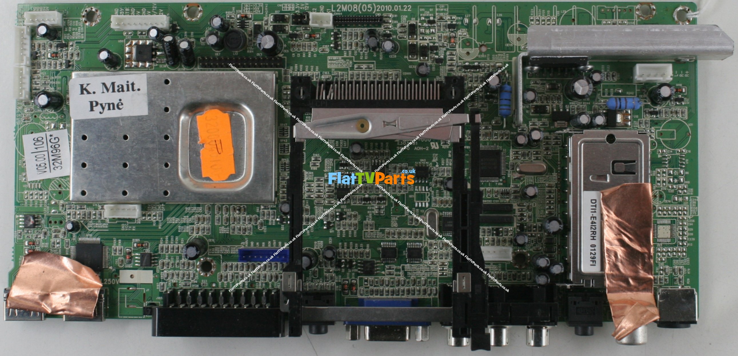

                        unbranded 32" lcd tv L2M08 MAIN AV BOARD
                        I HAVE A PROBLEM WITH SOUND
                        THE SOUND WORKS WHEN TURNED ON AND AFTER 20MINS THE SOUND GOES
                        NEED DIAGRAM OF THE BOARD AND ANY INFO SO I CAN REPAIR

                          post high resolution photos of the board, often times problems like bad capacitors will be obvious

                            Ive checked some capacitors and tried the black resister on the back but no luck yet

                              you need to post these questions to the badcaps TV subforum - that is where the TV gurus are on here!
