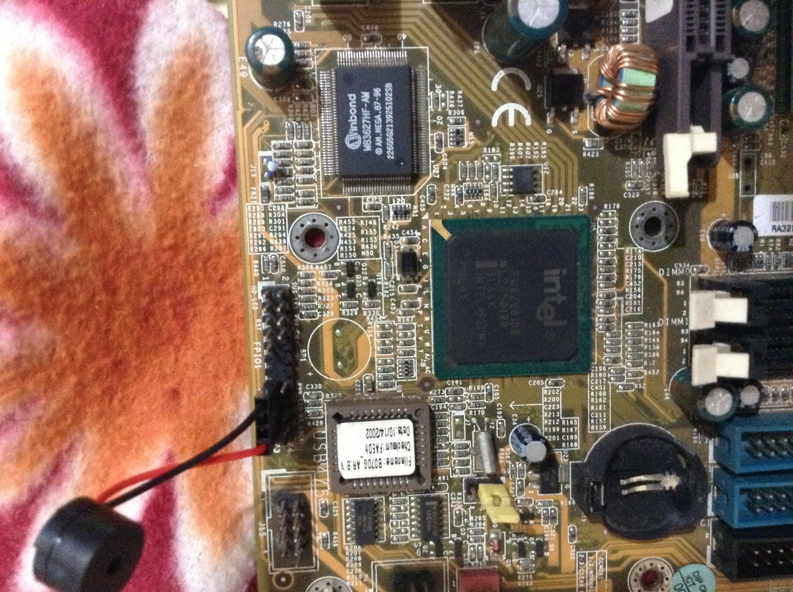

                    #49
                    Re: memory test fail -bad capacitor
                    Here the image
                    • srt1
                      • Aug 2013
                      • 177
                      • india
                      #50
                      I am using monitor also .. Stile have beep sound while windows loading .. Also Its not stoping.also no error codes. As i said before its not affecting in operation windows loading smmothly and application also working

                        #51
                        Originally posted by srt1
                        I buy this motherboard from loacal store. its second hand. So i dont know wat model but ithink its Evo d380mx bd-70g. On the motherboard its written compaq bd-70g. Also i found another problem on this board sometimes its not power on.when i touch on the crytal lead near south bridge its start posting. I am using post debug card also so i can see its start posting.what could be the reason for it? Also i noted its crytal not grounded.(grounding is not removed beacuse ther is no sign of soldering).
                        The crystal does not need to be grounded in most cases. The small wire is used to keep the crystal from being pulled up.

                          #52
                          The beep could mean that the cpu may be detected as too hot. May need to check the heatsink for proper seating also make sure that cpu fan is spinning and is being detected in rpm speed monitor.

                              #54
                              Yes i checked in bios pc health status . Cpu temp is normal 41c and also cpu fan showing its speed. I found another two fans rpm but is 0 reading . One front fan and another is chasis fan.i take a fan and conected to chsis fan conector.surprisingly beep sound stop. tahnk you..
