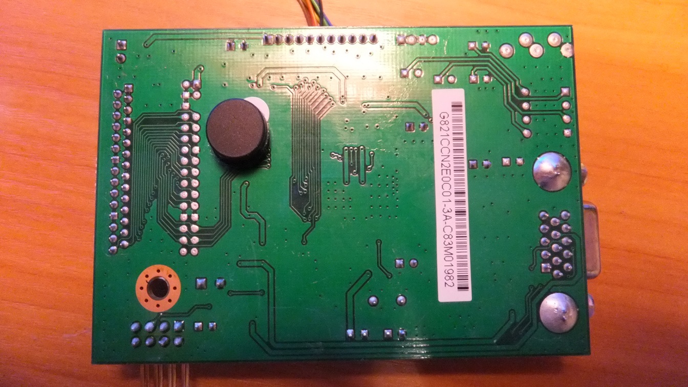

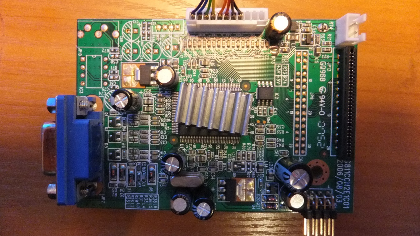

    Hello, I am recapping my monitor and also want to replace the low quality capacitors on the logic board.
    The caps on the logic board are following:
    3x Canicon 220uF 16V 6x12mm
    1x Canicon 470uF 16V 8x14mm
    4x Evercon 100uF 16V 6x8mm
    width x height
    What could I use to replace them?
    There was no series marked on the capacitors, on the Canicons it reads just the brand, capacitance value, voltage and 105C temperature. Nothing else.
    On the Evercons after the temperature there is a circled E letter and under that E83A which is the date code I assume. No clear indication about the series either...
    I will be ordering from Digikey this time.

      Here you go
      Thanks in advance
      • mariushm
        • May 2011
        • 3799
        Re: Replacements for Canicon and Evercon
        You can use pretty much any general purpose capacitor there, all the heavy work when it comes to producing power is done on the other board.
        That board only has some linear voltage regulators, which don't need capacitors that are very low esr (in fact some linear voltage regulators don't like having very low esr capacitors).
        I would use Panasonic FC, Nichicon HD or HE, United Chemi Con KZH, KZM, LXZ .. all these should work just fine.

          Thank you. So I ended up choosing these:
          http://www.digikey.fi/product-detail...529187?cur=USD
          http://www.digikey.fi/product-detail...529188?cur=USD
          https://www.digikey.fi/product-detai...356102?cur=USD
          So these should be allright? Is KZM too low ESR? Does KZM have the same problems as KZG series?

              Thank you. I swapped the 100uF 16V Panasonic FC's to 100uF 25V Nichicon HE's due to lower price and better specs.
              And the Rubycons were out of stock, so I used Panasonic FR instead of them to replace the Hermei LE capacitors too.
              The monitor works like a charm now. I'm thinking that it should be pretty durable with all new capacitors.
