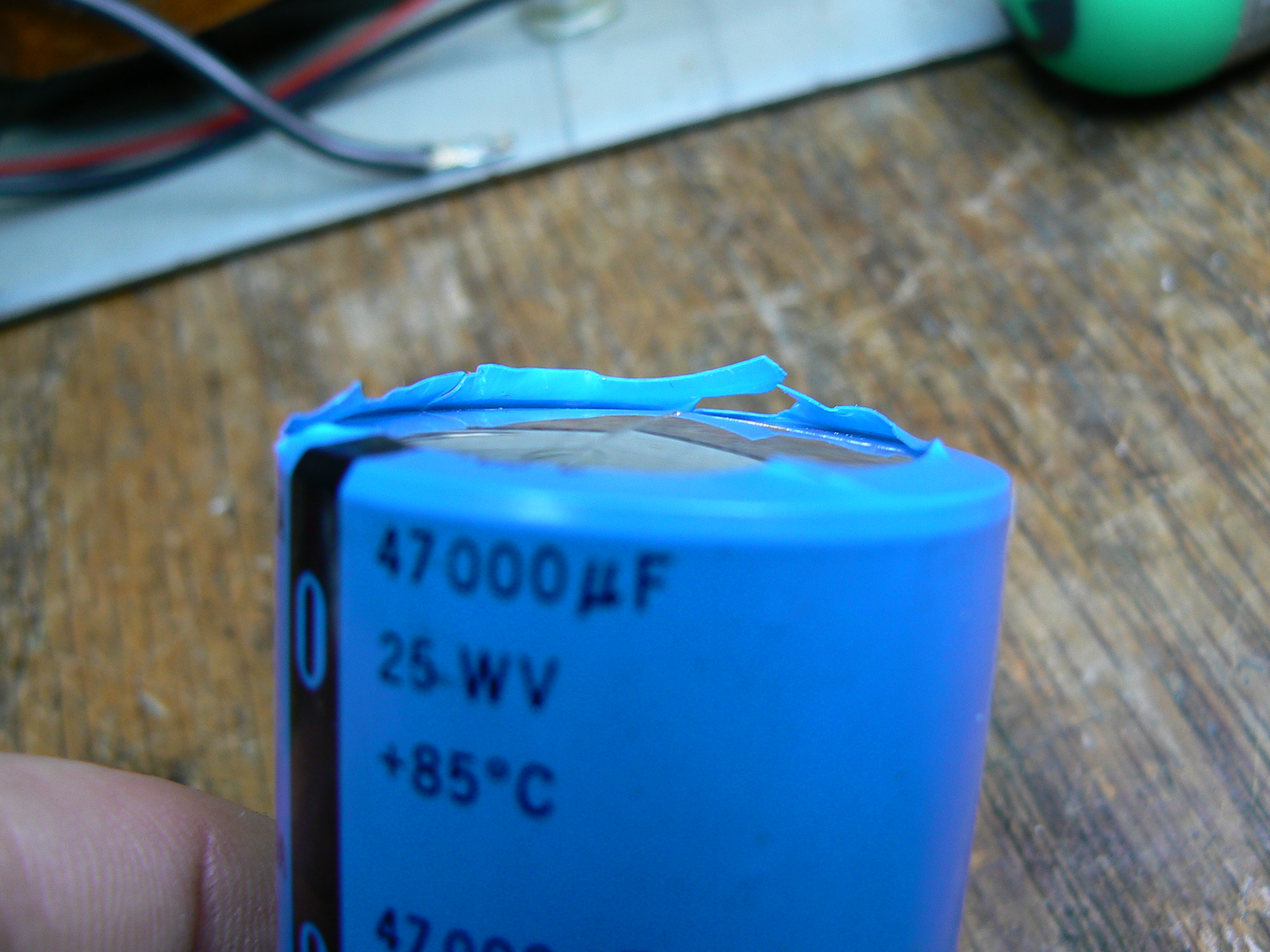

Should these caps be replaced?
  • LDSisHere
    • May 2012
    • 727
    • U.S.A.

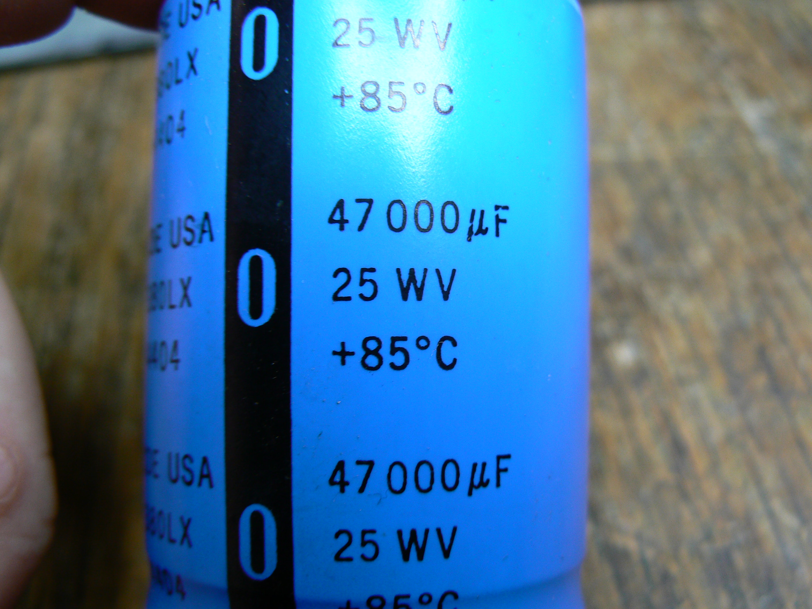

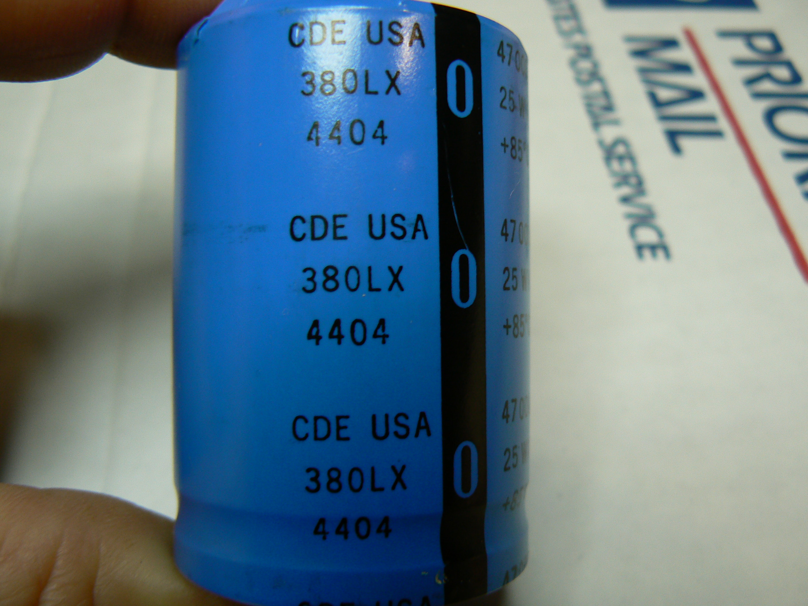

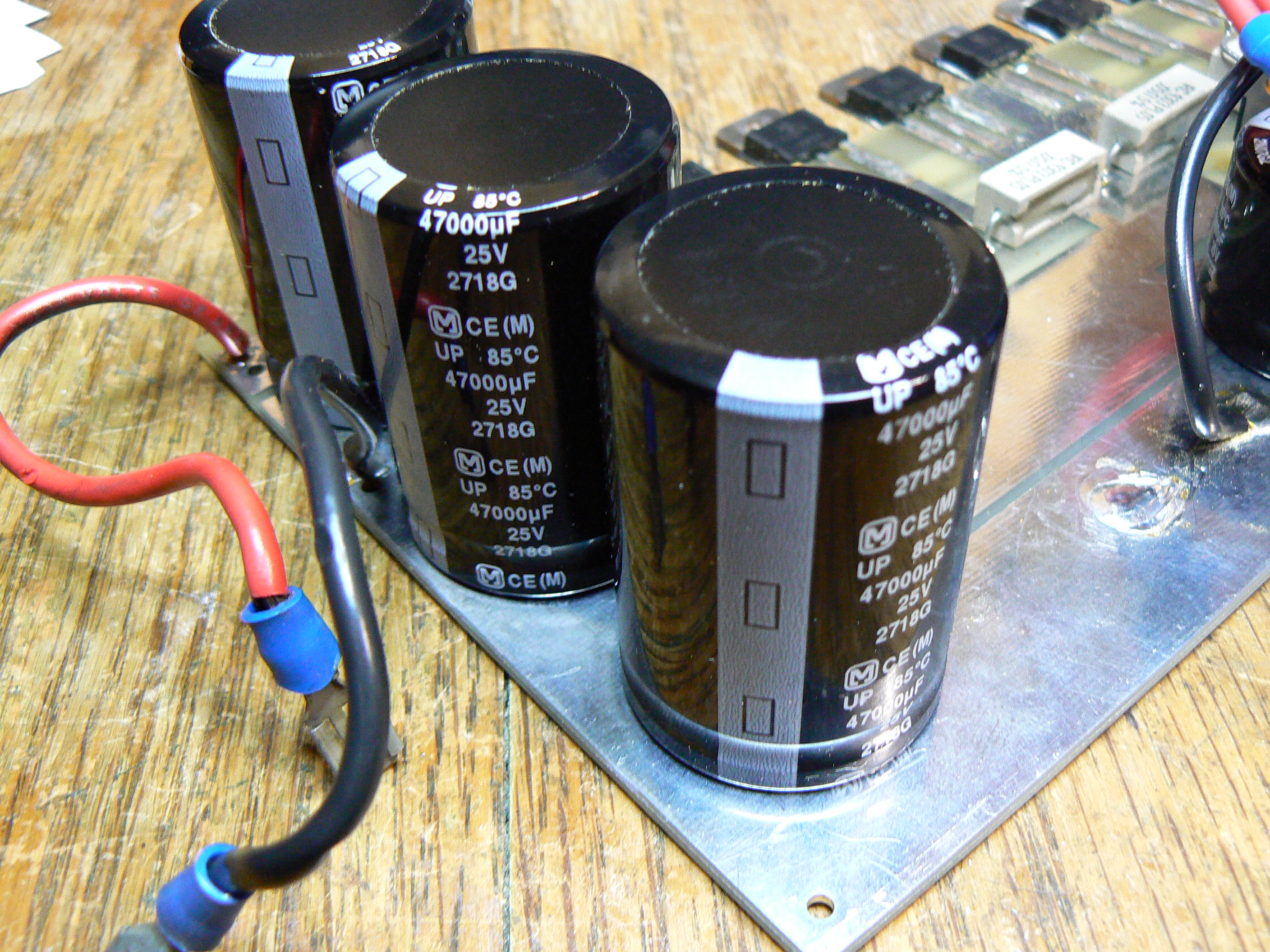

    I am repairing a linear power supply with a blown bridge rectifier. It has three huge caps that I am not sure are bad. The tops are slightly domed but the vents have not popped. They test 0.01 ohms on my Blue ESR meter and I have no way to test the capacitance since they are 47,000 uF. It looks to me that from the date code they are from 2004 so about 9 years old.
    This is the Digi Key link for the exact same caps: http://www.digikey.com/product-searc...ds=338-2267-ND
    This is the link to the caps I will most likely get if they need to be replaced since they are a lot cheaper and the same basic specs: http://www.digikey.com/product-searc...081?k=P6901-ND
    I have attached the datasheet for both brands of capacitors.
    I am leaning toward just replacing them to be on the safe side but I thought it would be a good idea to get some input from the forum before spending the money. Any constructive feedback would be appreciated.
    Thanks!

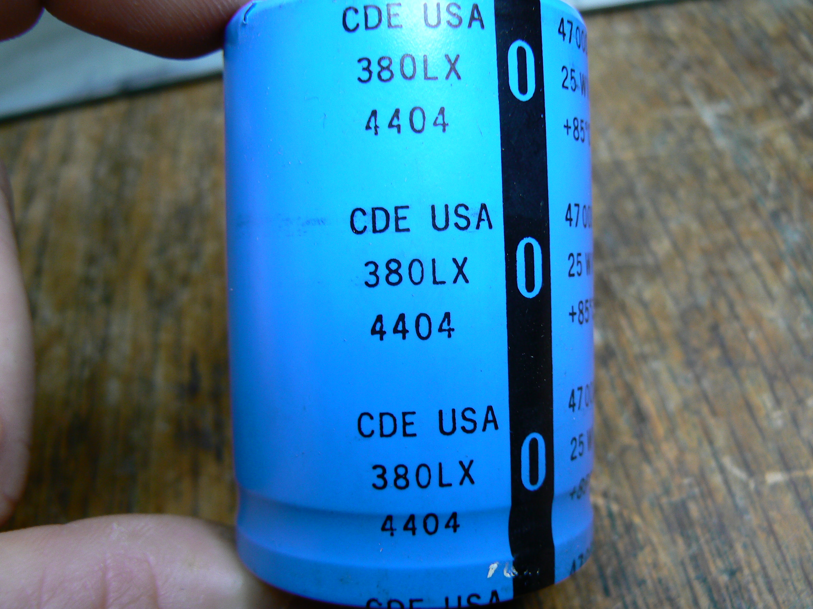

    looked domed to me - cant understand why the cornell doublier should be so much more expensive.
    maplins stock that brand - they are similar to radioshack!!

      They definitely suffered some abuse. I would replace them just to be sure.

        Seems strange that they have bulged, but sometimes with light loads, the power supply rails can go up somewhat, and this occasionally causes this to happen. If it is the cause, get 35v caps if you can, and if you can fit them!...

          Even if they were the same price I would still go for the Panasonic's, however at $4 apiece cheaper I would be crazy to not get the Panasonic's.
          This supply is a linear 12V that is supposed to do up to 35A. These are 85 deg caps and the tops are almost touching the huge transformer so that could be the problem. This thing is probably heavily loaded when it is being used.
          Thanks for the input, I will go ahead and order them.

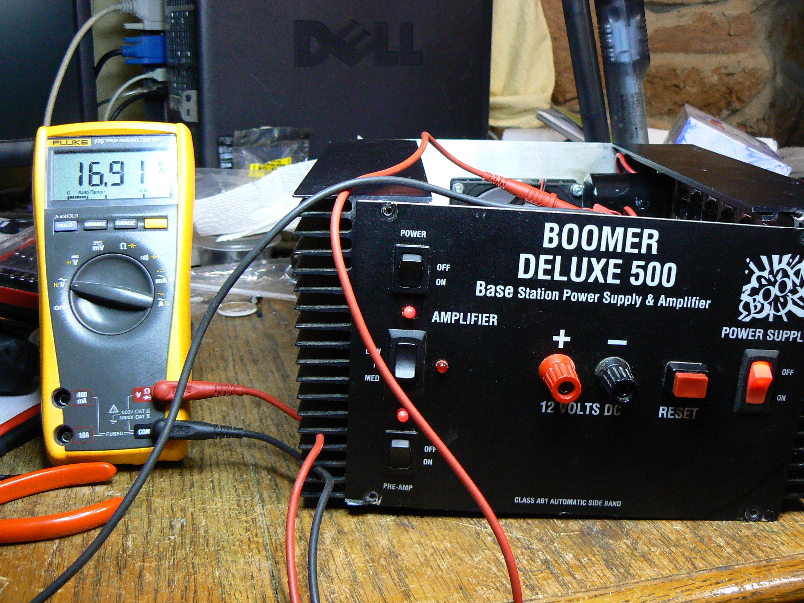

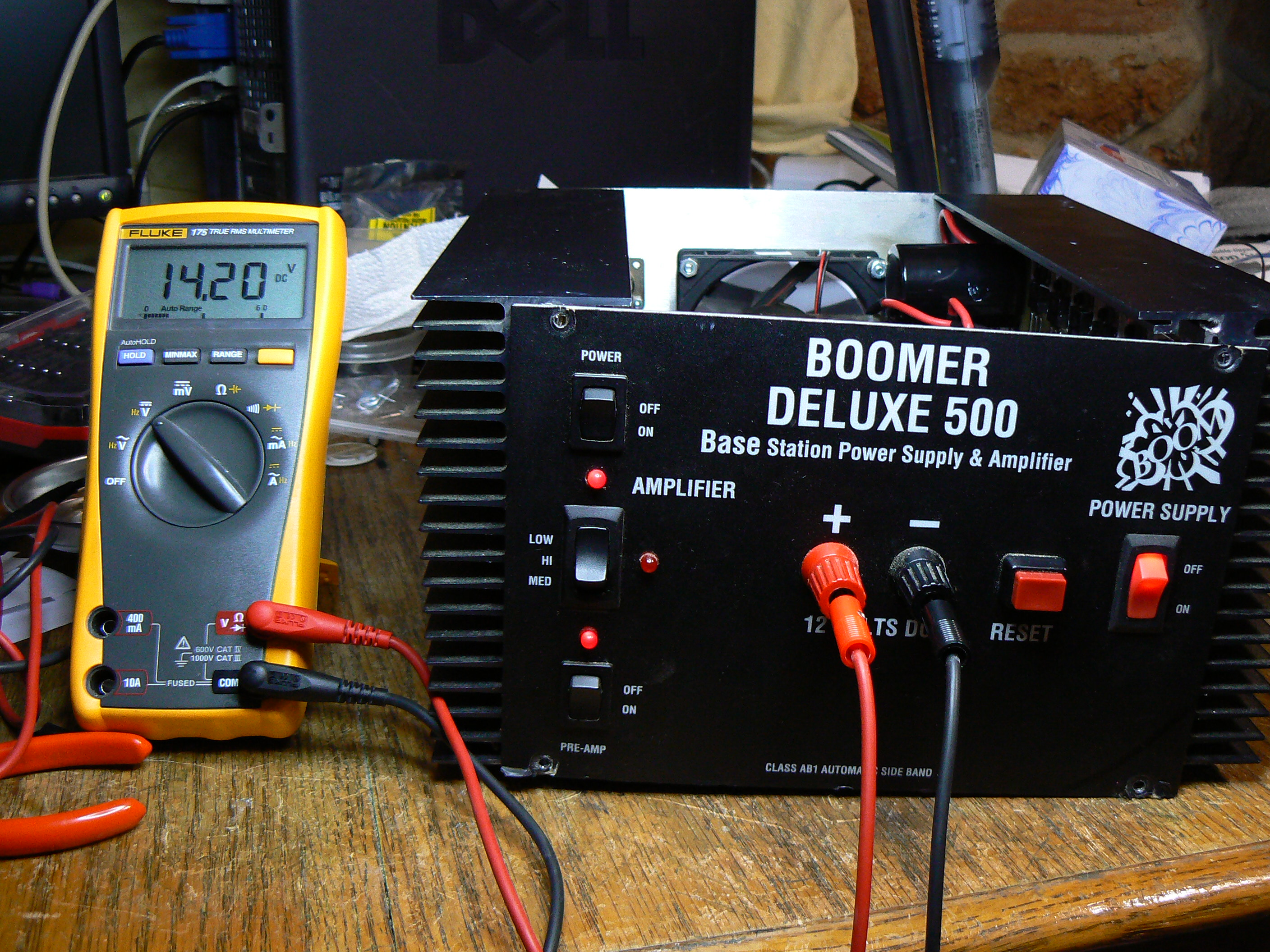

            Wait, put them back in and measure the voltage on the capacitors with no load on the power supply. It shouldn't be above the 25v rating of the capacitors. If it is, you will need higher voltage capacitors!

              I believe cornell doublier is highly regarded in the audio/hi-fi world? I think they are one of the last capacitor manufacturers Made In USA.
              The blue sleeving is/was also used by Sprague.
                I appreciate your concern, however I do not think the voltage being too high is a problem. The transformer that is feeding the rectifier is only putting out a little over 14V AC with no load and the rectifier is supposed to have a 1.1V drop. Additionally, these caps are supposed to be surge rated to 32V.
                From the dates I found in this thing it looks like it was made in the mid 90's so it appears to have been recapped once before, so going by this it was due once again.
                  I have no idea if they are good, okay or bad but I know for sure they are much more expensive at Digi-Key.
                  I was surprised by the USA on the label and by the fact that Digi-Key carried these exact same band\series\size caps.

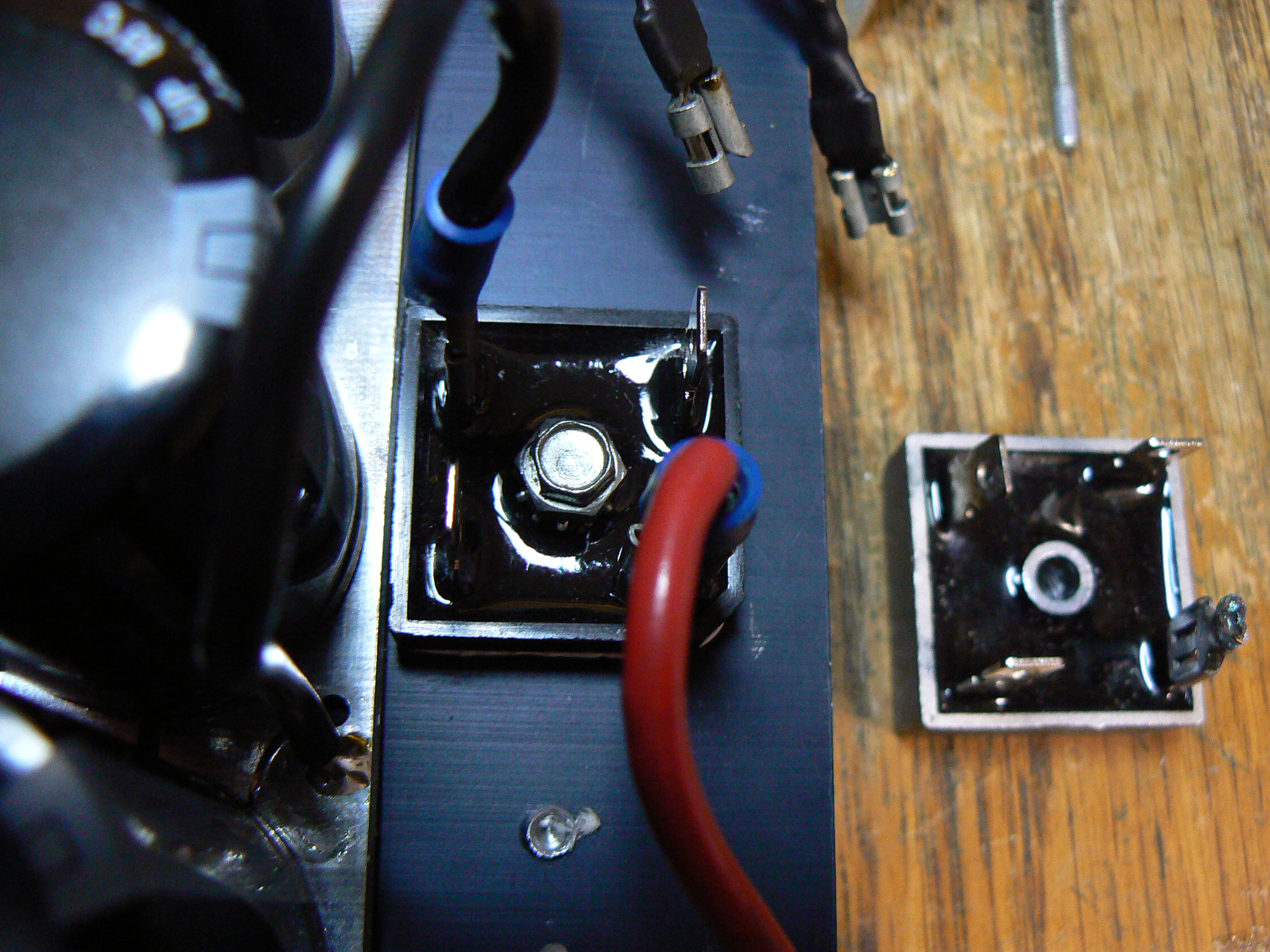

                        The 50A 1000V bridge rectifier was shorted when it was given to me to repair. Before I posted on here this morning I tested the rest of the components by using a 8 amp rectifier out of an ATX supply. It worked just fine. I had around 14V DC at the rectifier and approximately 13V DC on the output side of the board.

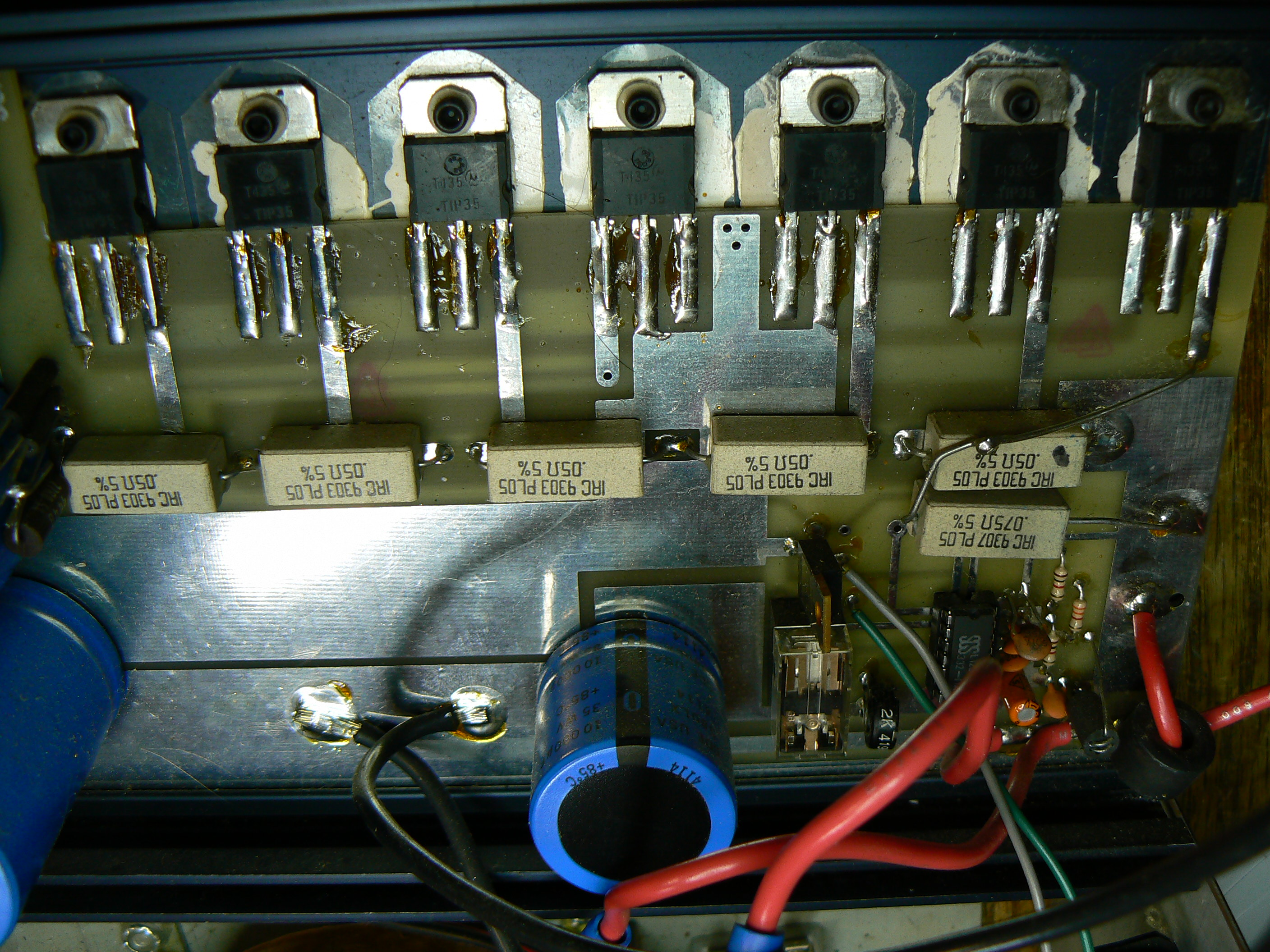

                        I think the purpose of this thing is to run automotive CB equipment from an AC power source and maybe boost the signal strength at the antenna.

                          I was wondering about the RF transistors in one of the photos. Makes sense now.

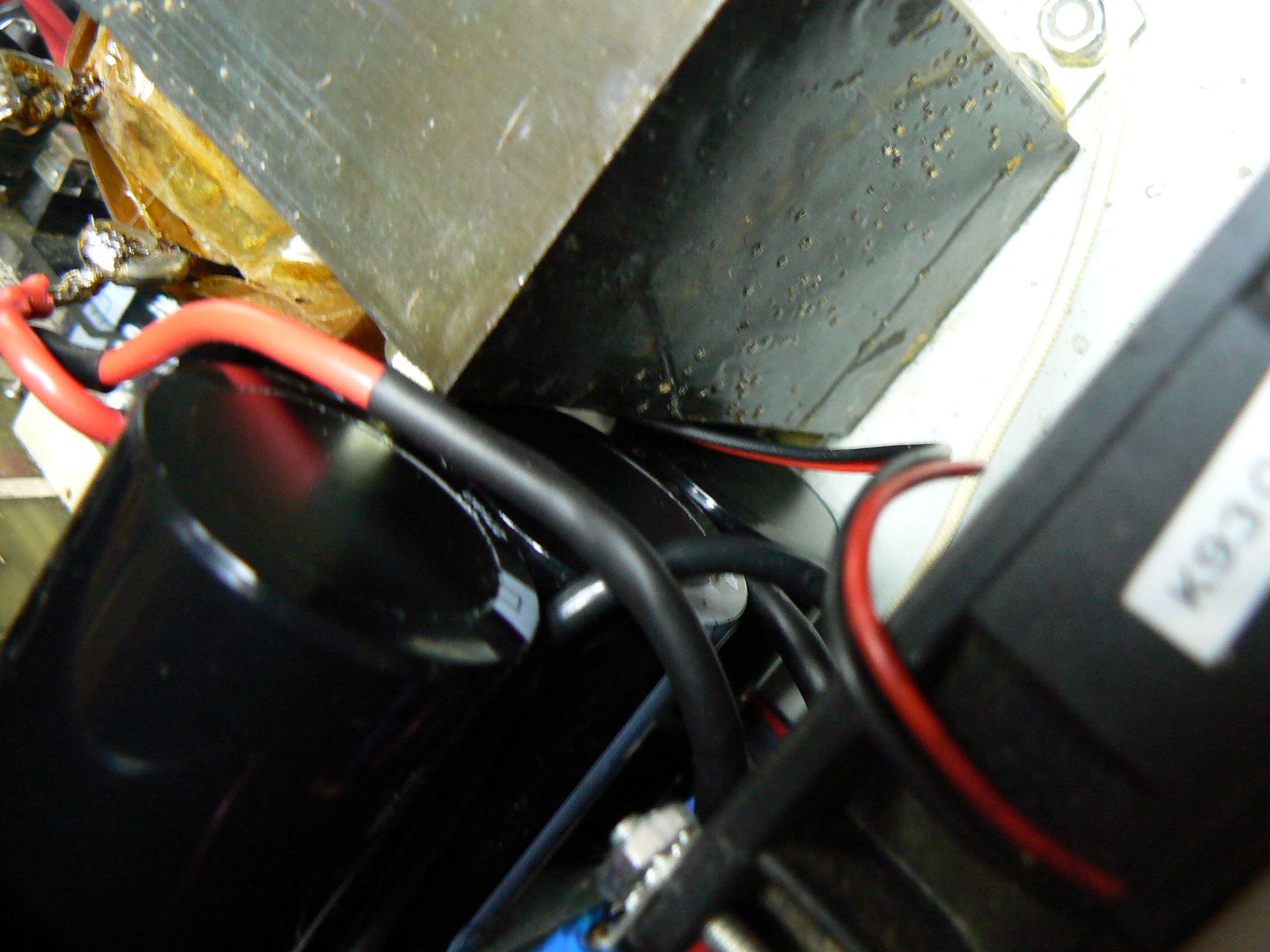

                              I got the caps and rectifier in today. I put everything back together and as best as I can tell, it is all working properly. I do not have any way to test the amplifier side.

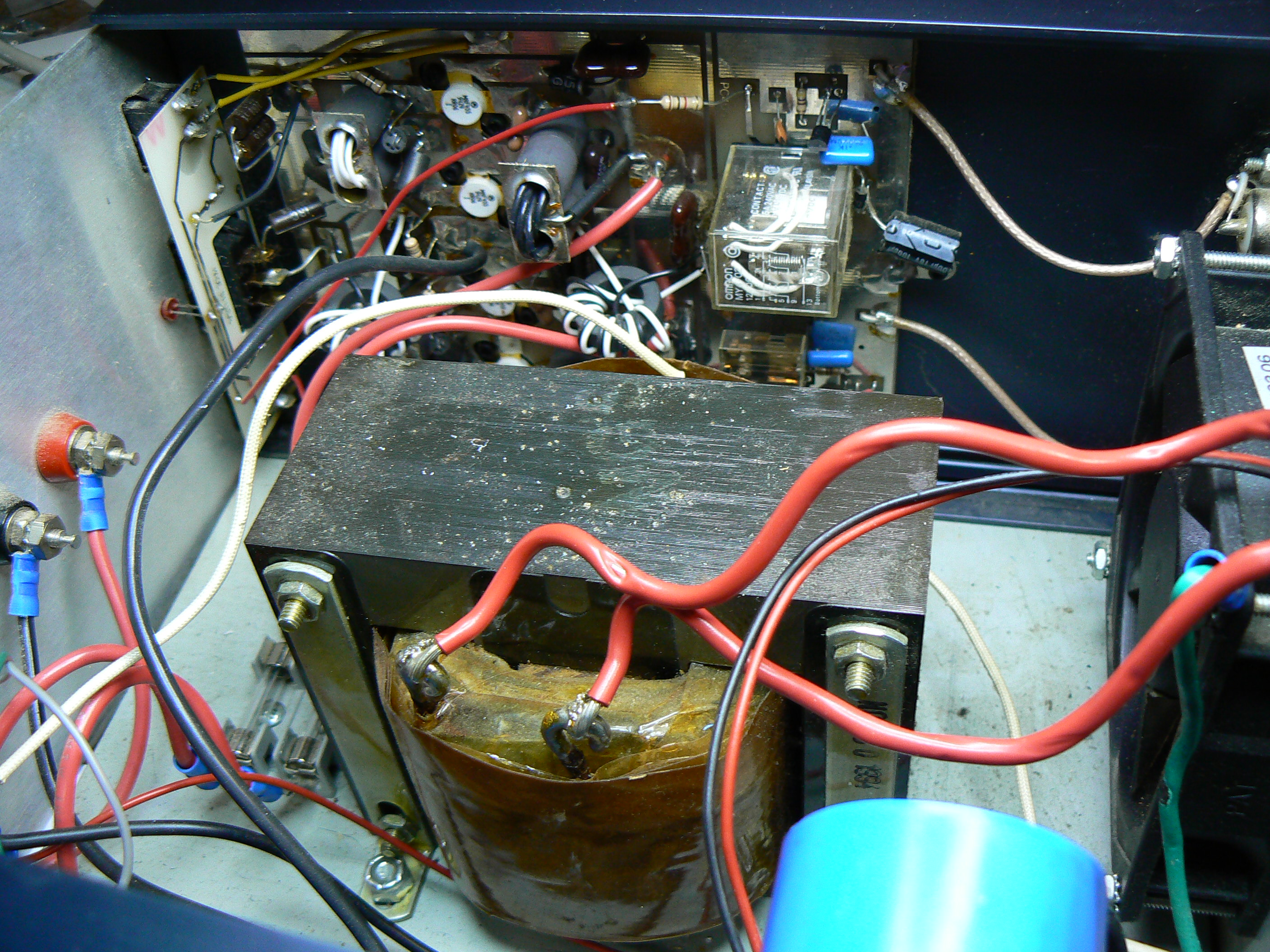

                              I included a couple of pictures too show how close the capacitors are to the transformer. The top cap was domed the least and the bottom one the most when I removed them. The "small" 10,000 uF was not domed at all, but I went ahead and replaced it along with all the other electrolytics in the supply to prevent any other problems in the near future.

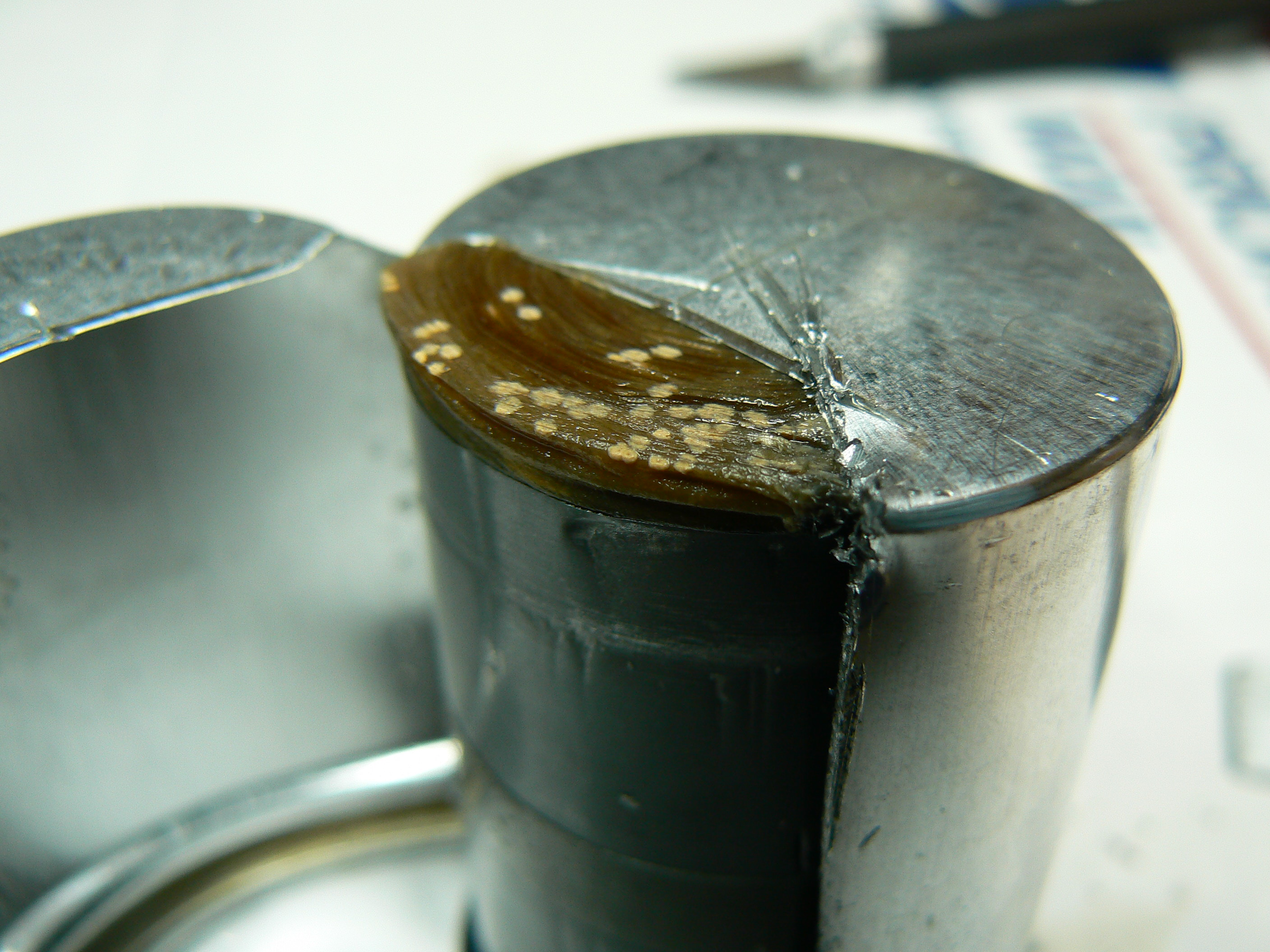

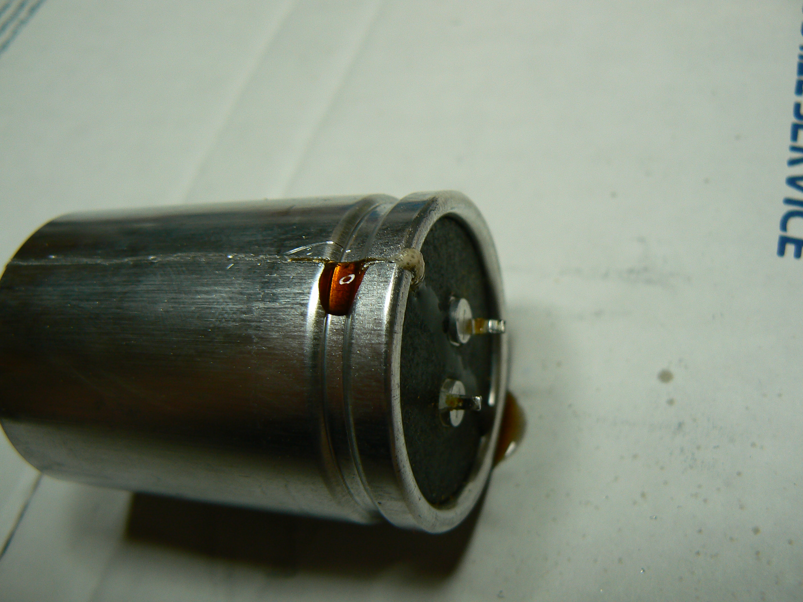

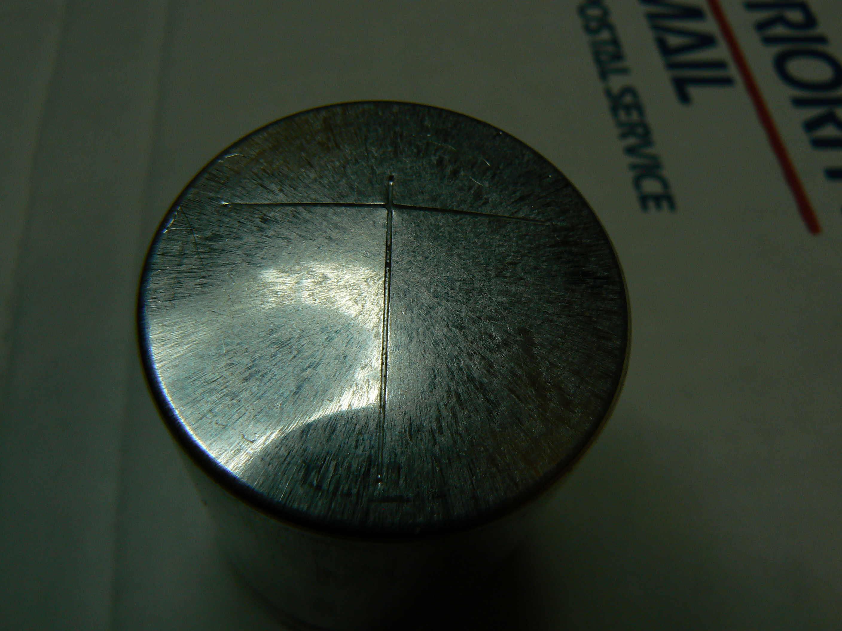

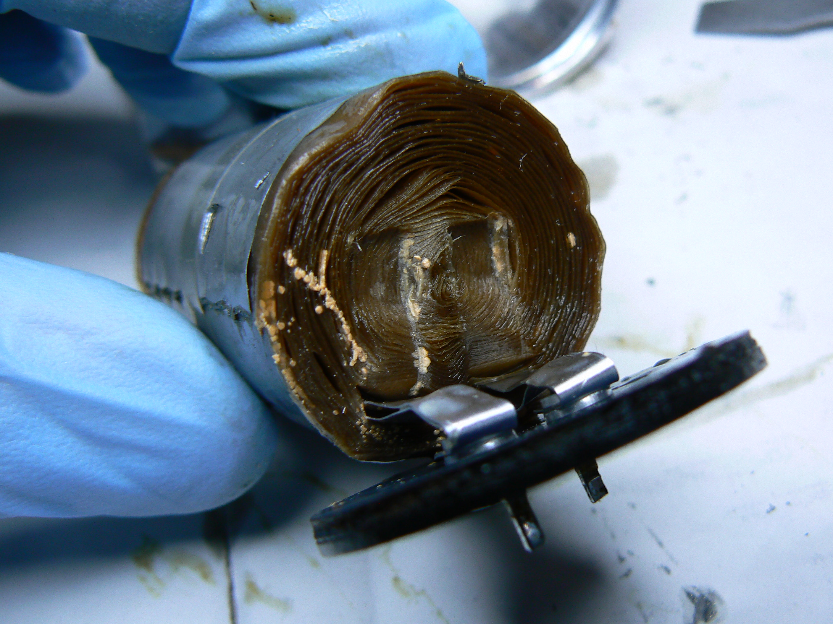

                                      • LDSisHere
                                        • May 2012
                                        • 727
                                        • U.S.A.
                                        Re: Should these caps be replaced?
                                        Originally posted by kc8adu
                                        used to see a lot of those with the bridge shorted.idiot cb'ers overloading the front terminals and then overdriving the amp.the whole unit is a pile of crap but they would hold together if you ran them right.
                                        Originally posted by ben7
                                        Did you toss the old ones yet?
                                        If not, it would be cool if you did an autopsy of them

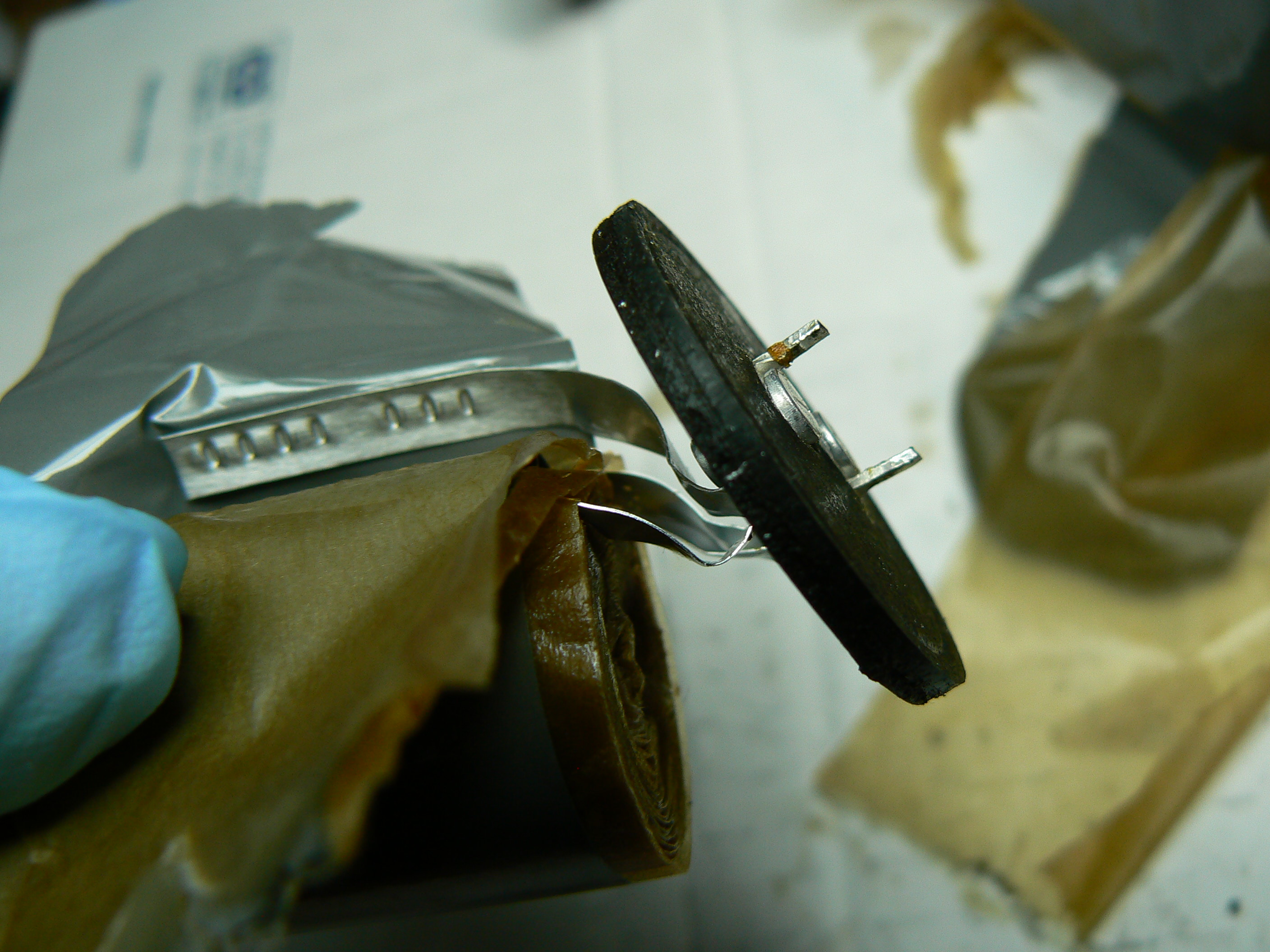

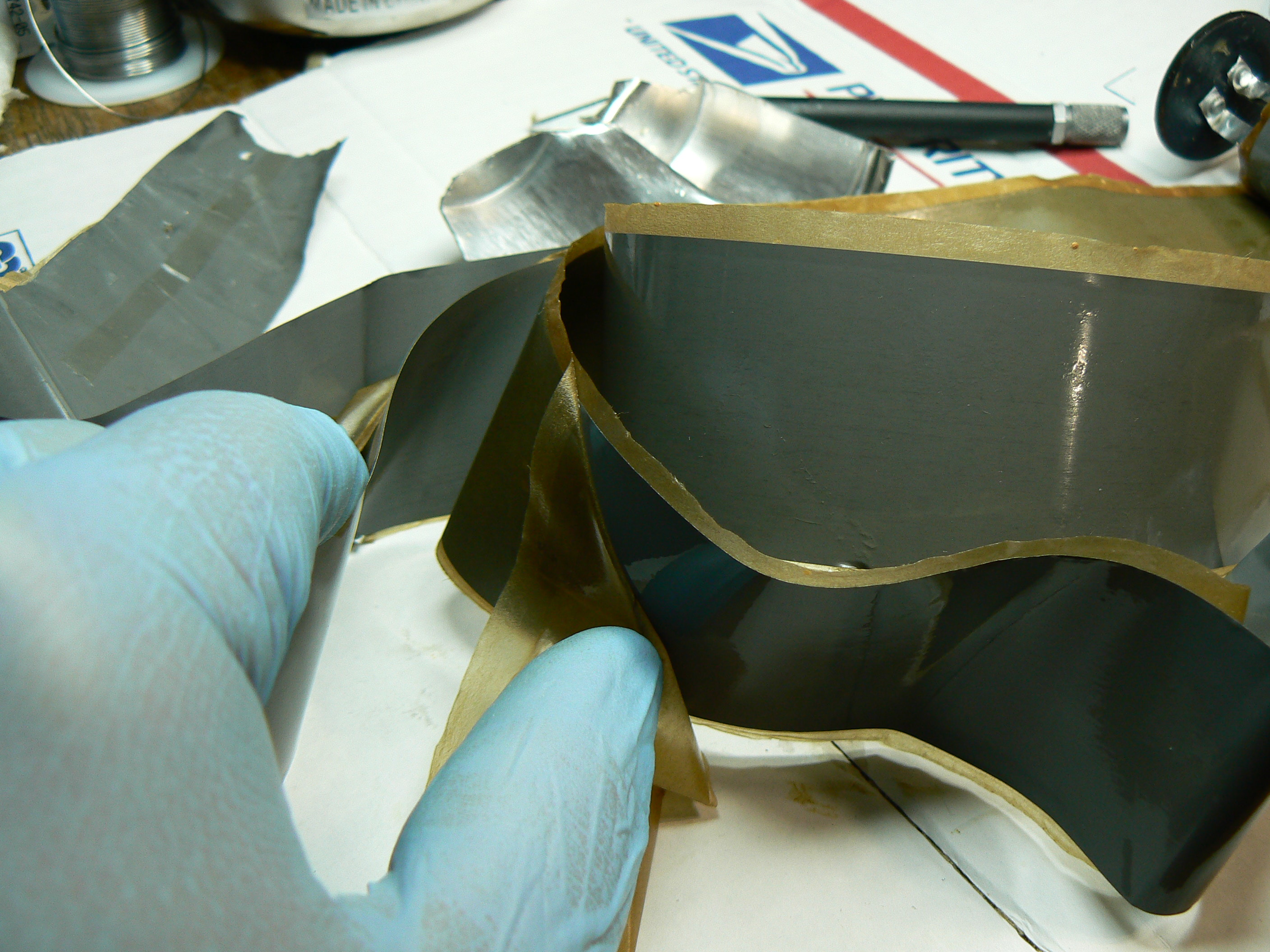

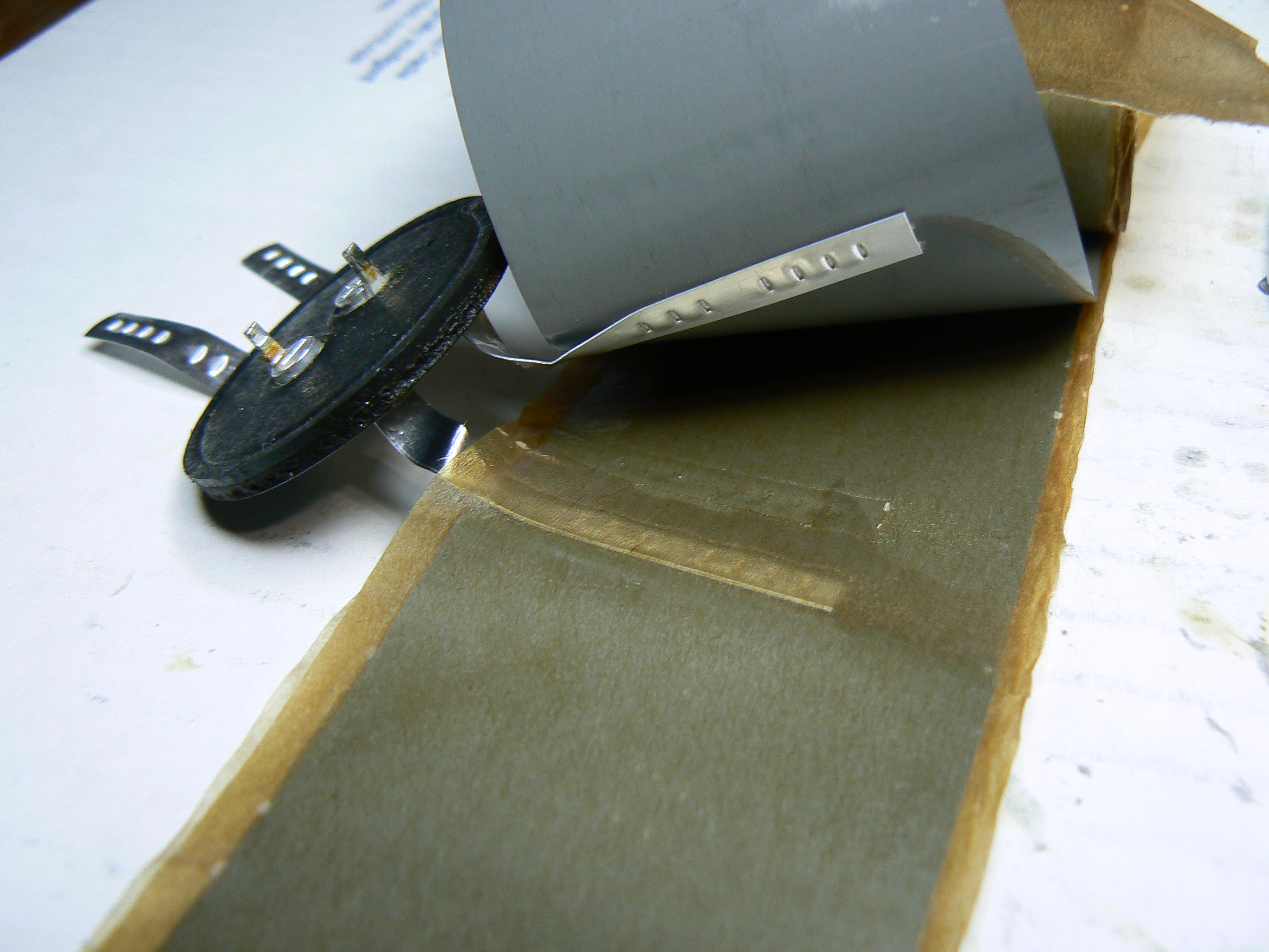

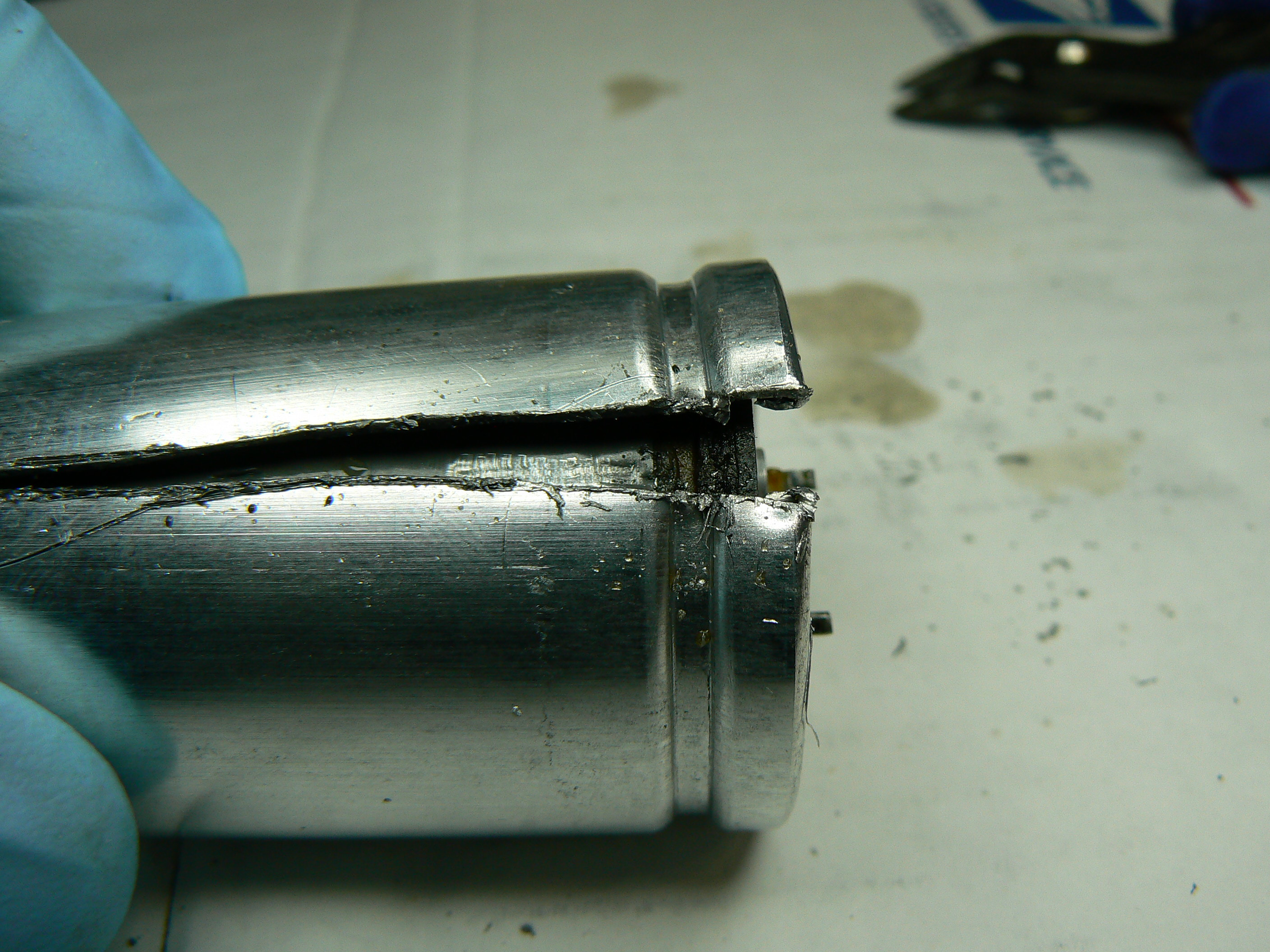

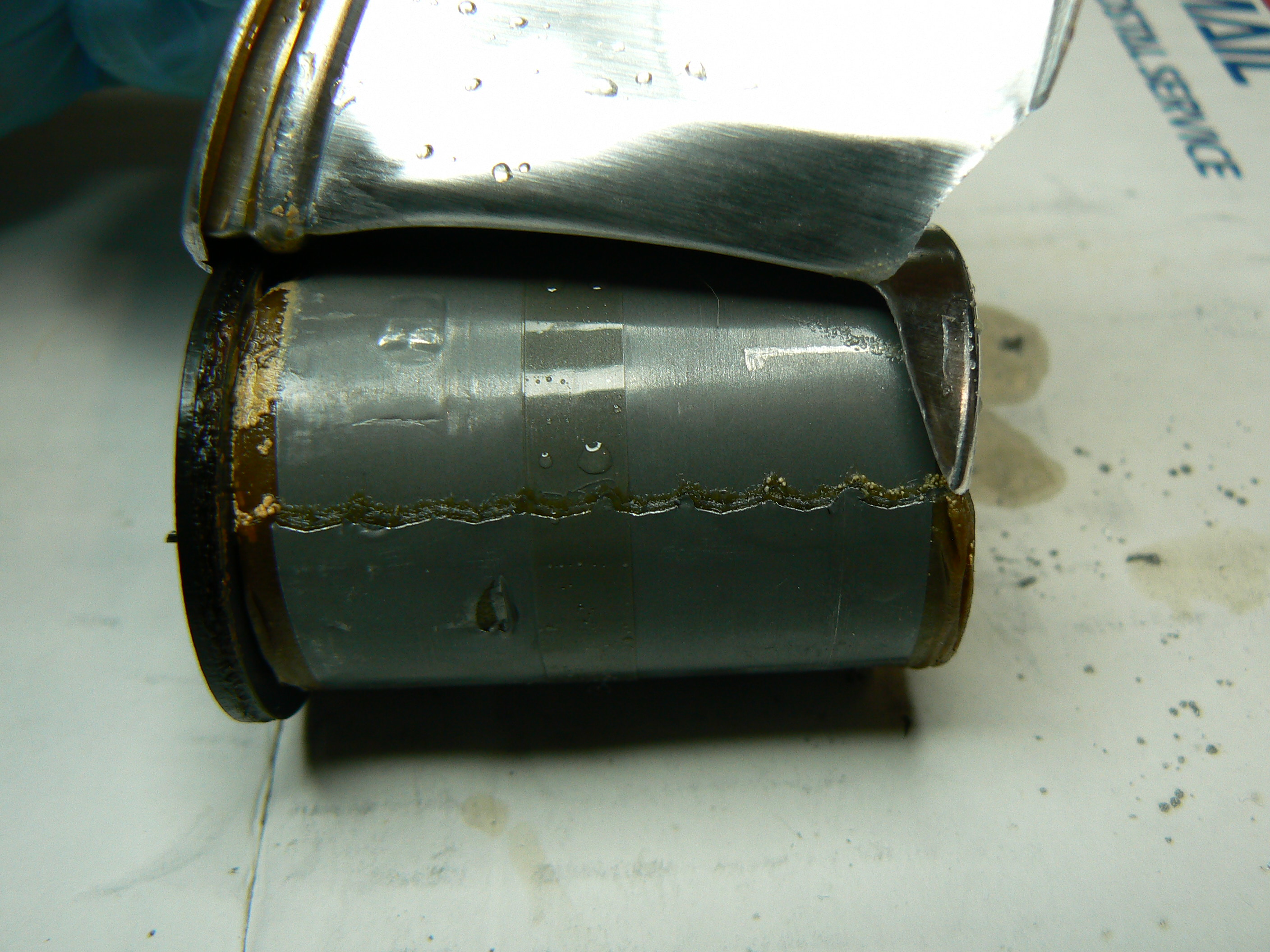

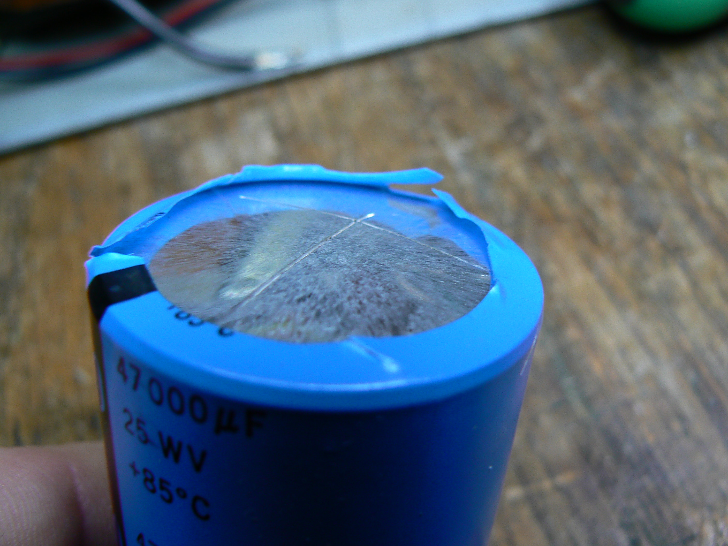

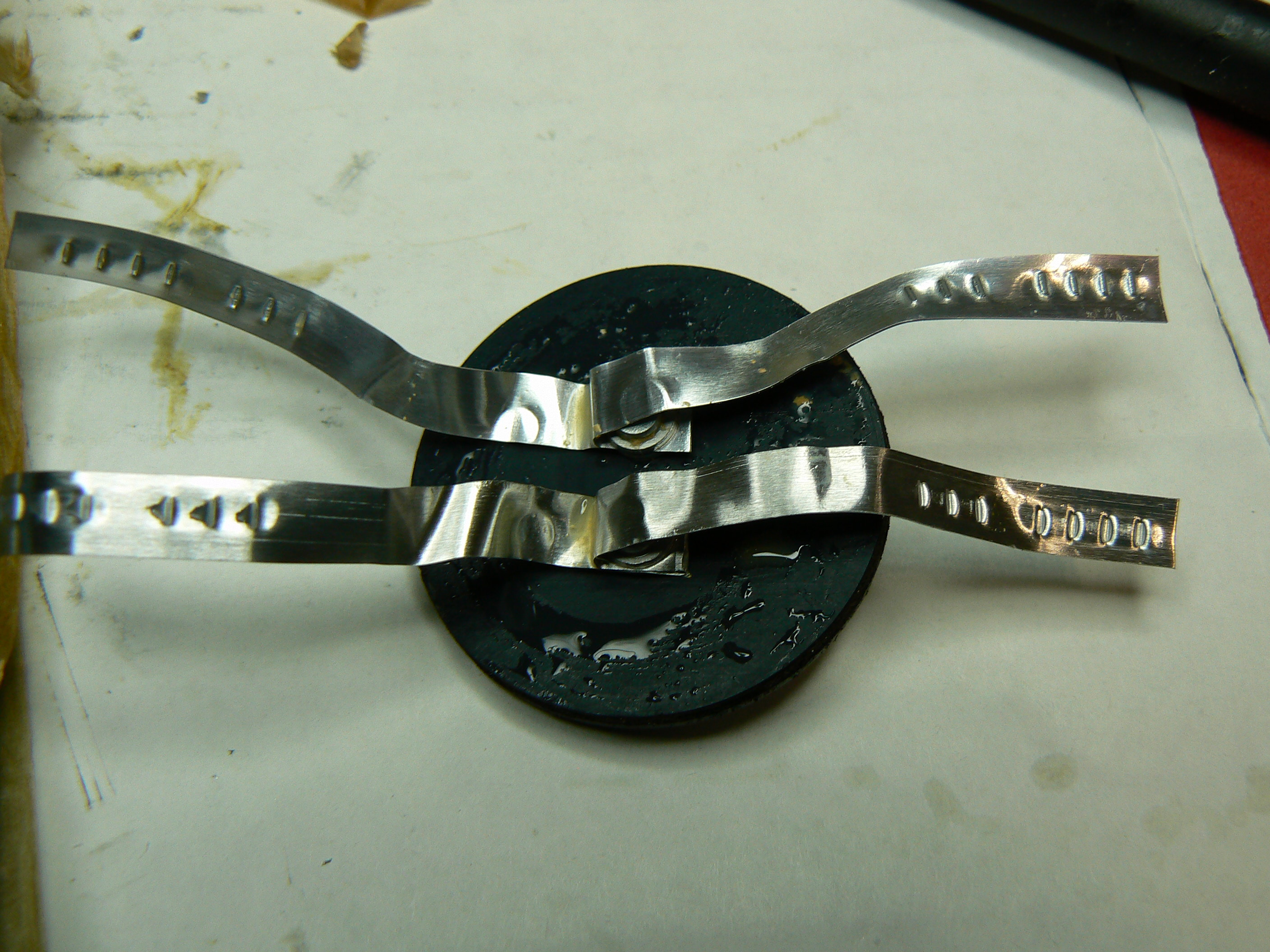

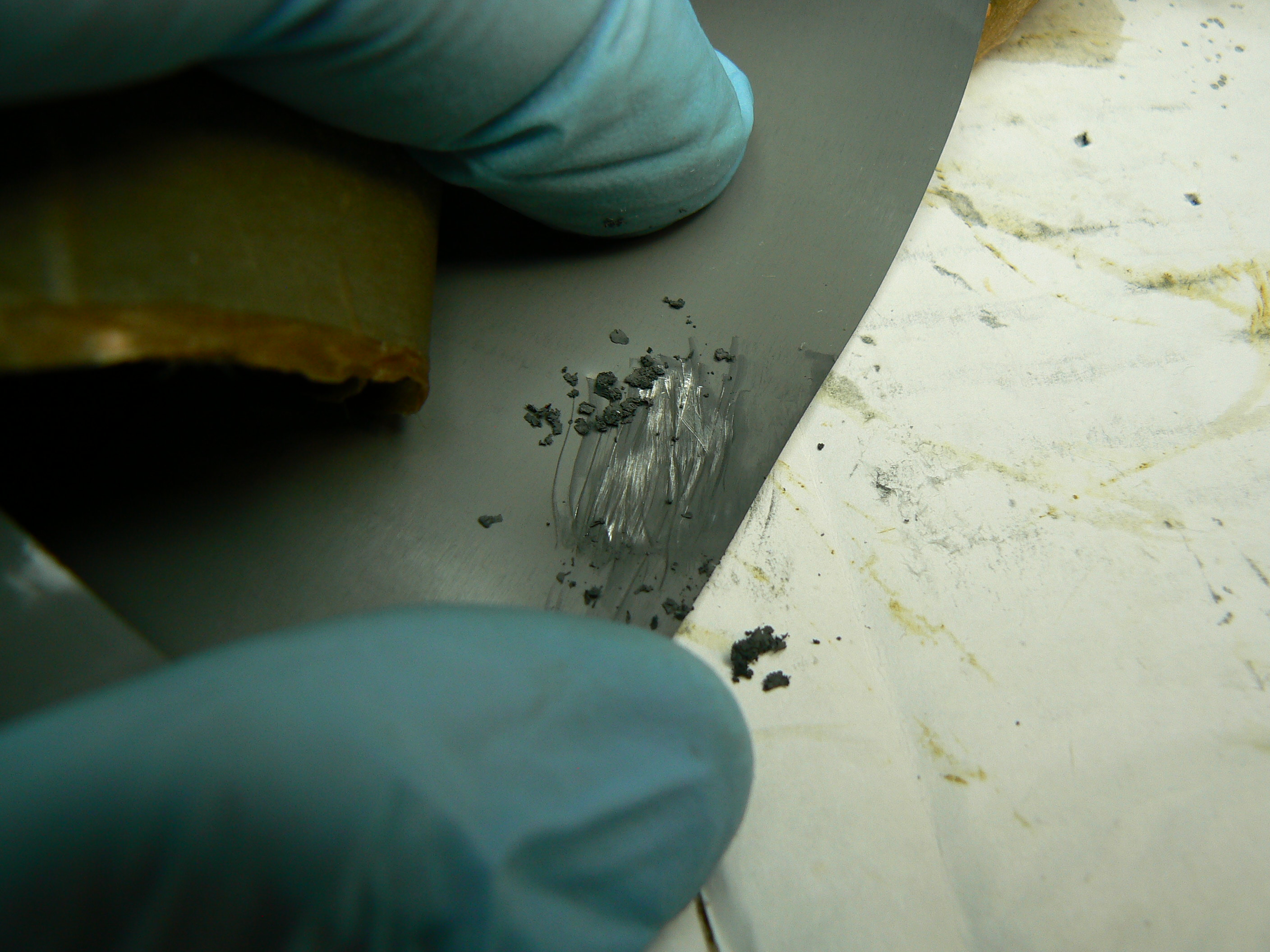

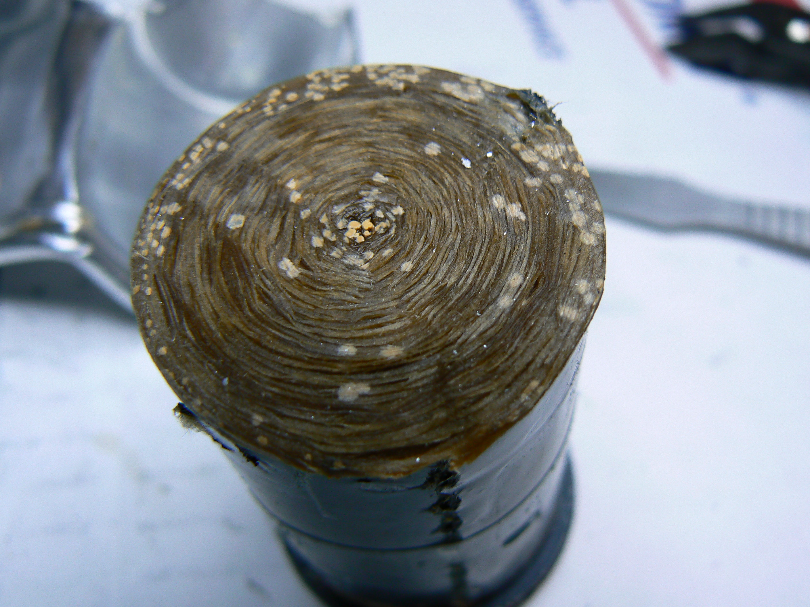

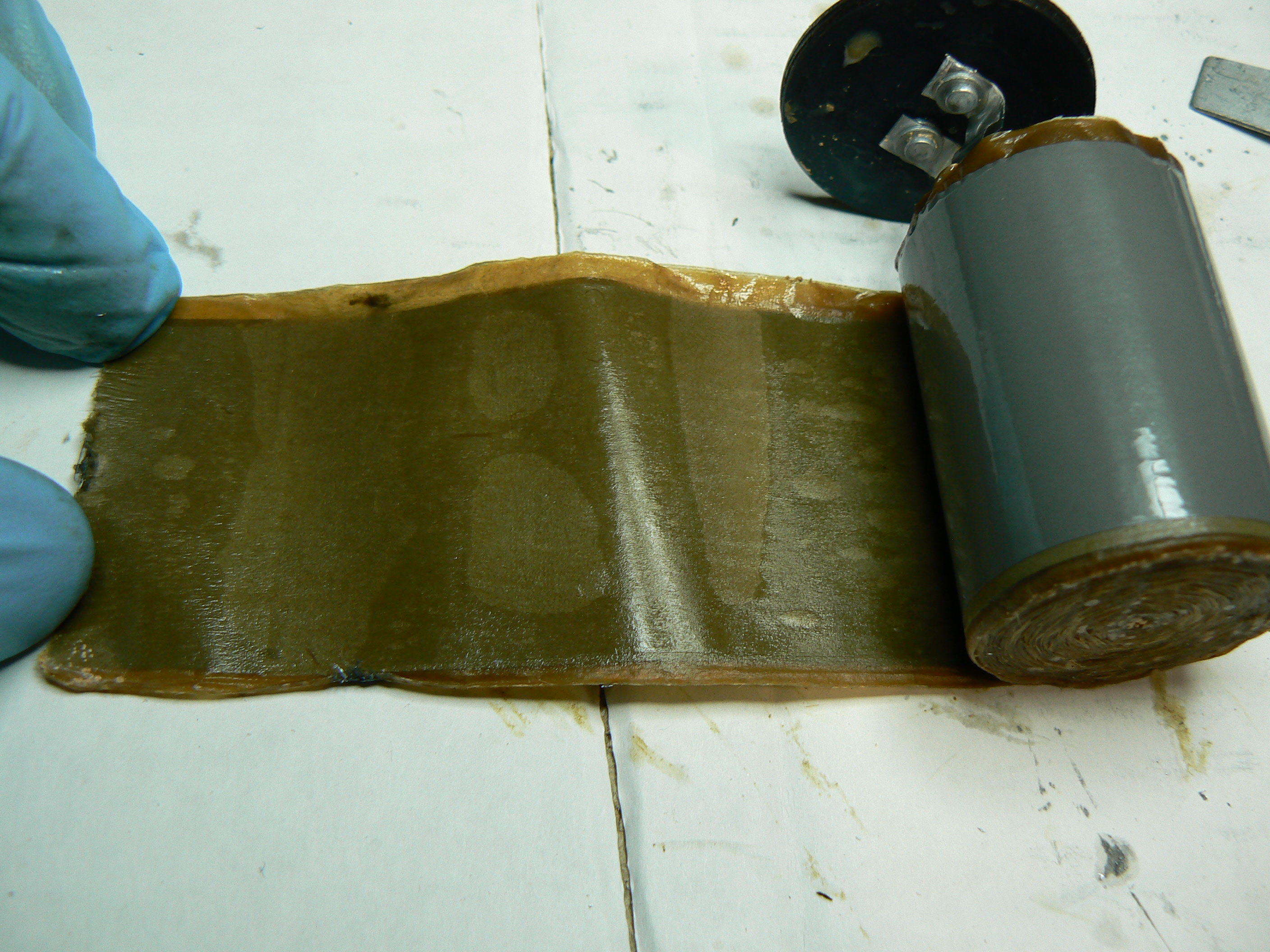

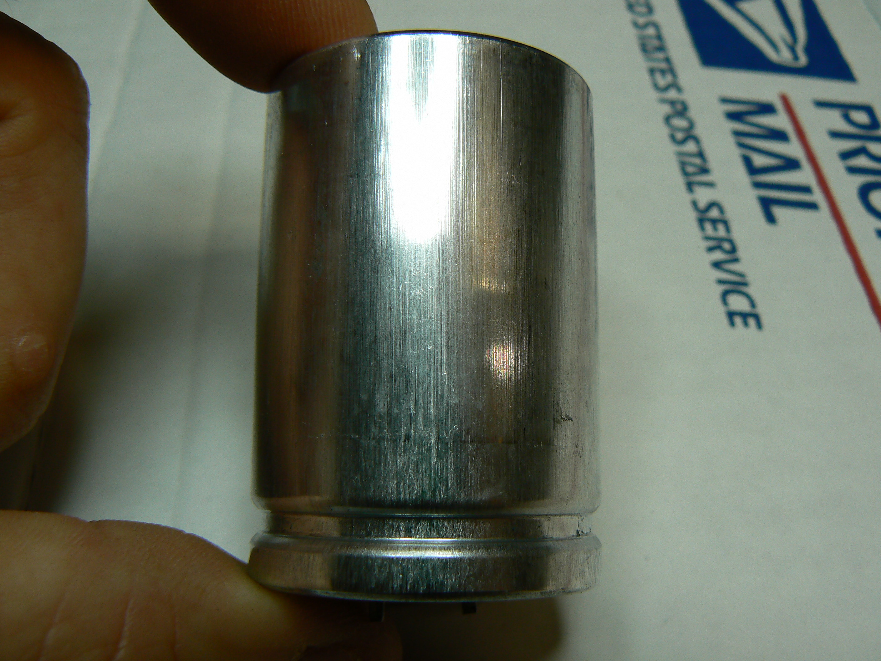

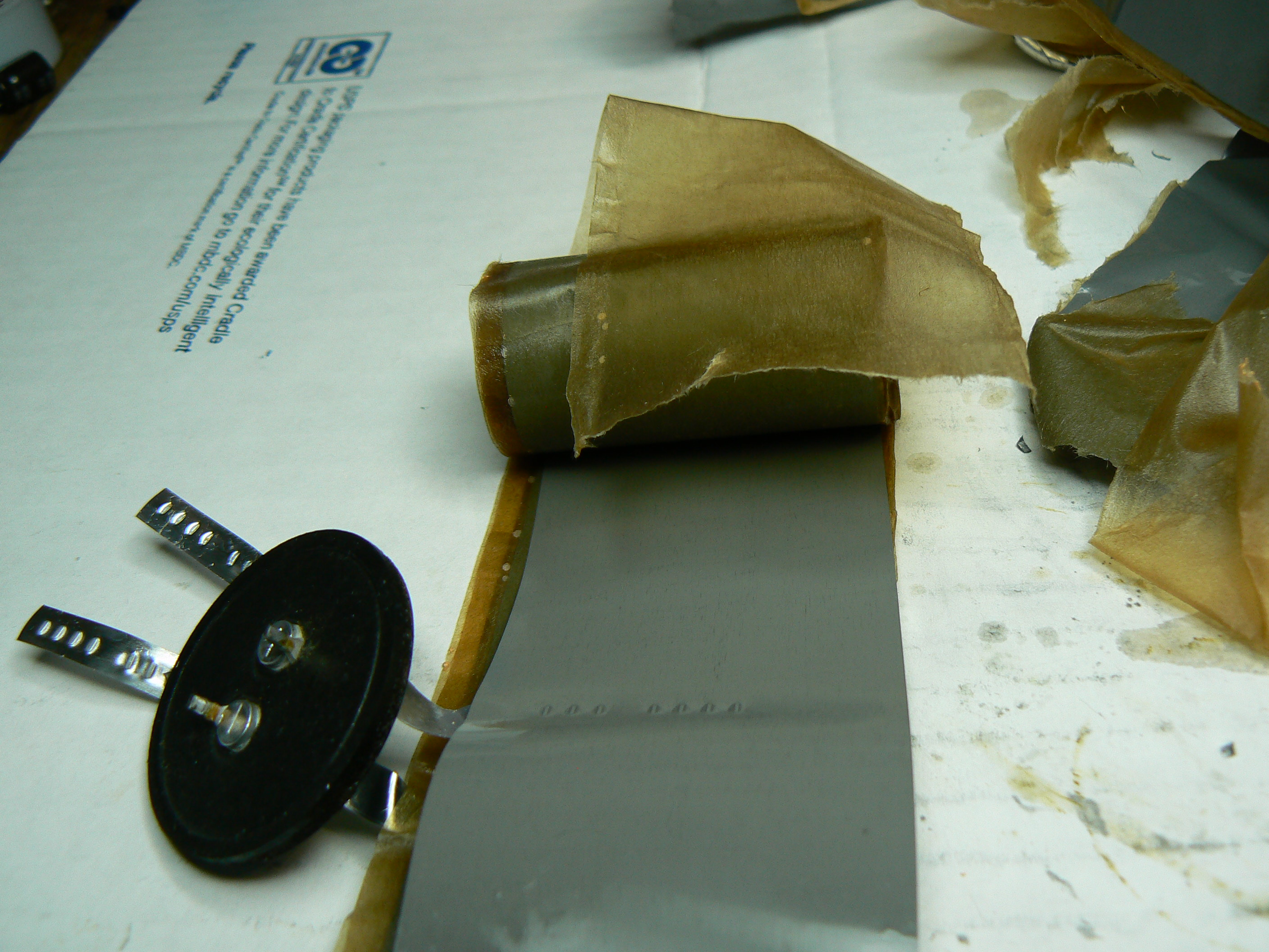

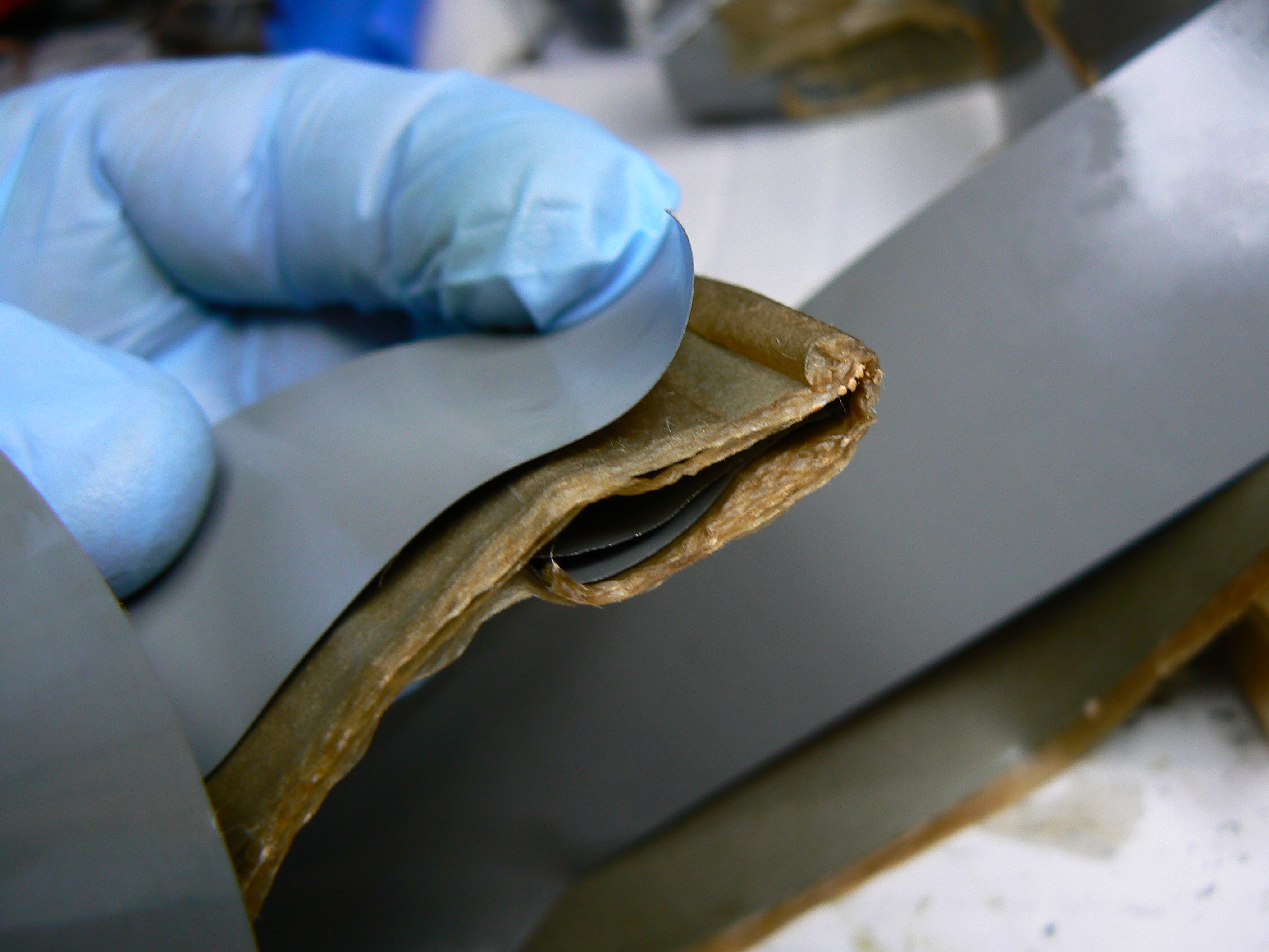

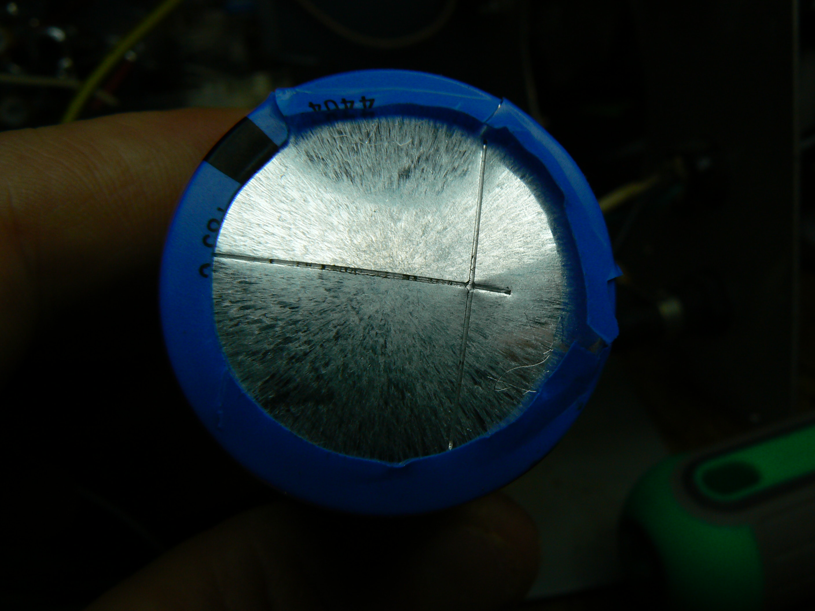

                                        I got one of these caps back and did an autopsy on it. I found it interesting. Getting the can open without mangling the entire cap was not easy. When I did finally puncture the casing, brown liquid started squirting out and I could hear it depressurize. When I got the "roll" out it looked like it was moldy in some places. Also, I was somewhat surprised that the leads were connected in the middle of the roll.
                                        I hope my pictures show you what you wanted to see. I do not think I have ever intentionally taken a capacitor apart.
