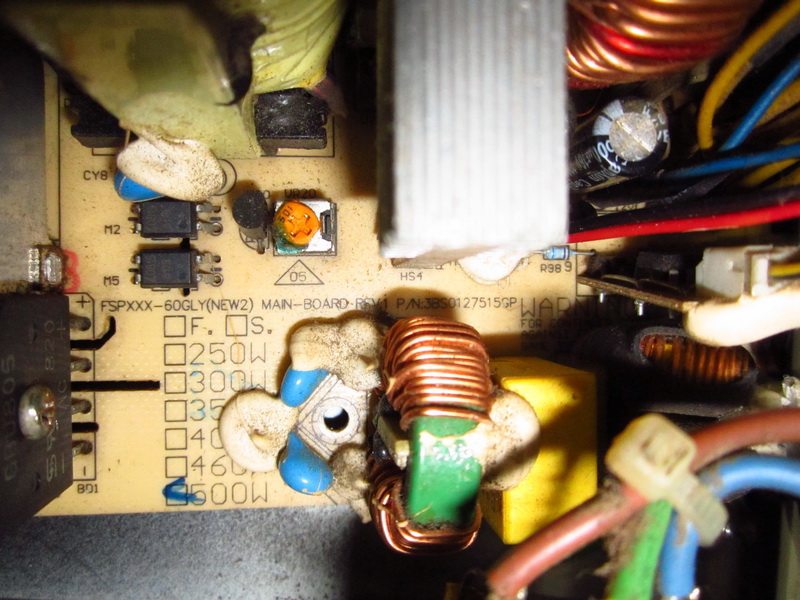

    everything just fine before oneday its start like loosing its power. then i push the power and my house fuse are blown. i open the psu n find nothing strange. no blown fuse, no blown caps or sign of burn. nothing... then i try to jump start psu by shorting green and black cable and then the fuse are blown again.
    whats wrong with my psu?? pls somebody help me...
    ** sorry my english not good

    Sounds like a shorted bridge rectifier or PFC circuit.

        A picture of the internals of the power supply would be helpful.

          bridge its secure than may be its because the melting coil?
          hmm it can rip now

            Looks like it could be related to the FSP model I have (in my sig).

              yup. it use FSPXXX-60GLY(NEW2) with capxon caps.

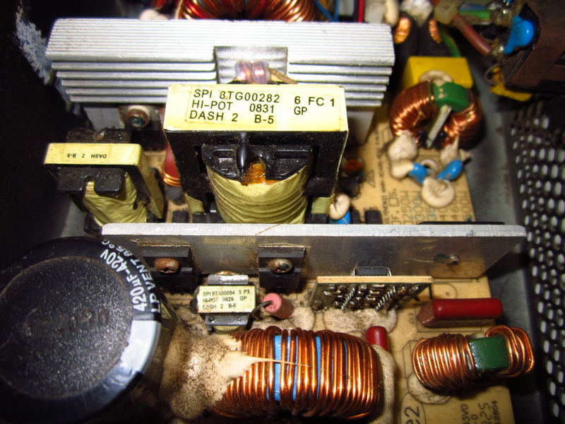

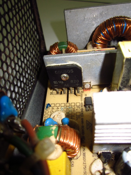

                Check for a short between positive and negative on the bridge rectifier

                  bridge rectifier are fine. see pict in post 5. there are burning sign in transformer.

                    looks like glue.
                    you have some shorted silicon.
                    bridges can short on the ac side too.
