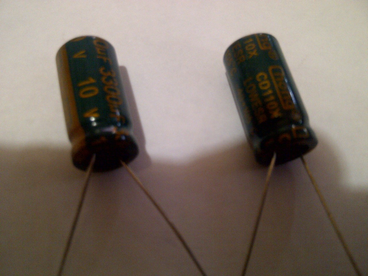

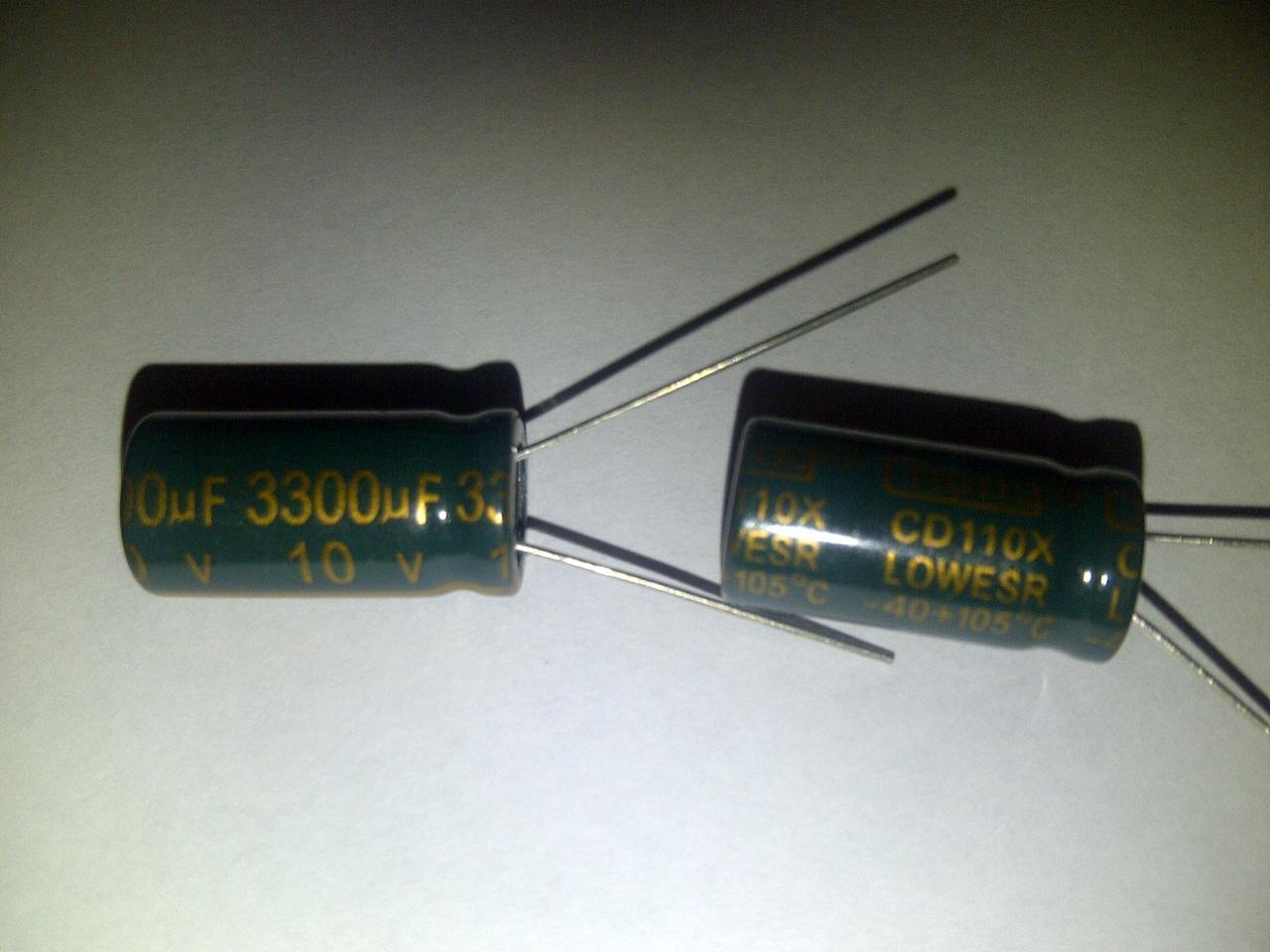

              Re: Amico Capacitors
              I got them and replaced 4 bad caps on a Dell Dimension 4550 Mobo. The board is behaving the same as before: sometimes it boots to bios, but at no time does it get to the OS splash screen.
              Can't say for certain that these new caps are no good as the mobo may have other problems with it.
              I've attached a couple of pictures to show what they look like.
                The ones in the picture aren't Amico, they're made by ChongX :
                http://www.chongx.cn/en/cp_view.asp?id=567
                But on their site , the CD110X are only rated for 2000h @ 85c
                Still crappy capacitors but they would at least get the board running. But your motherboard probably also has some capacitors that are not swollen or visibly bad and those still affect how the board works.

                          Those are utter garbage, but one would expect them to at least get the board up and running for a few days. Pop open the power supply and have a look, you probably have a bunch of bad caps in there too.
