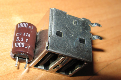

    Hi there,
    I'm new too this board and have never replaced a capacitor before. Basically, two capacitors on my Asus P4S800-mx seem to have blown not because of a design flaw but i think because of a power-supply failure (caused by impact). The tops of the two capacitors in question have caved in and there is a brown residue around the top.
    The capacitors are marked with 'KZG' so I assume they are the Chemicon KZG's I have seen referred to in this site. They are rated with 820uf and 6.3v. From what I understand, I need to replace these capacitors with a similar or higher voltage, but I was wondering if I could have a little more advice. Online I have found some 2000uf, 6.3v KZG's; would these be a good choice for a replacement? Also would I be correct in assuming that these capacitors would be larger in size? (I dont think this would be a problem as there is plenty of space for the capacitors, so long as the distance between the 'legs' is the same).
    Alternatively, I have found some unamed 1000uf, 6.3v capacitors on ebay that appear closer in size and rating, although I have no guarantee these capacitors are from a reputable brand. Someone here may be able to identify them though so here is the picture:
    Ok, thats it I think just need some advice on whether to choose go for a similar brand or rating of the ones already on the board, sorry for the long post and thanks in advance for any replies,

    here's a chemicon KZG
    the 820uf is 8mm diameter, the 2200uf will be 10mm
    no idea what those ebay caps are, why not ask the vendor.
    check this link for what caps to buy. the better ones are to the right of each line.

      KZG are Ultra low ESR caps, i doubth that any other brand then Rubycon, Panasonic and the other known good brands can reach similar specs. Therefore i would certainely not use any other brand.

                    Choose the caps by their ESR valuies, this is in any motherboard circuit the absolute most important factor. The rule is the lower the better. Higher voltage won`t hurt, but you probably gain nothing. If you realy have some money to spend, take some Oscon or similar solid polymer caps, but they are realy expensive. But on p4 boards there is probably nothing better than this. Especially those 820uF caps are IMHO to small to stand the high ripple currents generated by those Intel monsters. Many of those boards are ex factory equiped with oscons and probably the desing of this board intended their use.
                    In any other cases i suggest some good Rubycon MCZ or the equivalent series from the other major brands. For those 16v input caps you probably can use any LOW ESR series from the recomended brands. In no way you should use some generic or odd brand or not LOW esr types. They are absolut not suited. The capacitance is not criticall, but usually i would not lower it, only go higher, but not to mutch. E.g. not more than the double value, may be a little lesser is better. Instead of 1500uf there is probably no problem using 1800uF, but 3300uF could be to mutch.
