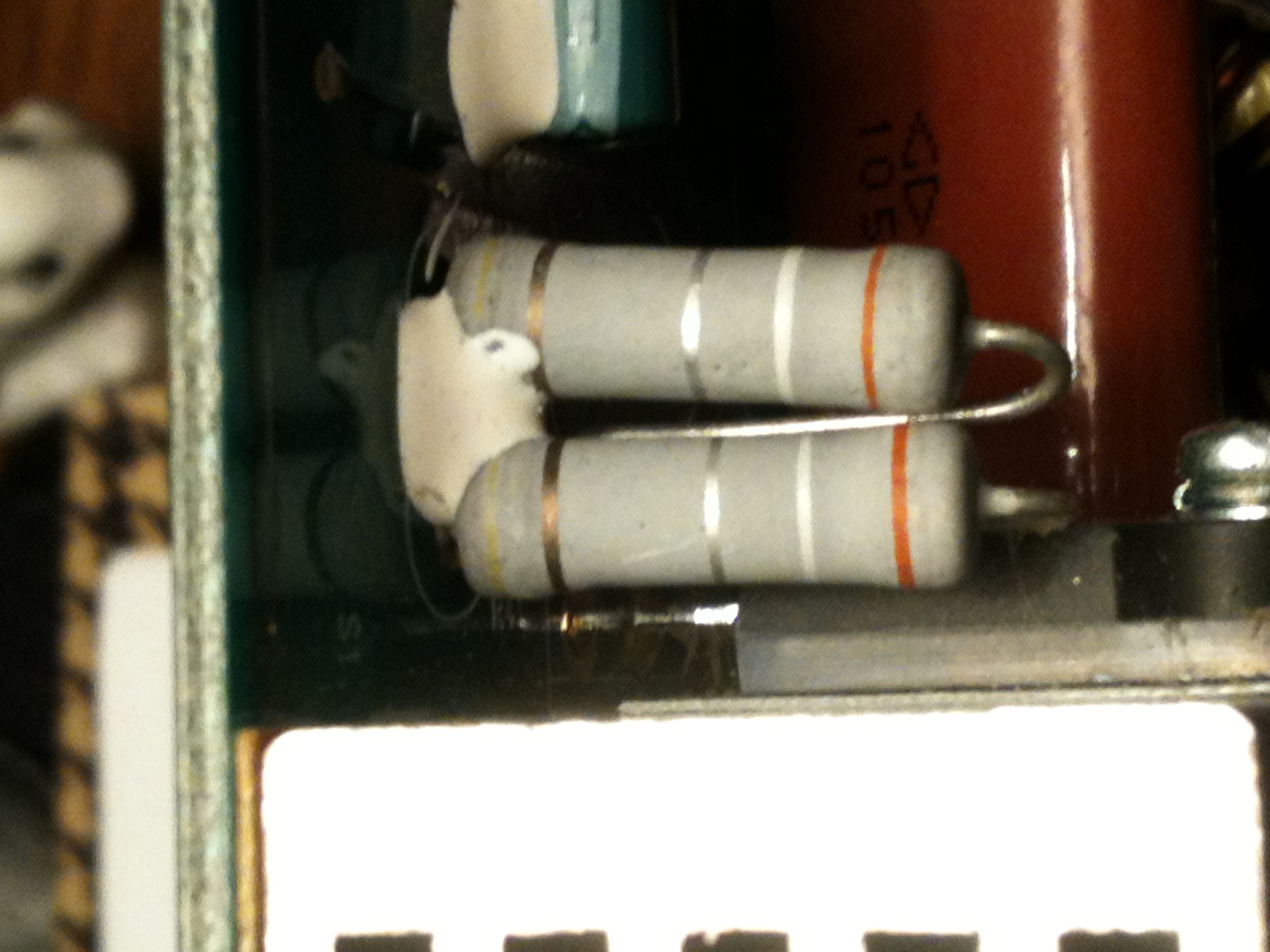

    Rescued an off brand 42" LCD tv from a local landfill today. Going through power supply and found an open fuse and a couple bulging caps. Tv does not power on at all, no light, nothing. Only thing possibly fishy is a closed 400v polyester foil capacitor. I am very inexperienced so can someone with knowledge tell me if these types of capacitors would normally appear shorted? If it is a problem what else should I check? Thanks

    Also found these two resistors both look fully closed, does anyone wanna chime in on the value for these?

          Those are 0.39 ohm resistors plus or minus 5%. To get an accurate reading you should de-solder one lead on each resistor before checking. Can't help you with the cap
