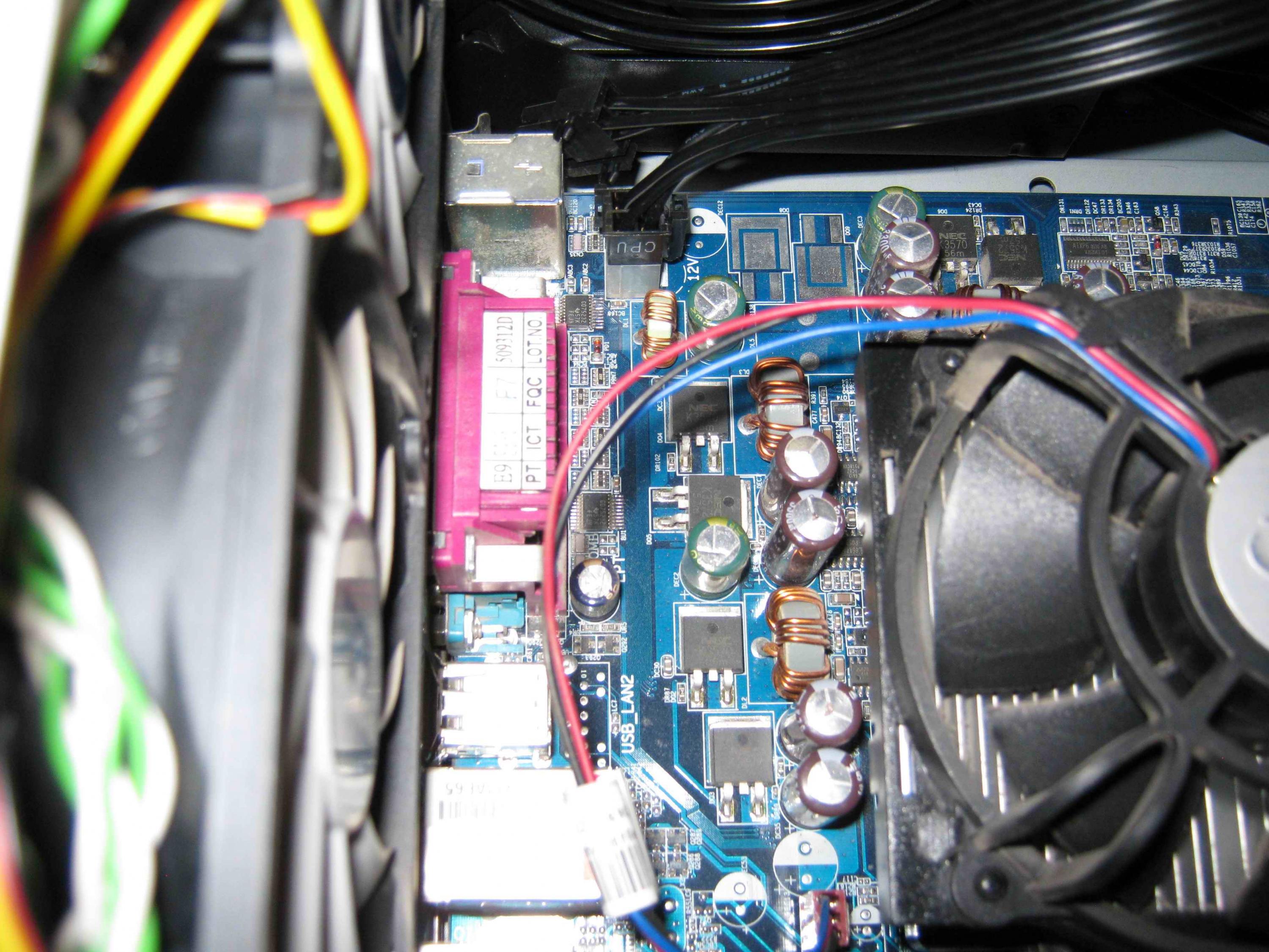

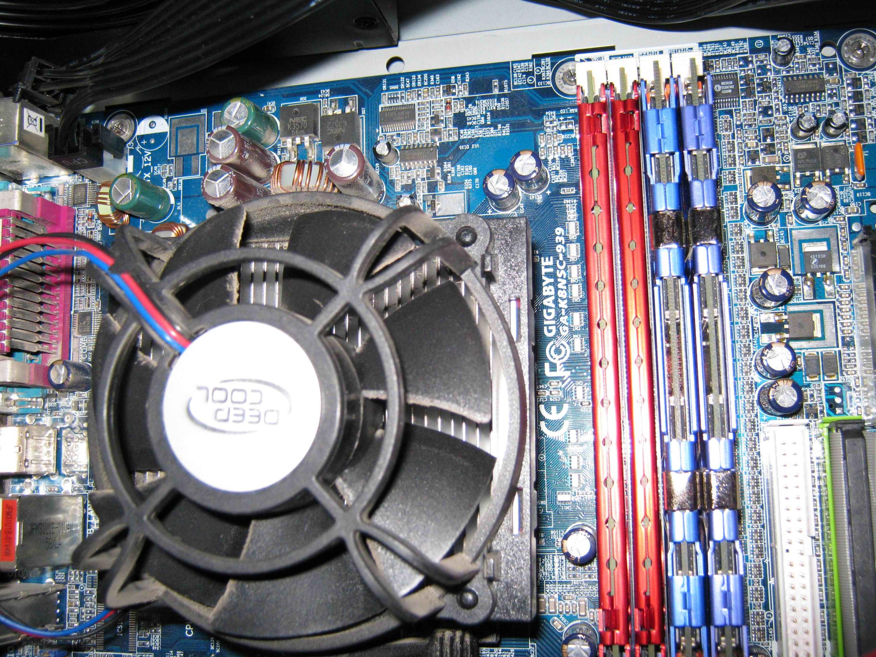

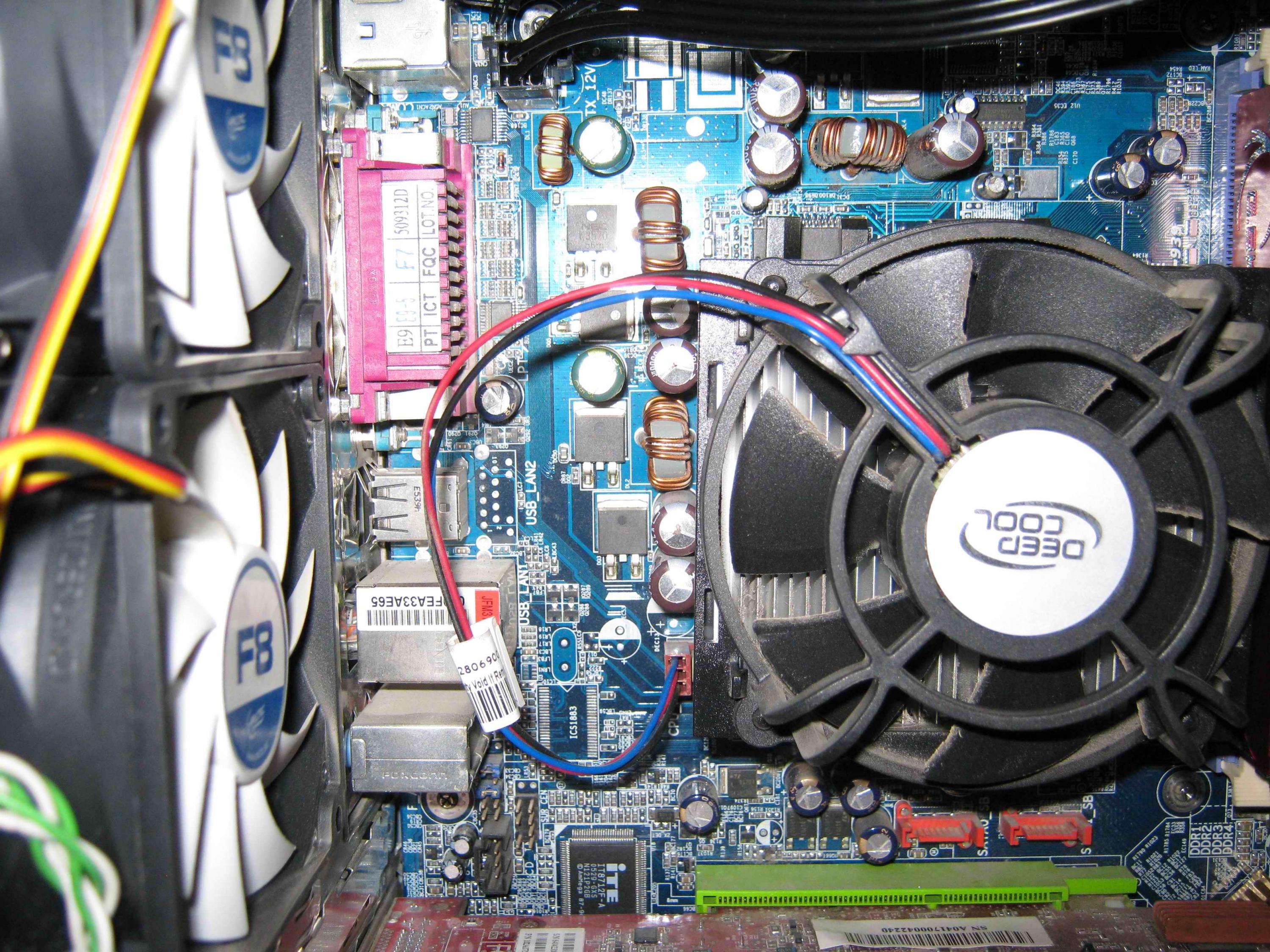

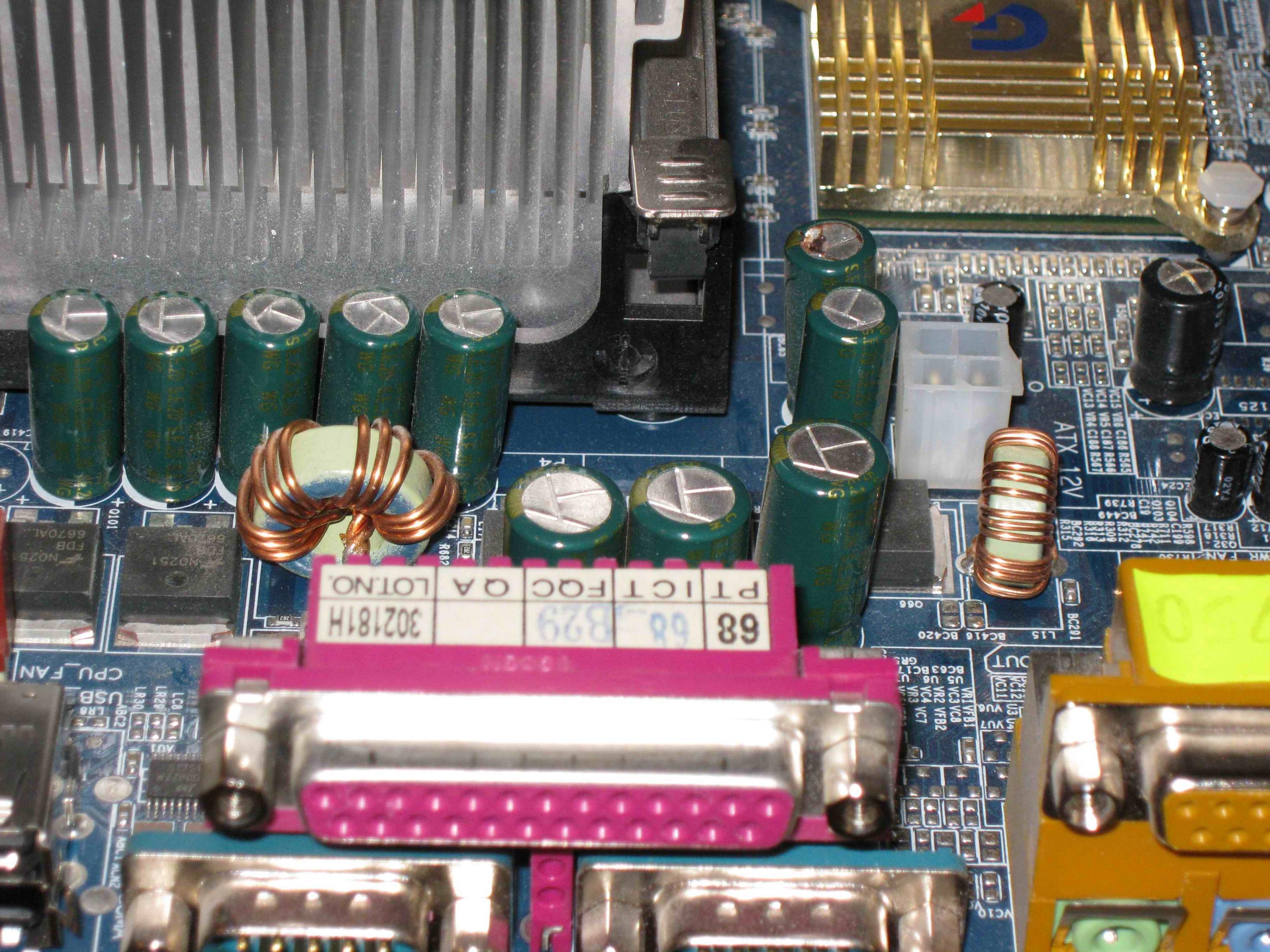

BSOD and Gigabyte Capacitors
Re: BSOD and Gigabyte Capacitors
No they are not, look closer"The one who says it cannot be done should never interrupt the one who is doing it."Comment
The teapos are also trashed too. The pannies are the only survivors, but given their age, I'll replace them anyway.<--- Badcaps.net Founder
Isn't this a psu issue as well? I mean, input caps toast but past the fets and coils the output caps remain decent? Seems like the voltage off the psu killed those SanyosCap Datasheet Depot: http://www.paullinebarger.net/DS/
^If you have datasheets not listed PM meComment
Probably so, but not having the PSU here I have no way of verifying. Of course I'll recommend replacing the PSU as I normally do.<--- Badcaps.net Founder

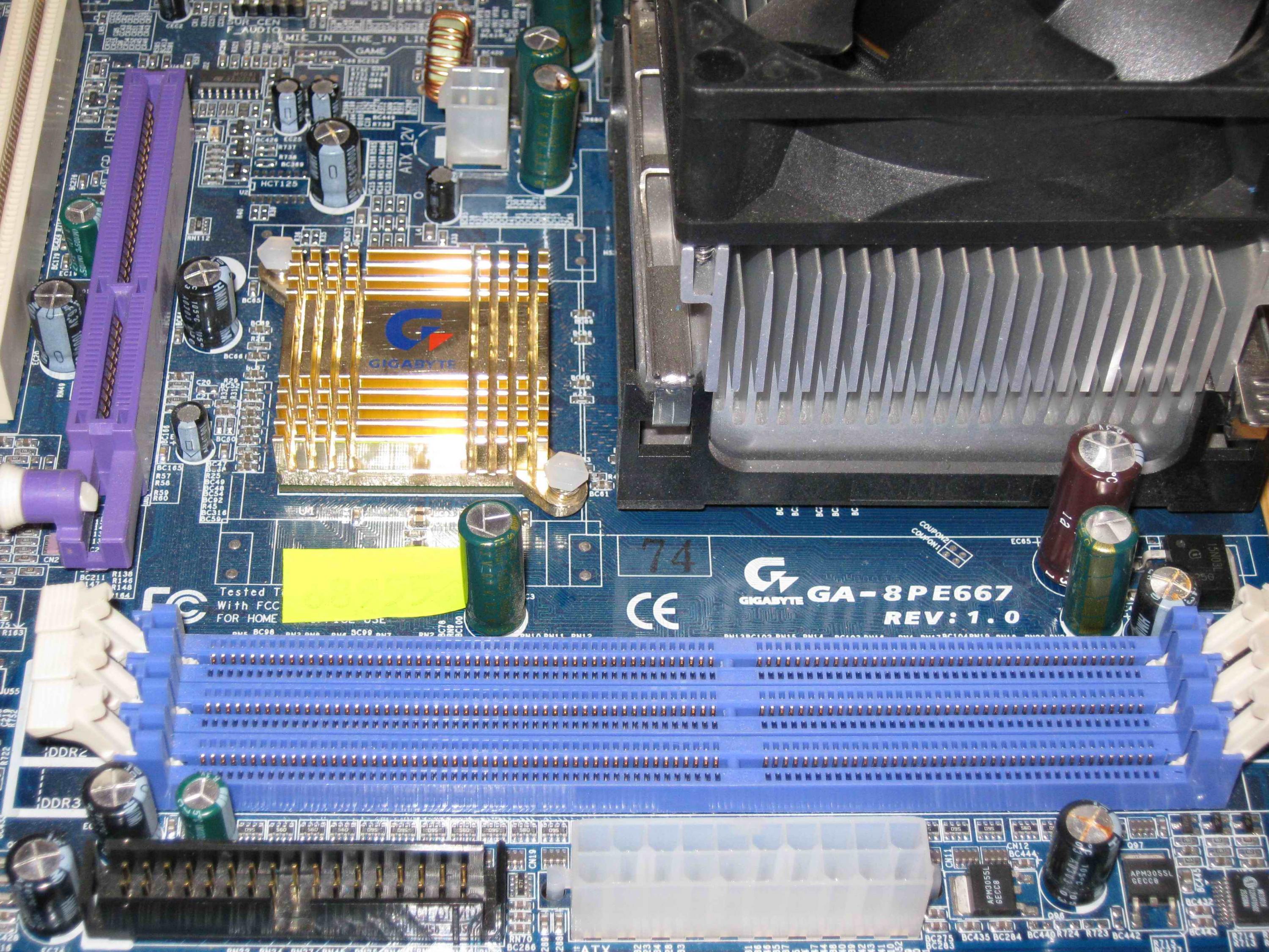

In both motherboards (K8nsc-939 and 8PE667) can be seen how all the Chemi-con KZG are bulging..
Yeah, are the Nichicon HM 1000uF and 6,3V. All of those (9 in total) leaking or bulging. I think that were a f***ing bad model/family of capacitors.
Anyway, I think that this system had a life with bad heat conditions..Last edited by nsb_; 05-23-2018, 08:34 PM.Comment
Nichicon HM/HN/HZ made after 2005 should be fine. Those made before 2006 and especially before 2005 are very failure prone. Sanyo's (Suncon) WF series is rather failure prone (so I doubt the PSU was at fault), and Teapos are failure prone altogether, especially on motherboards (IE, in high ripple current applications such as the output of a buck regulator). NCC KZG made between 2001 and 2007 have a very high failure rate (KZJ weren't much better if at all). WG aren't the greatest caps in the world, that's for sure. It seems on nsb_'s board that there was one Nichicon HM which didn't bulge or leak (out of the nine), but it's probably out-of-spec anyway.Comment
