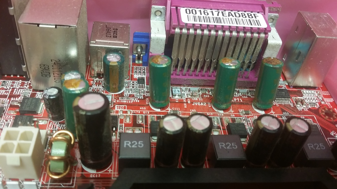

                          Originally posted by Uranium-235
                          bulging sanyos? thats rare.
                          I know, right? Got a MSI K9MM-V in today with a few bulging WF-series Sanyo's. Rare indeed.
                            and the ones beyond the regs are fine. might be PSU related in this case as mentioned above
                                    Corporate client with software married to the MAC address. These boards are irreplaceable to them.
                                    Well, they're not going to live forever... then what?
