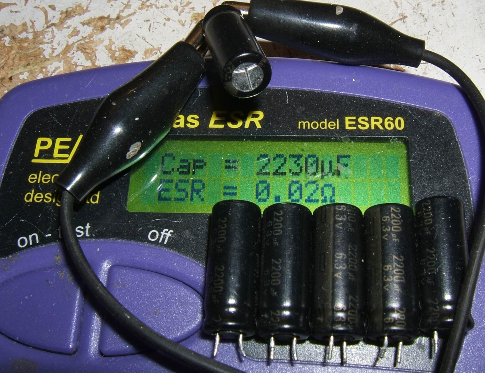

          Re: Replacement for oddball size KZG
          Here's some interesting caps.
          sig files are for morons
          • Topcat
            The Boss Stooge
            • Oct 2003
            • 16956
            Are those actually legit pannies? I've seen some really good fakes... What series are they?

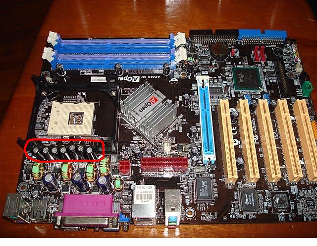

                        So you think some Nichicon HN 6.3V 1800uf will be okay?
                        • PCBONEZ
                          That depends on what the specific cap does.
                          Sometimes uF matters. - And uF goes down as caps age...
                          You said 'by the CPU'.
                          If these are Vcore caps as long as the total uF is over about 5500uF you should be okay because you'd be lowering ESR too.
                          [And no, don't use less caps to get 5500uF. That would raise total ESR.]
                            These are the caps in question (this is not the board I'm working on, just a pic of the model).
                                You have 7 so 7x1800uF = 12600uF.
                                You'll be fine.
                                P4 and socket 604 & 771 & 775 etc.. only need about 5500uF in Vcore to be stable.
                                They end up with more uF in aid of using more caps in parallel to get ESR lower.
                                It's mostly about the ESR in Vcore, not the uF.
