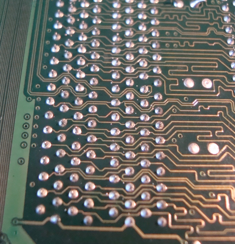

                              Removed motherboard once again in order to look for short circuts or cold joints. I've found this:
                              Near almost every through-hole joint there is a small drop of tin; maybe one of them causes problems?
                              marcin

                                Re: Recapping did not help
                                Good catch!
                                Look for any that are bridging traces.
                                (I see one that might be between the 8th from bottom pins in the right two rows..)
                                Should clean up with que-tips and isopropyl alcohol.

                                • zorba128
                                  • Jan 2012
                                  • 10
                                  No luck... I'm running out of ideas .
