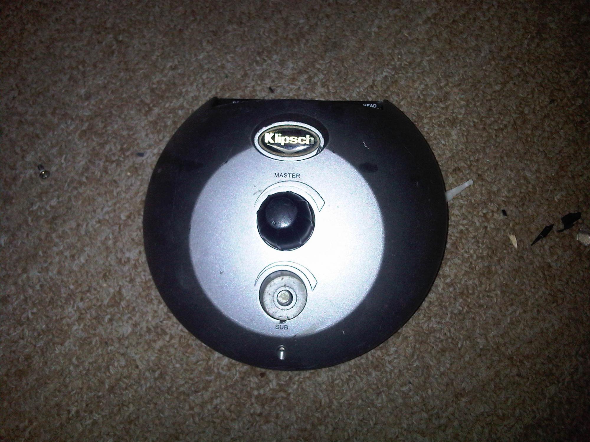

    audio controller for my klipsche system.
    sound is staticy and almost gone, i have to have it on max volume to hear muffles, crackl-y sound (left channel low volume)

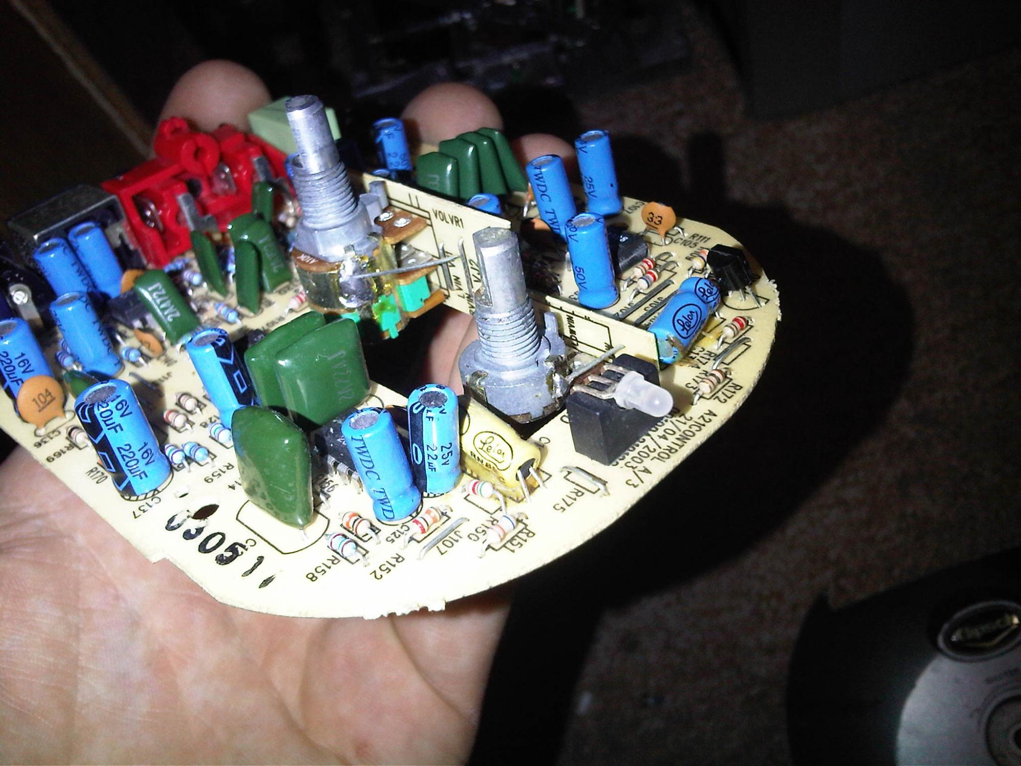

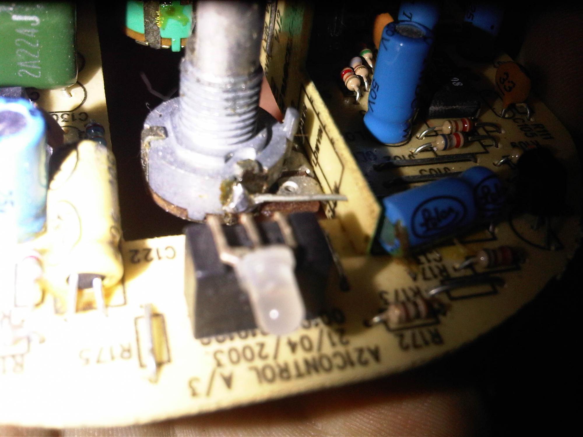

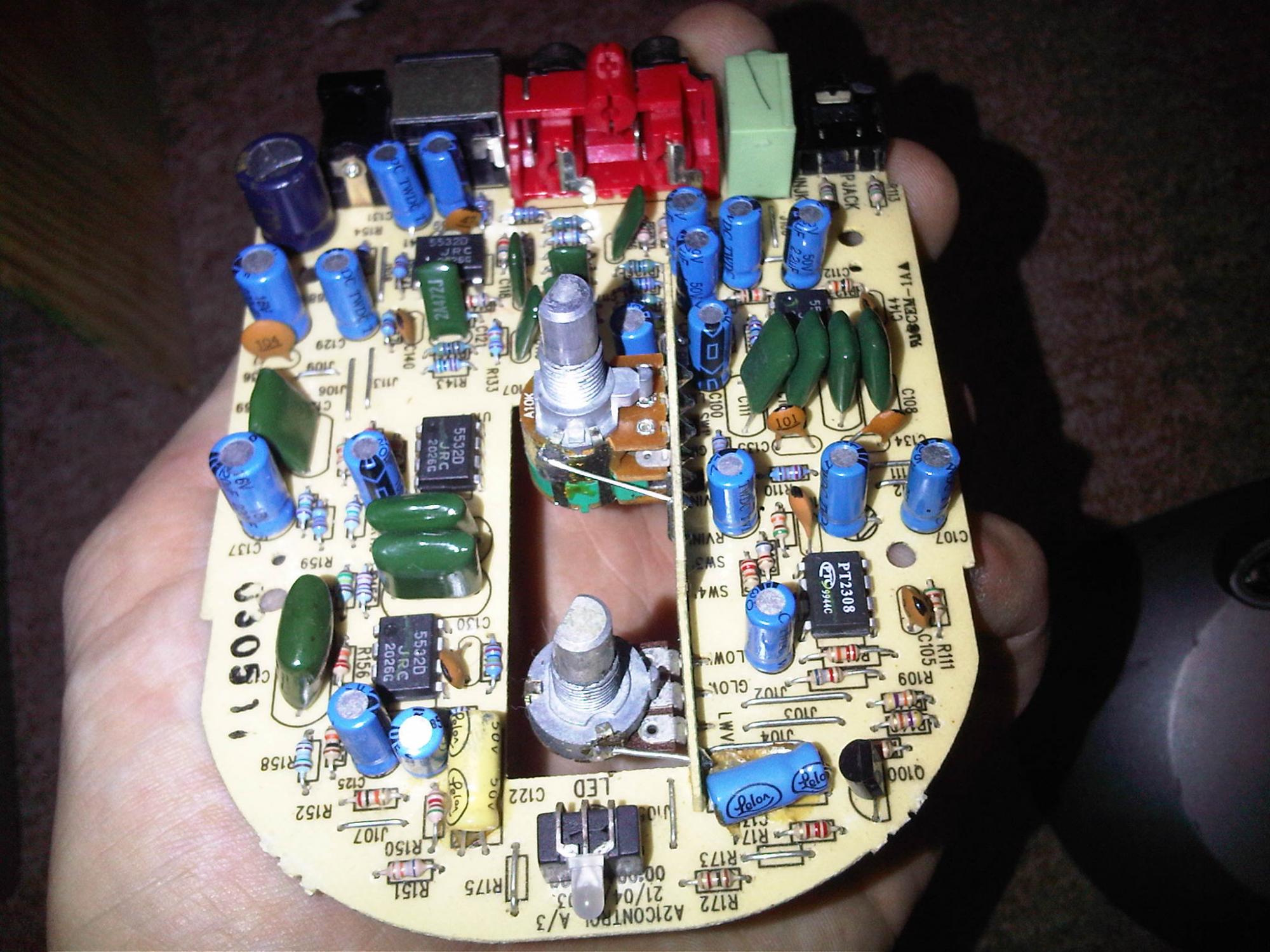

    are these caps bad?
    they say "lelon"
    and "twdc" ??
    there is one that says "orient"..
    im not sure im thinking replace them all.
    16v, 25v, 50 ranges and 2.2 uf -470uf (i had the 470 on hand and replaced it, no change) most are 2.2 or 220uf.

    Check the main aplifier, probably located in the subwoofer box - this tiny box contains only some opamps, the controls and some tiny headphones amplifier.
    Those caps are indeed not good brands but as they're not subjected to lots of heat and other factors, don't think they're bad. Couldn't tell for sure without checking them though.

      An opamp failure in the control box could lead to the same results... but agreed, it's probably not the caps even tho they're crap. Test the power supplies and outputs of the opamps.

          Those are general purpose caps so *anything* will work as a replacement as long as it fits physically and has the same capacitance, and the same or higher voltage rating.
