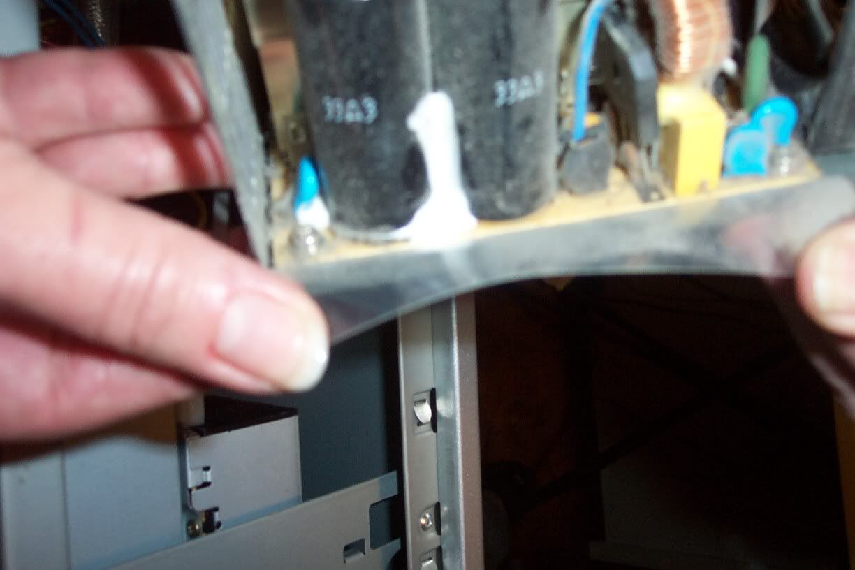

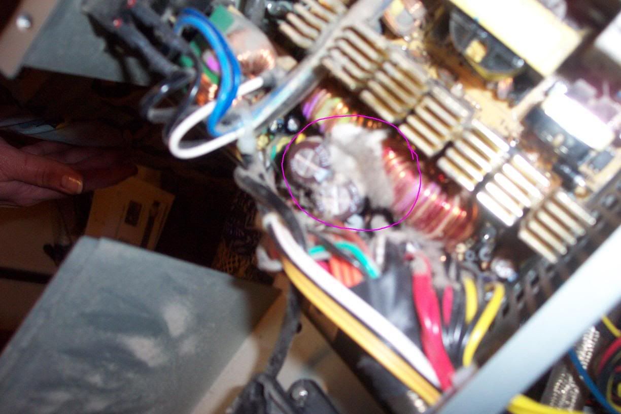

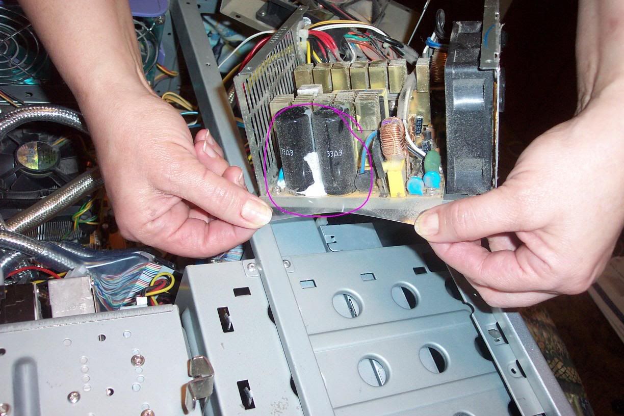

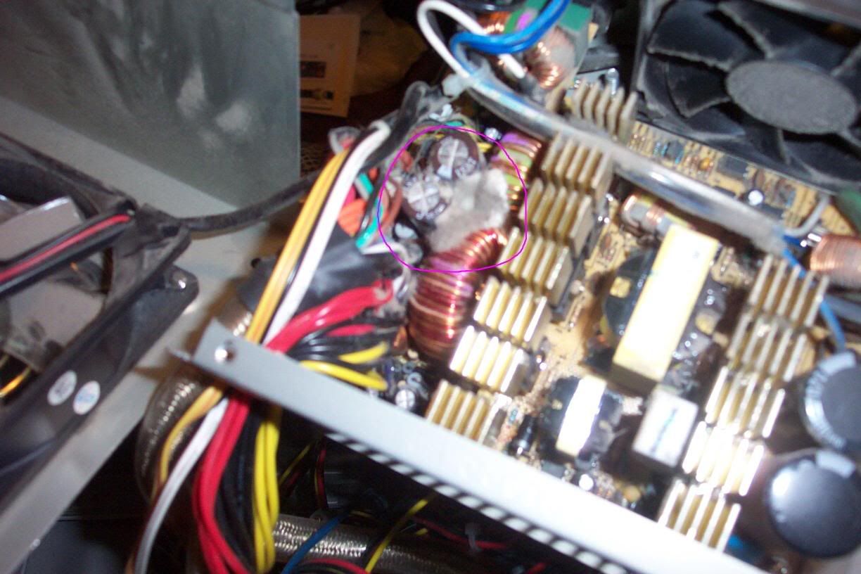

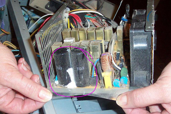

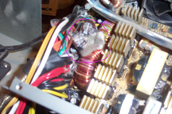

                Ok, well, upon the initial suggestions of the capacitors being a possible culprit to my problem, i thought it was just a motherboard thing. But at your advice, i opened up the PSU and checked it out, and saw huge clumps of what i first thought was dust, but upon closer inspection is actually a hardened white substance. Could be glue i guess, but i dunno why there'd be glue in there. I guess this would be the electrolyte (though the caps arent bulged at all). I took pictures, but my camera doesnt have a macro-focus, so it was hard to get them clear. I'm pretty sure after looking at the inside of the PSU that this is definitely the problem, but would still like some input, just in case im misreading.
                larger versions and other pics
                http://i7.photobucket.com/albums/y28.../DCP_1348a.jpg
                http://i7.photobucket.com/albums/y28...5/DCP_1350.jpg
                http://i7.photobucket.com/albums/y28.../DCP_1351a.jpg
                http://i7.photobucket.com/albums/y28.../DCP_1355a.jpg

                  Your caps are fine, the white stuff between the two large bulk caps is just what you thought, glue, there to prevent high frequency sound etc etc...
                  And the very blurry caps on the secondary side looks to be United Chemi-Con, if it is that is an excellent PSU! And yes, the stuff between the caps and the coil is glue there also, yet again to stop the coil from vibrating and creating coil noise...
                  Just inspect all caps on the secondary side and make sure that their tops are flat...

                    hmmm... well all tops seem to be flat, and not bulged on both the PSU caps and those onthe mobo....
                      The brown-maroon colour of the plastic sleeve can be deceiving, but these are without doubt "JP CE-TUL" caps, which are a ubiquitous feature within any not-too-old Enermax PSU.
                      Equally distinctive (but not shown in Saxman's photos) are the smaller black capacitors, which are invariably marked "JP CE-TUR". Whether TUR and TUL are actually different series, or a manifestation of the all-too-common 'Engrish' of swapping Ls for Rs and viceversa, I wouldn't know.
