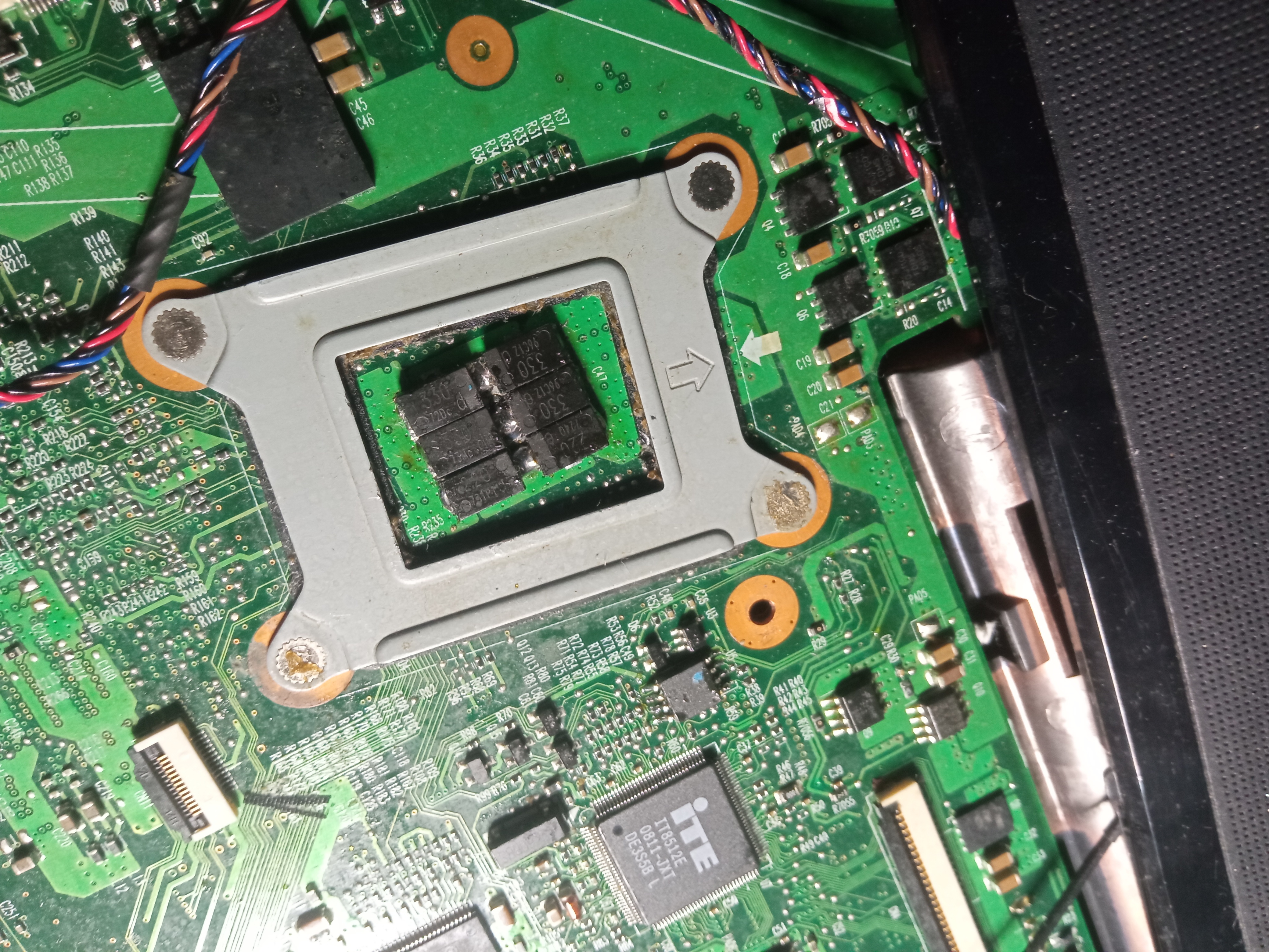

    Hi, I've been troubleshooting this PC for a while but I cannot repair it for now.
    The error on this PC was the known graphics card soldering problem (or that was what I was thinking), so I took a 3470 from a 5920G and installed it.
    The video after that worked, so I thought the problem was solved. When I tried to install windows, I noticed a problem: the ACER logo (bios load) stopped after completing the loading bar (and that was in every power on, but sometimes not even charged the Acer logo screen, I only could see a blinking white bar).
    So I thought it may be some problem with bios, but found in another thread It could be NEC TOKIN capacitor. I extracted it and mounted some capacitors from other boards (attached photo), but problem continued exactly the same.
    Click image for larger version  Name:	IMG_20250225_221943.jpg Views:	0 Size:	3.57 MB ID:	3581218
    Thinking again in a BIOS problem, I reprogrammed the bios, but the same effect appeared.
    Testing voltages I can find in board correctly: VCORE(0.95-1.1V), 5V(5.3V on usb), 1.5V, 1.8V, 1V, 19V, and nothing fluctuates when fail appears.
    Another problems noticed are:
    - when Windows starts (sometimes it does it), after a time it freezes. Last time I tried Windows 10 and got an BSOD with error "DPC WATCHDOG VIOLATION".
    - sometimes I hear a fan noise like clicking, and fan tries to rotate but cannot. Sometimes at power on if this happens, laptop does not start. When not happening. it starts normally.
    I also have noticed that I can start windows normally if I let the computer a certain time powered off. When is a short time after power on and power on the problem appears.
    Any idea about this?
