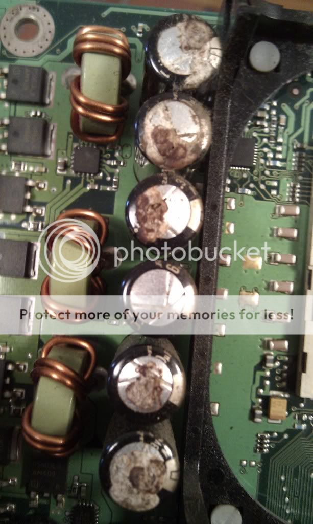

    Replacement caps for bad RUBYCON
    I have a fujitsu siemens motherboard with 7 failed rubycon caps, they all have brown goo coming out of them.
    The capasitators in question is Rubycon 3300uF 6.3v
    I am wondering if this is a good replacement:
    PANASONIC - EEUFM0J332 - CAPACITOR, RADIAL, 3300UF, 6.3V
    Capacitor Application:Low ESR
    More specs here: http://no.farnell.com/panasonic/eeuf...-3v/dp/1219450
    Is the quality of this capasitor adequete for my application?
    I live in Norway, so i want to buy local.
    Also, should i replace the other caps on the board even if they look fine?
    The pc would not stay on for more than 5 min.

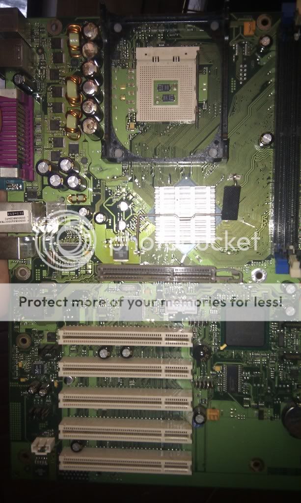

    Re: Replacement caps for bad RUBYCON
    To be able to help we need more information. You said the original ones was Rubycon, what series are they? Give all letters and numbers written on them. Also measure the size of the can. Then someone can tell you if its a good replacement or not.
    A picture of the board would probably help out on your second question, then someone else could say if you might want to change more of them even if they look ok.

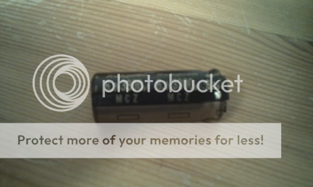

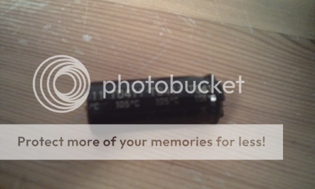

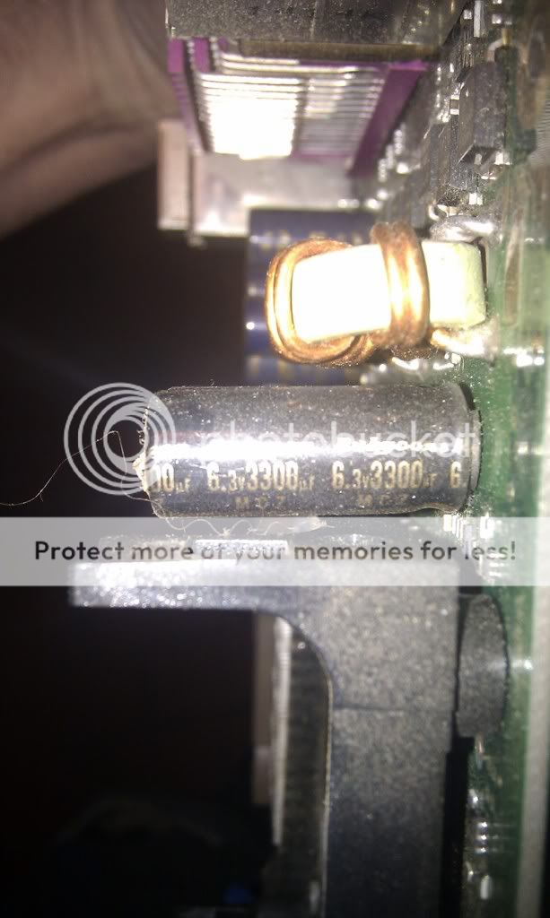

      Failed caps: rubycon T0411 105* 6.3v 3300uF MCZ
      All other caps are other brand or size and looks fine.
      Only nubers on the motherboard:
      w26361 - w69 - x - 03
      w26361 - w69 - z2 -03 - 36
      The pc is working fine for 5 min and then just goes off.
      Some pics:
        You should replace it with the same thing:
        https://www.badcaps.net/store/produc...products_id=30
        If you will list the OST series capacitors, I will tell you what to replace those with as well, as they have no doubtedly failed but have just not shown signs of it.

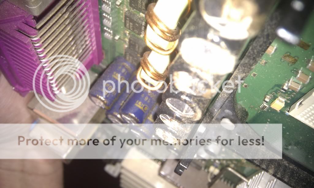

          4x OST RLX 105*c O408 1500uF 16v
          14x OST RLp 105*C O408 1000uf 6.3v
          1x Rubycon T0406 MBZ 105*c 1500uF 6.3v
          1x Rubycon T0402 MAZ 105*c 1000uF 16v
          2x OST RLG 105*c O408 470uF 6.3v
          I think that was all of them.
          I should replace all?
            Date code is 2004 so if they are not showing signs of failure, leave them alone.
            Give me the diameter.
