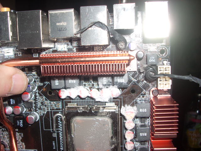

    And the first contestant is; ELCON, EPL Series.
    https://www.badcaps.net/forum/showthread.php?p=160946
    They even bloat!
    https://www.badcaps.net/forum/attach...3&d=1303094863

      I thought polymers explode, don't bloat. Those might be lytics in a polymer casing
      • c_hegge
        • Sep 2009
        • 5219
        Re: List of Bad Polymer Caps
        They bloat, then explode, whereas lytics just vent.
        Originally posted by Topcat
        it will be interesting to see what starts to show up in this thread in the future...
        Assuming the thread doesn't die before we get too many. Sticky maybe?
        I have seen pictures of Apaq polys on ASUS motherboard exploded before. I'll see if I can dig it up.
        EDIT: Not the one I was thinking of, but here's one.
          I've been looking at the chemistry they use.
          Organic Polymer and [true] Solid Polymer are actually quite a bit different.
          The Organic types can form Hydrogen inside just like Lytics.
          [Which may be why some 'polymer' have vents.]
          Depending on specifics the Organics can also get pretty toxic if they overheat.

              Yea but the owner of that card linked above said he cooked it in the oven with the caps installed so no wonder they failed...
              • PCBONEZ
                Grumpy Old Fart
                • Aug 2005
                • 10661
                Oh Hell, - Delete this whole thing.
                - Or at least change the title so the title can be used for said list.
                By the time I saw photos I forgot he baked it.
