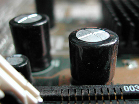

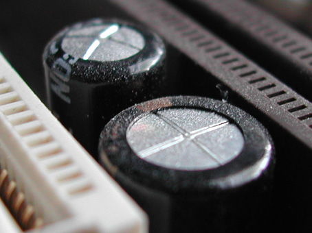

    Hi there,
    I'm just popping in and give you the situation here.I'm using 2 VP6 dual pentium 3 servers here in a webradio environment.
    Now i'm having the first problems which appears to be "'badcaps" but before doing someting stupid,i ask the experts here.
    Server 1 is my streamserver (on 24/7),worked flawlessly for the last 2 years ,but the last weeks the pc is starting to do funny. Spontainiously reboots,or ""hanging"" into blue screens. Normally after rebooting it runs again.
    the OS on this system is Windows 2003 server.After crashing the OS gives a "fatal error message" (or something like that,don't know the exact phrase)
    Server 2 is the spare server,worked ok too,but is mostly tuned off. After a few weeks of inactivity i started up the server to get a "disc boot failure"
    First i thought the HD died so i opened the server to replace it. But during the replacement the server start to do strange things,wont reconize HD,or won't boot,and when it boots,no install of OS possible... (all errors i did find on this site) When inspecting the board however,i don't see real problems yet,all caps looks pretty normal,except for on small caps at the agp slot which is a bit ronded at the top .
    What do you think? I know i'm asking at the know direction...but i guess i won't believe both servers starting to die at the same time i suppose...
    Sad thing is,i once bought a recapped board on e-bay some time ago to have a spare....but this board won't start at all.....this one looks real dead..
    Am i stuck with 3 dead/dying vp6 boards here? I would like to have all boards recapped but i'm located in the Netherlands.....(so i can't send those boards to the US i just read) Are there any companies in Europe recapping those boards?
    Your thoughts please?

    Can you post pictures of the suspect capacitors?

                  • ProFM
                    • Jan 2006
                    • 6
                    Re: Multiple boards,multiple problems
                    Hi kc8adu,
                    Indeed,clearing the cmos did the trick for the recapped board.
                    I made some pics from the spare server.They don't look all bad,but some of them have the know rounded tops as you can see.
                    Attached some pic of the spare server.
                    I must say that the mother board from the server looks better,pics from that one i will post later
                    kc8adu,i will pm you for more details regarding recapping those boards.
