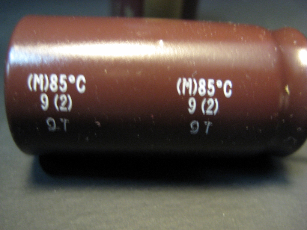

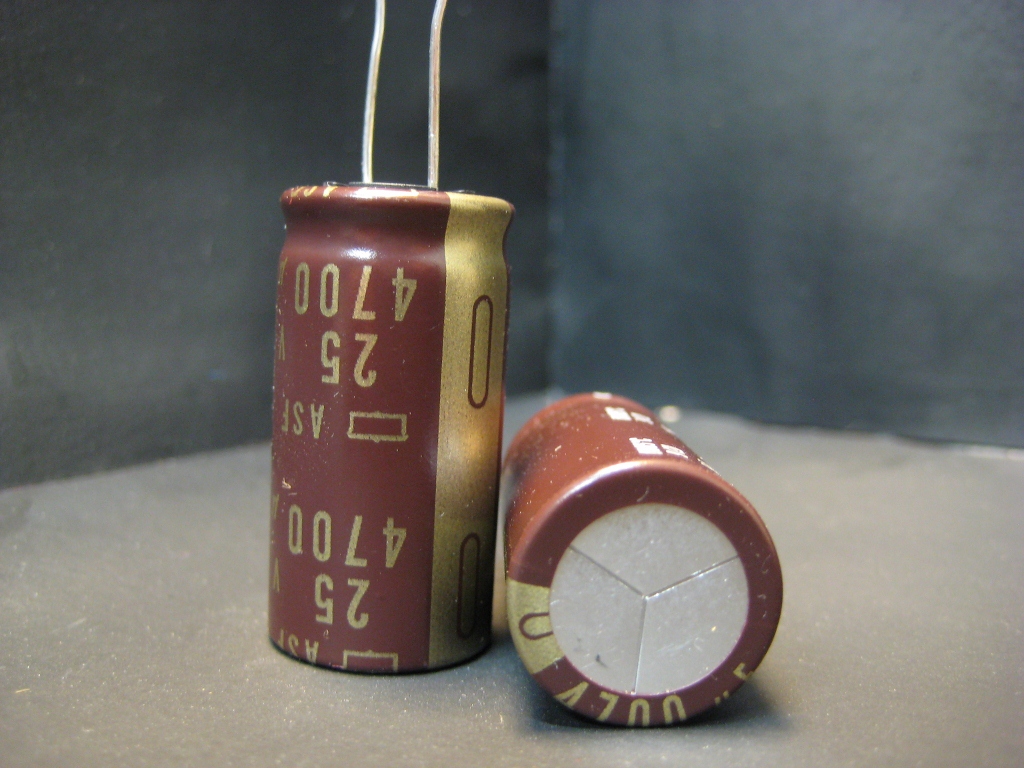

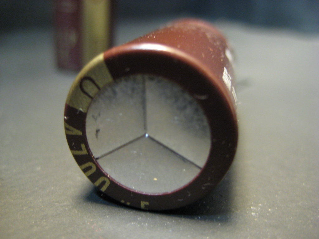

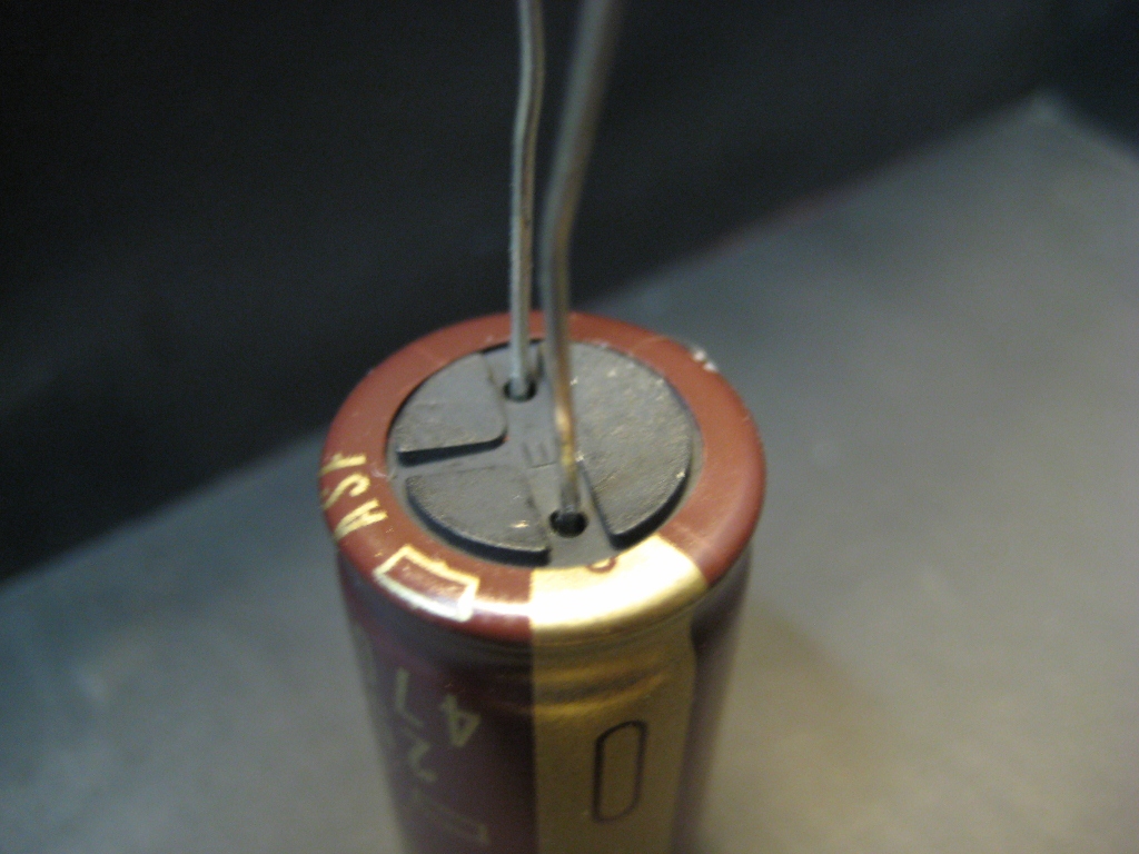

    Yes, I'm in the middle of a few projects right now. My biggest one is an amplifier. I bought a kit off eBay for a subwoofer preamp. It came today. Origin: China.
    When I opened it, it has some unfamiliar caps. They are United Chemi-Con "ASF". I've never seen an "ASF" in my life, so I did some research. The only thing that turned up is that it is an audio grade cap, regarded pretty well by the audio comunity. I'm a bit dissapointed they are only 85*C, but this seems typical among "audio caps".
    So my first question. Does anyone have a datasheet for the ASF? Secondly, do these look real? It was from a legitimate China based eBayer. I don't think they are fake, but you never know, especially with these caps being "rare" and such.
    Pictures are attached.
    Thanks.

    They look real to me. No luck finding an ASF datasheet. Perhaps it's one they market to OEMs only.

        Chemicon ASF, AWF and a few others are high-end audio-grade caps that were probably discontinued in the 90s or early '00s. The only source seems to be NOS lots on EBay which for some reason are mostly in China and SE Asia - may be surplus lots from audio equipment manufacturers.
        Virtually all the high-end audio-grade caps are 85c, moderately high ESR, and not very high ripple current. They're optimised for higher linearity, lower Dielectric Absorption and comparatively lower Dissipation Factor, which are more useful properties for Linear Circuits. They're also priced about 10x-100x the price of a computer-grade low ESR cap with similar ratings. Check out the price difference between a Panasonic FJ (computer-grade) and a Panasonic Pureism PX or PXL (high-end audio-grade). Even better, check out a Rubycon ZL vs. a Rubycon Black Gate WKZ - the price difference will be about 1000x.

          The date code on that suggests September 2009...
          I'm not sure what their pre-2000 date codes looked like, and that document doesn't help.

                    Date code appears to be Feb 1999.
                    Might wanna research "Reforming Capacitors".

                      Found ASF in UCC catalog from year 2000. - In the Japanese catalog only...
                      Also found specs but it's not in PDF and not in English.
                      4700uF/25 shows Ripple as 1900 -> at 120Hz.
                      Low ESR caps are rated at 100kHz.
                      Those aren't just GP caps they are lower grade GP caps.
                      [Grade and Quality are not the same thing....]

                                As far as I know, all Chemi-Con 85C electrolytics never come in a brown sleeve, but they normally come in a black sleeve, except for special purpose units such as low leakage units.

                                      They are real just an obsolete series that is no longer manufactured so the data sheet is no longer provided.
                                      http://waybackmachine.org/
                                      They save random web pages for some historical purpose.
                                      Sometimes if you dig a little through their cached pages you get lucky on obsolete data sheets.
                                      This was saved Nov 16, 2000.
                                      http://replay.waybackmachine.org/200...sf/size_j.html
