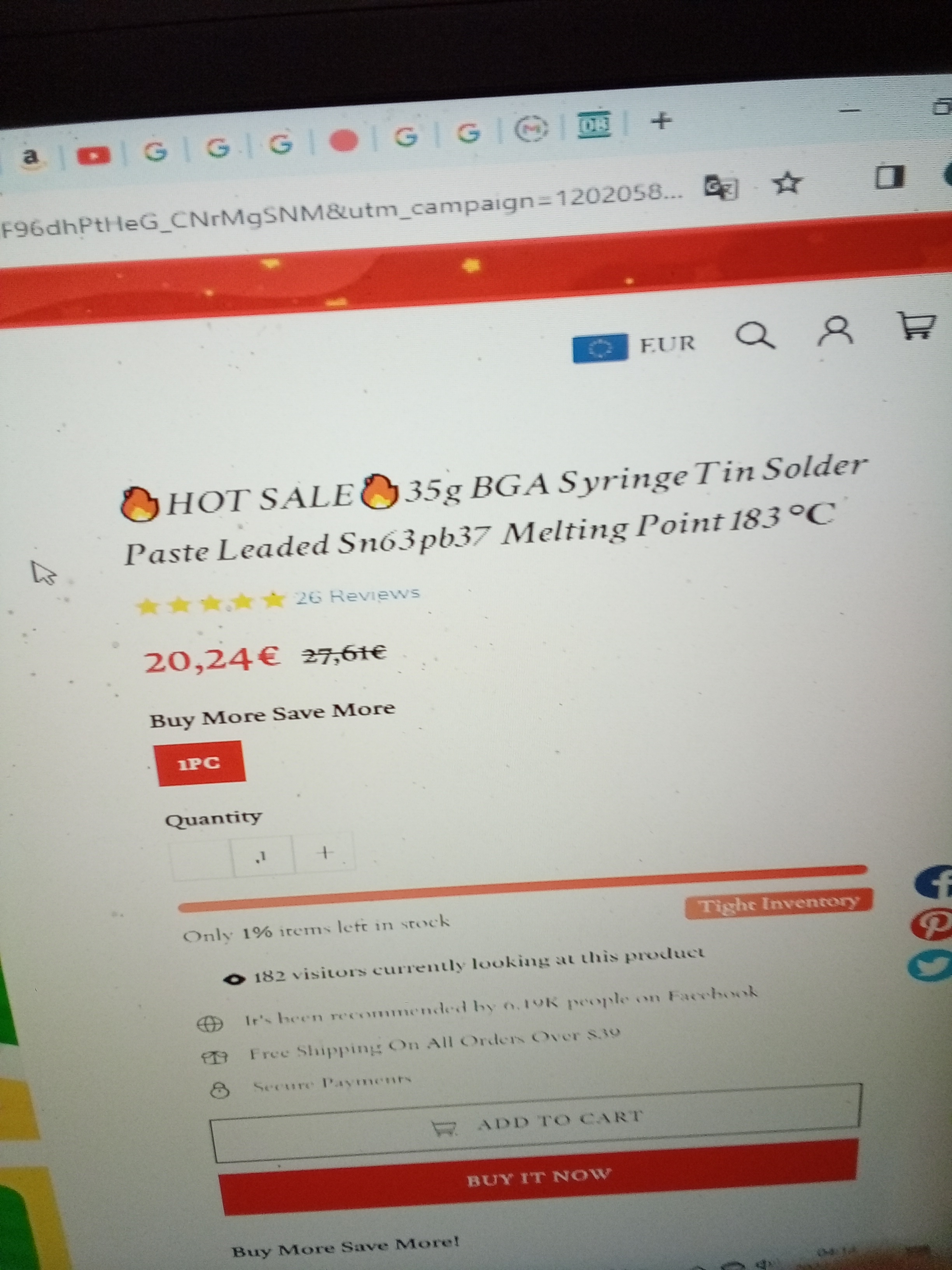

    Hello everyone today I see this advertisement about a soldering paste that is according to them video posted as almost fantastic for all surface soldering to the point that one becomes suspicious
    Therefore, your experience is of great importance. Is it really as good as it looks or ?​

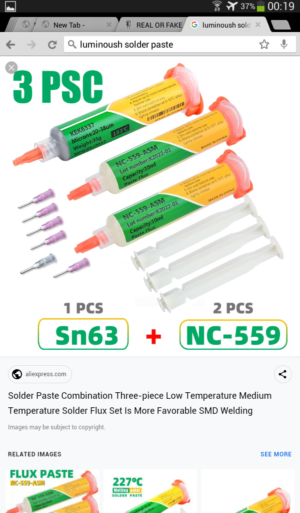

    there are very few uses for solder paste unless your making surface-mount pcb's with an oven and a stencil.
    however - it's irelevent.
    the center photo shows a chinese ripoff of Amtech NC559 flux, so are they selling flux or solder-paste?
    it looks like even they dont know!

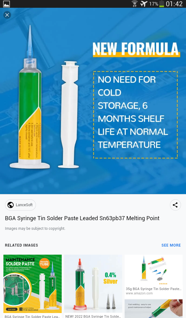

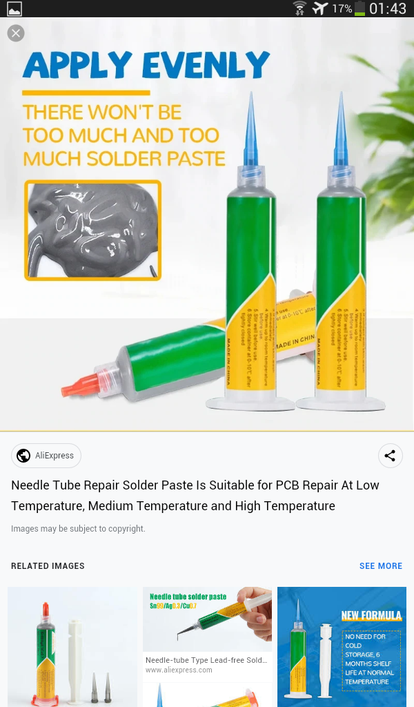

      REAL FAKE not OR
      I mean, just assume that you have a small corporation that allow to be published photo like this...
      On last pictures...
      63Pb6Sn63Pb37 <--- very informative
      SOLDER PASTE
      MAINTENANCE
      And for illustration, they choose to spill it arround keypad contact, on coating...

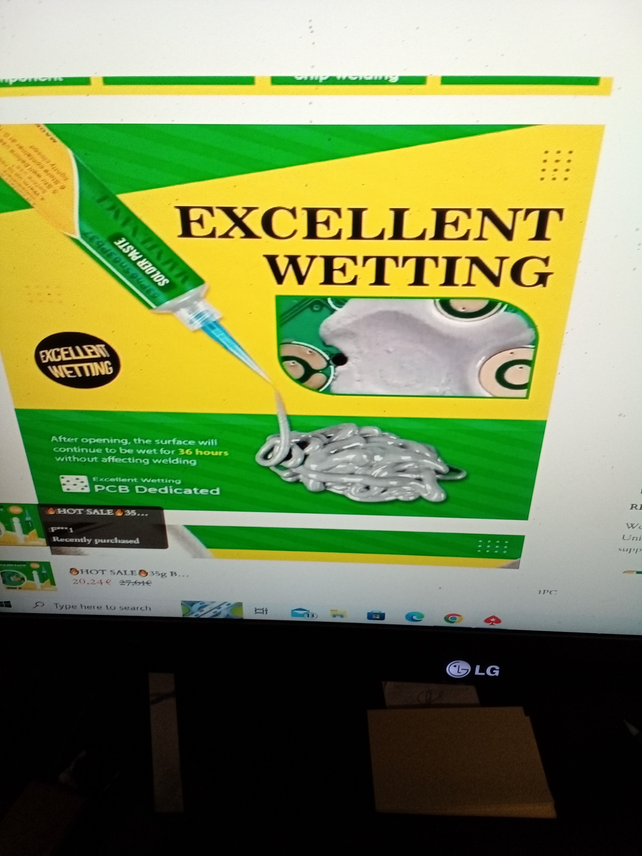

          I cant loaded the web page... have you yt link to video?

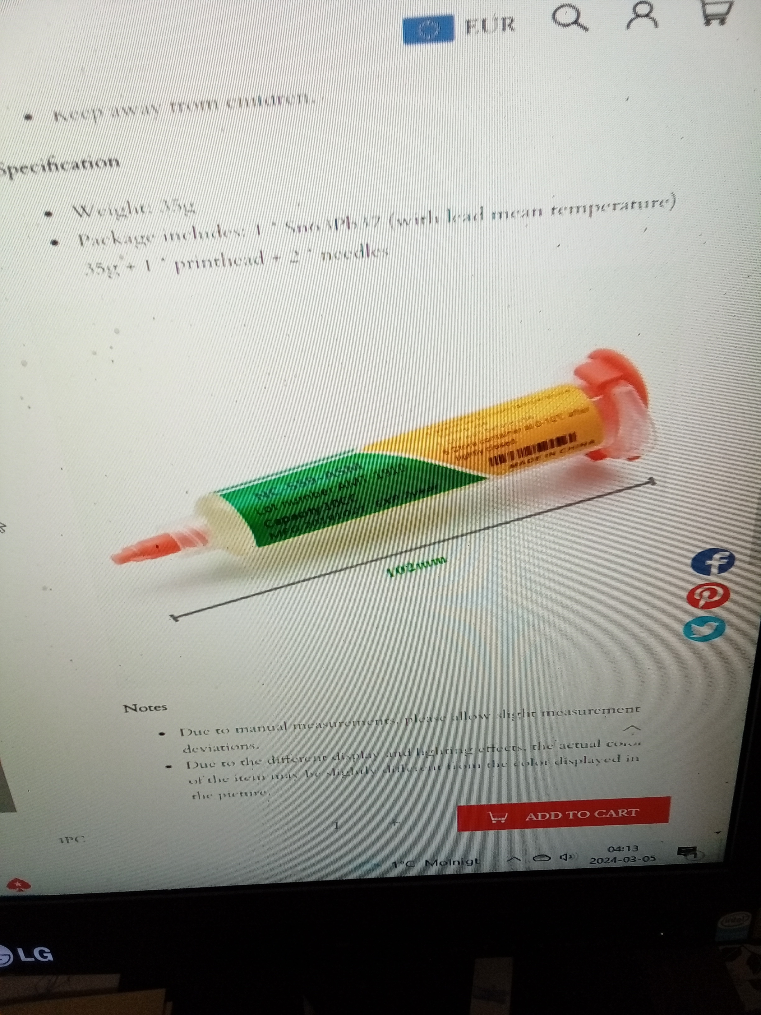

          Hard to not see... advertisement is generated all about bad photoshoped pieces of pictures, the any label, info, sytinge, aplicator, solder paste, illustration of use... all PS on last attachment. Would you trust in video, if they cant provide you actual f...ing photo of product?
          I search and found company KEK, but there is another label on his product... so...
          Edit
          Found some blank syringe so they can be printed/PSed anyway...
          Just noticed that on your label is 63Ph6Sn... so not photoshop mistake
